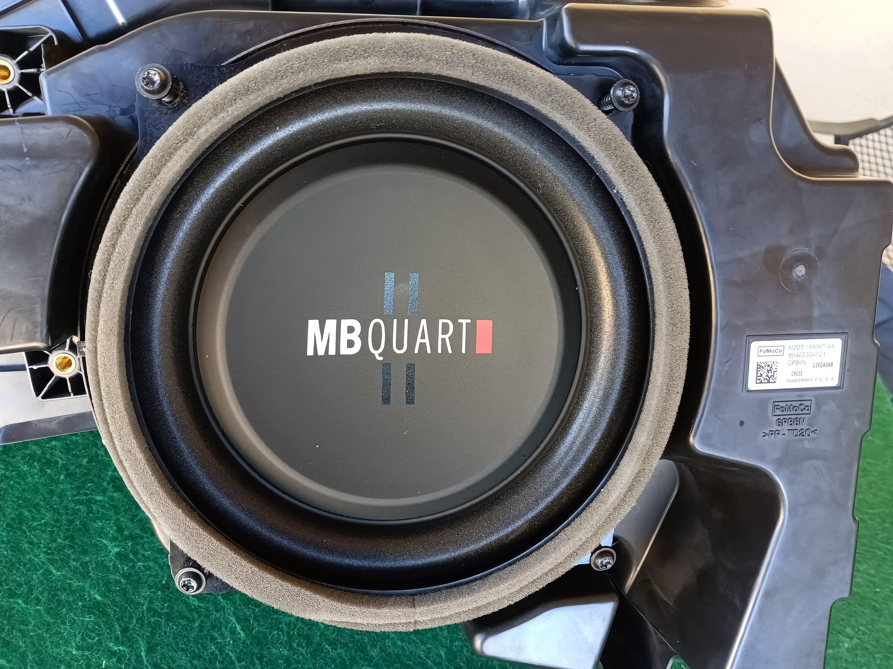

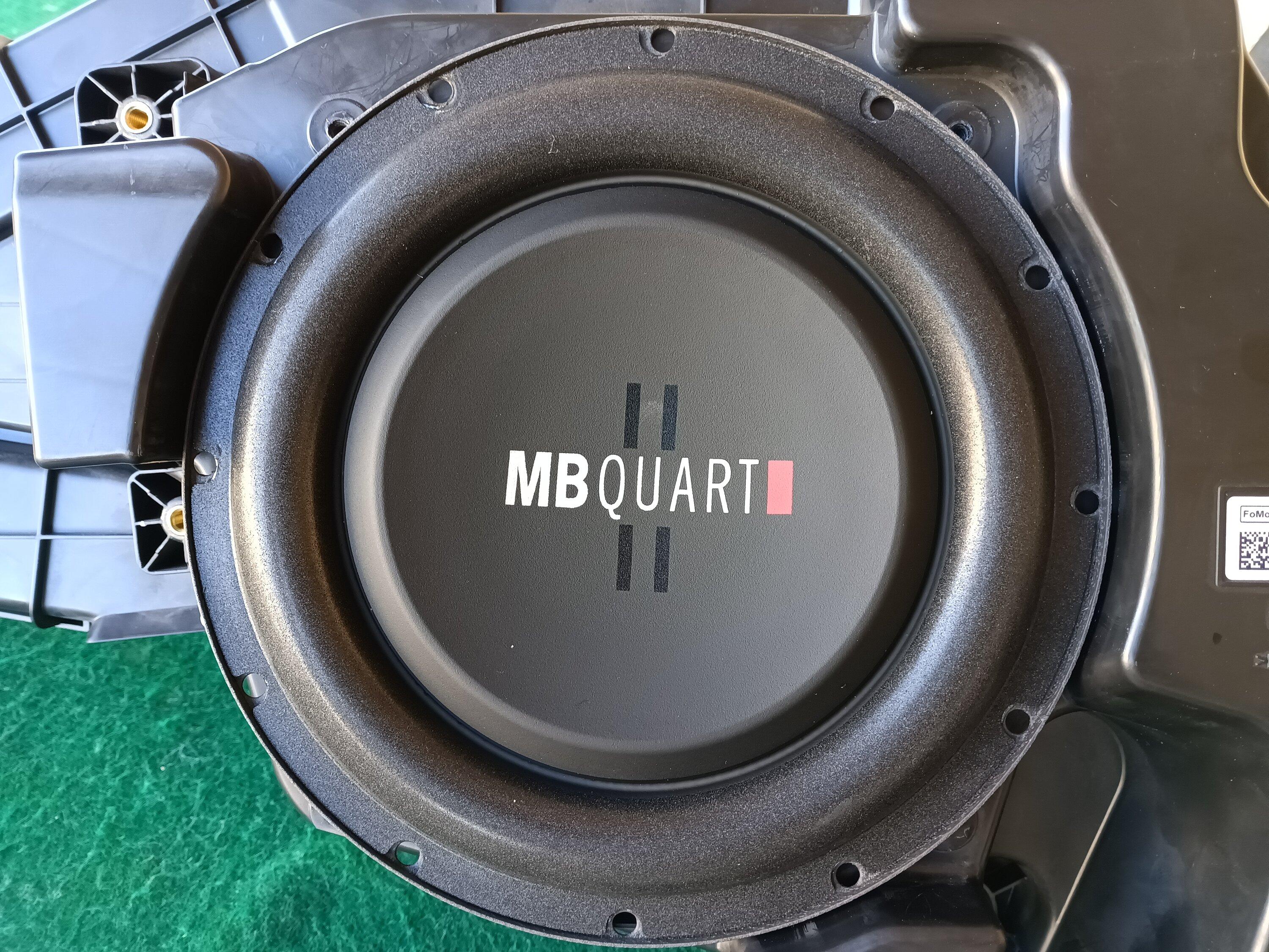

Ford Bronco B&O subwoofer upgrade IMG_20240110_111158_111

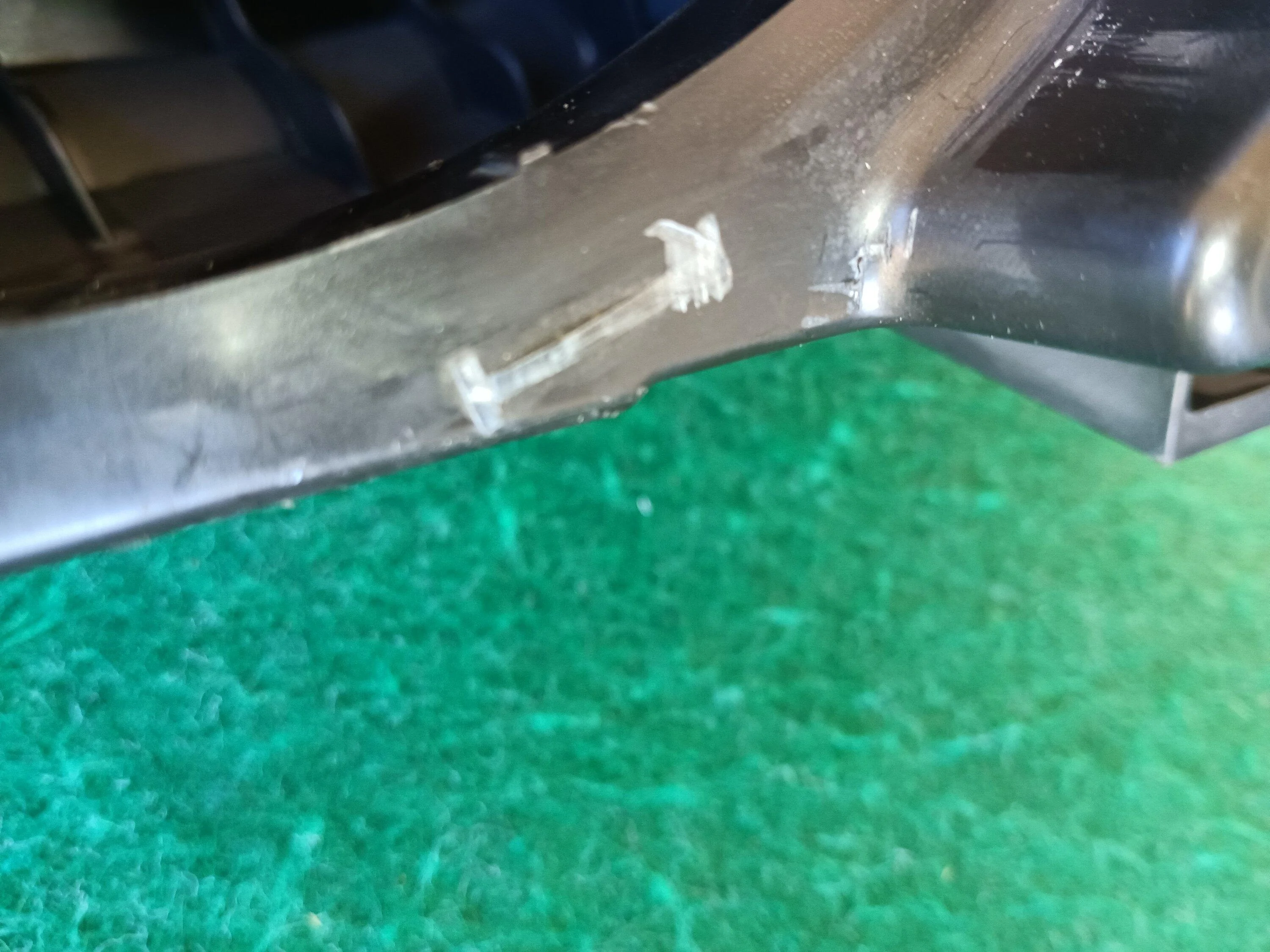

With just a razor remove tab and this 8" shallow sub fits! You must remove beauty ring from woofer.
Ford Bronco B&O subwoofer upgrade IMG_20240110_111434_184
Ford Bronco B&O subwoofer upgrade IMG_20240110_110900_489

So a 8-inch is what we have there and needed. Did you run it off the same power from the B&O amp? I upgraded all of my other speakers except the sub. I do belive I have a nice 8-inch on my bench somewhere that I did not use.

The factory B&O is a dual coil and a very small lightweight speaker. I'd go so far as to call it a woofer and not even a full subwoofer. Each coil was 4 Ohms when I tested it. I doubt that MB works well off the wimpy factory B&O Amp.

I am using a 5 channel mb quart amp NA2-500.5 to run 200 rms to the woofer and 40 rms to the front dash and kicks. I chose to keep the 4" in the back factory power but upgrade to mb quart FKB110.

Update....The woofer sounds fantastic in that enclosure with only 200watts!
Which MB Quart model number subwoofer is this ?

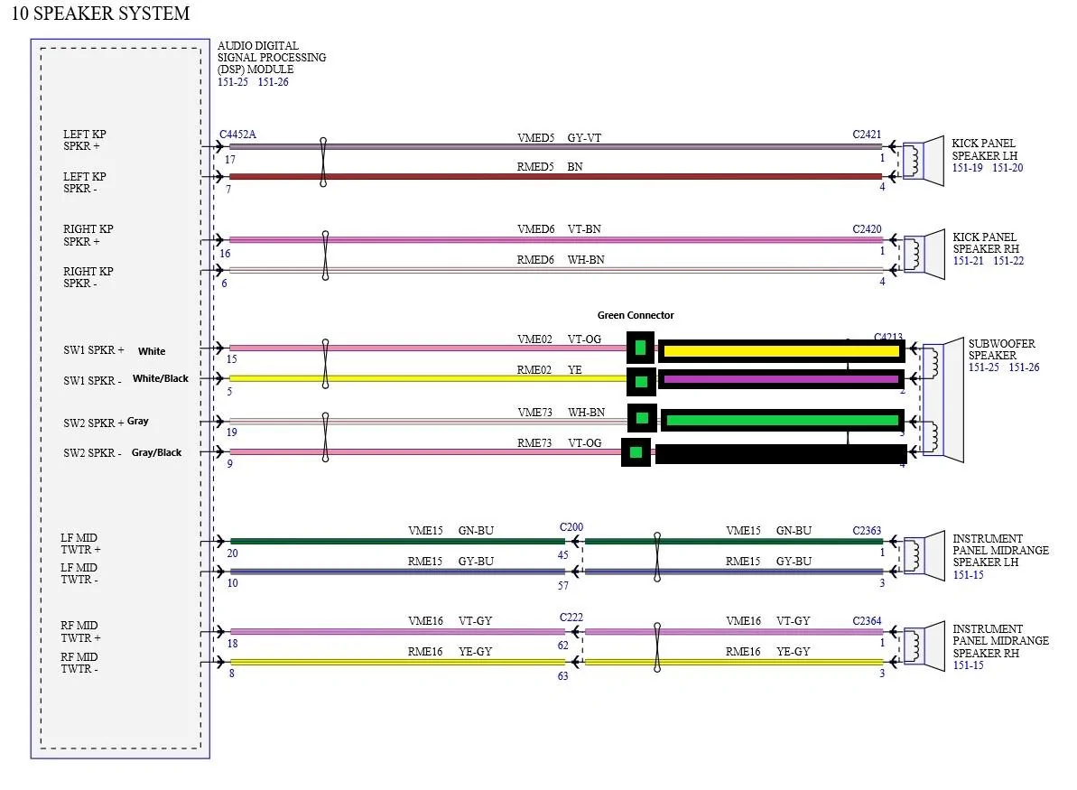

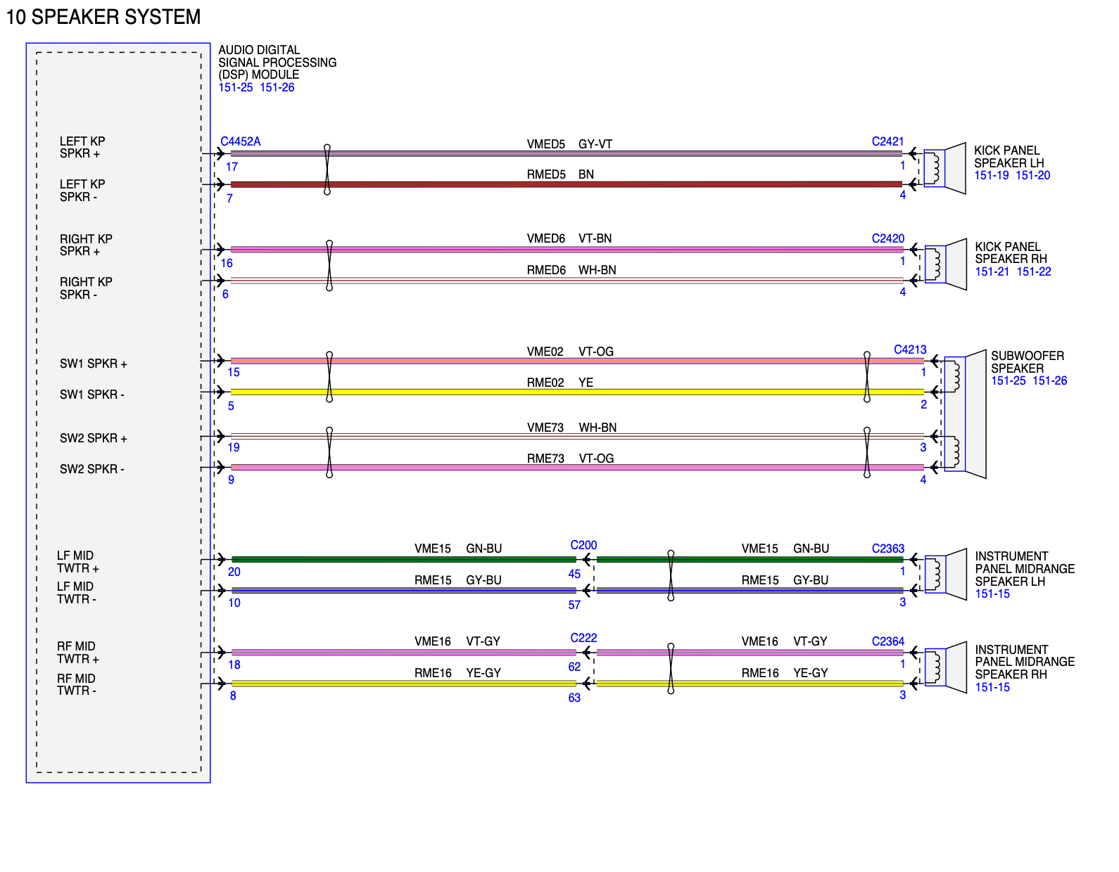

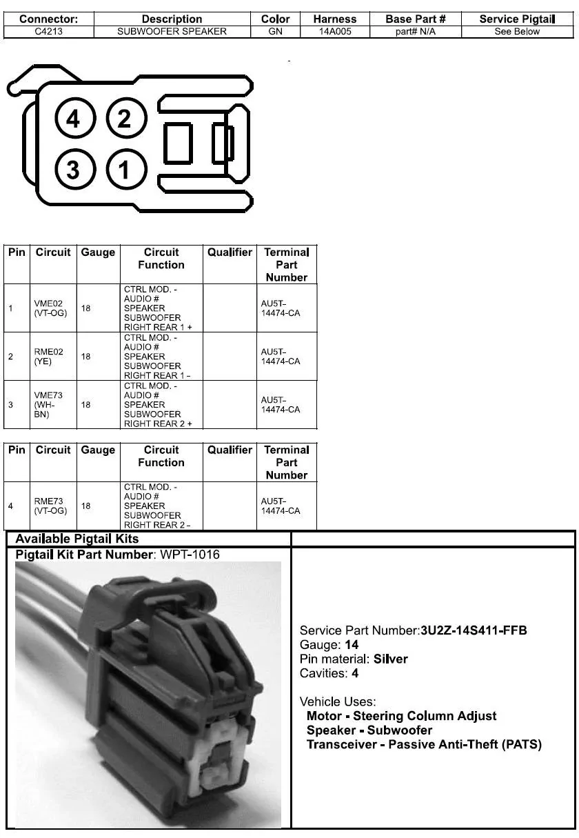

Can anyone clarify what is +/- wire colors at the B&O factory subwoofer inside the box ? This diagram is not to helpful
Johnny Mo
Aug 13, 2020
2,111
4,261
Westchester County, NY
teachu2shoot.com
Ford Fusion Energi, Ducati XDiavel
Ford Bronco B&O subwoofer upgrade 10Speaker-2
You have the wrong diagram there is a green connector that changes the colors that go into the sub enclosure see below. Inside the enclosure it goes to Yellow+ w Purple - and Green + with Black -. You can buy a connector and make it a clean connection instead of cutting - but the pins in the connector were flimsy and mine broke while crimping in my astro tool. so I just cut and spliced in my kicker key line level input connector. But if you are not running an amp these will go straight to your speaker terminals.
Ford Bronco B&O subwoofer upgrade 1668443137898
