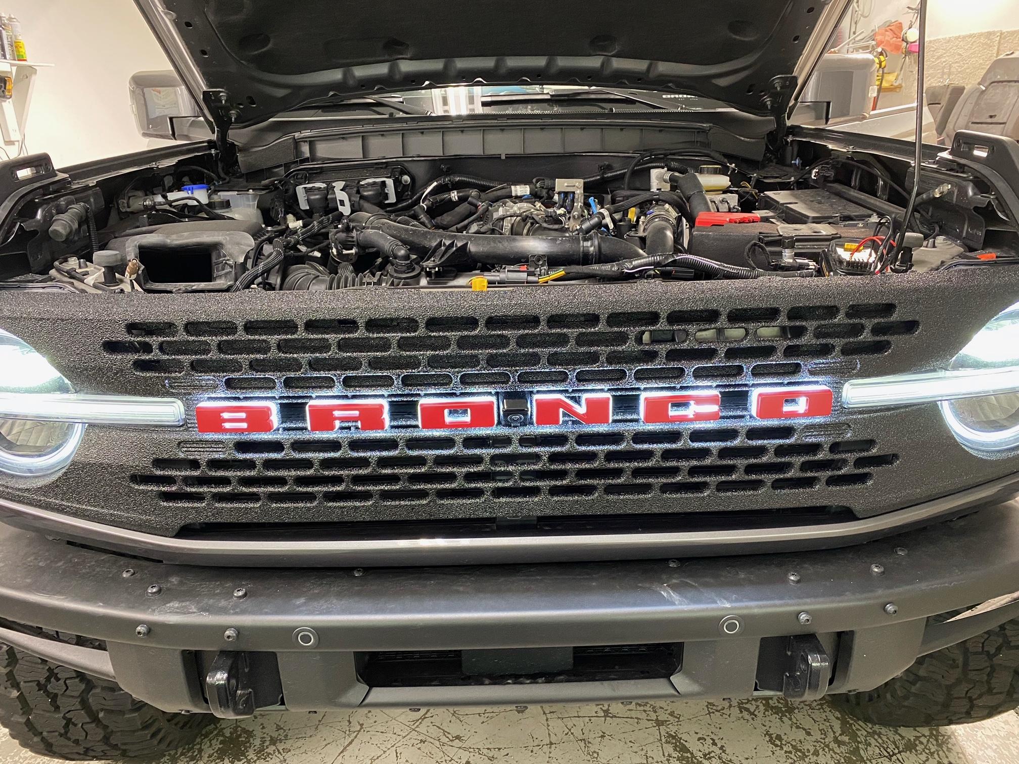

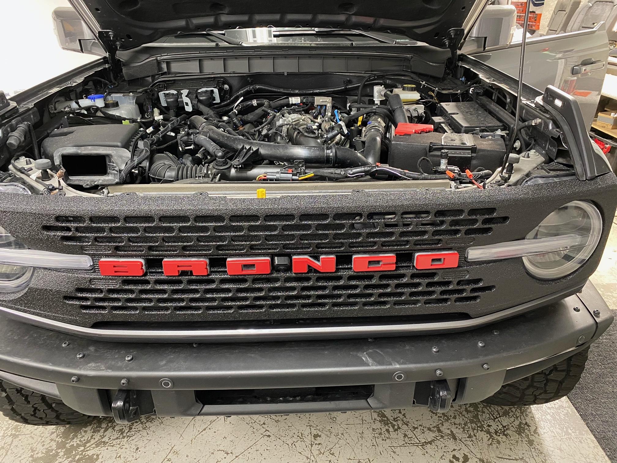

Amazing work, Peter. Fabulous, fabulous Bronco!!
Do your Bronco grill letters light up? 😉
Thanks Cat !!!
and yes, they light up. For some reason, some pics aren't showing up ?? so here you go....
OFF....
Ford Bronco Bad_Bronco Build...... So far...... image0 (9)
ON......
Ford Bronco Bad_Bronco Build...... So far...... image1 (6)
OFF....
ON......

Next, Line-X the grille (Hard Top and Fender Flares also, later) View attachment 281352
and add some cool lights I made..... off....
On.....

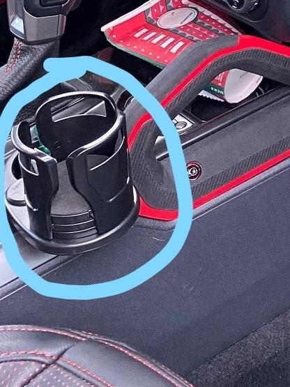

what is this? a 3rd cup holder? where did you get it?
Ford Bronco Bad_Bronco Build...... So far...... InkedIMG_5796_LI
