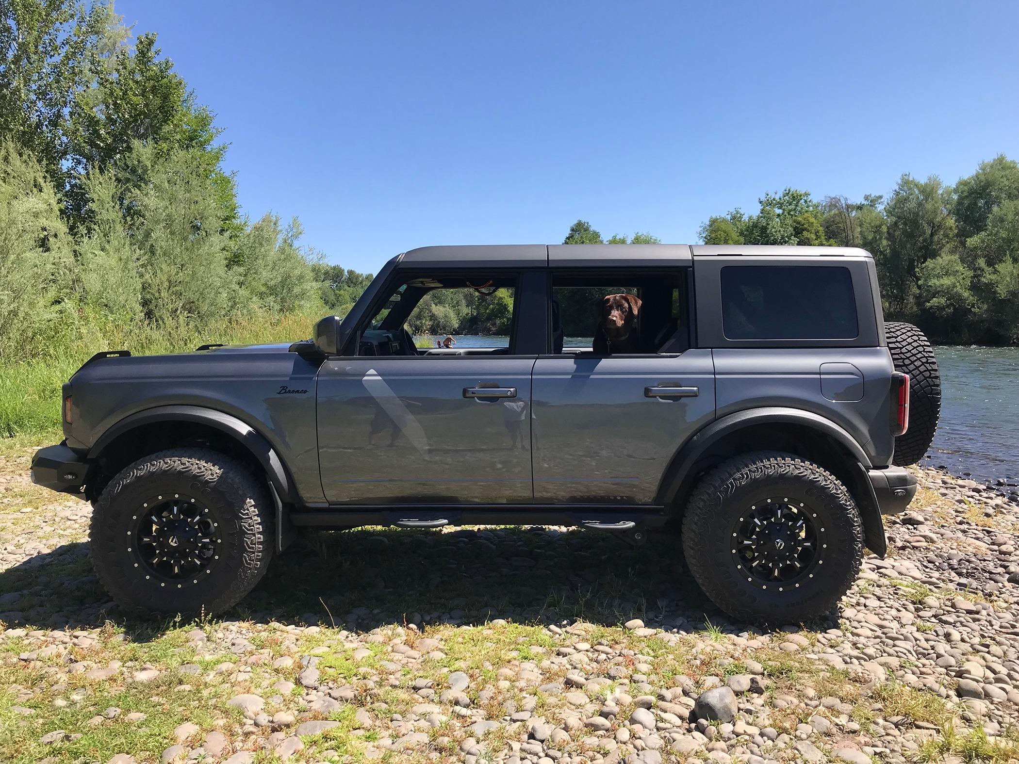

Bilstein 6100, rear clip is set at the lowest groove, Front is set on the fourth groove from the bottom. On flat ground it has a one half inch rake, taller in the rear.

Do you have to disassemble the coil over every time to adjust the c-clip then?

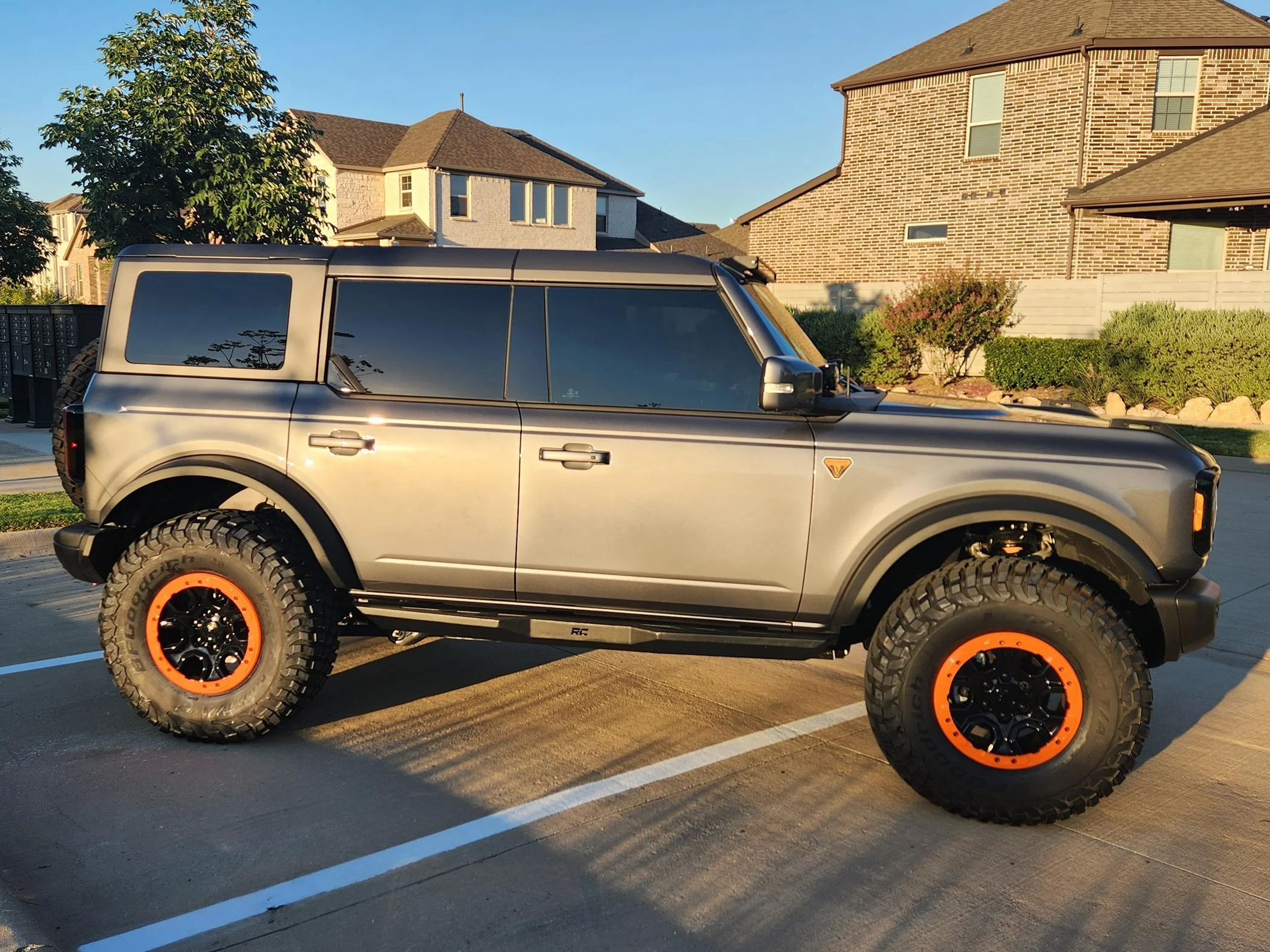

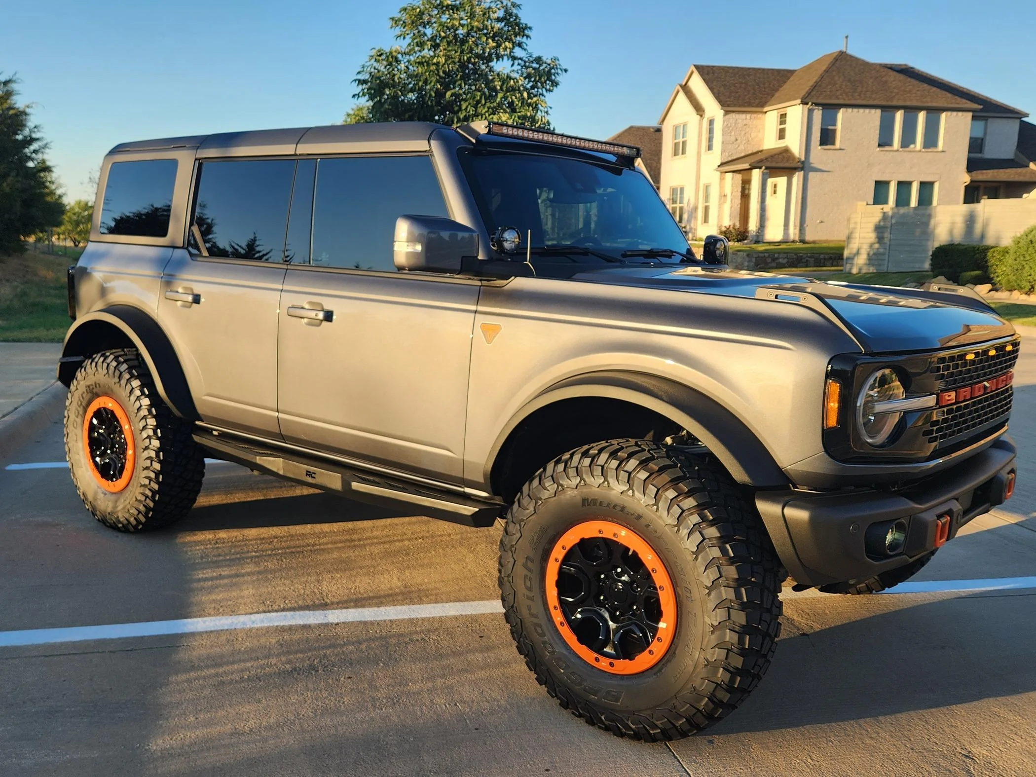

Bilstein 6112s front and back at highest setting.
Ford Bronco Bilstein B6100 20230816_073228
Ford Bronco Bilstein B6100 20230816_073205
For the front assembly you will need to remove from the vehicle and compress the spring to change the c-clip position. On the rear I was able to use a spring compressor and make a c-clip adjustment without removal. I was very surprised i ended with the rear assembly c-clip set at the bottom groove.
