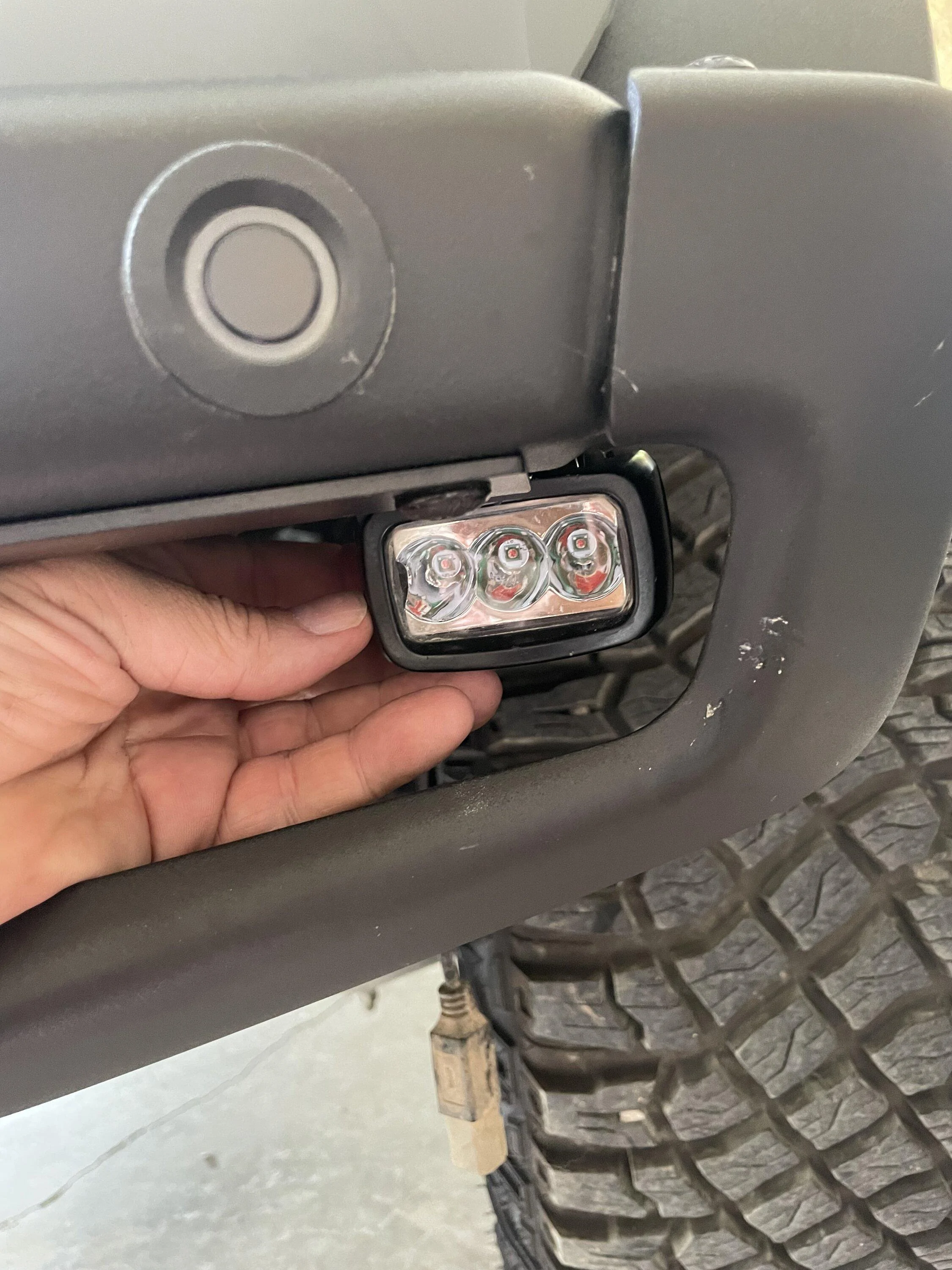

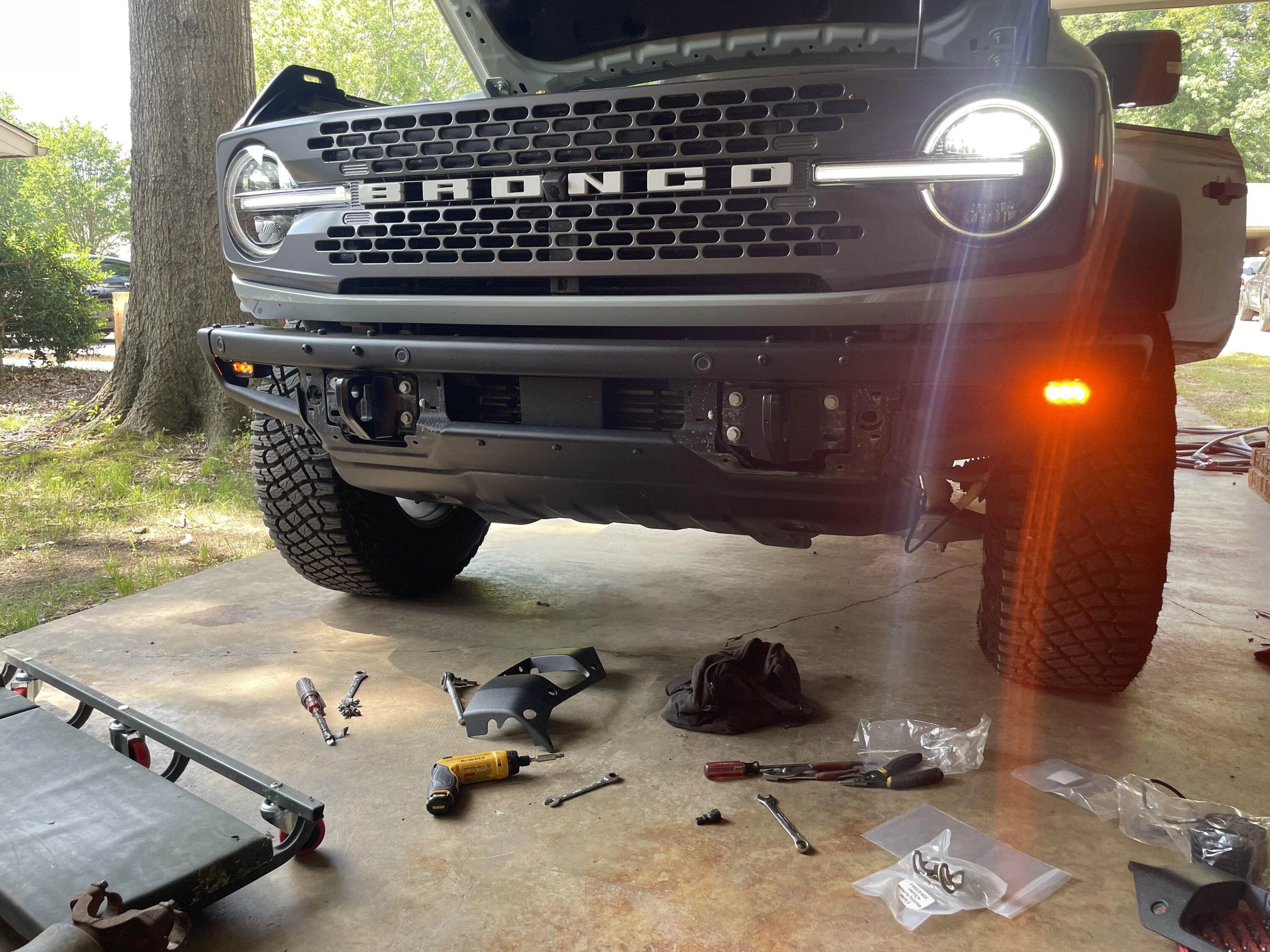

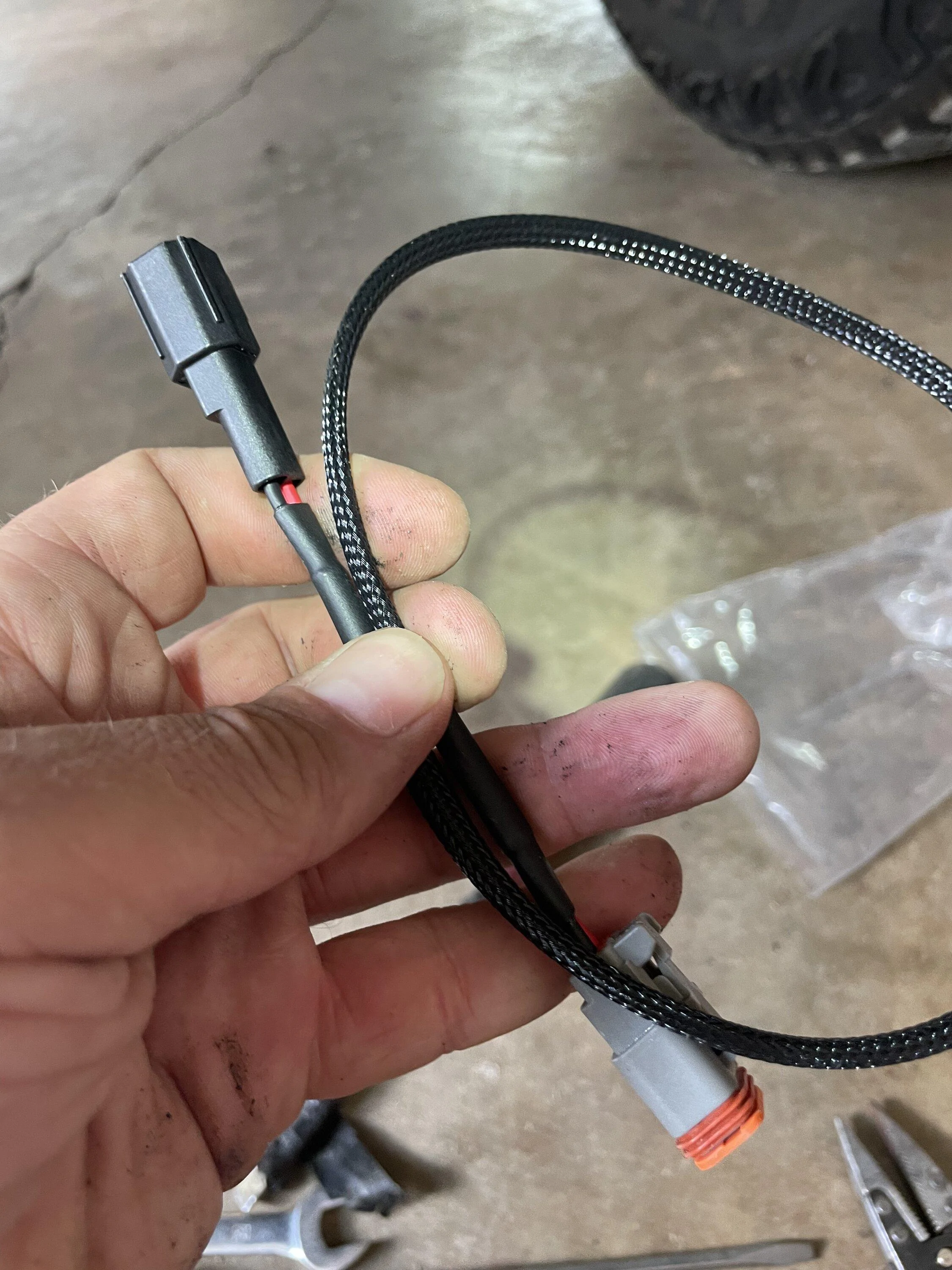

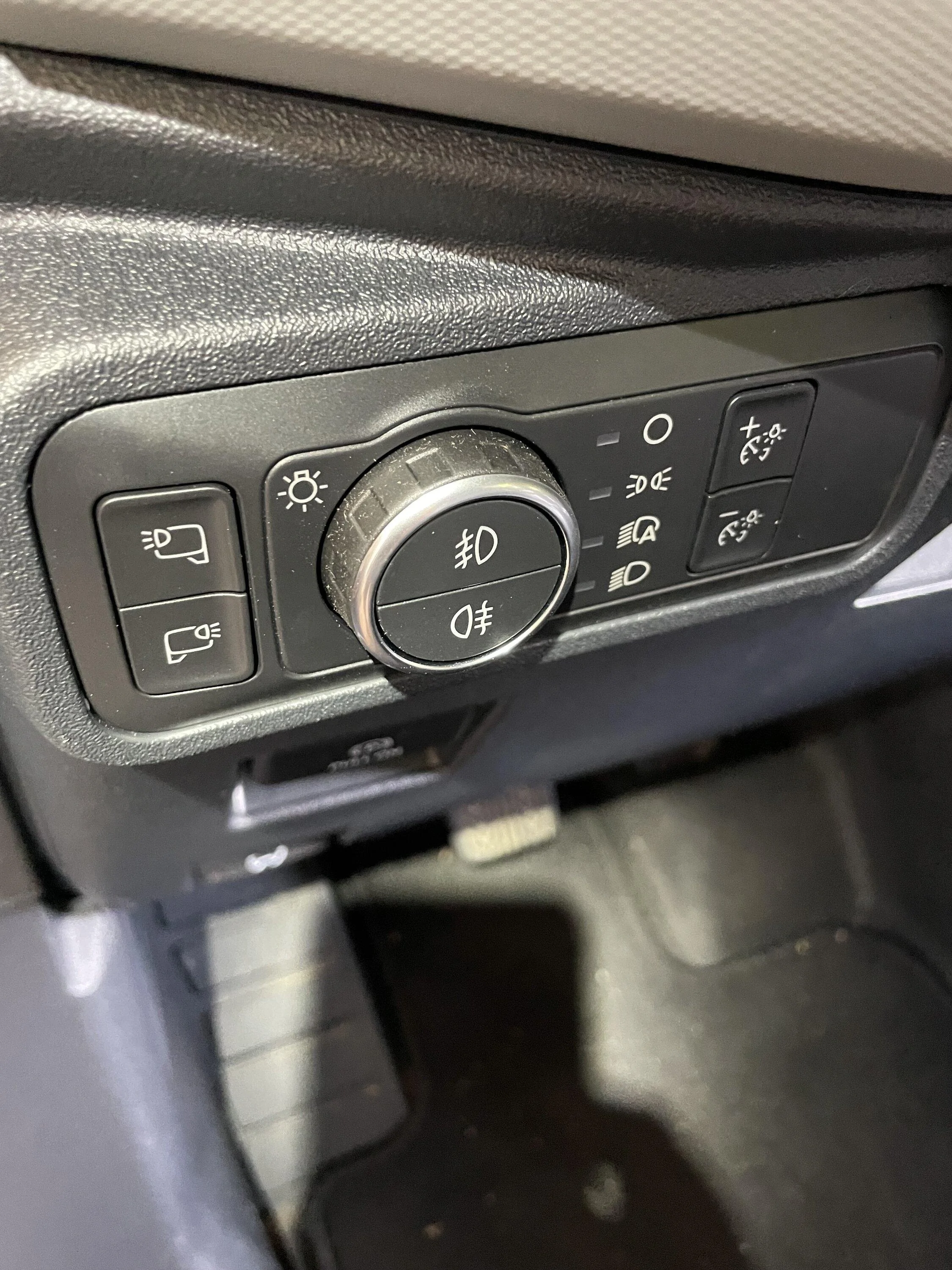

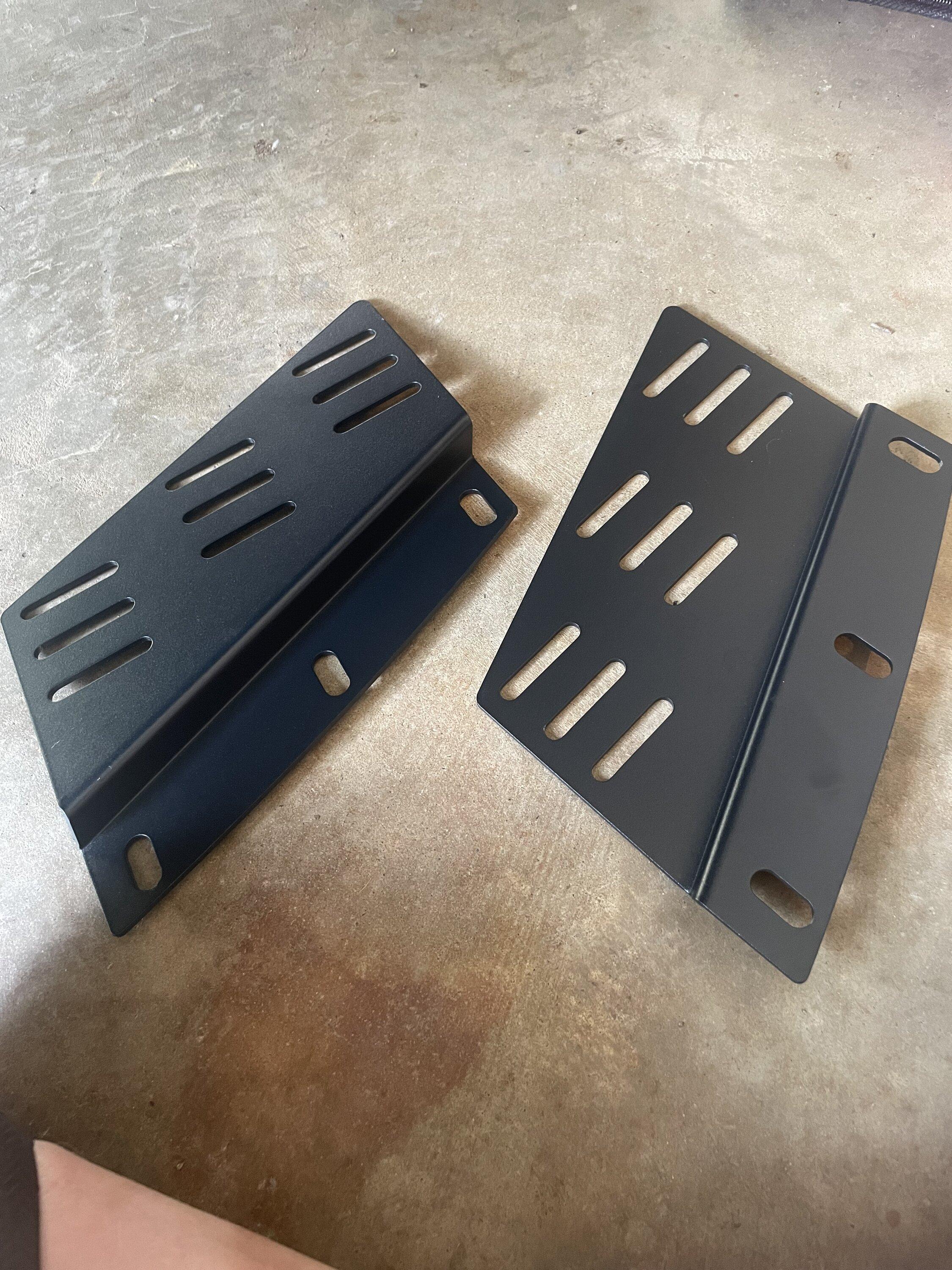

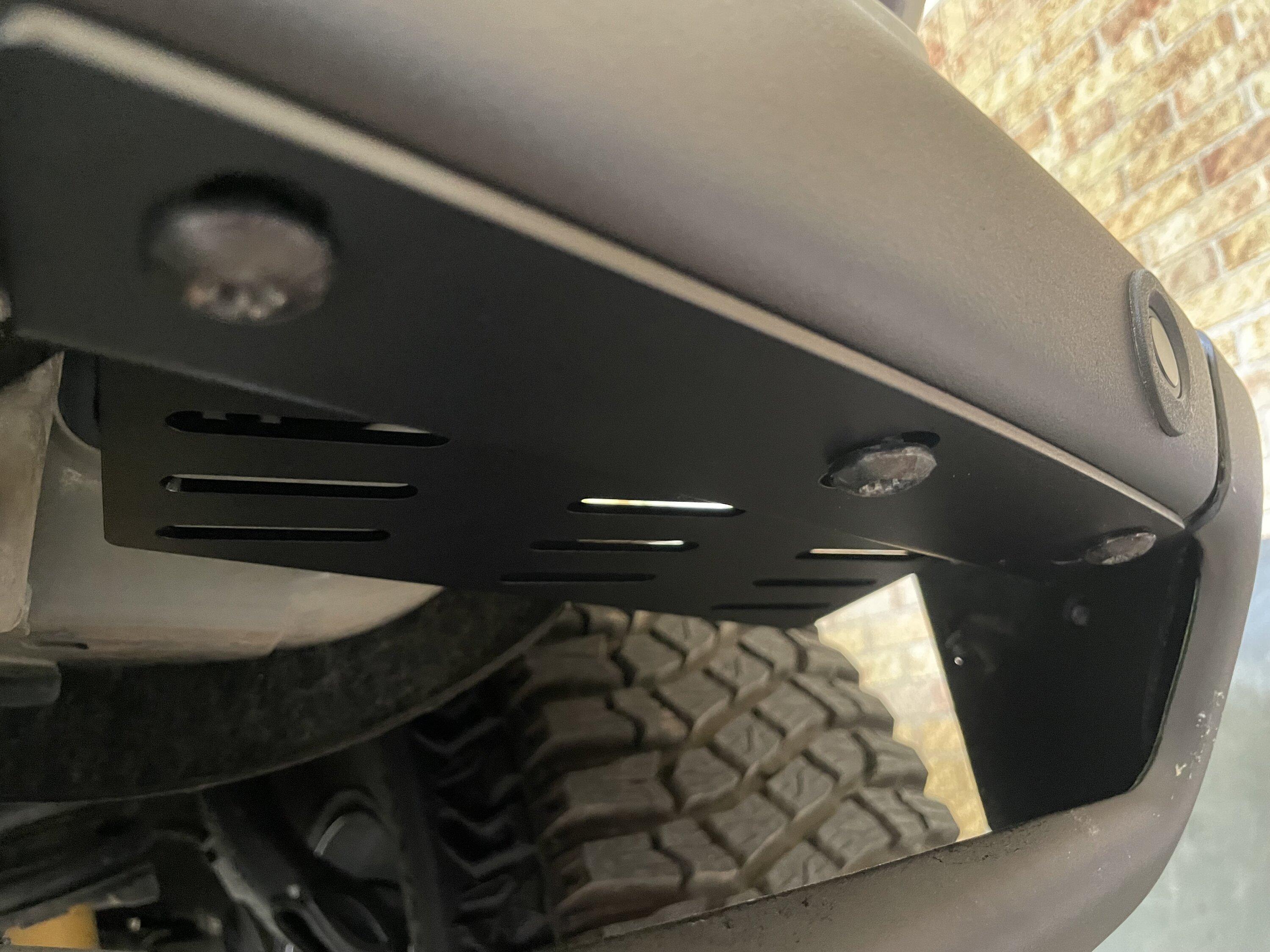

High package Broncos have the wiring for OEM fog-lights behind that modular bumper. So I bought a headlight switch with the front fog light button(and rear, I don't know, maybe I will do something with that), adapter pigtails from 4x4TruckLEDs.com, and fog light brackets from JCR. I grabbed some old Rigid LED lights out of my shed. Using Forscan and a USB OBD2 adapter got to mounting, plugging in, and reprogramming my Bronco for fog lights.
JCR mounts

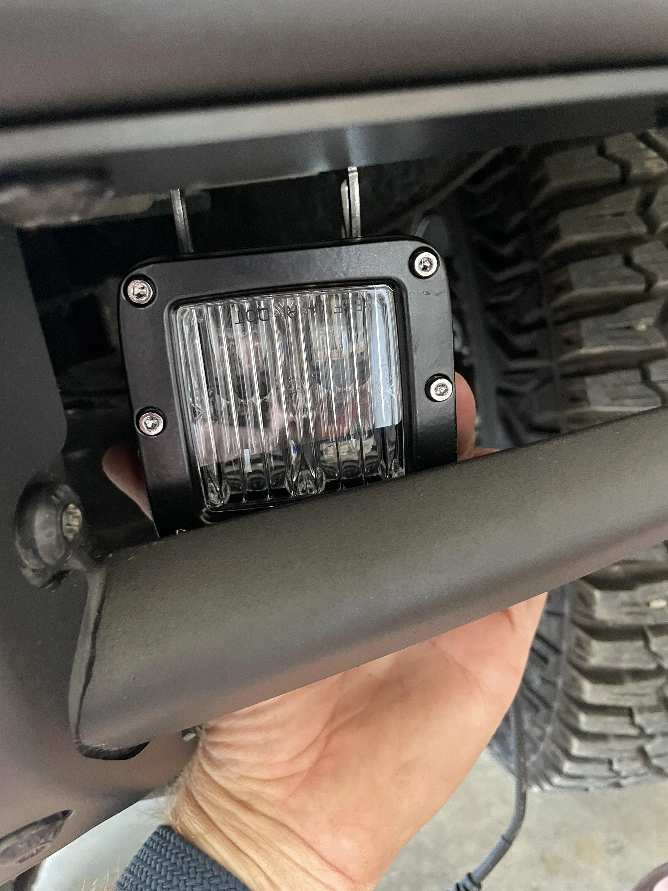

Rigid D-Series brackets are a bit to tall so I dropped in a set of S-Series lights for now.

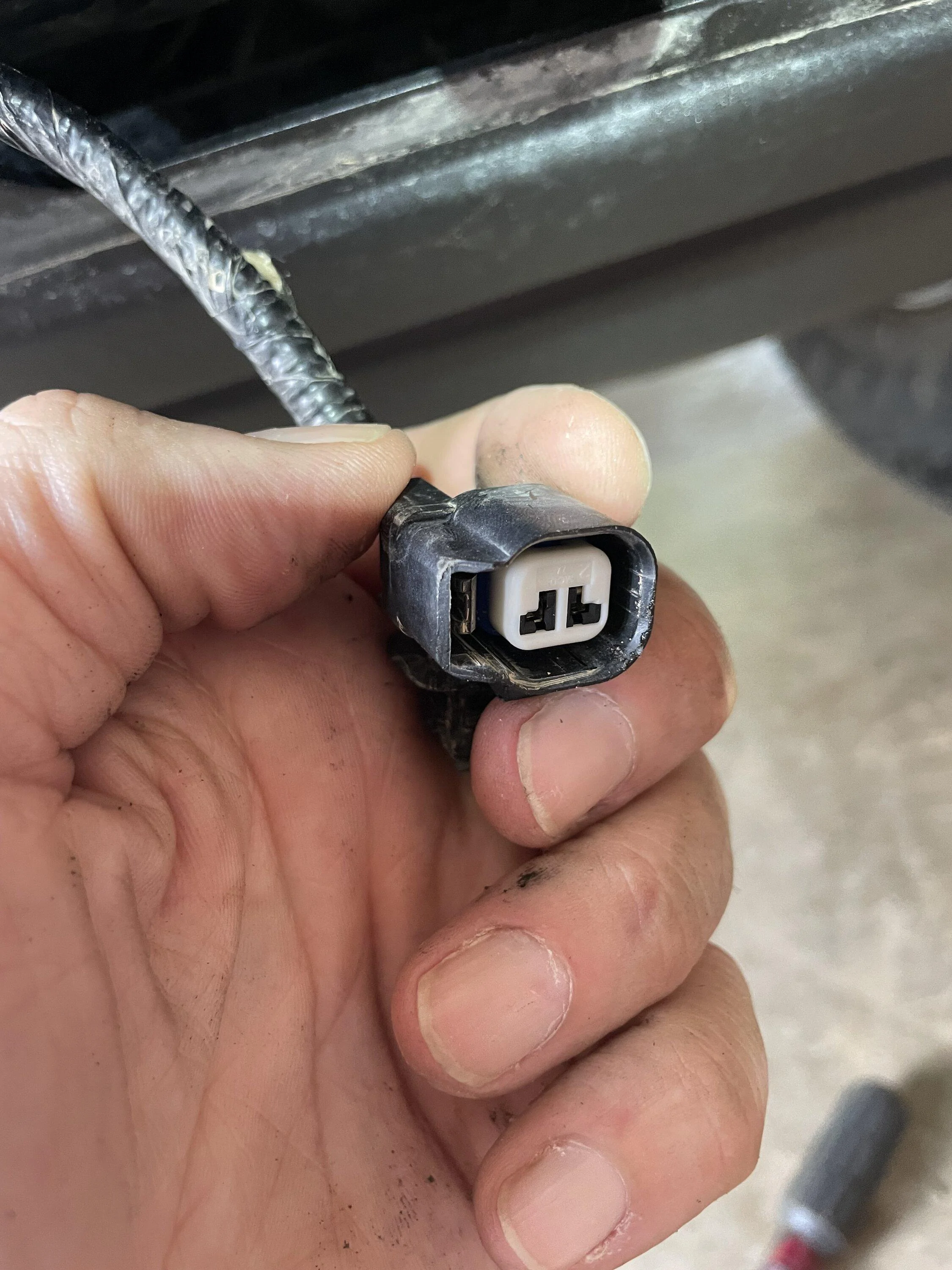

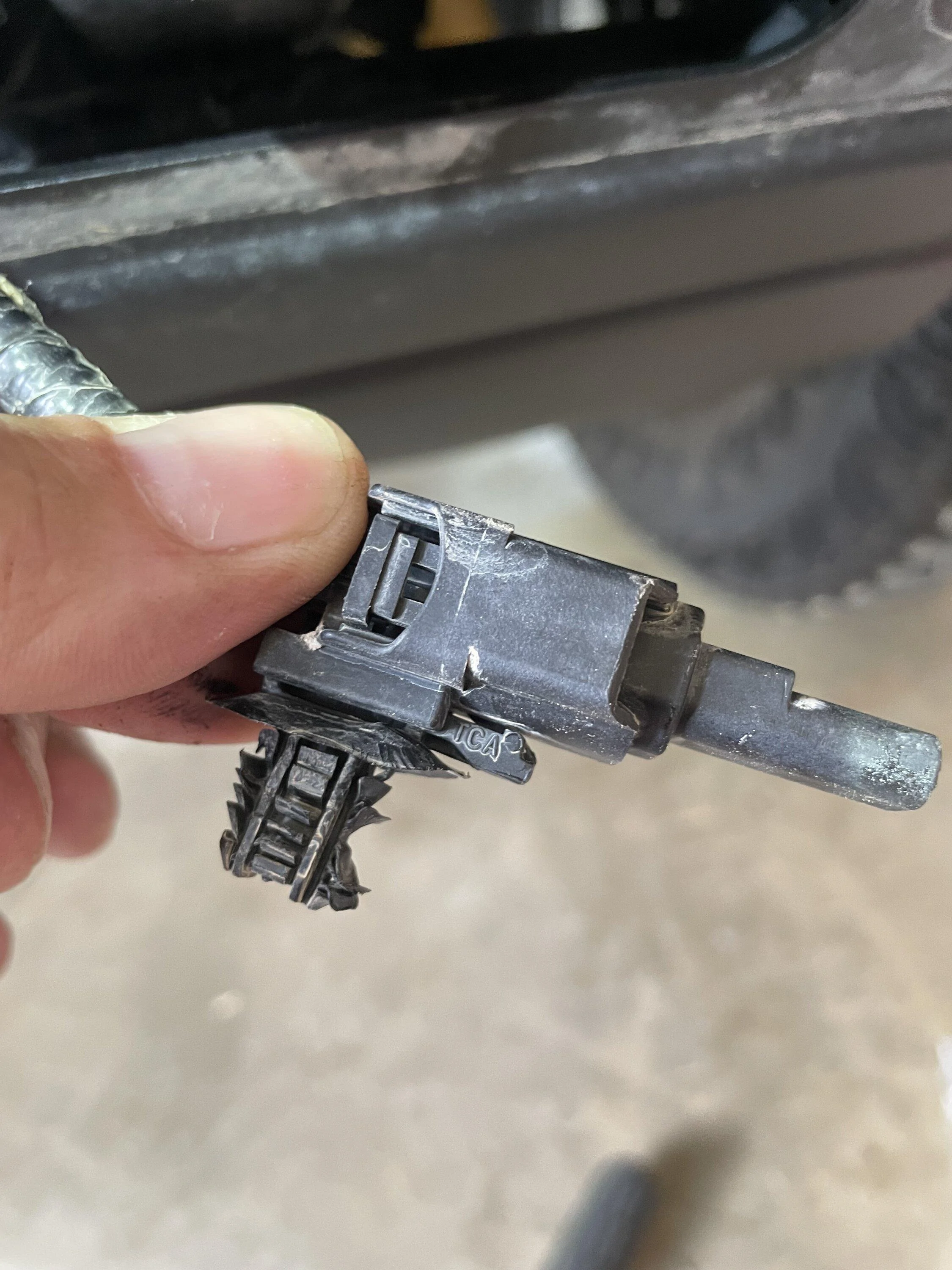

Plugging in pigtails.

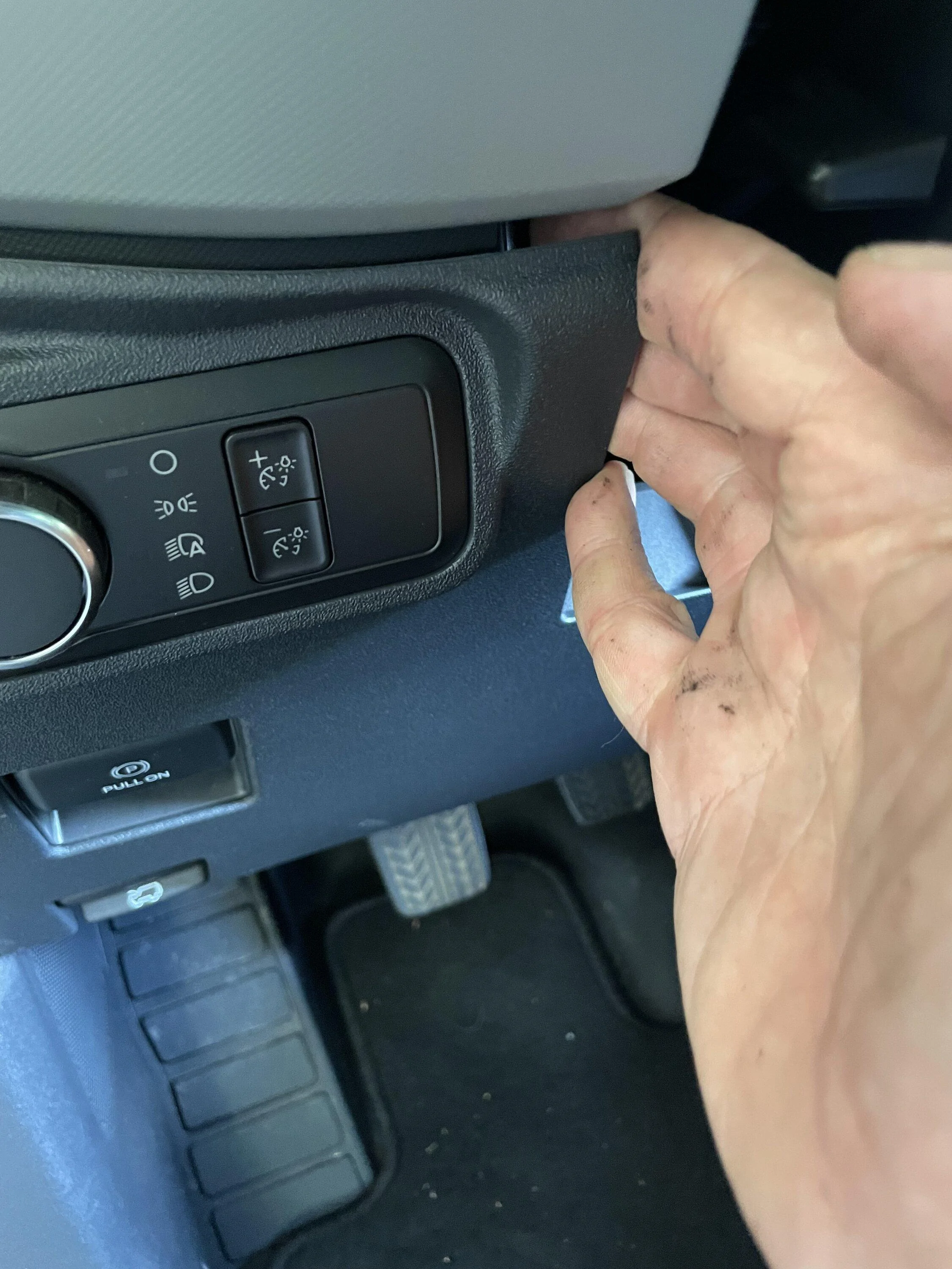

Swap out the headlight switch.
