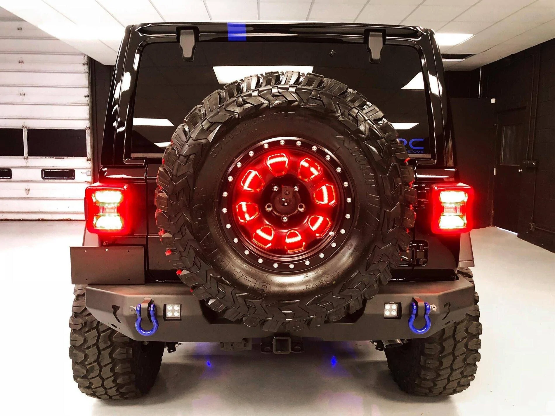

Just fix it like all of the Jeep’s do...
I expect these to be available almost immediately provided the wiring isn't too difficult.
I like that the Broncos spare appears to sit much lower, I don't plan on running 37s, but the rearview mirror looks like it'd still be at least usable in the Bronco compared to the Jeep.
Wiring is going to be a breeze on a set up like this. From pictures there's two channels for wiring and at least one easy to reach connector on the interior panel.
I've actually been hemming and hawing over this situation. Chase light or rim light? It's gonna come down to whether or not I do an interior spare tire solution on a lay flat H-frame or just leave the 70lbs tire on the back door to wear out the hinges.

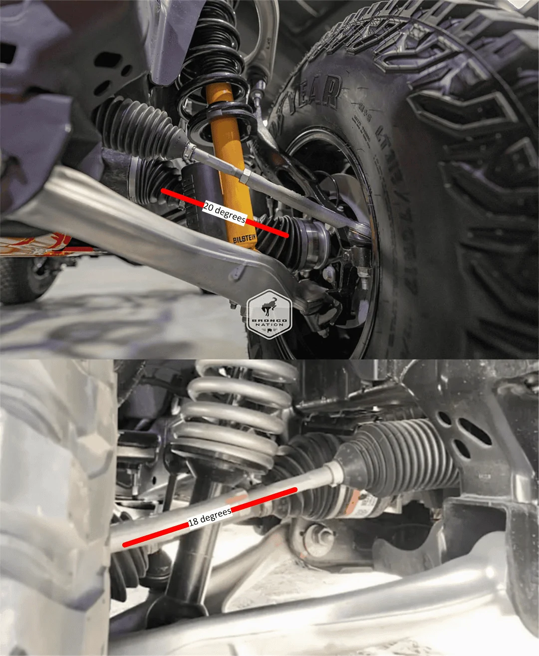

Pretty extreme CV joint angle in that front suspension pic, that is going to be hard on the axles if wheeled hard. If I was going that high, I'd probably opt for a full crossmember LCA drop kit with larger knuckles.
Here is a CV angle comparison, granted the two photos were taken at different angles, but the relative difference is minimal. The 4WP 37" lifted photo shows the CV angle at 18 degrees (lined up behind the steering arm). The unloaded Sasquatch photo shows the CV angle a 20 degrees, when weighted down with the body it's CV angle would most likely be closer to 18 degrees.

Looks tough on 37s. Wow! I would be cautious wheeling that too hard. Seems a front and rear D44 may be at their strength limit. M210/220 may be a bit stronger though.
