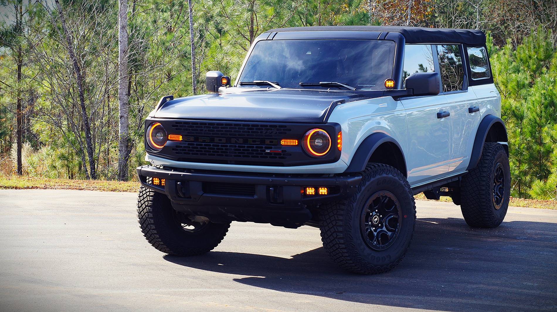

Bronco6G friends,
Some of you may have seen me post 0-60 & 1/8 mile times throughout this forum, but figured I would start my own thread. Wanted to have a place to post my ongoing results as I add more performance mods to my Bronco. Why do this? I mean, it's an off-road vehicle, not a drag car; right? Well...I do it because It's fun and I enjoy seeing what I can eke out of this platform and the little 2.7L engine. I’m all about making a quick off-roader :)
My Bronco is a 2022 Big Bend Sasquatch 4DR Soft Top with the mid package. It has the modular front bumper, added factory skids plates, NFab rock sliders, and ACFab shock skids. In a nutshell, I have no plans to make my Bronco lightweight as I do wheel the vehicle and put the added protection to use.

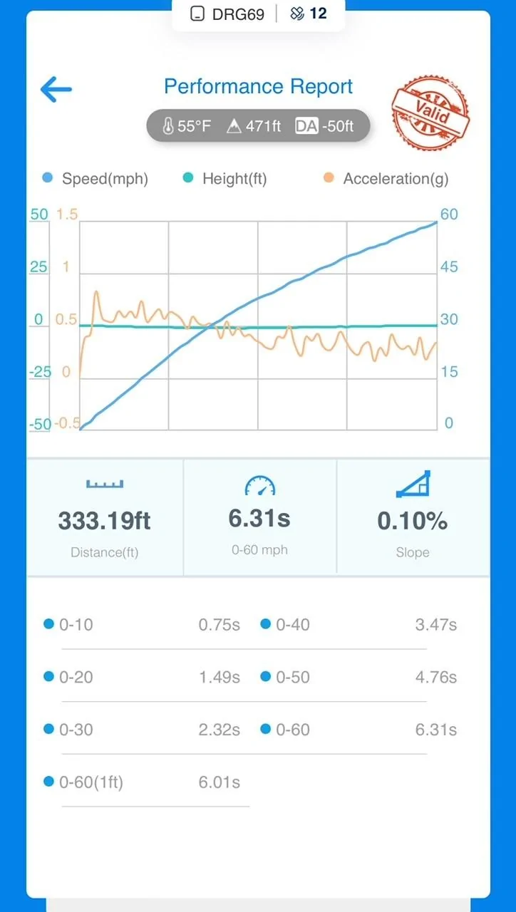

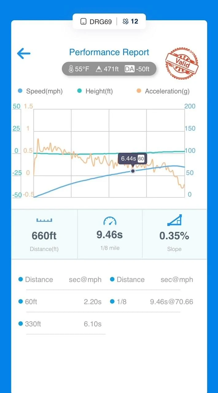

With just the S&B air filter and using 88(E15) or 93 octane I would consistently hit 0-60 in the 6.5-6.7 sec range. When I added 6 gallons of E85 for a E30-ish mix, I would drop down to 6.3s and 1/8 mile in 9.46s (would be closer to 9.39-9.40, but let off too early)
Ford Bronco 0-60 in 4 Seconds - My 2.7 Bronco Performance Modification Thread 6.3
Ford Bronco 0-60 in 4 Seconds - My 2.7 Bronco Performance Modification Thread 9.46

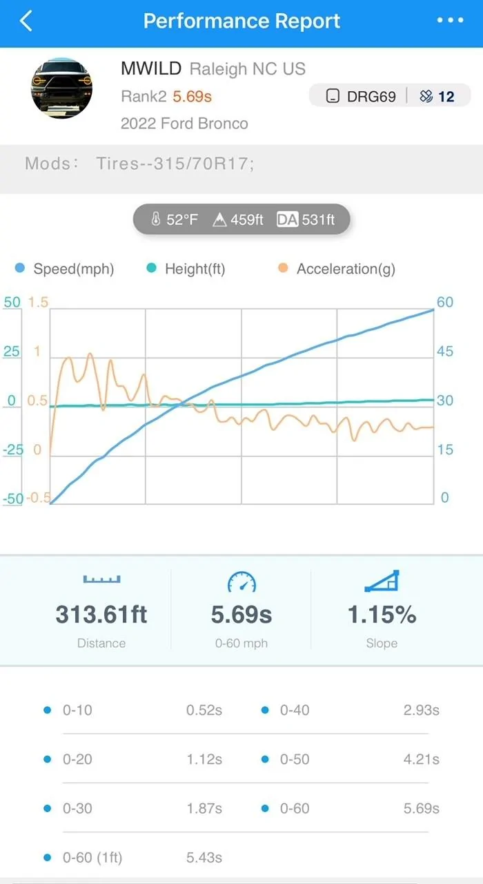

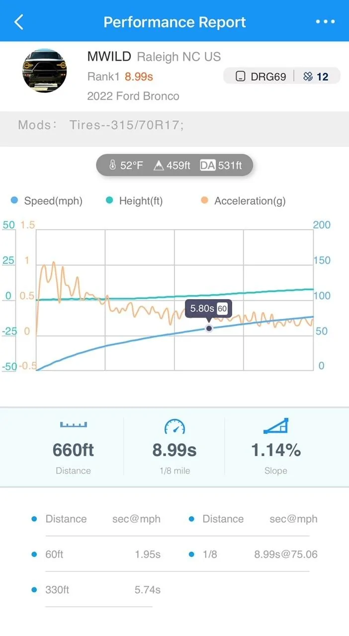

Today I installed my Ford ProCal device and managed to drop my 0-60 to 5.69s. This was with 93 octane. I also did the 1/8th in 8.99s and 60 ft in 1.95s (Faster than my old 93 Mustang 5.0 w/FBO 😁)
The Bronco now wheel hops off the line in 4A...wasn't expecting that.
All runs done in Sport mode + 4A + ATC off + 2nd gear launch.
Ford Bronco 0-60 in 4 Seconds - My 2.7 Bronco Performance Modification Thread 5.69
Ford Bronco 0-60 in 4 Seconds - My 2.7 Bronco Performance Modification Thread 8.99

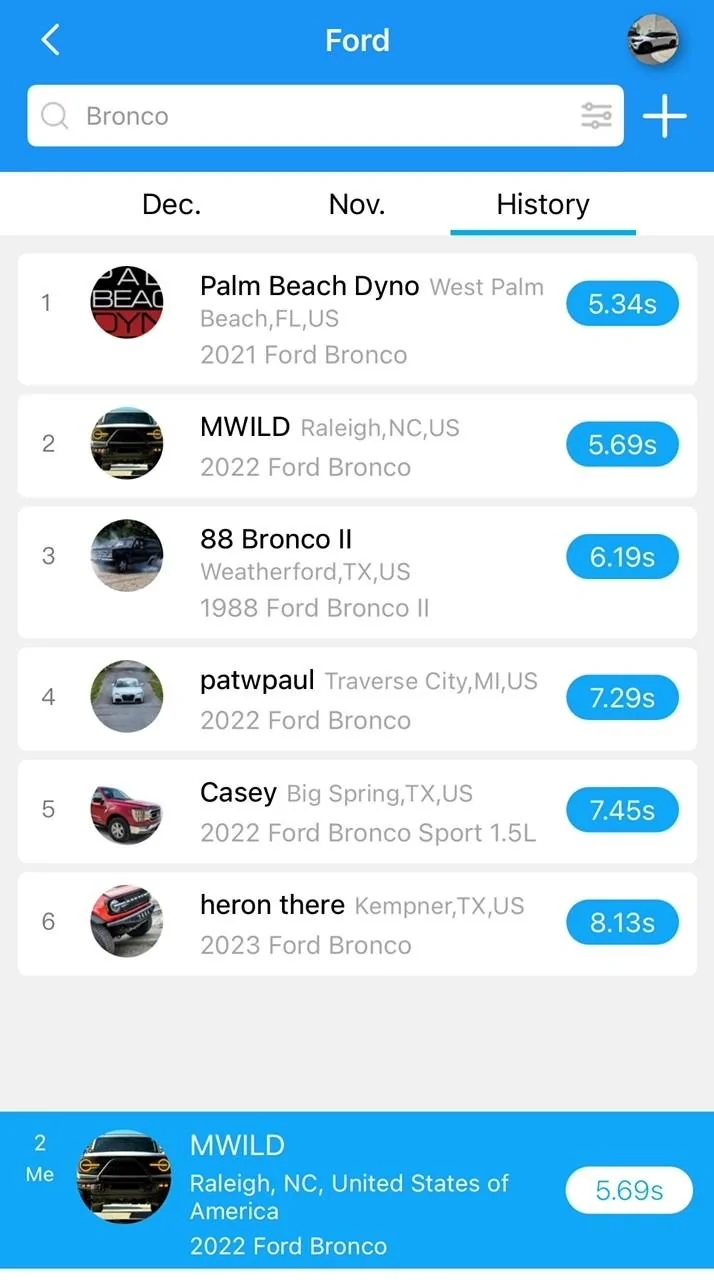

Still have Palm Beach Dyno in my sights :)
They were able to achieve 0-60 in 5.34s. This was in a 2021 WT with the top, spare and doors removed + JB4 @ Map 4 with E30 + Exhaust
Ford Bronco 0-60 in 4 Seconds - My 2.7 Bronco Performance Modification Thread PBD leader

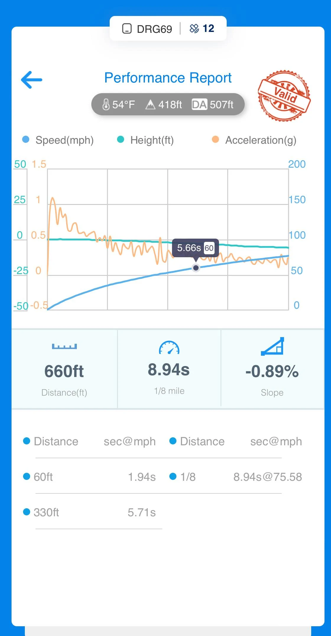

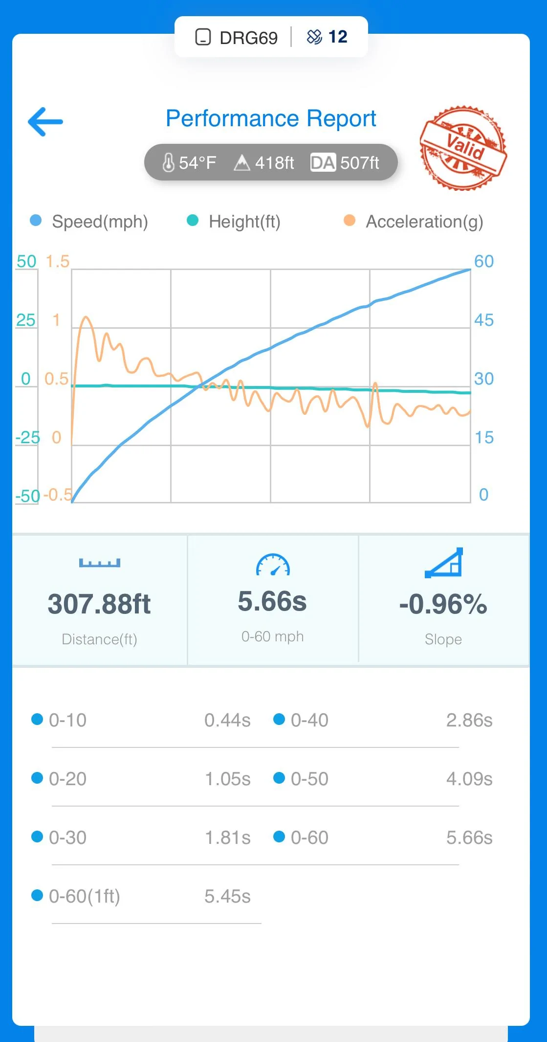

[UPDATE 1/7/24]
Installed Injen CAI and Turbosmart BOV and ran again.
Did my 0-60 and 1/8 mile with the addition of Injen CAI and Turbosmart BOV. No real improvement flat out, but in day to day driving I noticed a solid improvement in midrange power. I ran it a few times and the were all pretty similar. Think i’m gonna need more boost plus an intercooler for it to make a substantial difference.
Ford Bronco 0-60 in 4 Seconds - My 2.7 Bronco Performance Modification Thread 5.66
Ford Bronco 0-60 in 4 Seconds - My 2.7 Bronco Performance Modification Thread 8.94

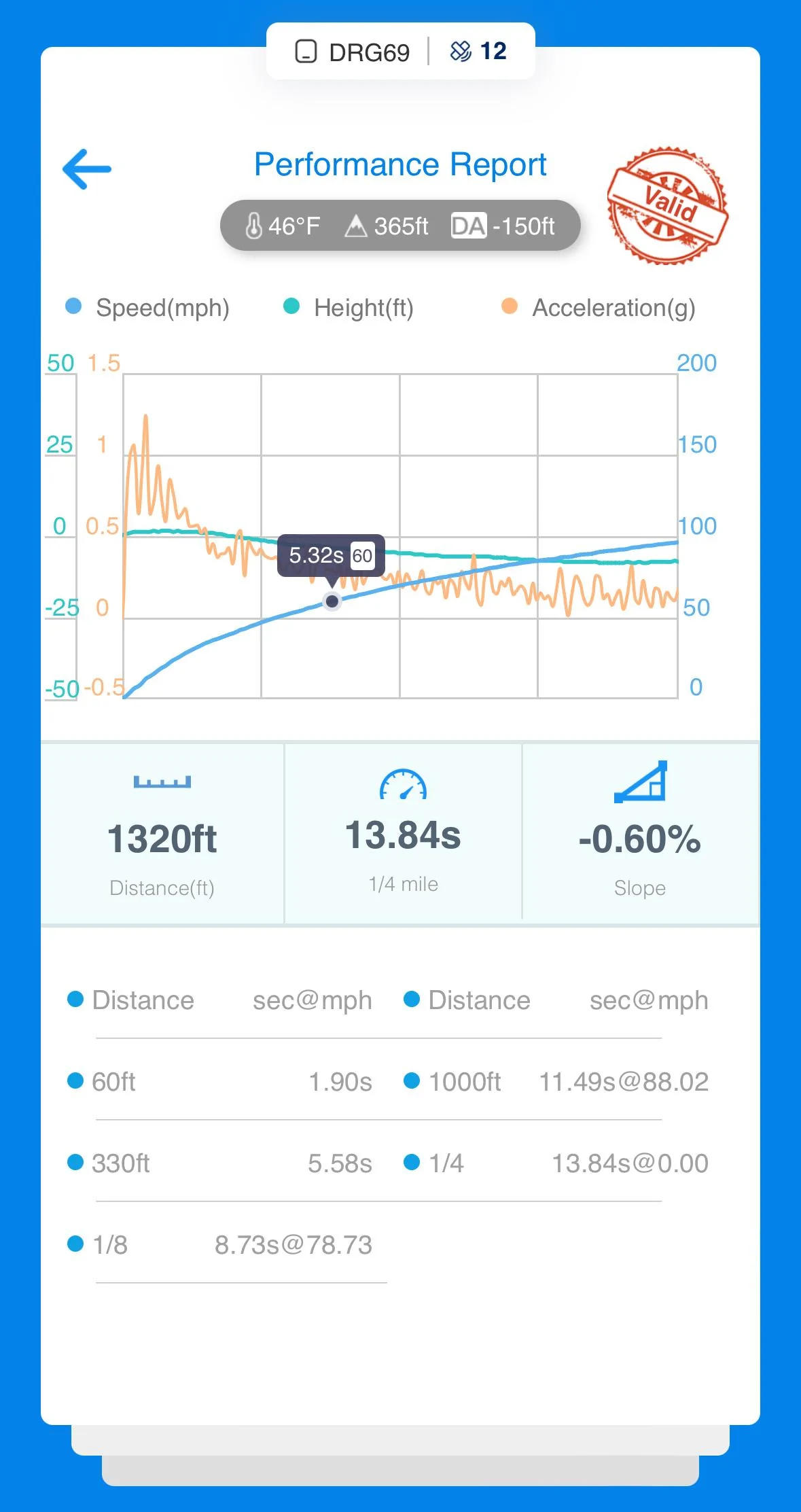

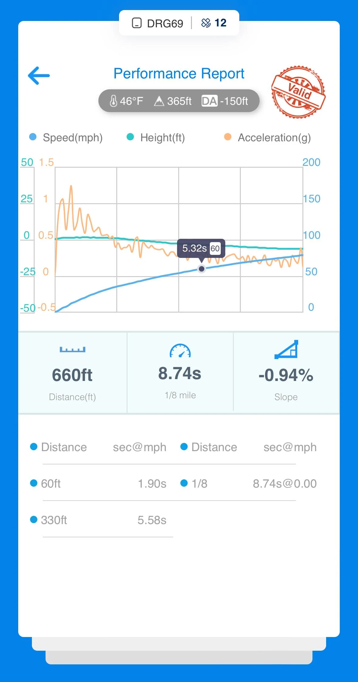

[UPDATE 1/13/24]
Today I’ve been driving around with the RaceChip set to level 3 and the Bronco feels great. I decided to give this setup a run since I had a nice piece of road away from civilization.
This time I launched the Bronco in 4H instead of 4A. The launch was more violent and I experienced more wheel spin, though it still pulled hard off the line. Think I’m gonna drop the air pressure a bit and not launch so hard next go around to see if it improves my times… Anyway. The RaceChip was exactly what I needed. I don’t know how much boost it adds, since I can’t see the actual boost pressure w/piggyback tune…
Regardless, even on this low setting I ran the times below:
60ft = 1.90s
0-60 = 5.32s
1/8 mile = 8.74s @ 77.32 MPH
1/4 mile = 13.84s @ 95.60 MPH
This was on a fresh tank of 93. Technically, these times are faster vs. Palm beach Dyno’s run, but there was an issue with the 0-60 run being unverified within the app. Oddly enough, the 1/8 and 1/4 mile saw no issues and were verified. Doesn’t matter, I still have more to come so I’ll do it again. Still, these are BRaptor beating acceleration numbers.
Ford Bronco 0-60 in 4 Seconds - My 2.7 Bronco Performance Modification Thread IMG_0690
Ford Bronco 0-60 in 4 Seconds - My 2.7 Bronco Performance Modification Thread IMG_0689

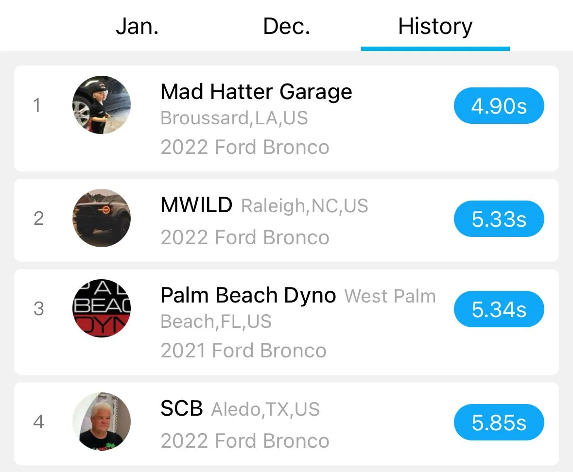

[UPDATE 1/28/24]
CV Fabrication Intercooler and plugs installed.
ā€œOfficiallyā€œ beat Palm Beach Dyno 0-60...barely, but a win is a win :)
Ford Bronco 0-60 in 4 Seconds - My 2.7 Bronco Performance Modification Thread Beat Palm Beach Dyno

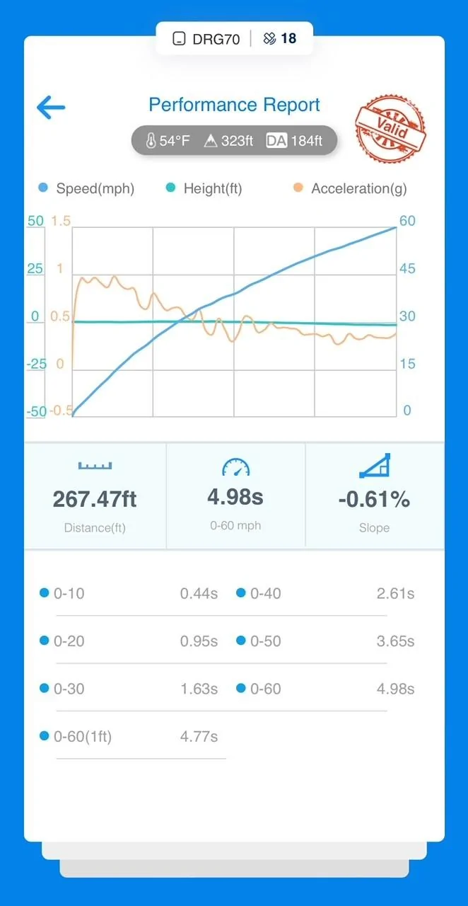

[UPDATE 2/4/24]
Was not expecting this, but was able to achieve 0-60 in under 5 seconds. This was in part by using E30 mix for fuel and getting a solid launch in normal mode without wheel hop.
Ford Bronco 0-60 in 4 Seconds - My 2.7 Bronco Performance Modification Thread 4.98

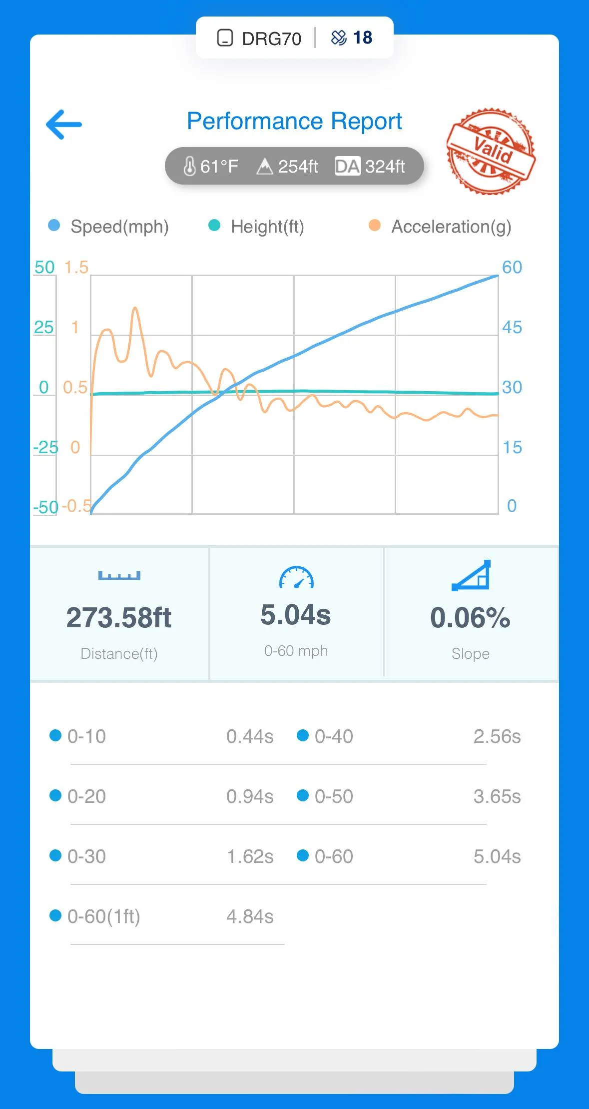

[UPDATE 2/16/24]
Okay, so I've had some fun testing the Pulsar XT and Ford ProCal Tune combo. Still working on my standalone Pulsar XT review, but I'll post my results and thoughts with the two stacked together here.
Running 93 Octane + Ford ProCal tune & the Pulsar XT set to level 5 I ran the 0-60 time below.
The best run I had was 5.04s, but I experienced wheel hop.
Ford Bronco 0-60 in 4 Seconds - My 2.7 Bronco Performance Modification Thread IMG_1039

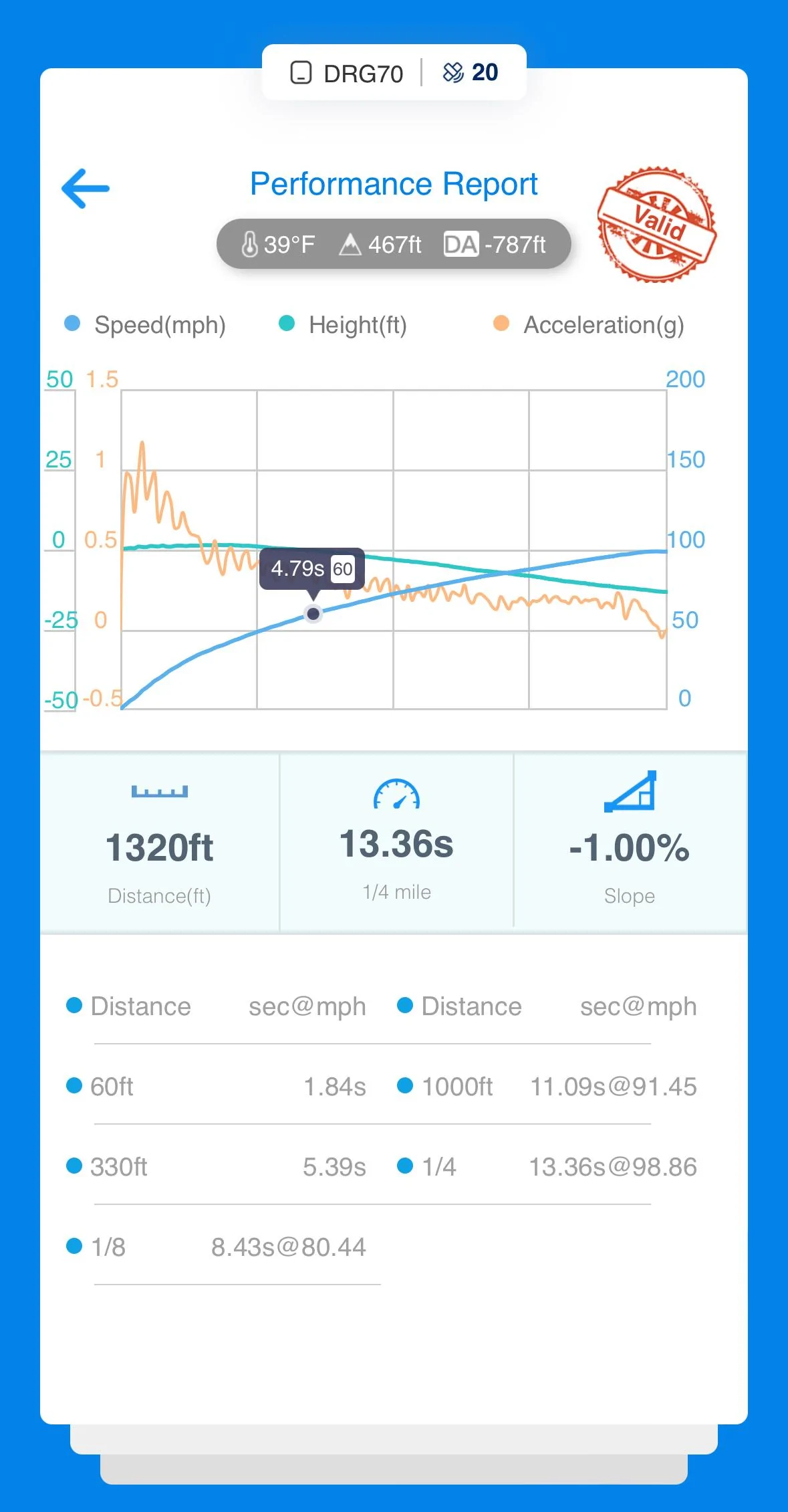

Same setup as above, but with a mix of E30 fuel.
4.8 Seconds! Crazy for a five thousand pound shoe box on 35's :)
This combo is faster vs. The RaceChip S and ProCal tune, though I would rather daily the RaceChip since it doesn't retard the timing as much as the Pulsar XT.
I won't daily this combo, but wanted to share my experience with the two stacked together.
Got even better times, thanks to the cold weather
Ford Bronco 0-60 in 4 Seconds - My 2.7 Bronco Performance Modification Thread IMG_1069

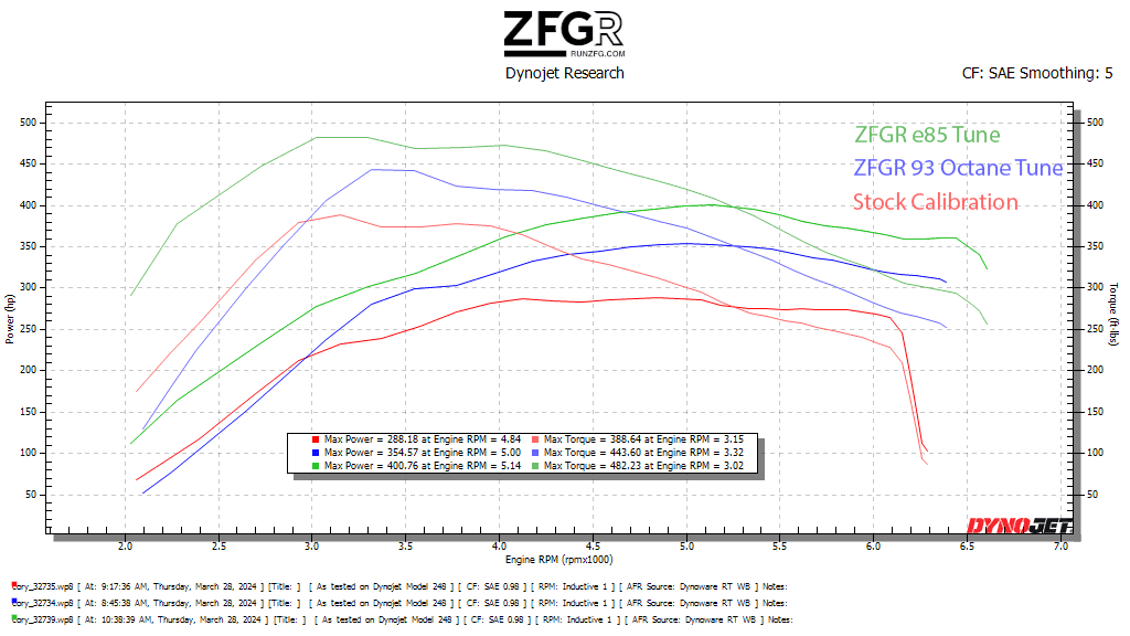

UPDATE 3/29/24
Dyno time :)
Ford Bronco 0-60 in 4 Seconds - My 2.7 Bronco Performance Modification Thread Dyno Chart
