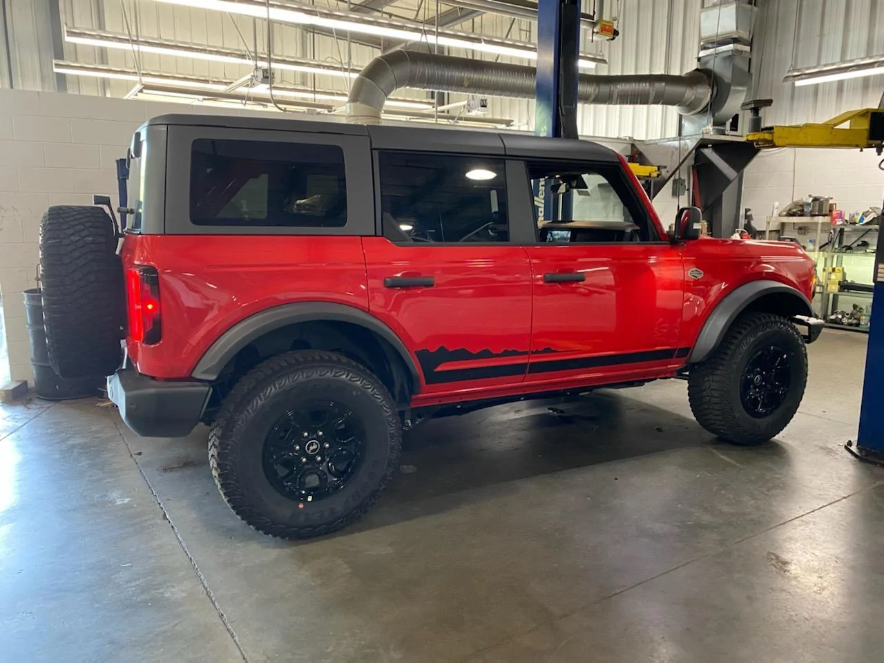

I didn't, but I'm sure there is some. I installed the JKS max tire clearance kit and cut off the crash bar sockets and that freed up a little unsprung weight in the front end. They come from factory with a nose down rake. Here's a pic of mine fresh off the truck sitting in the dealer garage and you can see the stance nose down.
