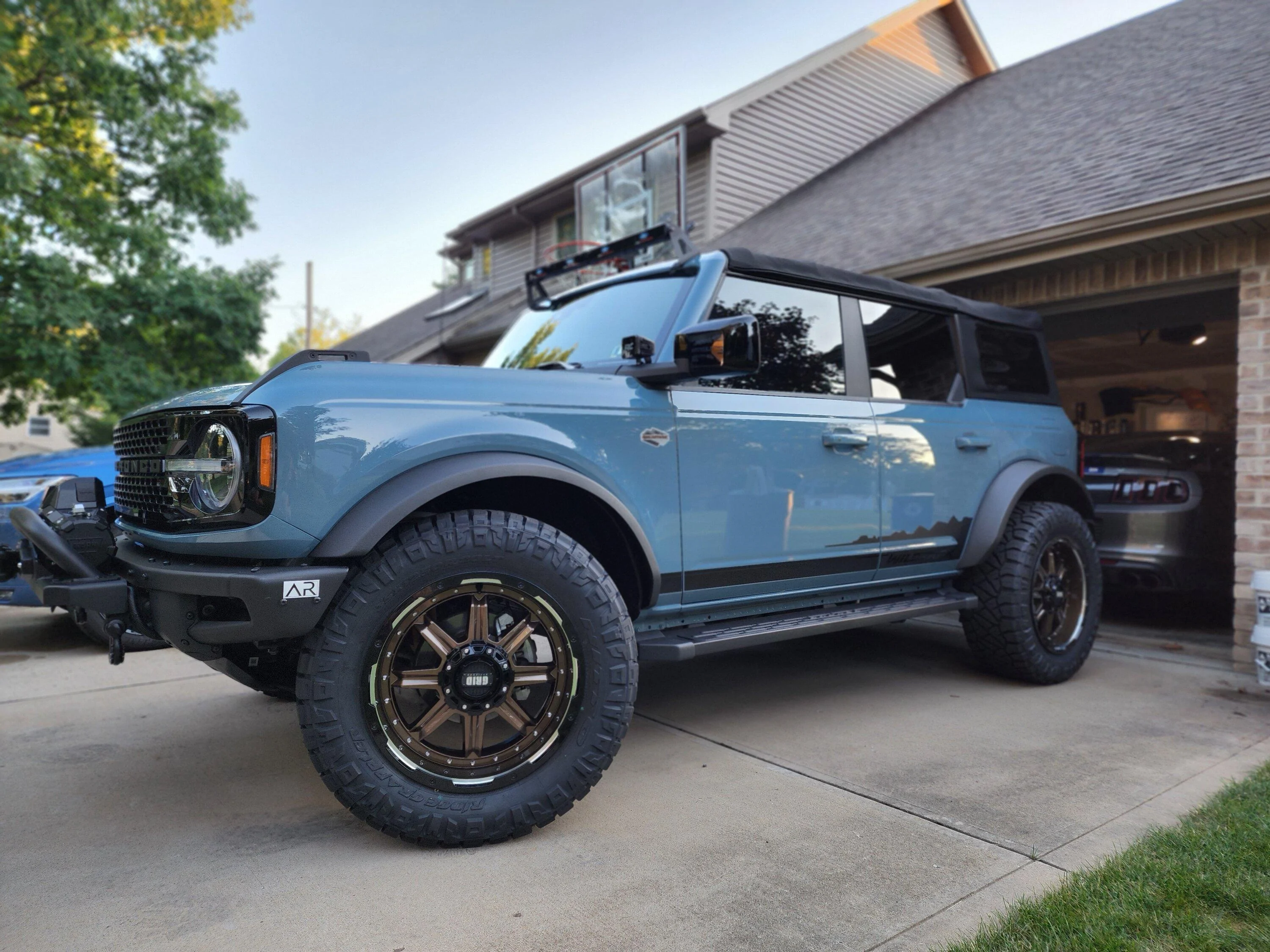

Here my SAS pkg with 20"x9" w/-12 offset wrapped in 35" Ridge Grapplers. Gave me a decent poke but nothing crazy. Pushed out a little more than 1⅜". I though about spacers for a second, but beings that the factory tires aren't true 35's my decision was made. Glad I went the way I did, almost went 37's...True 35's are mear millimeters away from rubbing inside wheel well at full lock.

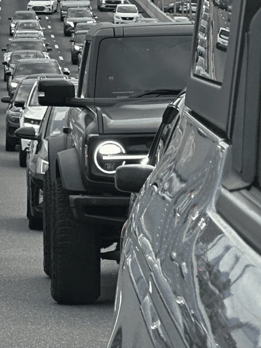

I spied a Black Bronco the other day with Sasquatch wheels plus what appeared to be a 1.5 inch spacer. Had a mean Sinnister look and I aprove.

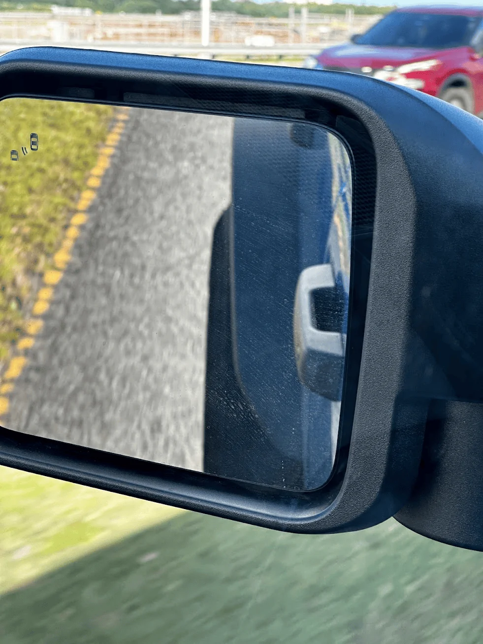

I'm running -10et Wheels and the poke is similar, here is a shot taken from my rearview mirror
