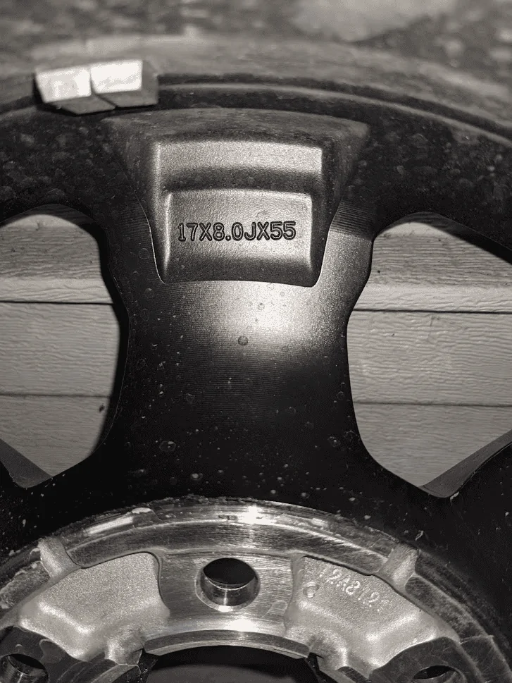

I would double check the 1.5" min size spacer. I haven't measure the studs on the Bronco but I do know the back of the optional BL wheels have pockets where it can accept some stud poke if you will. I was initially going to run spacers on those wheels so I could push them out and run bigger tires but have since changed plans. I would recommend Bora spacers.
Optional BL wheel where you can see the pockets between the lug holes.

Did you happen to measure the depth on those pockets? I'd like to get a 1" or 1.25" at the most spacer.
I have not. I have 1" spacers that I had planned on running until my build changed so I never installed them.

Yep, 1.5" from CJ Pony parts. So far, so good. Coming up on time to recheck the torque but they haven't loosened on any previous checks. With the 315's on the stock BL wheels it gives about 2" of poke from the stock flares... you will get very dirty
Edit just to say you won't have any issues fitting a 1" with factory studs., my factory studs sit flush with the spacer and those pockets on the back of the BL wheels look about .5" deep, eo you'll clear without any trimming.

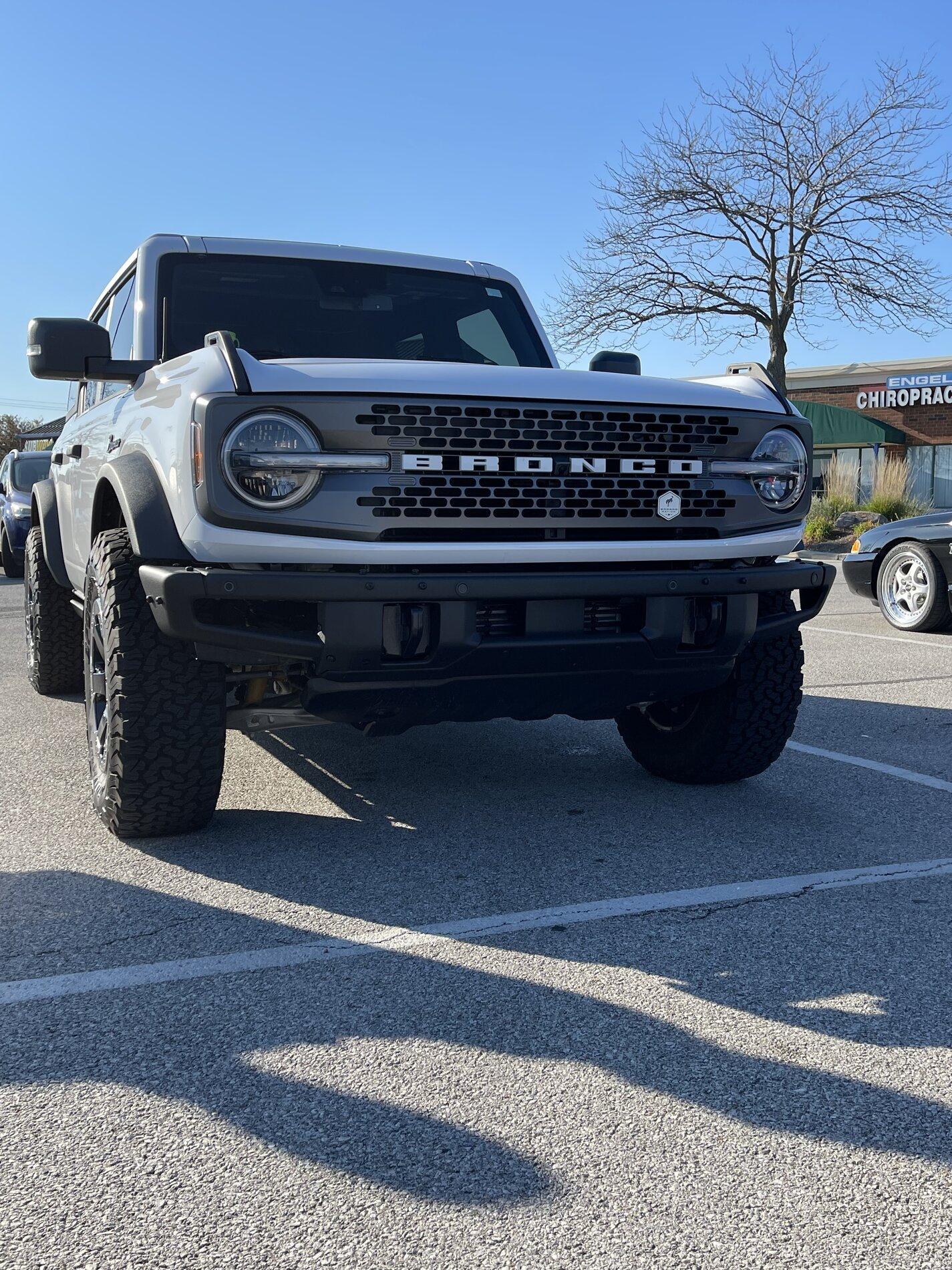

Ford Bronco 1.5" Wheel Spacers on Sasquatch? 20220129_162739
Was taking a picture of my fogs here but you can see the poke with the tires/spacers
