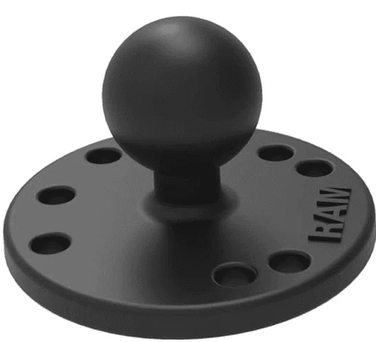

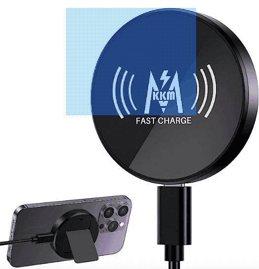

On the other end, I have a Magnetic Cell Charger attached with epoxy to a Ram Ball on a round plate. For around town, I've had no problems with my phone staying put.... but I don't think it would do so great off-road. (The magnet part, I'm sure the epoxy is solid.) I used this on my expedition and work car for a couple years now without any issues.

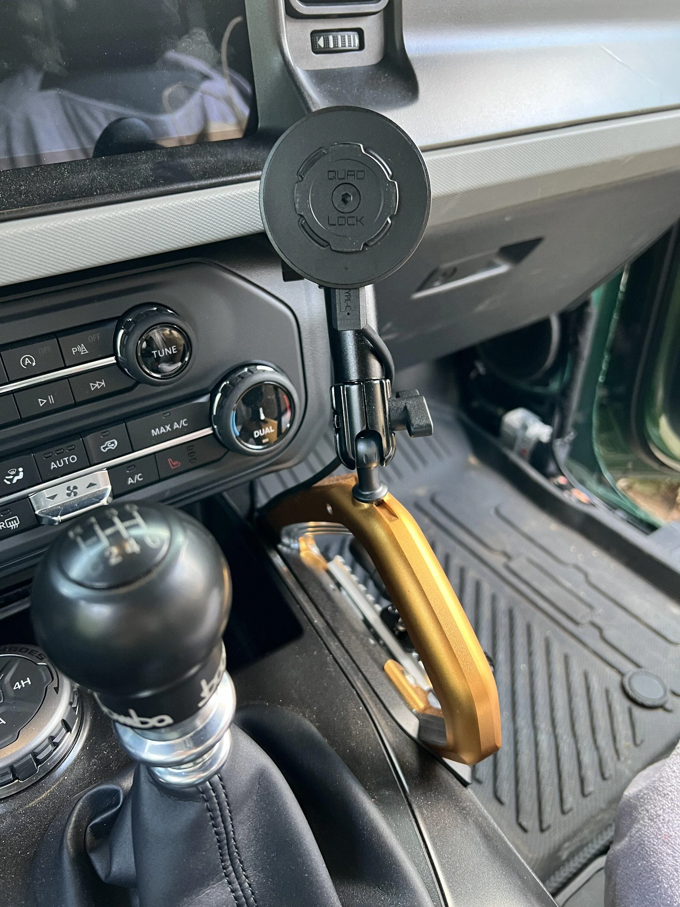

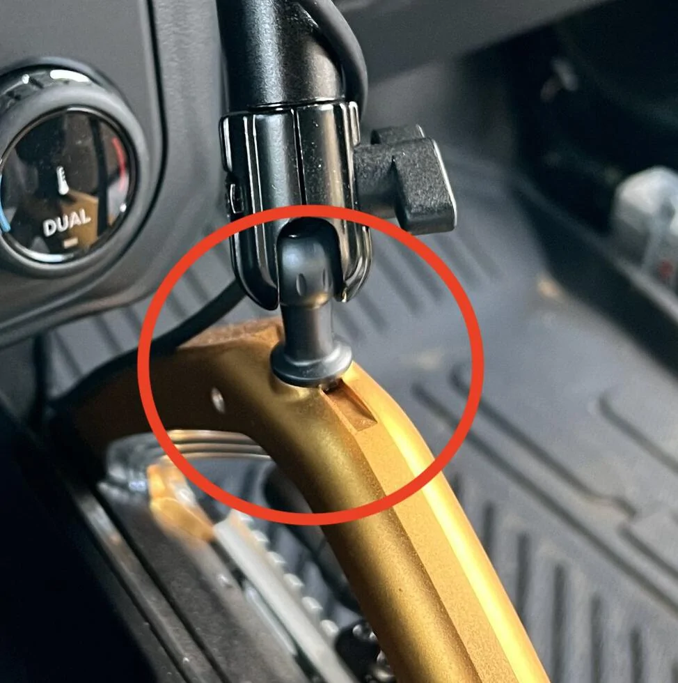

How is this part happening? Bolted on, special hand grip, unicorn dust?

that's from Archetype Racing, stupid expensive....and you get to deal with their customer service. So buyer beware.

It's not expensive if you like quality parts designed and manufactured in the USA.
In addition, I have contacted AR multiple times and have never had an issue with their customer service, so take a look in the mirror for the problem.

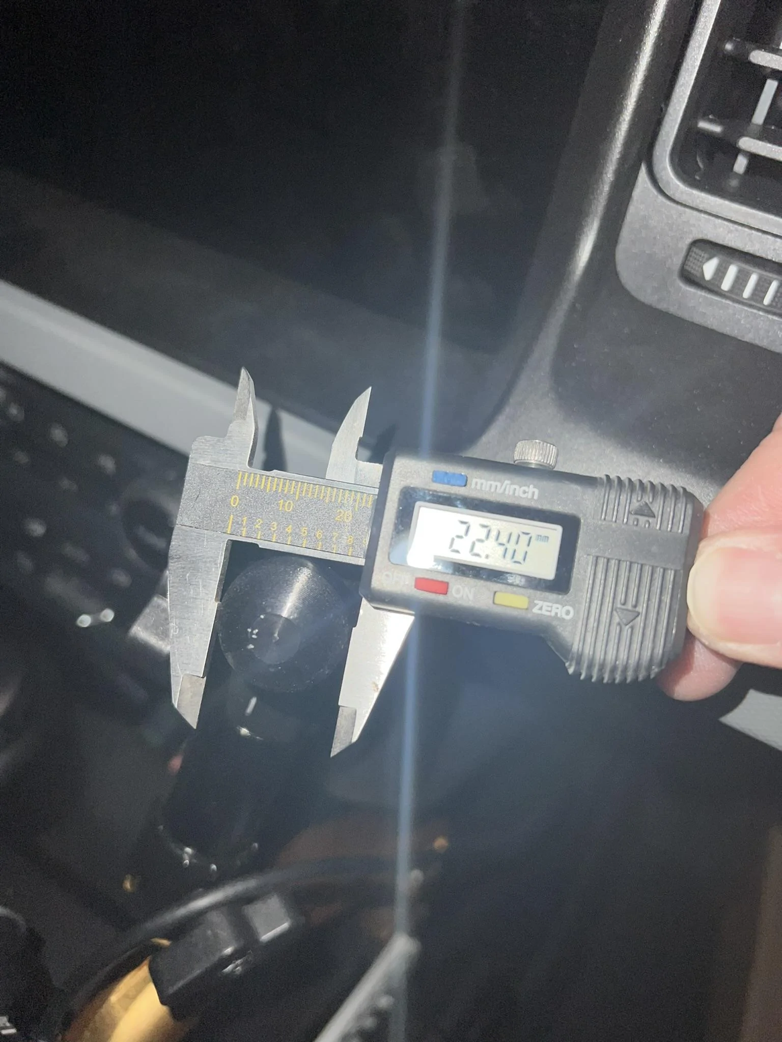

Which size ball is on the back of the quad lock mag charger?
I think it’s 22mm, but I’ll measure it tomorrow when I get home to be certain.

the common ones are 17mm, 20mm, and 1”
Yeah, I might be using an Archetype 20mm, but keep thinking it’s one of the 22mm ones that I have. Will check this evening.

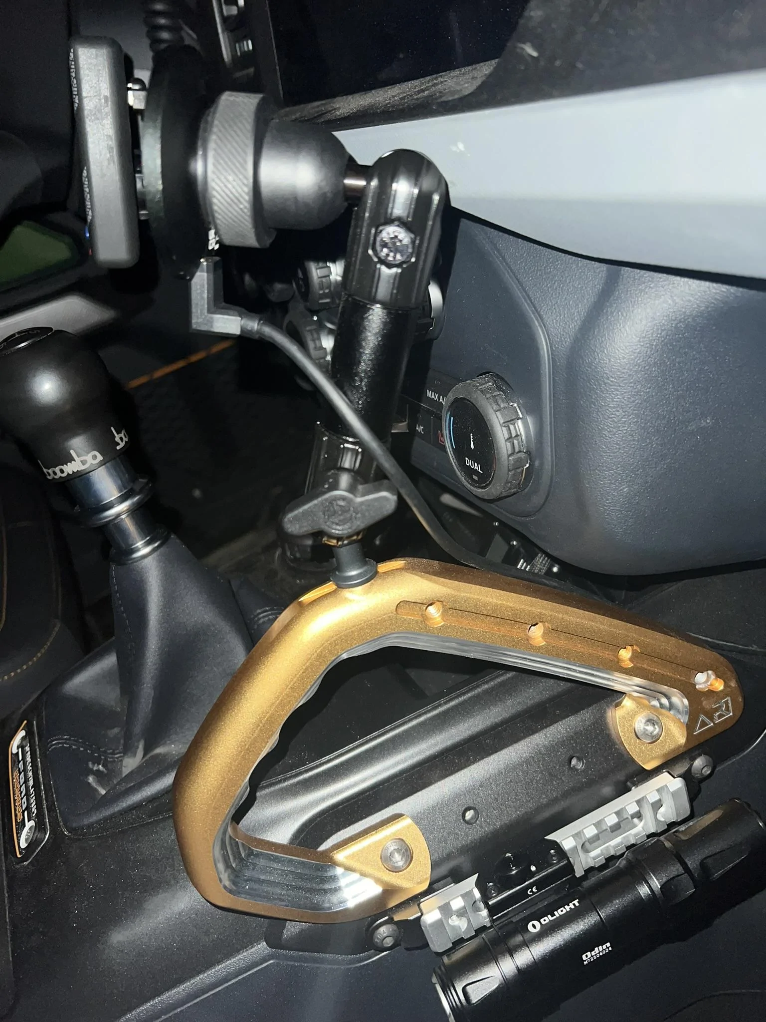

Tom,
So it turns out the Quad Lock is ~22mm. I purchased this Tackform assembly along with a Quad Lock's Adhesive Dash/Console Mount to build the correct stack. I used one of the Archetype's (@EIGHTLUG) 20mm balls on their D handle as the base. Solid connection even when going fast over the bumps and jumps.
Important note, I purchased the Adhesive Dash/Console Mount with the standard wireless charging head, not the MAG wireless charging head. The standard wireless charging head provides a much more secure mounting point than the MAG version.
Pics below for reference...
