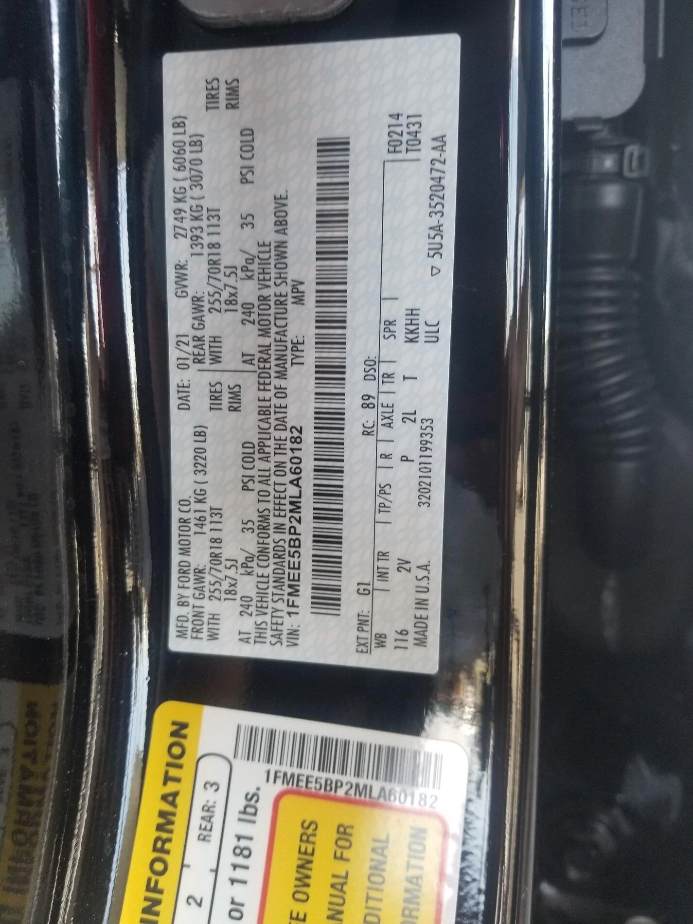

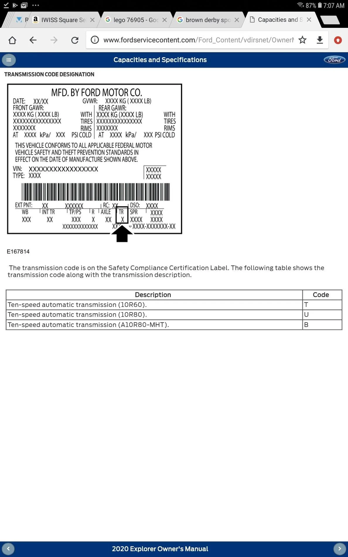

Updated 5/14/21 with confirmation from the Ford parts system:
Source: https://www.bronco6g.com/forum/threads/2021-bronco-parts-department-catalog-is-up.16634/post-603373
What's the transmission replacement part?
10R60 or 10R80?
Original post:
Am I the only one that was under the impression the Bronco was getting the 10R80? I looked back and all of the discussions I think just assumed as I could not find a reference from Ford stating what specific model would be in the Bronco. I don't know all of the differences between the 80 and the 60 but it just feels funny to have an Explorer transmission in an HD off road machine. I will withhold judgement for now.

First bit of solid evidence I've seen. Any chance we know exactly what spec Bronco that door jamb sticker is from?
Extremely disappointing tbh.
The Ranger gets the 10R80, but the heavier Bronco with larger tires get the 60?

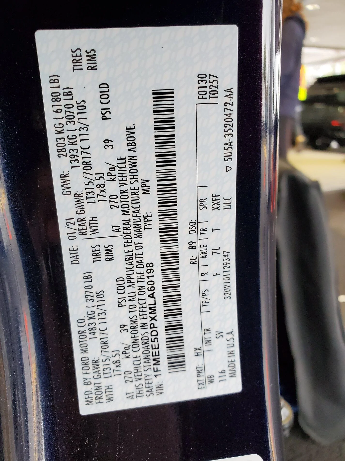

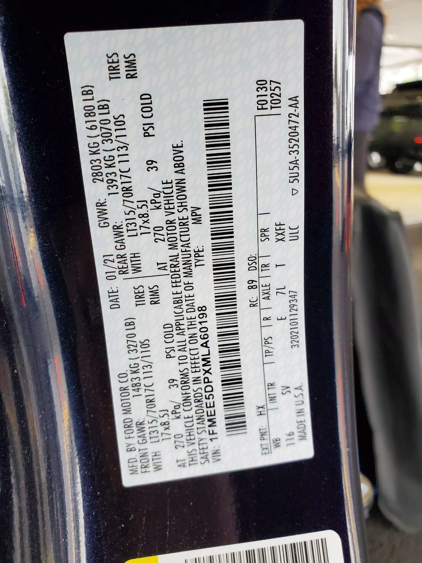

is it possible the 10R60 would be for the smaller engine and the 2.7 would get the 10R80?
I had the same thought since Ford did something similar with the front axle but they have been pretty clear about that since the beginning. It seems odd Ford has not come out and clearly stated what transmission will be fitted, at least from what I have found.
Maybe people can keep an eye on the data plates as these trucks make their way around.
I should have paid more attention to that. I tried to find the most recent photo so this is one of the Broncos that is currently on dealer tours. I think it is a 4 door OBX.
