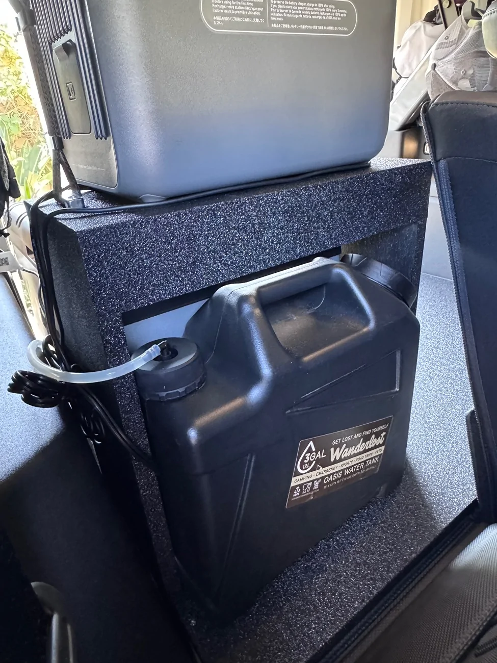

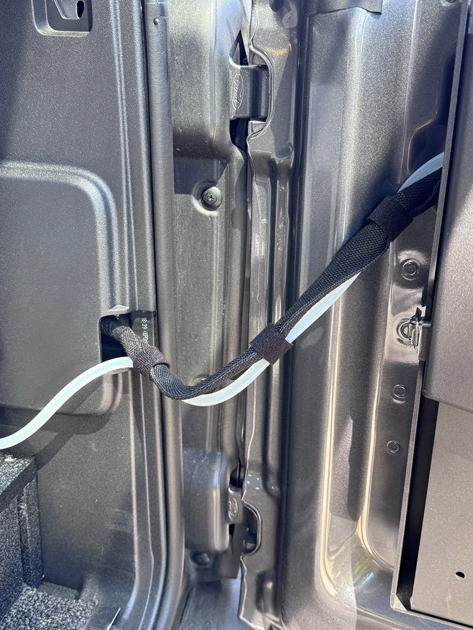

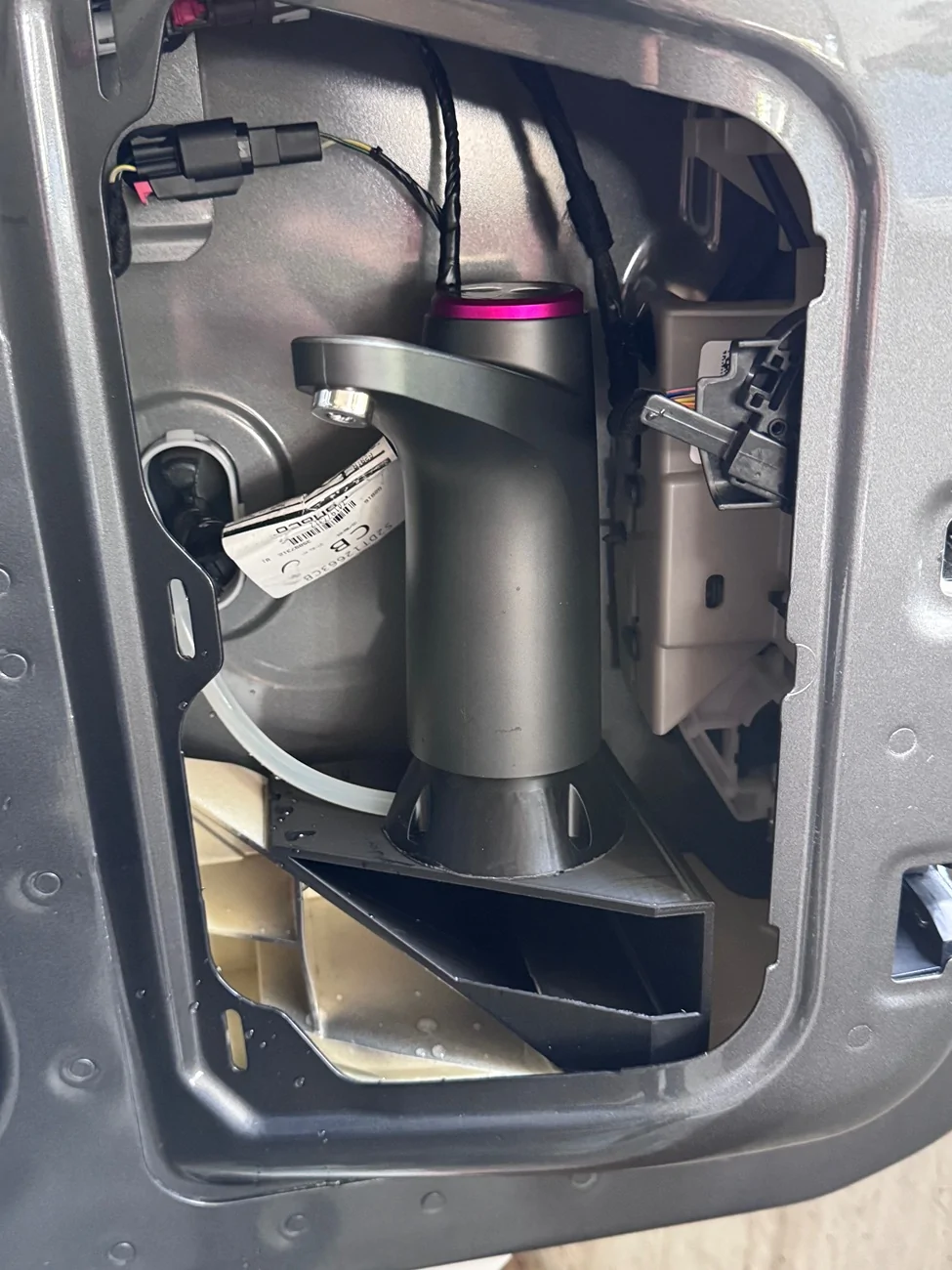

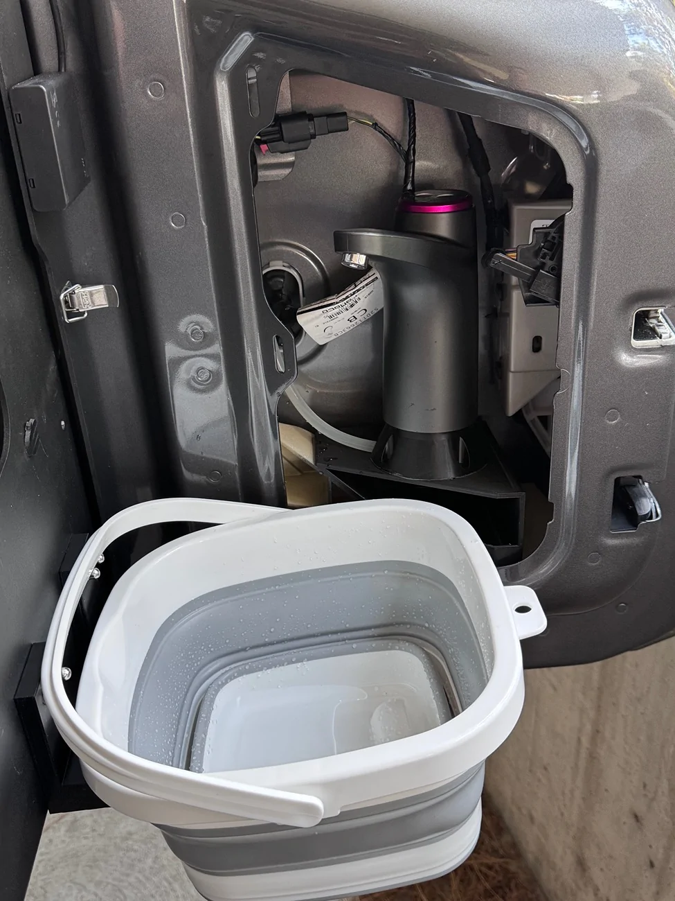

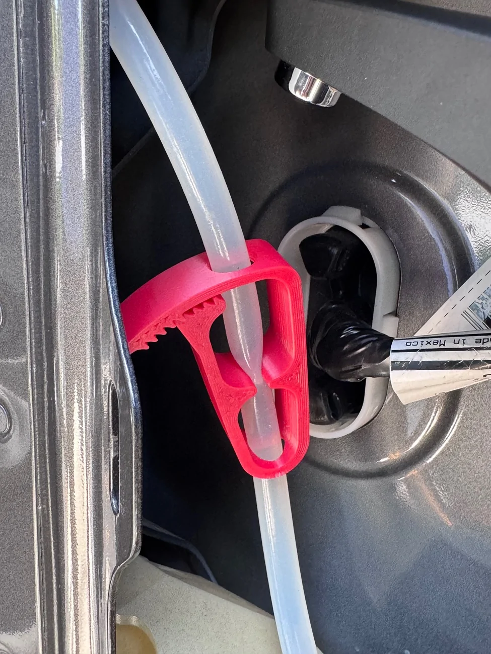

Wanted to share a rechargeable faucet I added to the inner space of the tailgate trim. I 3D printed a hinge, a door pull, tube clamp (to prevent siphon drip), and a shelf and base for the faucet. I ran the silicon tube through inside of the tailgate, then to a 3 gal. tank in the back behind my refrigerator. In addition, I also added hooks on the side of my tailgate table to hold a collapsible bucket as a sink.

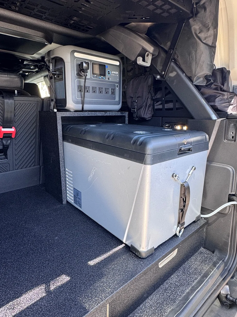

Heck, yeah. Nice work. Did you also 3D print the stand that supports your PPS and serves as storage for the water canister?
rodmach1
Rod
Sep 6, 2025
Irvine, Ca
2025 Ford Bronco Badlands Sasquatch
That’s actually wood covered in textured vinyl wrap, same as the deck with the 2 drawers

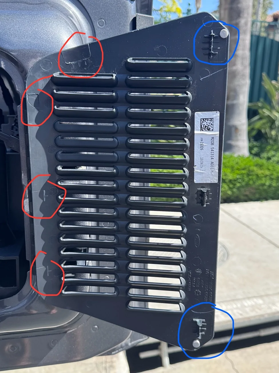

NICE!! I like that hinge setup @rodmach1 - how did you attach it to the tailgate? And, I assume you just snapped off the tabs that hold it in place. I have a lot going on in my tailgate and an easy access solution like you developed would be super helpful - can you please share the STL file via DM? Thanks in advance!

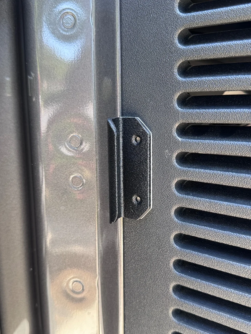

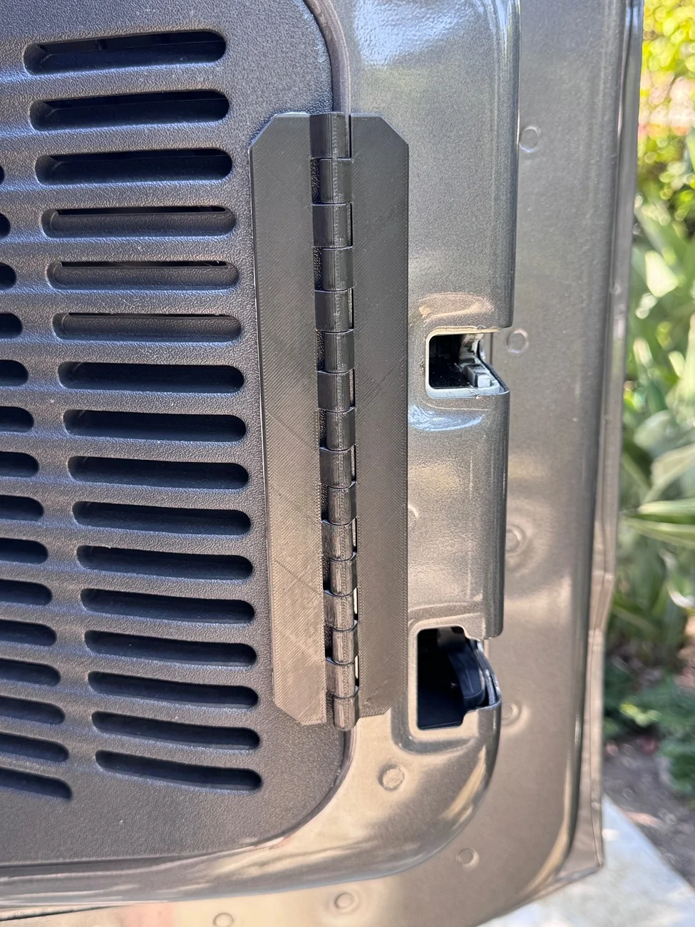

Hey, thanks. Yes I snapped off the tabs on the left side (pictured in red circles) and the top. On the right side (pictured) I removed the 2 of the 3 metal “spring clips” leaving the middle as the “catch” while the other 2 acted as an alignment guide the added 2 foam bumpers to prevent rattling
Ford Bronco Refillable Water Faucet for Tailgate / Cargo Area - DIY and 3D printed parts IMG_1099
. I did pinch the metal clip for the middle to make it easier to open but strong enough to hold closed. All held on with gray 3M tape. Other double sided tape did not hold well with heat, I just didn’t want to drill into the trim if I didn’t have to. I’ll add a picture to see how I did it and link the 3D files which came from Bambulab.
Handle: https://makerworld.com/models/1230633
Hinge: https://makerworld.com/models/963256
* a buddy of mine filled in the screw holes and I cut the corners after printing to match the trim panel

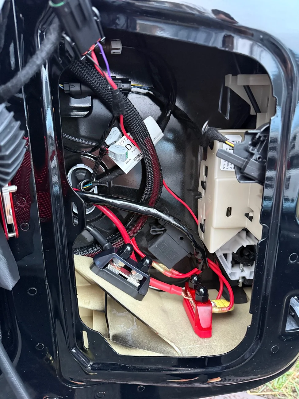

Thank you - I think a couple of rivets instead of 3M VHB to attach the hinge would be a better solution.
I have a dual ARB compressor mounted behind my spare, chase lights and a 6” light bar on my tailgate so I installed a separate power distribution block IN the tailgate. I have power control for the compressor & switch to change the strobe pattern for the chase lights mounted on that cover so better access would be great and your solution is near perfect!
Here’s a picture of what’s inside…
