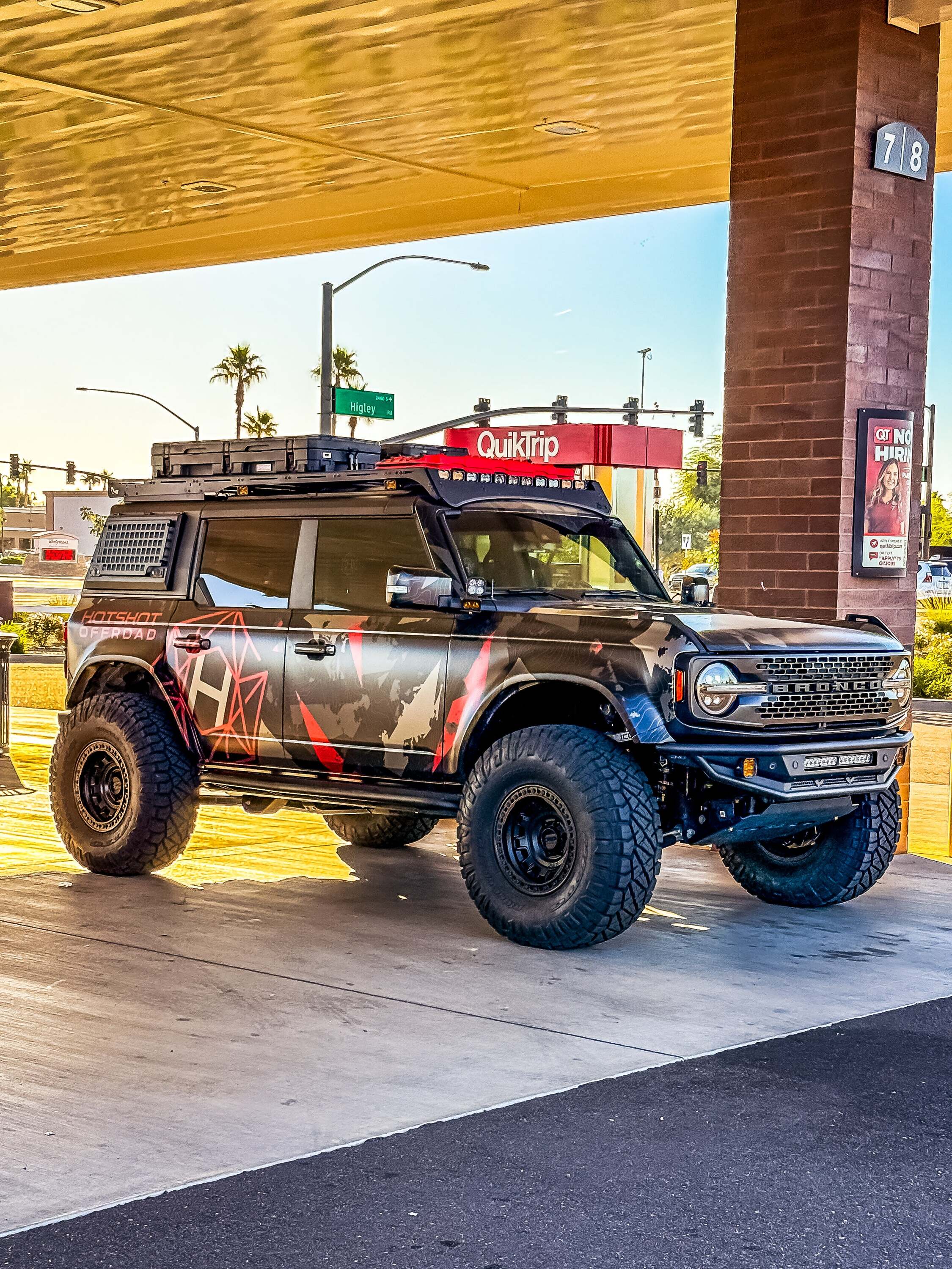

We have our full build break down live! Hit the link here to check it out on our website or feel free to review it all down below!
https://hotshotoffroad.com/blogs/builds/our-2025-sema-bronco-full-build-break-down
Custom-built by the two-man team at Hotshot Offroad, this 2023 Ford Bronco Outer Banks 2.7L made its debut at SEMA 2025 as a showcase of precision, creativity, and dedication to the off-road community. Designed and assembled entirely in-house, this non-Sasquatch Bronco represents the perfect balance of performance and aesthetics, combining trail-ready toughness with refined craftsmanship. Equipped with an Icon CDXS Stage 7 suspension, Ford Performance 4.88 drivetrain, and a full suite of Diode Dynamics lighting, the build demonstrates the depth of capability achievable through meticulous component integration. The Armadillo Designs custom aluminum hardtop, Anderson Composites carbon fiber body panels, and Pureblind custom vinyl wrap bring a distinctive, head-turning look to match its performance. From the Baer 6T performance brakes to the Ecoflow-powered Fridge and cargo system, every element was thoughtfully engineered to enhance both function and form—showcasing what a small, passionate team can achieve with vision, expertise, and relentless attention to detail.
Parts Overview Introduction:
To bring this Bronco to life, we at Hotshot Offroad curated a premium selection of components that blend proven performance with custom fabrication. Every system—from suspension and lighting to armor, drivetrain, and interior—was upgraded or reimagined to elevate the vehicle’s capability and presence. What follows is a complete breakdown of the build, detailing the high-end aftermarket parts, innovative installations, and one-off custom touches that make this truck a true showcase of craftsmanship and off-road engineering. *You can click any/all hyperlinks to check out the product(s) listed on our build list. Please also note a full gallery of this build will be uploaded shortly.
2023 Bronco Outer Banks 2.7 Non Sas Build List
Suspension Components
  • Mikellis Body Lift Kit
Lighting
  • Diode Dynamics SSC2.0 Max Custom made Crosslink Roof Rack Light Bar
  • Diode Dynamics RGBW Rock Lights
    • Hardtop Gullwings: 2 RGBW rock lights custom designed to fit inside of our hardtop gullwing that activate when a wing is opened
    • Cargo Area: 2 RGBW rock lights Custom installed and activated via switch to provide more light in the cargo area
  • Custom 3rd Brake light w/ Baja Designs Amber Rock lights
  • Full Custom wiring harnesses for all lighting components
Armor
  • RCI Full Skid Package
    • Engine, Transmission, Cross Member, Cat Guards, Fuel Tank, Rear Diff, Front LCA, Pinch Weld Guards, and Rear Shocks
Performance Components
Exterior Components
  • Anderson Composites
    • Carbon Fiber Hood
    • Front Fiberglass 2” Rise, 2.5” Fenders
    • Rear Fiberglass 2” Rise, 2.5” Quarter Panels
  • TrailRax Roof Rack w/ Custom mounting Plates
  • JCR Engine Engine Cover
  • ARB Tred Pro Recovery Boards w/ quick release mounts
  • Custom Designed Vinyl Wrap designed and printed by Pureblind Wraps and installed by HM Designs in Tempe, AZ
Interior Components
  • Stereo
    • Focal Fiber Speaker system w/ Custom tweeter mounts and crossovers
    • JL Audio Amplifier
    • Audio Control Tailgate 12” Subwoofer
    • MTI Acoustics Amp/Crossover Mounting Plate
  • Wolfbox G900 Tri Pro Smart Mirror
  • Custom Cargo Slide Out
    • Featuring custom cut extruded aluminum for storage
    • Rhino Lined Cargo floor with lift up portions to access factory storage below
    • Custom built fridge slide/shelf featuring the Iceco IPT20 Fridge
    • Ecoflow Delta 2 Power Bank
    • Sidio Crate Storage Crates
    • On Demand Air System
      • ARB Twin Compressor
      • Apex Designs Compact Reel System (CRS)
      • Apex Designs Precision Tire Inflator
      • Adventure Labs CRS Mount
Wheels and Tires
  • Nitto Ridge Grappler 38x12.5r17 Tires
