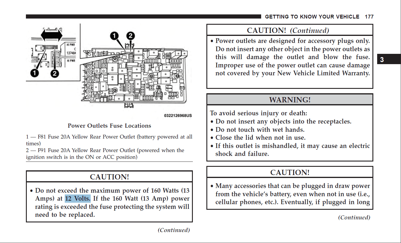

On my Jeep JLU, there is a fuse which can set to a specific location to do that. I hope that would be available on the Bronco as well.
