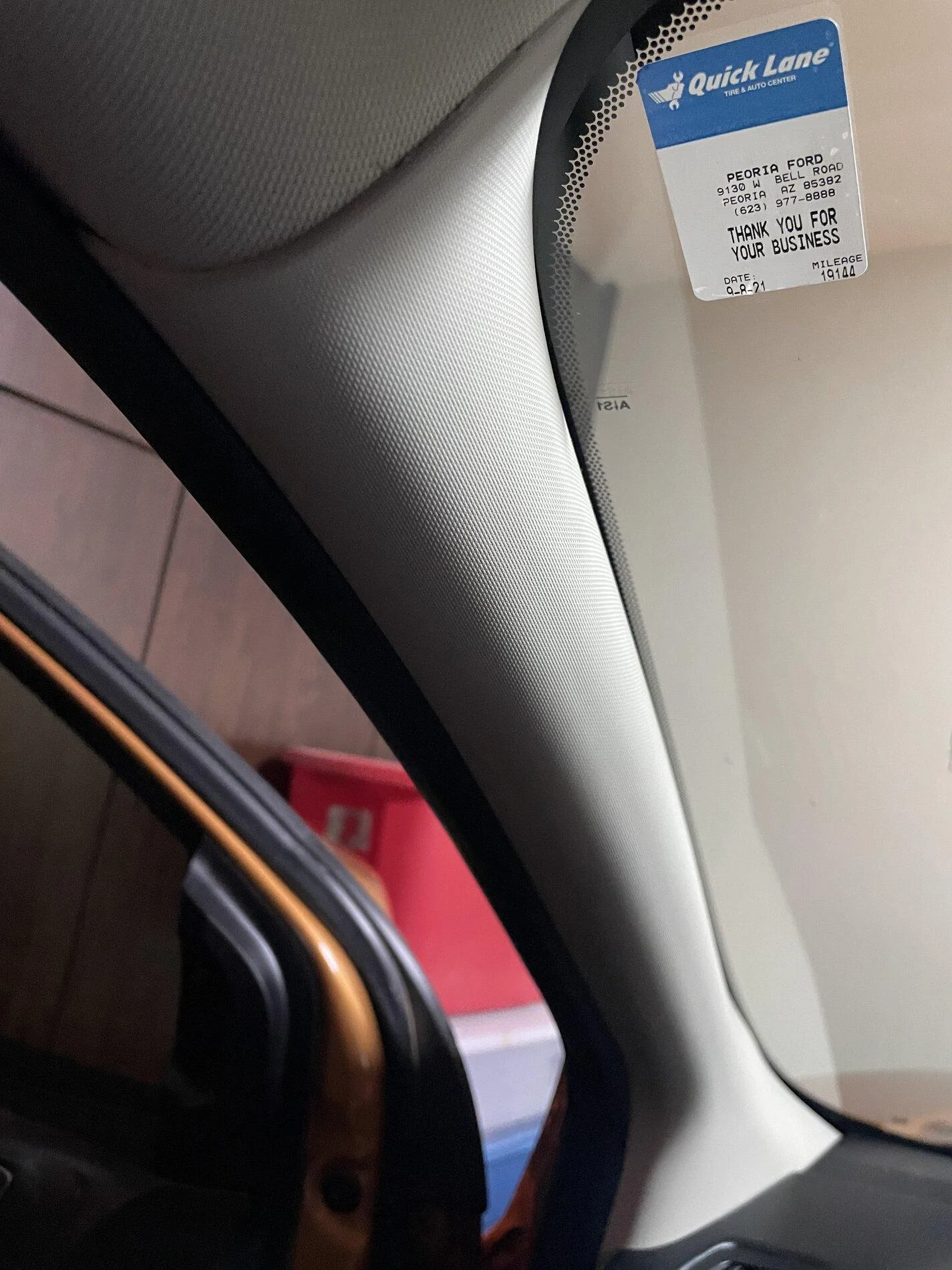

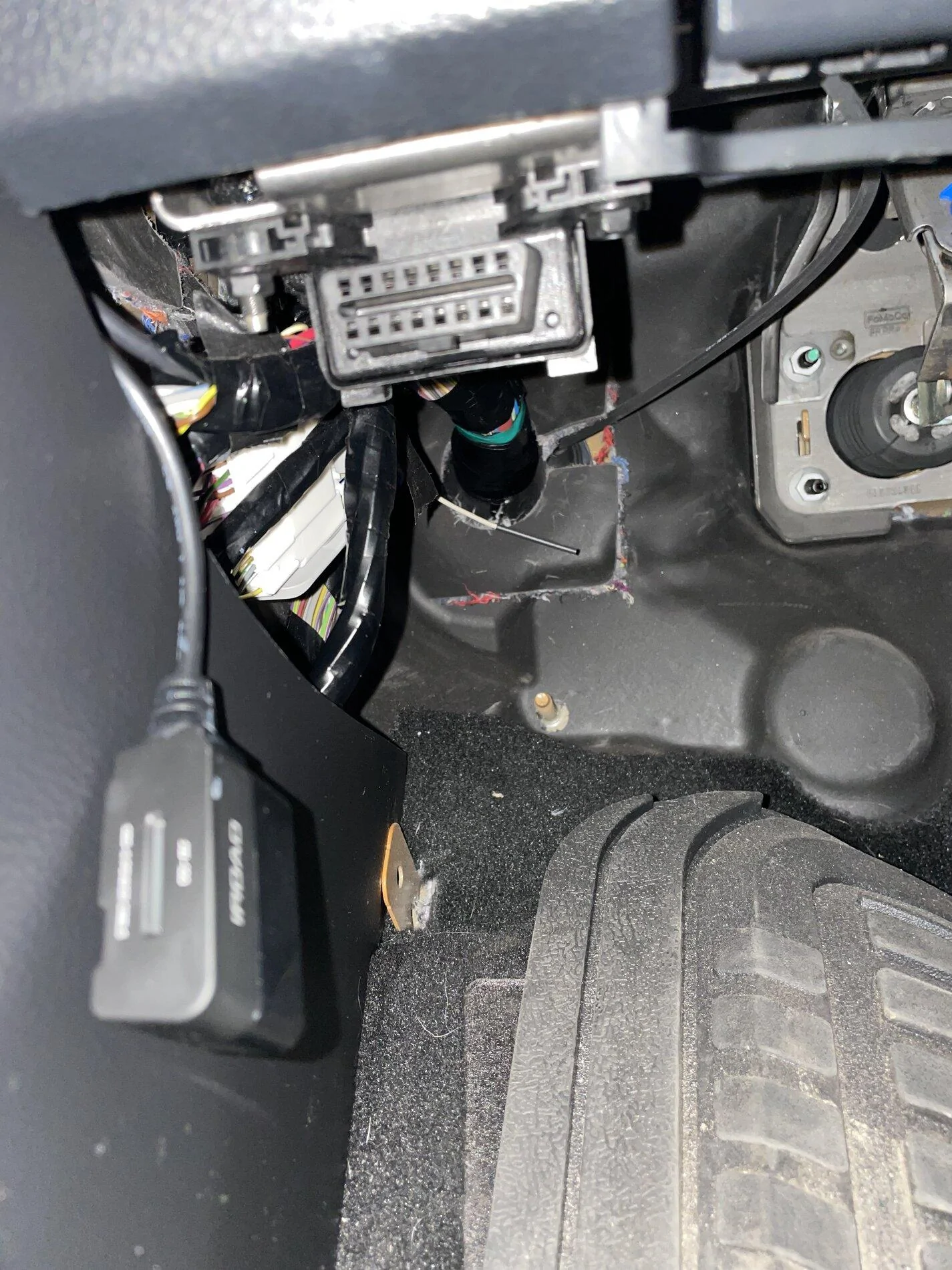

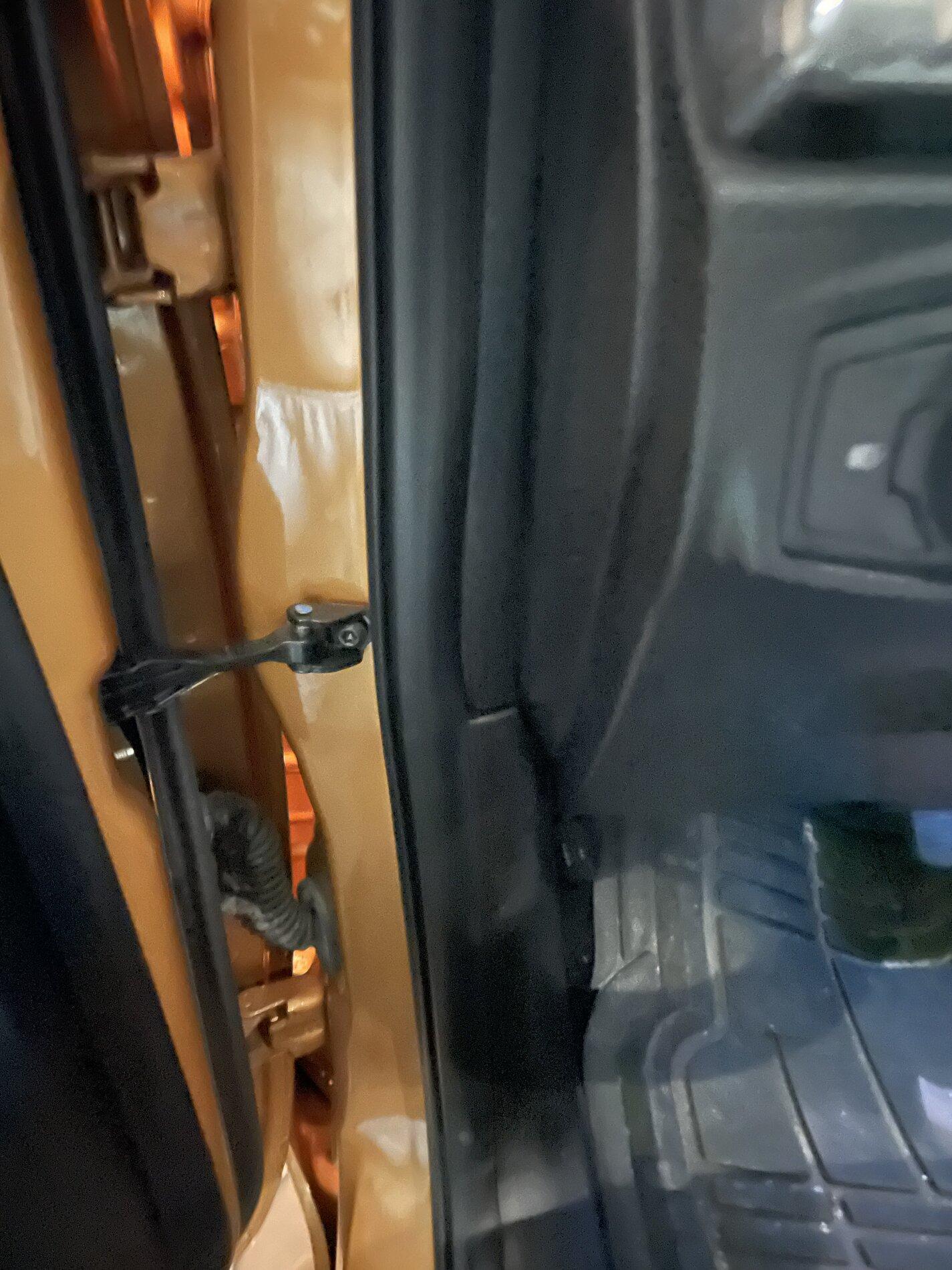

You can check on Amazon here to see if there's a ODB cable compatible with your dash cam. It's a super clean install and everything is hidden away. This is in my Ranger but I'm sure the Bronco will be just as easy and I'll be doing the same in mine if I ever get it. lol
Ford Bronco 12V Locations for Dash Cameras IMG_4216
I ran it down through the door weather strip and over where the plastic trim splits.
Ford Bronco 12V Locations for Dash Cameras IMG_4217
I have the parking module but I unplug mine when it's just sitting in the garage.

That is clean. Very similar to my wire concealment, except then I run under the dash to the climate control area.

Stupid question, but is there any issue leaving it plugged into the OBD and not unplugging it? I don’t have the need for the parking recording feature. Curious if anything can be harmed by leaving it hooked up. I never unplug mine from the 12V.
The ODB port is live constantly so there will be a constant draw if you do. I only disconnect it when I'm home. With the 12v it will turn off after 15-20 minutes so there's no need to always remember to unplug it.
