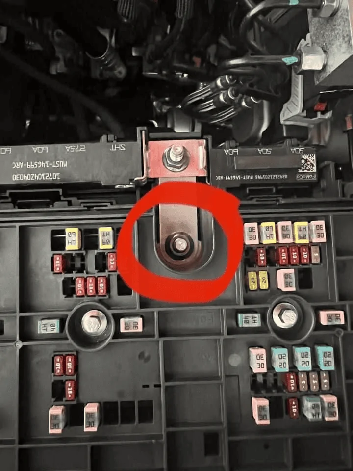

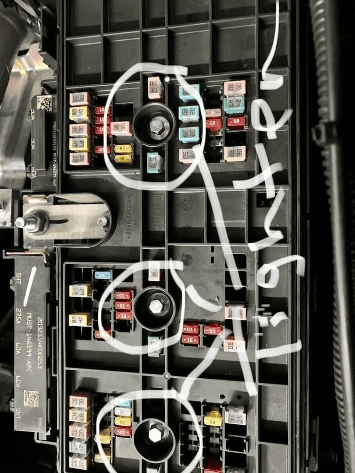

@jitsujohnny did you try tightening up the engine bay fuse panel grounding bolts? This was a common problem folks encountered on delivery. So much so, that a lot of us brought ratchets to the dealership to tighten these bolts before we drove away LOL
credit to @Ksjrb03 for being our in-house "TIGHTEN YOUR GROUND BOLTS" ambassador
