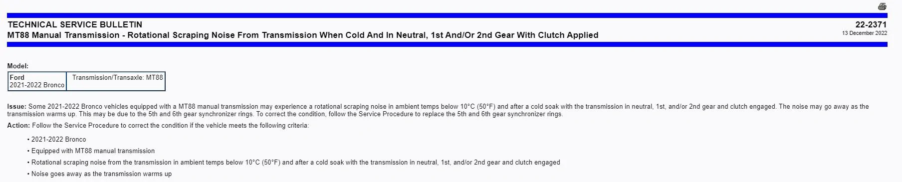

Brought my 22 Base into my dealer this past week for the first time. I've been hearing the TSB-like symptoms for a long time. It was a fairly warm day so I wasn't sure if they'd be able to replicate the noise, but called me mid-day to say they had and had already ordered the parts. Dealer stated they've done the repair on a "handful" of Broncos and have not had any return yet due to the noise coming back. Time will tell, but I hope it solves the problem.
My dealer replaced the transmission, however, they said they would not mess with the TSB.
Do you mind sharing the name of the dealer that is performing the TSB?
