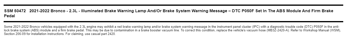

Part was shipped and installed! I picked her back up this morning. I'm back in the game baby! Took a bit of time given supply chain issues, but Ford and my dealer made it right.
If you're running into the same issue at the time of this writing the part number needed changed to MB3Z-2420-F. User flip posted the service announcement. I shared this when I initially dropped off my vehicle and it helped my service department given it's such a new vehicle.

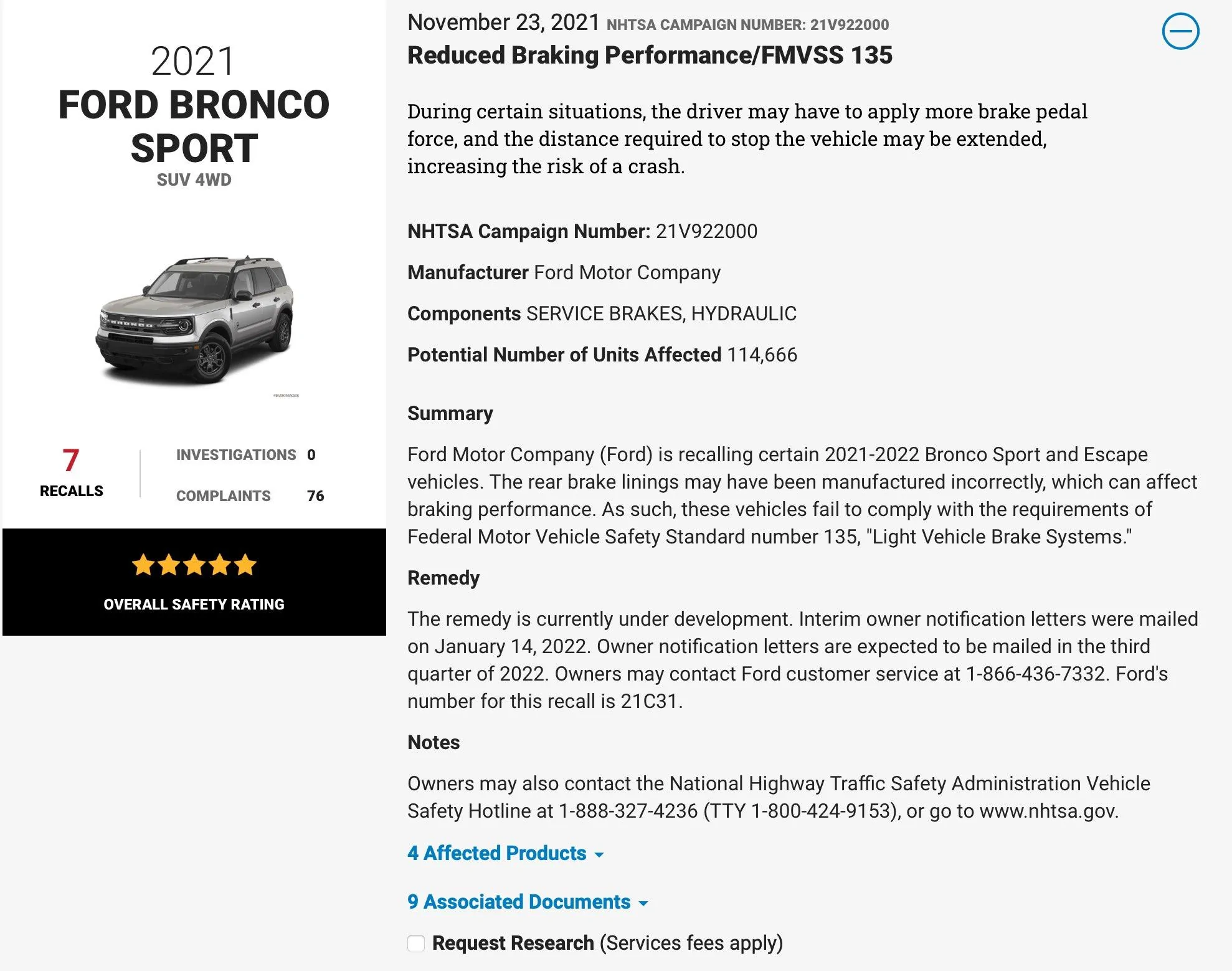

sorry for your trouble w this, and am not questioning the problem you've experienced
However at NHTSA site, I don't see a Bronco Sport recall w ' vacuum brake failure '
Bronco Sport has a recall for ' rear brake linings may have been manufactured incorrectly ' - ( below )
- affecting '21 & '22 Escape and Bronco Sport

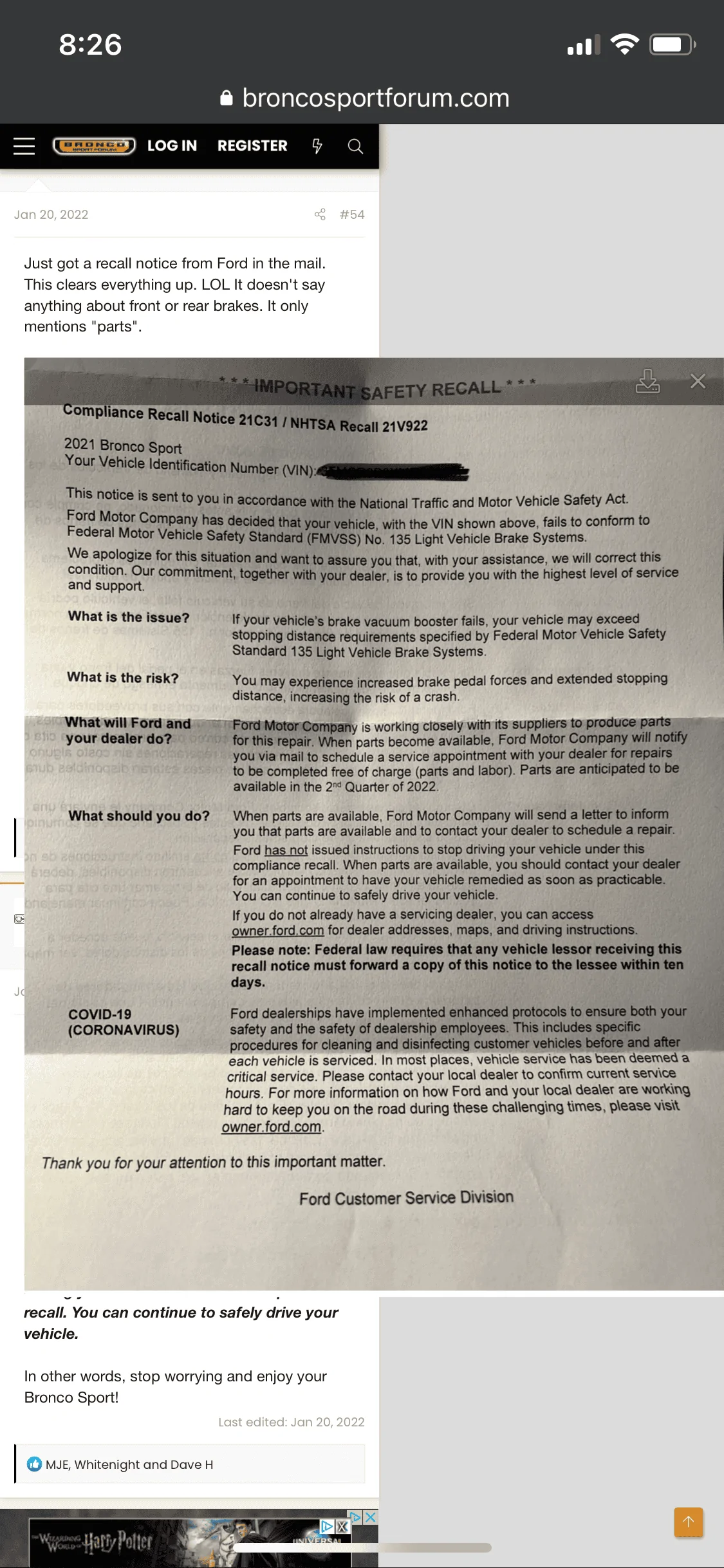

in the Bronco 2.3L vacuum brake boost problems it does seem that cruise control is involved, usually
I found this thread on the Bronco Sport forum and there’s widespread discussion there on vacuum brake issues. Not sure if it’s the same parts that are failing but it seems like it’s definitely related to vacuum brake boost failure reading the letter Baby Bronco owners received directly.
I could be wrong, just browsing the internet for answers.
Ford Bronco 2.3 vacuum brake boost failure 1660626378416

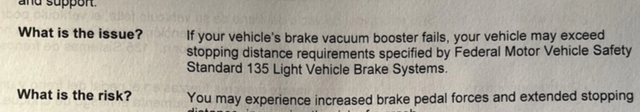

Specifically the line referencing what is the issue and mention of vacuum failure

it's interesting cause your printed page has the same NHTSA Campaign #, but the description at NHTSA website is very different
your printed page there definitely talks about vacuum brake booster failures in Bronco Sport
maybe the NHTSA website description is inaccurate ?
- they both have the same # 21V922
Ford Bronco 2.3 vacuum brake boost failure 84E4CB06-8770-403C-BAF4-E7418B8AD9DF
Yes, I saw that too. Agreed very strange. It seems what was sent to affected customers has more detail, and/or was slightly different? Not sure, but if you go on the sport forum very similar issue is being described.

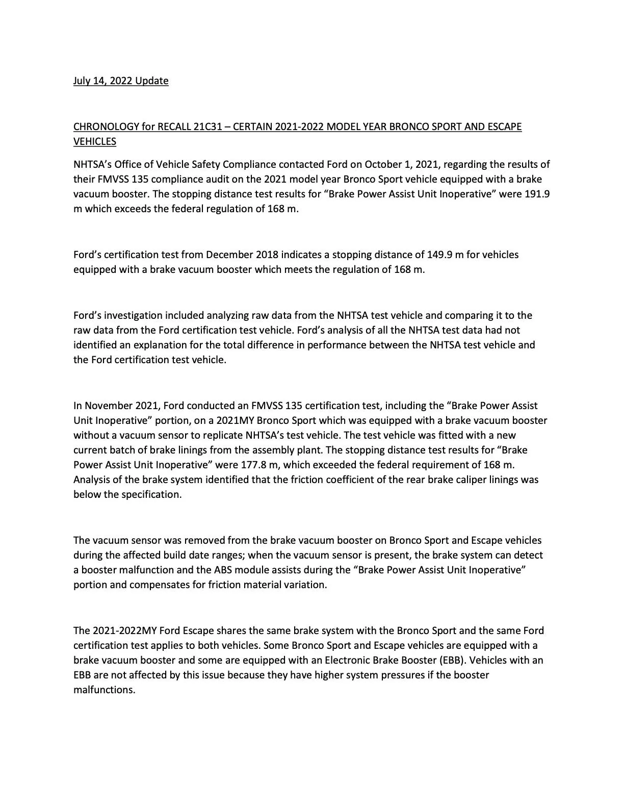

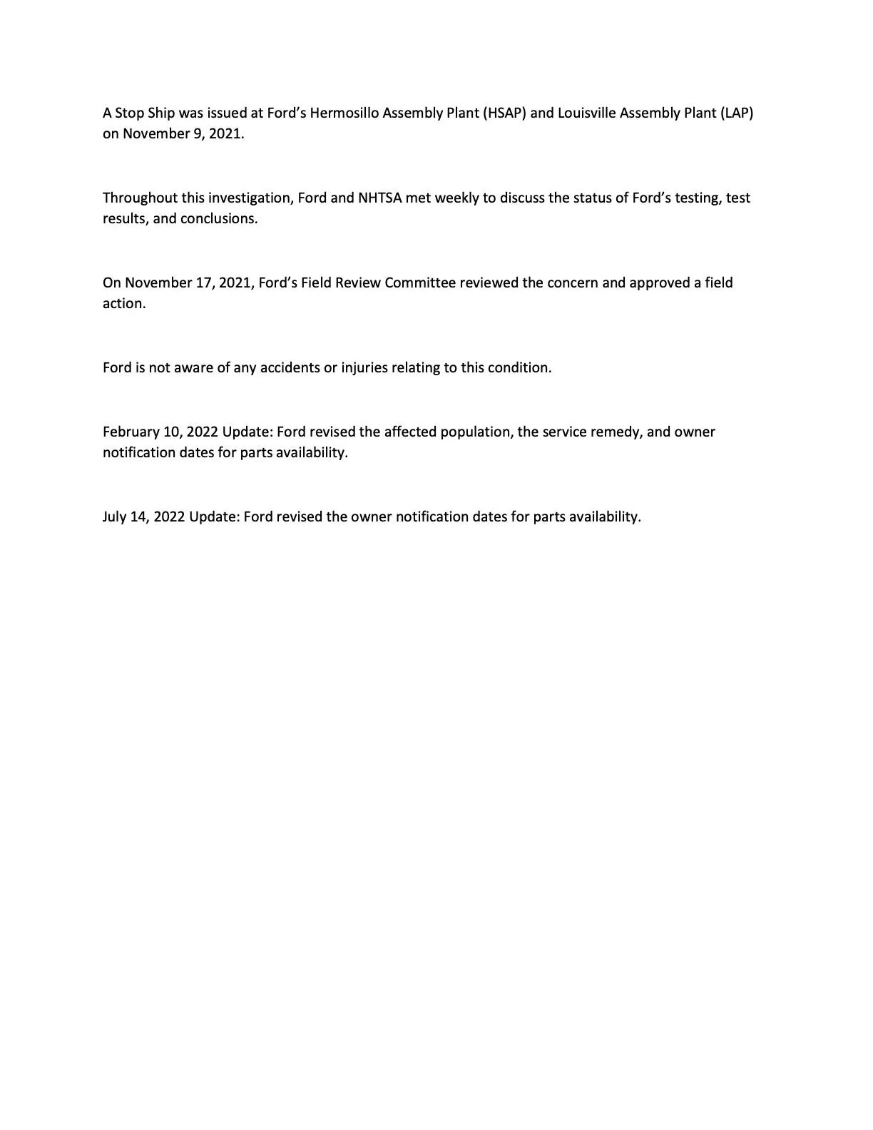

at NHTSA website here's latest update from July 14, '22
looks like they're having trouble finding root cause of long braking distances
- says July 14 Ford revised the owner notifications
looks sorta confused
Yes, a bit all over. It seems like it’s a failure in either the vacuum sensor, vacuum hose, or vacuum brake boost unit itself reading that. Which is about where I’m at with my full size Bronco. It could be either one of those three components from what I’m hearing from the dealers service department. Interesting that the notice mentions electronic brake boost vehicles aren’t effected.

If it's the same thing that happened to mine it's a known issue. Some of the 2.3's escaped the factory with "contamination" in the brake vacuum hoses. It's a quick fix, covered under warranty without question.

Yes, I found this a month ago and shared with my ford Service Department when I dropped off the vehicle. That part number is what I've now been waiting over a month for unfortunately. Now I'm just trying to find out if they have it in stock and how long it'll take to be delivered.
