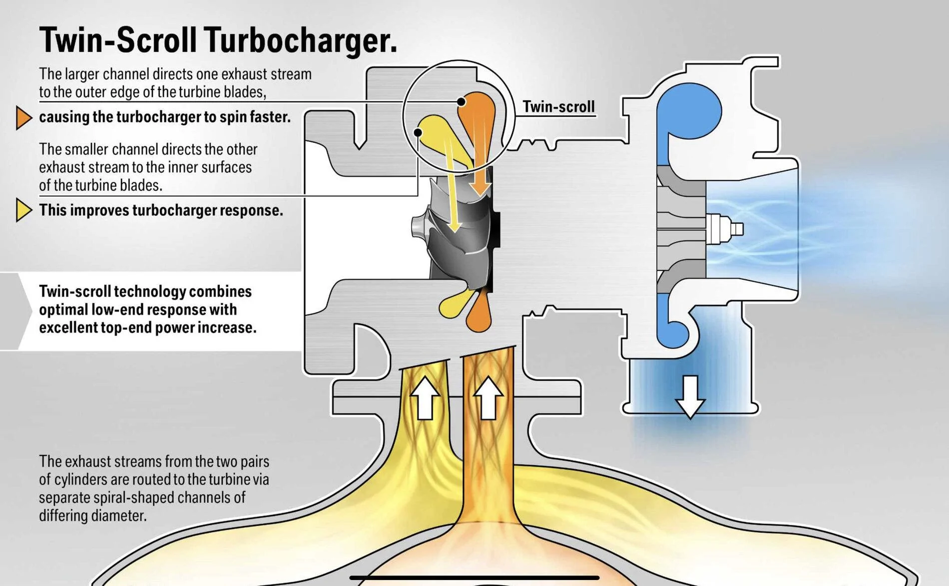

A twin scroll turbo is exactly what it sounds like, it has two inlets into the turbine, ...
The twin scroll in particular improves low RPM response due to the higher velocity in the scroll runners at some expense of high RPM flow.
Thank you, sir! You reminded me to look into this.
In case anyone wants more info on this design: http://www.whyhighend.com/twin-scroll-turbo.html
I couldn’t find a sketch of the Ford 2.3l turbo but this diagram shows the concept of twin scroll:
