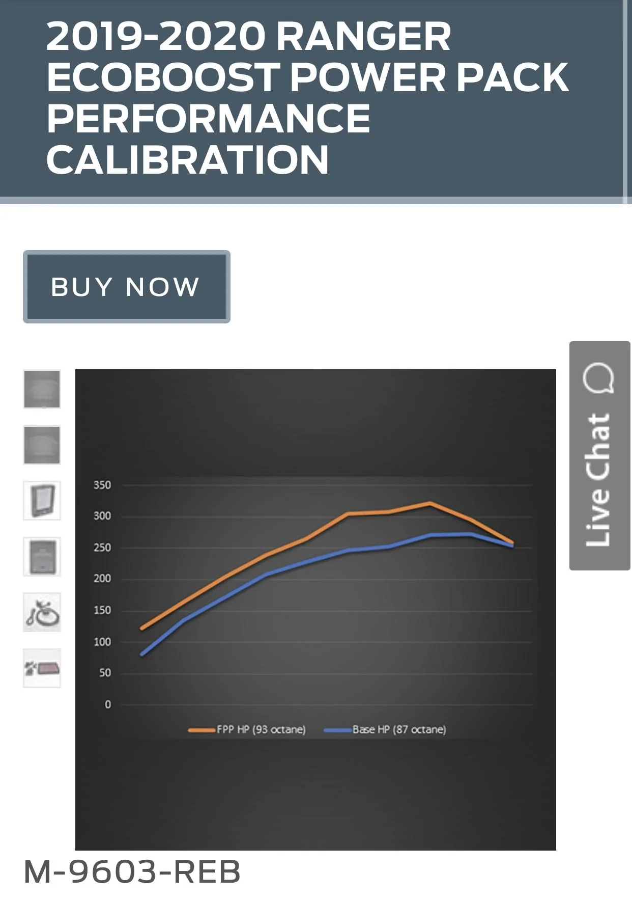

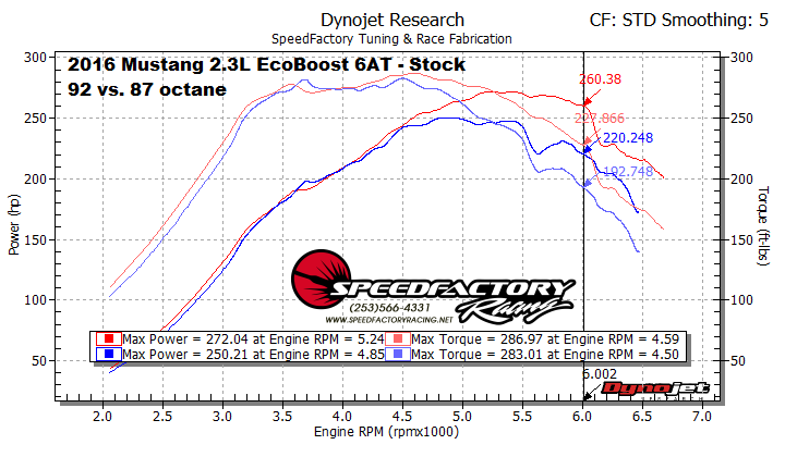

First chart is the dynojet difference between 87 and 93 octane in a 2.3 Mustang. The second chart is the purported ford performance power pack gains in ranger.
I am low-key excited to use regular gas again after 15 years, but of course would do premium if i got the ffp tune.
