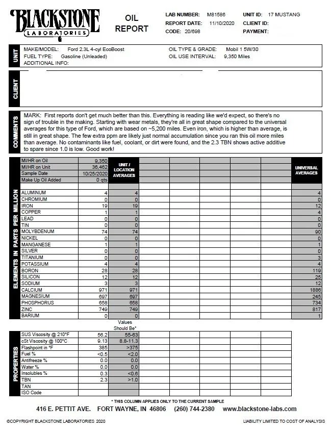

I thought I would share the oil analysis from my 2.3L Mustang. This is my first turbo engine and, like some of you, I was concerned about how well the oil was going to hold up. I also wanted to determine a good oil change interval.
Normally I like to change my oil and filter at about 7500 miles. Due to various circumstances I had a couple extra thousand miles before I got it changed. The car's computer said there was 5% oil life left.
The oil analysis shows that it held up well, even at 9500 miles. I consider this validation for spending the extra money on a full synthetic oil and I'll continue to run Mobil 1. I will probably continue to plan my oil changes at 7500 miles, since I don't like to push the limits just to save a few bucks. I have confidence in the car's oil life calculation and won't worry if the interval is a little more than 7500 miles.

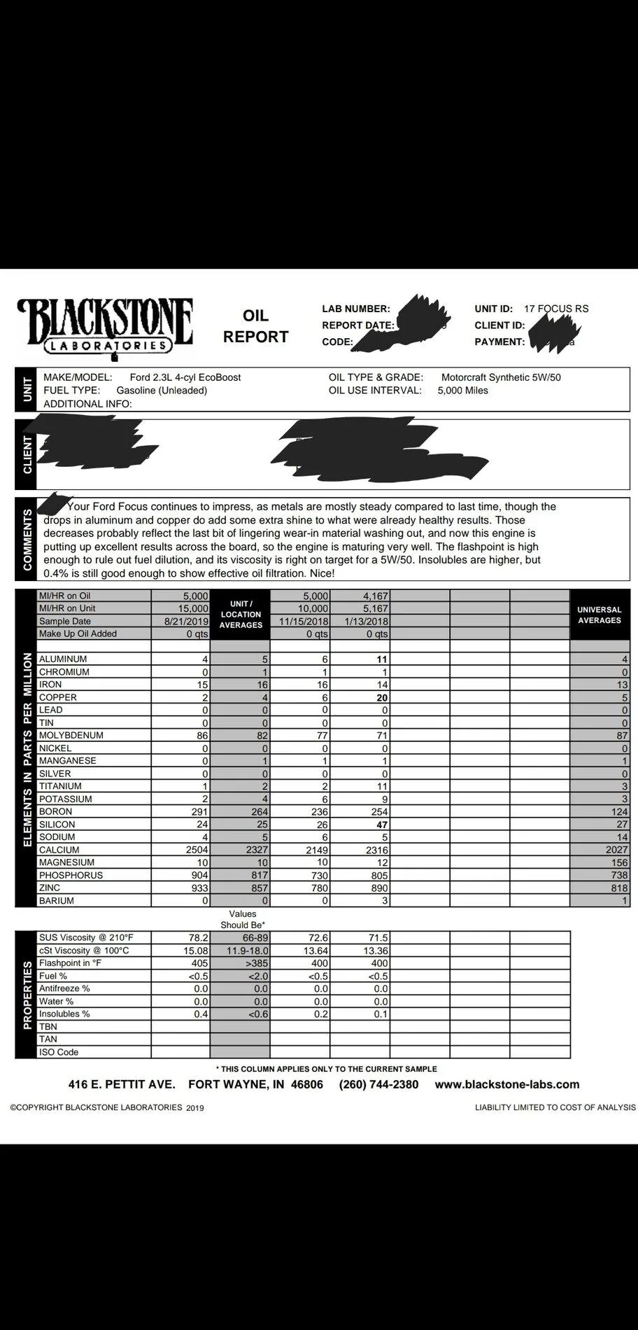

Here's another one for the 2.3l for 5, 10, and 15k miles on my RS. I use the recommended Motorcraft oil and filter.
Blackstone reports are awesome and while it makes for a $100+ oil change its worth it IMO.

This is the sort of scientific evidence that will disprove those folks claiming the 2.3 has universal fuel dilution issues.
Exactly the type of research which will be soundly ignored by 99% of people on here so their claim of "high strung and short-lived" 2.3 turbo motors make sense when they fill the order banks out for their twin turbo v6 Bronco and their ball-squirtingly awesome extra 46 cubic inches.
Okay, on topic: You should be running a higher zinc content oil than Mobil 1 for this application, note the drastically higher zinc findings in ASK NO RIDER's results. You should be at the 850-900 mark at minimum in order to ensure maximum turbo efficiency and lifespan.
Great to see another engine that is not one of the very-rare units to have fuel dilution in the oil. Typically that failure comes from the high pressure fuel pump, not the block. But something to keep an eye on is rising oil levels.
