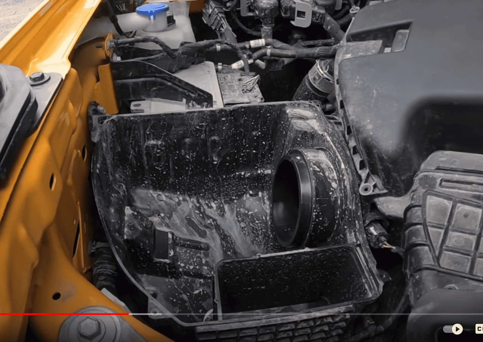

Interesting it appears they have no flapper at all for water intrusion. Like driving in heavy rain. There has to be a drain somewhere. Even just these parts if the area was somewhat protected from splash might help.
The bottom of the box does have a 3/16" drain in it but if water can get out, it can also get in. I drilled another hole in mine where the stem in the circle sits in the bracket since it still had standing water in it and is also the lowest point in the box. I would prefer to see an inlet system closer to Raptor where the filter is suspended above the bottom box instead of in it like the current setup.

I get it. I, too, would love to know where the water was getting in, because I encounter water crossings and mud holes on almost every local trail. They are hard to avoid here in the Ozarks, even on dry days.
Is it possible that the splashing was pushing up the drain flapper from the bottom and entering from below?
It is very possible especially if any of the down pressure created a upward gush of water. If that's the case, is the flapper operating correctly, what is the normal position (open or closed), how is it designed to operate and why is the area directly below not baffled/shielded better to prevent a direct shot to the opening? If nothing else, I'll cut up a front aero shield and try to close the gap between the front fender liner and rad support. Enough so if you're looking down from that area, you won't see the ground which should eliminate the up gush theory.

The drain flap is hinged and normally closed by gravity. If It was spring loaded, even with a light spring, it probably would not operate effectively. You can actually open it easily with your fingers through the air intake, without removing the air box cover. It doesn’t appear to have any protective splash shield below it to prevent water entering from splashes below.

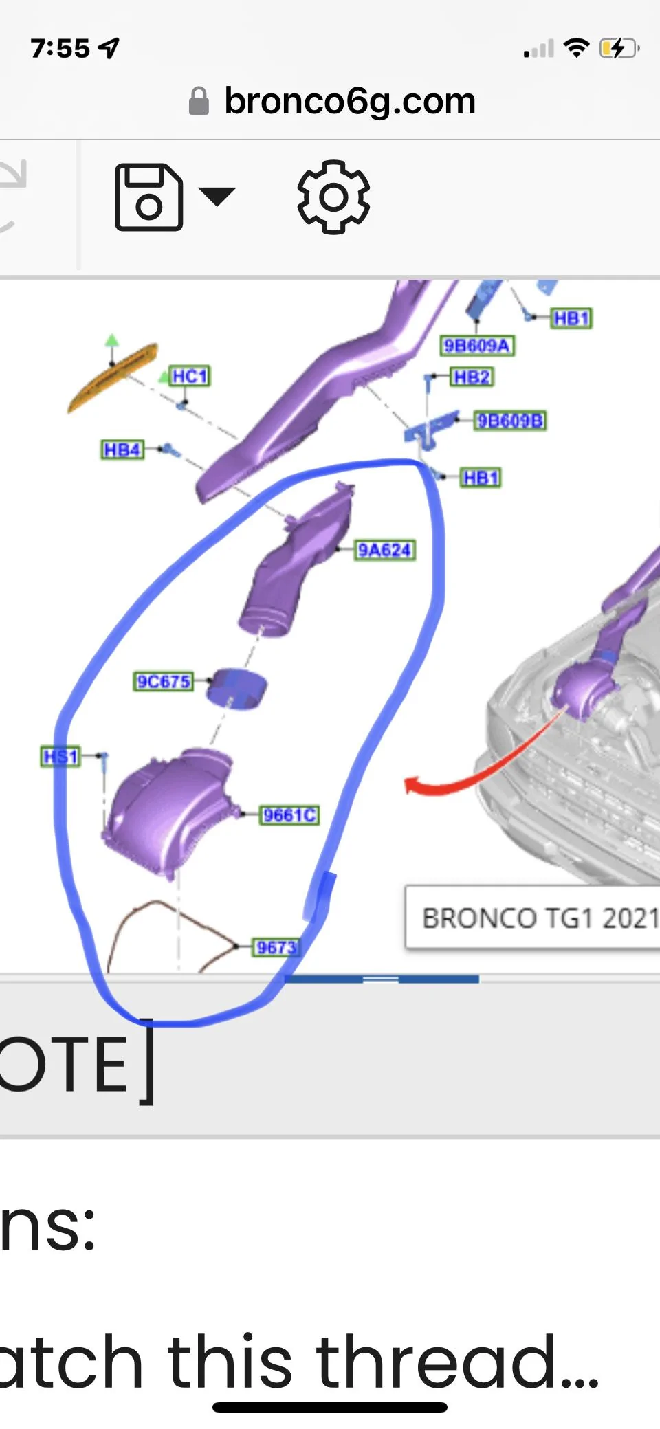

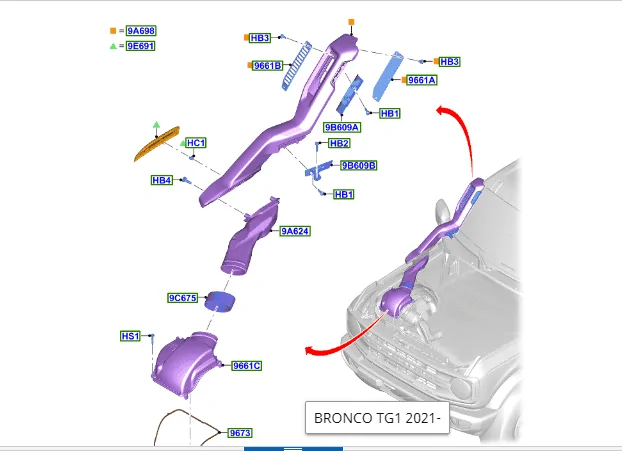

Does it look like the Everglades' snorkel can be easily retrofitted to the 2021 Bronco? Or is it complicated by a completely re-designed air box?

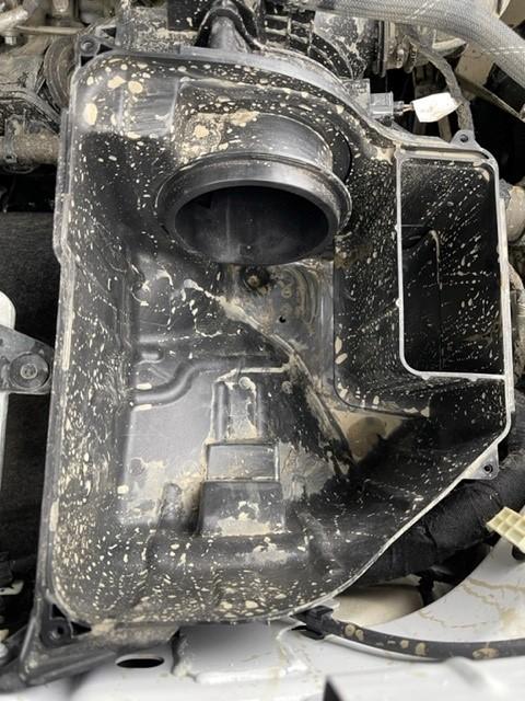

I'm completely stock so between the under body shields, wheel opening shields or the down pressure from the those shields pushing the water up into the engine compartment, it got soaked. Hood seal appears to be good because there wasn't a stream of mud water across the support trim panel, just in the corner where the inlet is. Did it come through where I stuffed the foam? Around the other two seals? If it came from below and not the front or top, how do I shield this area from a direct splash?
You said the hood seal is good, but did you notice whether or not mud splashed up from below onto the underside of the hood? I'm curious if it could have drained down into the opening to the air box, since the front of the hood appears to be the low point for the underside of the hood. 🤔
Not sure on EG retro but would need to replace the fender too?
Underhood is covered with mud spatter and consistent throughout the whole compartment with the exception of rad support trim panel. So yes, splash under hood, but no evidence stuff ran across trim to the inlet, just residue right at the inlet on the right side.
On other makes/models of off-road vehicles, snorkels are easily retrofitted on stock fenders by simply cutting an access hole via template and then bolting a trim panel around the opening to seal it. Is there more involved here (e.g., formed channels or snorkel support brackets on the EG fenders)?
Thanks for checking the hood underside. 👍

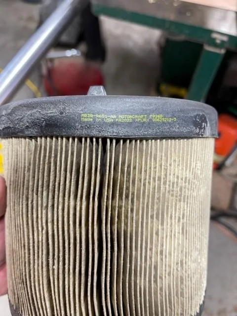

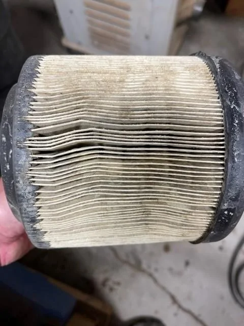

FWIW. I don't give a dang which you have, the water fording thing is crap. The first time I went with this thing I hit two legit mud patches with standing water and this is what my air filter looked like after vacuuming off and filter box after the cover removed.

Lid was on tight and mud/water did not get anywhere near the top of the grille. This is definitely a problem and am going to advise anyone looking at this to carry at least one or two filters if you're going to be going through water or mud pits.
ETA: All of the previous concerns I had with bronco just took a back seat to this. If the problem is systemic, engines gonna be hydro locking like crazy. No way would I trust this on a stream/river crossing I couldn't walk across and not get water in my boots.
As I mentioned to you mine showed signs up water intrusion as well but I think yours is even worse, and I may have been in a couple of deeper puddles at even higher speeds before too :) Not sure how yours seems to have let in even more.
