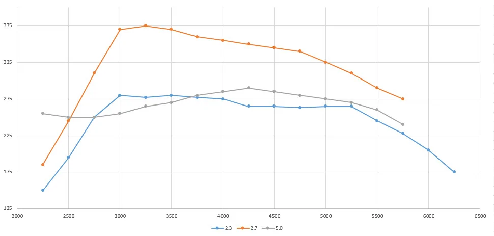

Here is my comparison of 3 motors. 2.3 (blue), 2.7 (Red) and 2013 F150 5.0 V8 (Grey). I chose this V8 as it is the motor in my truck, but also represents a modern, very capable V8 of the same displacement as the old V8 Broncos.
For those not versed, what you are looking at are lines that represent "power". This comparison only compared torque. Horsepower is pretty invalid for what us 4 wheelers want to see and is plenty sufficient. All numbers were derived from stock motors on 87 unleaded, using the same dyno, different days, and likely years.... Aside from the discrepancies that this could possibly bring up, we are not going to go down that road. What I wanted to see and share with those interested are motor characteristics and generalized power traits.
The 5.0 - Solid torque from early in the revs (taking off at a light or hill), building smooth power, and a smooth taper off.
The 2.3 vs 5.0 - 2.3 starts with significantly lower power but matches the V8 at about 2750 rpm. This will affect takeoffs and hill climbs at slower RPM, but let's not forget than a typical F150 has a six-speed trans and 3:55 rear end. Squatch has a 7-speed manual or 10-speed auto with 4.70 rear end. That will likely offset the majority of felt power. Crawl gear will make it a non-issue.
The 2.7 - Man, do I need to explain? A V8 with much less power over 2000 rpm and over 100 lbs of weight sitting over my front axle? I will make a mixtape with a V8 rumble to play through my 2000 watt stereo.

Why handicap the EB motors with 87 octane.
Seems a more fair comparison would be manufacturer recommended fuel. All the EBs I've driven recommended the top shelf.

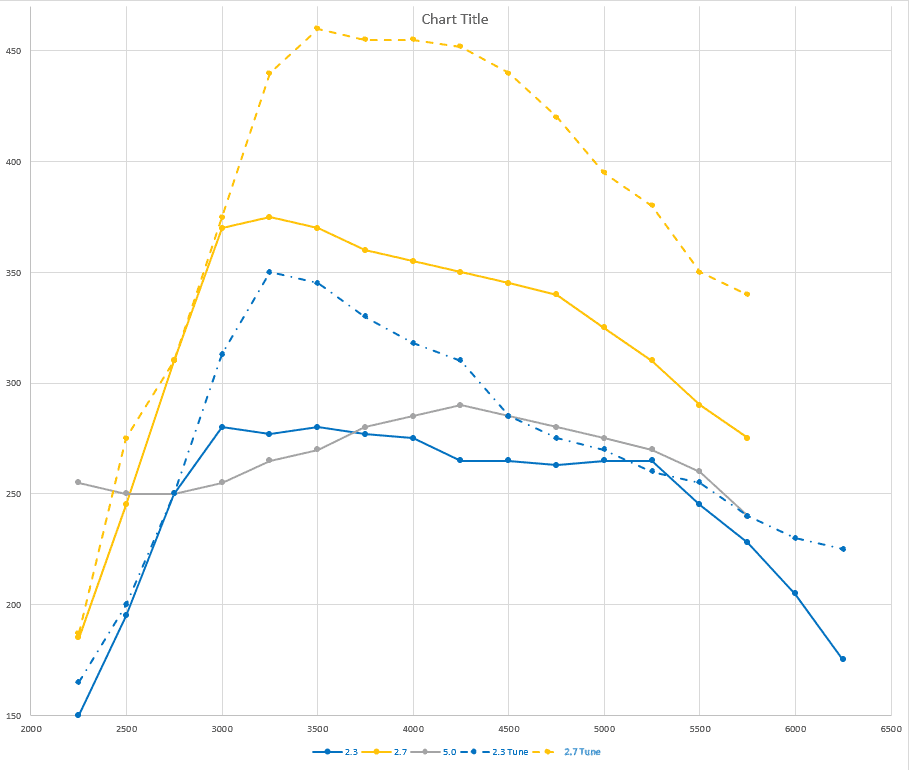

Updated chart with 93 octane tunes represented as dashed lines. Cyber Orange = 2.7,
Grey = Stock 89 octane 5.0. Velocity Blue = 2.3.

Bring a bucket and a mop, that some WAP!

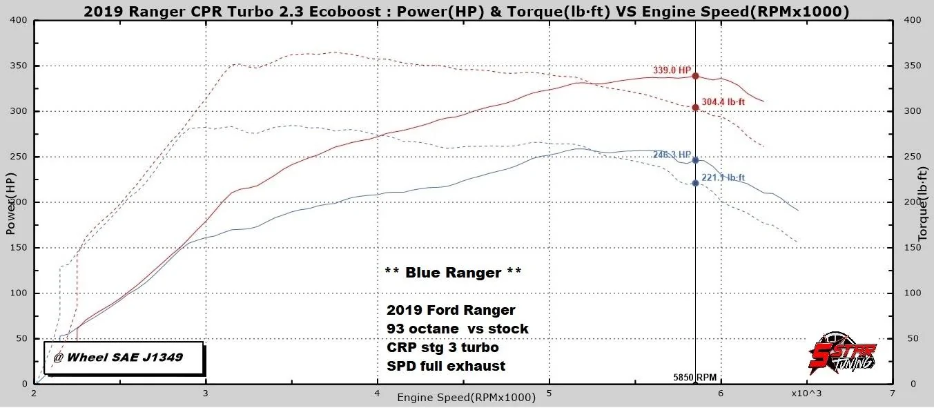

2.3 - I'm thinking that the stock tune is the dotted line. In which case I would prefer that because the power is flat. I'm not a pro with this companies chart printouts.

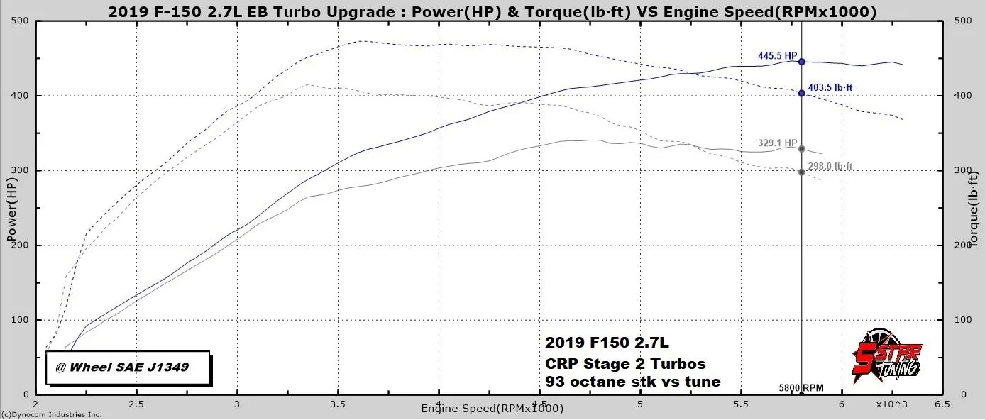

2.7 - This chart "suffers" from the same trend as the 2.3. I'll stick with the dotted line curve.
Ford Bronco 2.3L vs 2.7L power curves / dyno chart comparisons 2.7 turbo stage-2-vs-stock-93-octane
With the power put into pictures, for my seat of the pants dyno, would indicate that the "2.3 is plenty" and that a tune is not necessary. YMMV of course but here is a picture that might help each person get an idea of what the drivetrains may feel like.

The red line looks like a considerable bump?

The dotted lines on the bottom 2 graphs are torque figures. Solid line is horsepower. The tuned figures outperform the factory numbers in every way.
