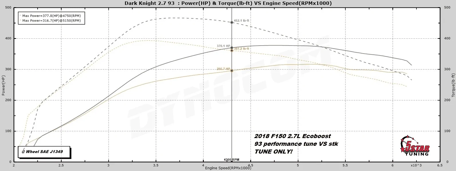

Awesome. I’m getting a 2.7 with a 93 octane tune. I’m sure it will crank out the power.
Have any graphs of something like that?
Keep in mind that the Ranger (2.3T) is going to be geared higher, but does weigh probably 1,000 pounds less using the same 2.3T w/10 speed. I still feel like the gearing advantage we get outweighs the weight penalty which is helpful to us in slow to medium wheeling speeds in the 4cyl.
Basically, slow off road and mud, its almost a wash when using the 7MT with the 4cyl. Sand and high speed would favor the 2.7 Really comes down to "do you like rowing or not"? If you like driving "fast" on the street, the 4cyl will not disappoint, but also won't impress. Main reason being the momentum loss during manual shifts vs the 10 speed almost never coasting.

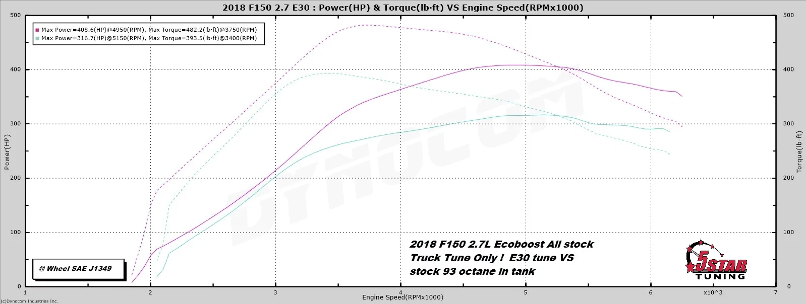

great info! coming from modified Subaru’s for the last 13 years and a huge fan of E85 tunes, I cant wait to get a Bronco. The aftermarket will be huge. I use Cobb tuning on my STis and they have tuning for 2.3 Ecoboost in mustang and focus already. I really want the manual but the 2.7 has more potential . Still, a tuned 2.3 with a manual making about 350 whp and 400 wtq like that Ethanol tuned Ranger in first post would be REALLY fun. That’s about what my current STI makes and it’s a blast. The Bronco will be at least 1000lbs more than my STi but it will still be quick. I’ve seen some tuned Rangers doing quarter mile in mid 13s And under 6 secs 0-60. Not bad for a 4cyl truck.
