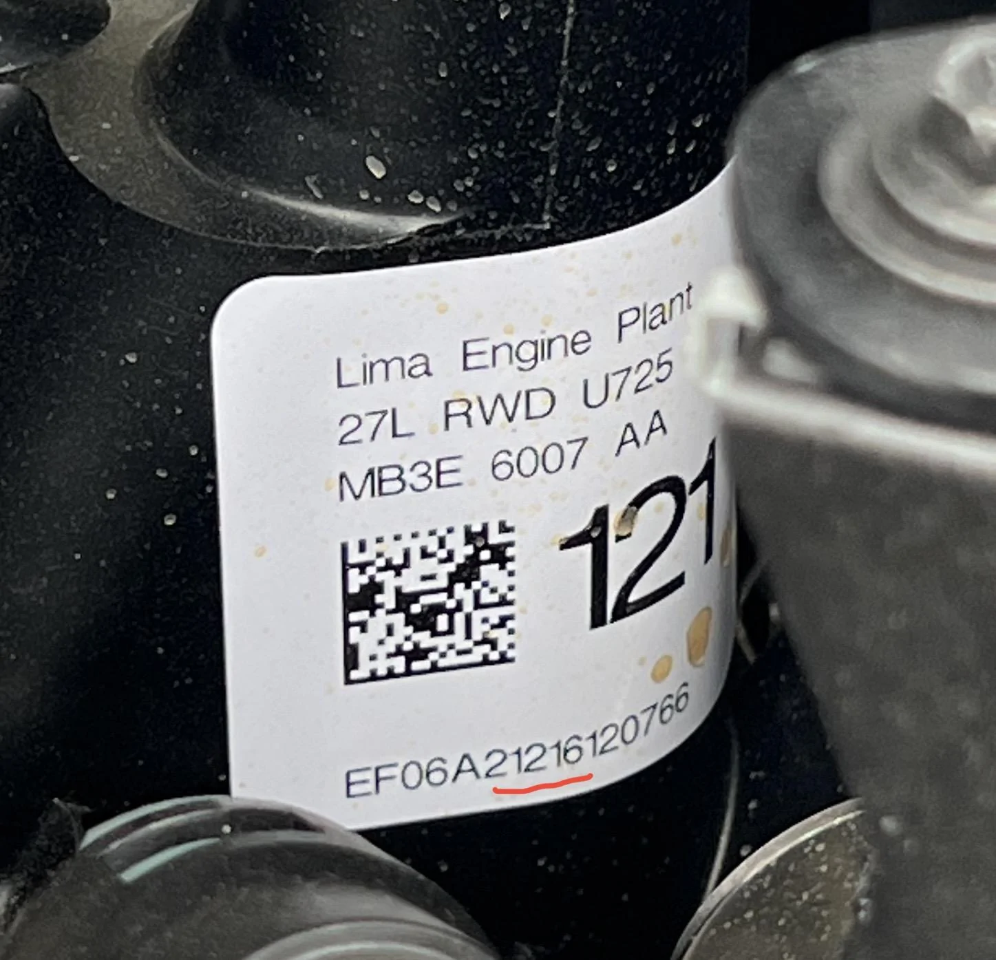

? can someone lookup the engine build-date for this VIN ?
this could be the most recent engine build-date posted so far - then we can add this to the known range of failures

Just checked mineā€¦ā€¦ build date 21216 šŸ˜¬
2700 miles so far, *knock on wood*

Make it 20ā€¦ I just got the call from the dealer that mine dropped a valve. Needs a new engine. No idea how long this will take to get replaced.

It must have happened Christmas Eve when we got home. We shut it off after an hour ride on the freeway and didnā€™t try to start it until the 27th. It was freezing here so I thought it was a dead battery. No codes in Forscan that werenā€™t related to voltage. It gave us no warning that it was having issues before it died. 1795 miles on the odometer. Iā€™m open to answer any questions. Hopefully they can fix it within a month or two.

Much appreciated. At least it happened in the driveway, and not on the freeway. If you have engine ser# would be very helpful - see OP photos. Glad everyone okay.
Iā€™ll see if they will send me a pic of the serial.

My was built 21174. Fingers crossed. haha. I was planing on getting the extended warranty at some point even before this.
I am with you at 21193. I picked it up October 2nd and just rolled 2k miles. I guess we will just have to wait and see...
