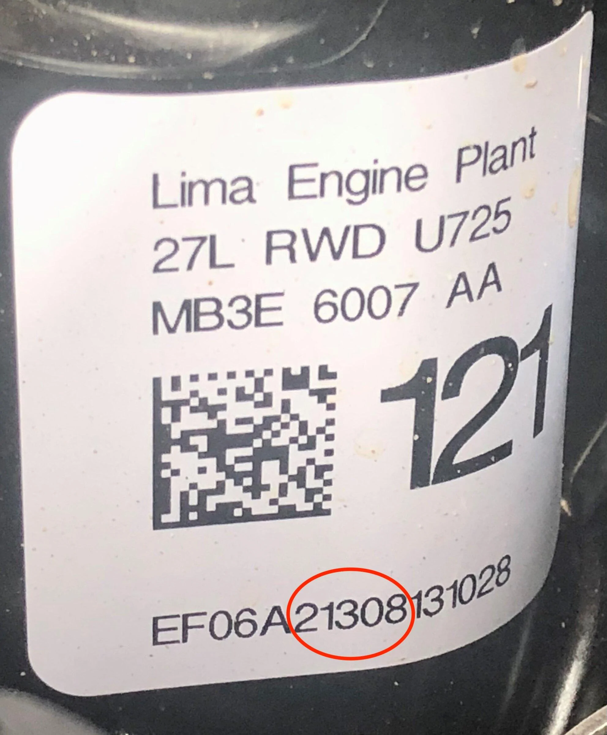

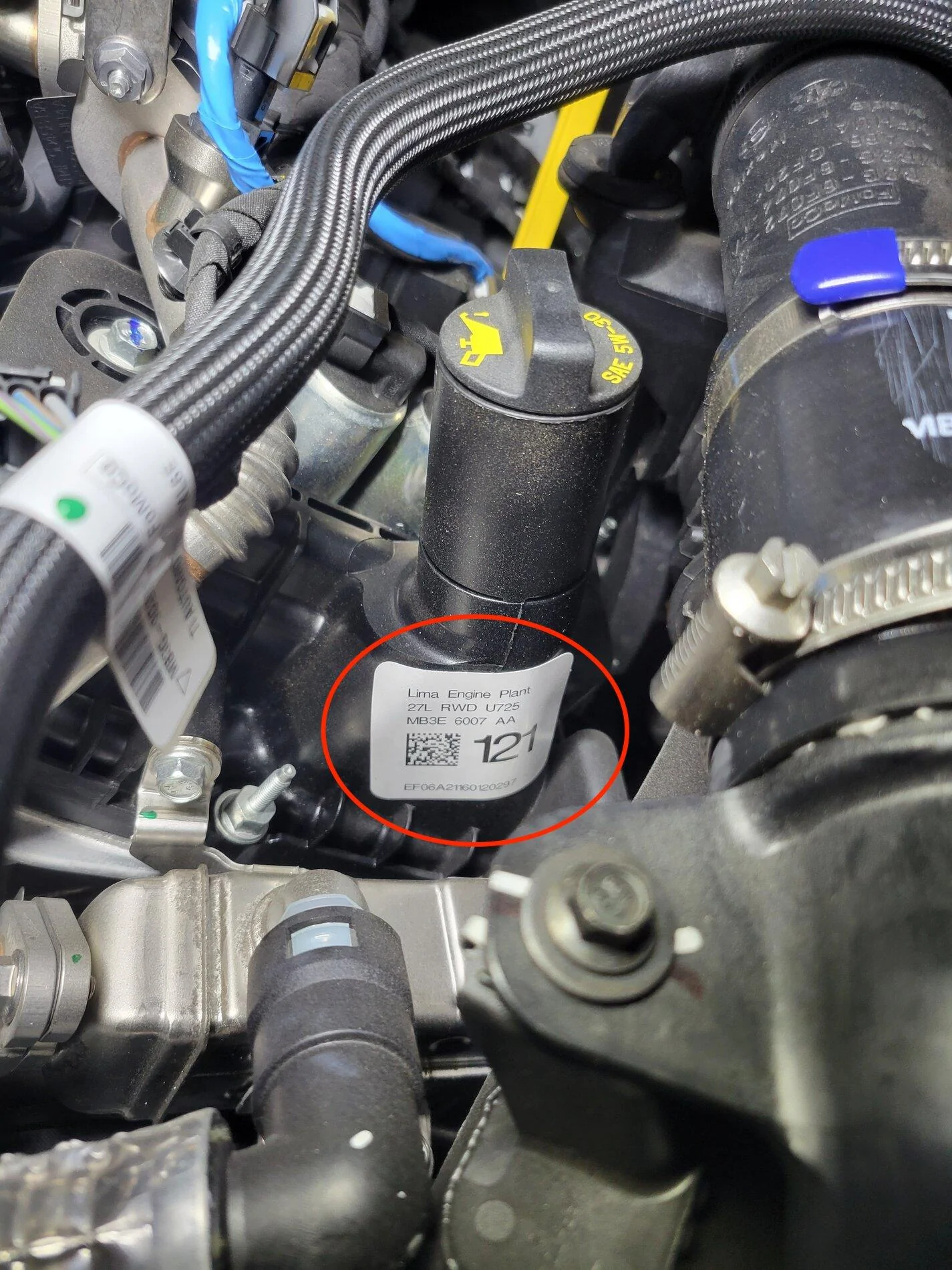

As others mention here, if the engine is blown it'd be very helpful to know the engine build-date - see photos below and in OP. Maybe the service dept can take a look and provide it to you -
Replacement usually several weeks - check-out the repair threads** in OP -

good info, but the most important data point is ENGINE build date - imbedded in its serial number
Wow, thx update, I remember your post Friday afternoon. At least no accident - everyone okay.

so....in the photo above, 21308 defines the build date for that engine...Nov 4, 2021. Or...the 308th day of calendar year 2021

The #308 was just an example of what sticker to look for. Don't believe we've seen a Nov failure yet. Fingers crossed
Roger that, I must have read a date wrong.

example Engine Ser# Labels -
- B6g trying determine if the failures are confined to a range of engine build-dates, see also 2.7 Failed Engine Tracking Thread
