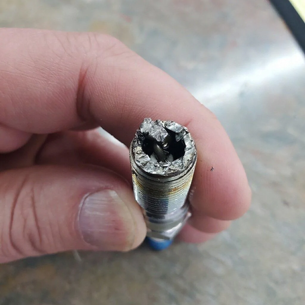

We actually know quite a bit about the cause, If you read through all the reports it's pretty obvious. The plant will have received several cores by now, and failure analysis is done. Not a running problem/lean out/timing induced detonation for sure...we can rule that out at this point, due to the fact that @International_George had his fail on shutdown, and pics posted in one of the other threads I can't seem to find right now. Improper heat treat is the "word on the street", and that theory still holds water at this point. I'm still hoping a few dealerships will tell whether it was intake/exhaust or both
EDIT: finally found the pics I was thinking of,
https://www.bronco6g.com/forum/thre...racking-thread-ford-please.28682/post-1035405
Still would want to see the spark plugs, however, the valve heat treat is currently the most plausible answer.
Look closely at the pic of the spark plug...it's hammered all to hell for sure, but the ground strap and electrode are still there and not turned to slag. It's still black even. Not a lean out, and definitely not detonation.
Awesome... That's what we need to know!

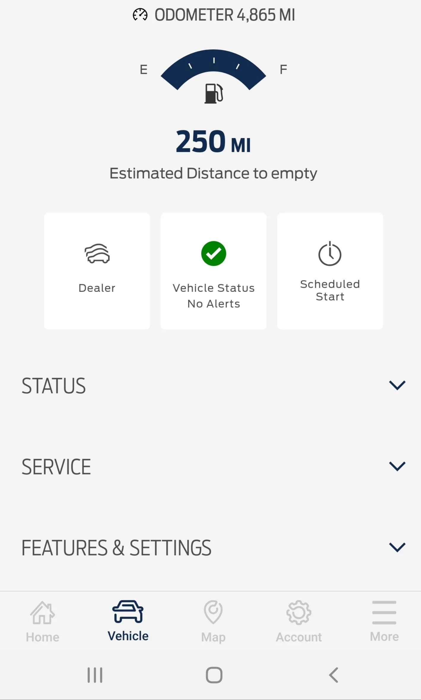

I focused more on your 250 mile to empty on a full tank. Your's has to be a 2 door, right?
I have a Bronco, that means that I have 2 doors. ;)
Ya, it's a pig normally because I have a heavy foot.
My highway average is about 17 mpg though.
