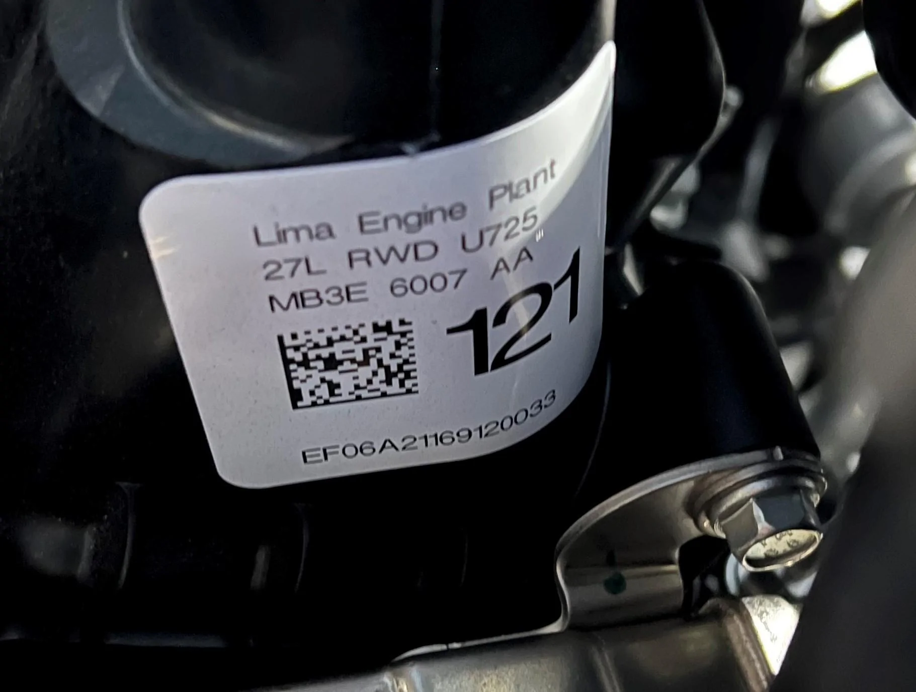

- so far the engine build-dates run 21159 - 21224 - see how to read Engine Ser#
- in October a Ford Lima employee (@Jay3630, deleted soon after) made five posts re 'bad batch of brittle valves' - 'April batch' - see posts #1, #2, #3, #4, #5
- if the failures are caused by 'bad valves', maybe that 'April batch' has been working its way thru the system - then the problems could subside ?
- late October a Ford Service Technician wrote a post re the frequency of failures nationwide - he said 'about thirty in the last month . . recorded in the Ford Technicians Forum page'
If Your Engine Fails - dealer service of course - also :
- good to call Ford Customer Svc - expedite repair, communication, cover rental
- good to send VIN & full name to @Ford Motor Company here in B6g
- engine ser# would be very helpful in B6g build-date tracking efforts
example Engine Ser# Labels -
Ford Bronco 2.7L blown engine failure list . . 68 so far [Updated: December 13, 2022] b2
- B6g trying to see if the failures are confined to a range of engine build-dates
- maybe they were all built in same couple months ? - see also 2.7 Failed Engine Tracking Thread
- in 15 of the engine failures we have the build-date info

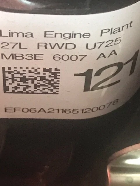

Man, you guys are same engine build-date (June 14) - and almost same sequence#, only 19 apart
