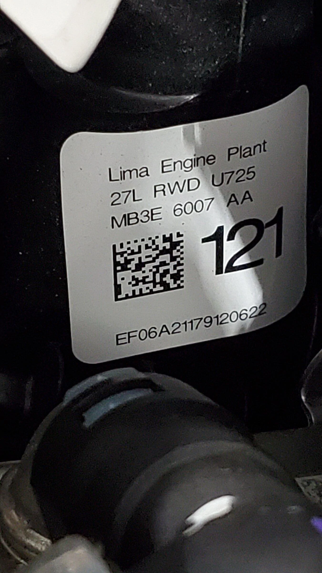

I finally looked at my date, looks like I'll keep my fingers crossed as the miles rack up! Almost 1,500 now.
- in the engine build-date 'failure range' (66-days so far), there's a 31-day gap in the middle, w no failures in the gap
- it could be we're looking at two separate failure ranges w a 'clear gap' in the middle
- so far your 21179 falls in the 'clear gap'
- as they accumulate, we'll have to see where the build-dates fall
Thank you for that! Fingers crossed šŸ¤ž

So do we know ā€œin clear rangeā€ then?? 21196 with 2800mi(mostly in sport ha!)

So do we know ā€œin clear rangeā€ then?? 21196 with 2800mi (mostly in sport ha!)
Looking at the 15 known engine build-dates so far, we have -
- '1st failure range' (17-days) - 21159 thru 21175 - 7 failures
- 'clear gap' (31-days) - 21176 thru 21206 - zero failures
- '2nd failure range' (18-days) - 21207 thru 21224 - 8 failures
With only 15 data-points our view is still fuzzy, but to have a 31-day 'clear gap' in the middle is very unlikely, unless we're looking at separate failure ranges.
With data we have so far, it appears very likely we have some kind of a 'clear gap' in the middle.
