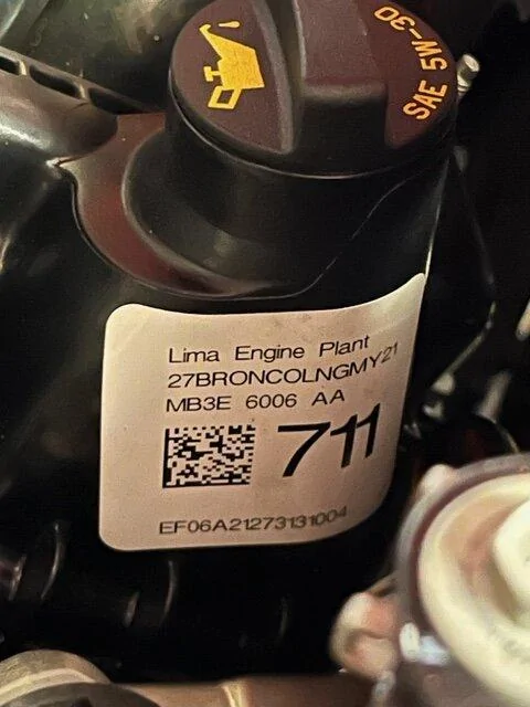

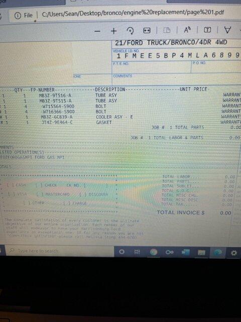

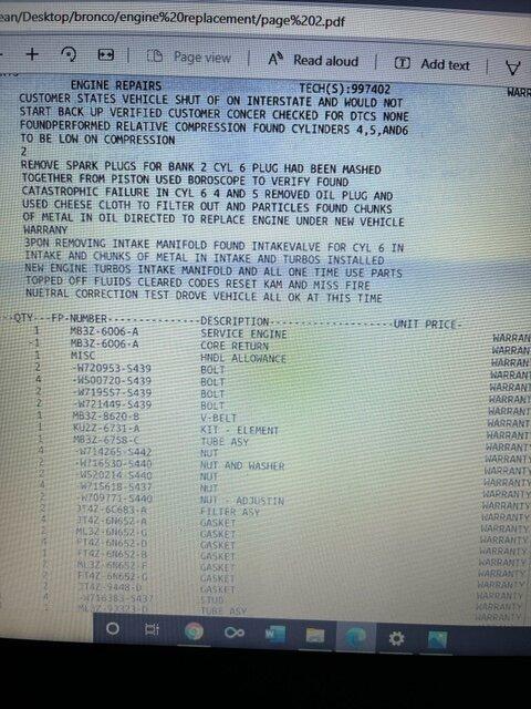

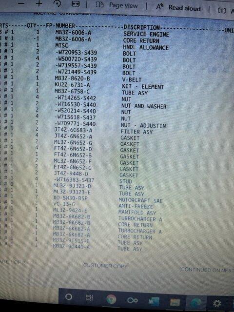

Finally got my Bronco back after 6 1/2 weeks at the dealership. Fortunately, I haven't found any scratches, dents, or dings and they did a great job getting the hood aligned. I didn't have any issue making the 100+ mile trip home.....no engine lights, no smoking, and no overheating.
The pictures below are the new engine's build number and the invoice from the dealership showing what was replaced and their diagnosis.

Sucks it took that long but nice to see it was taken care of correctly. Here’s to many thousands of miles of trouble free adventures 🍻

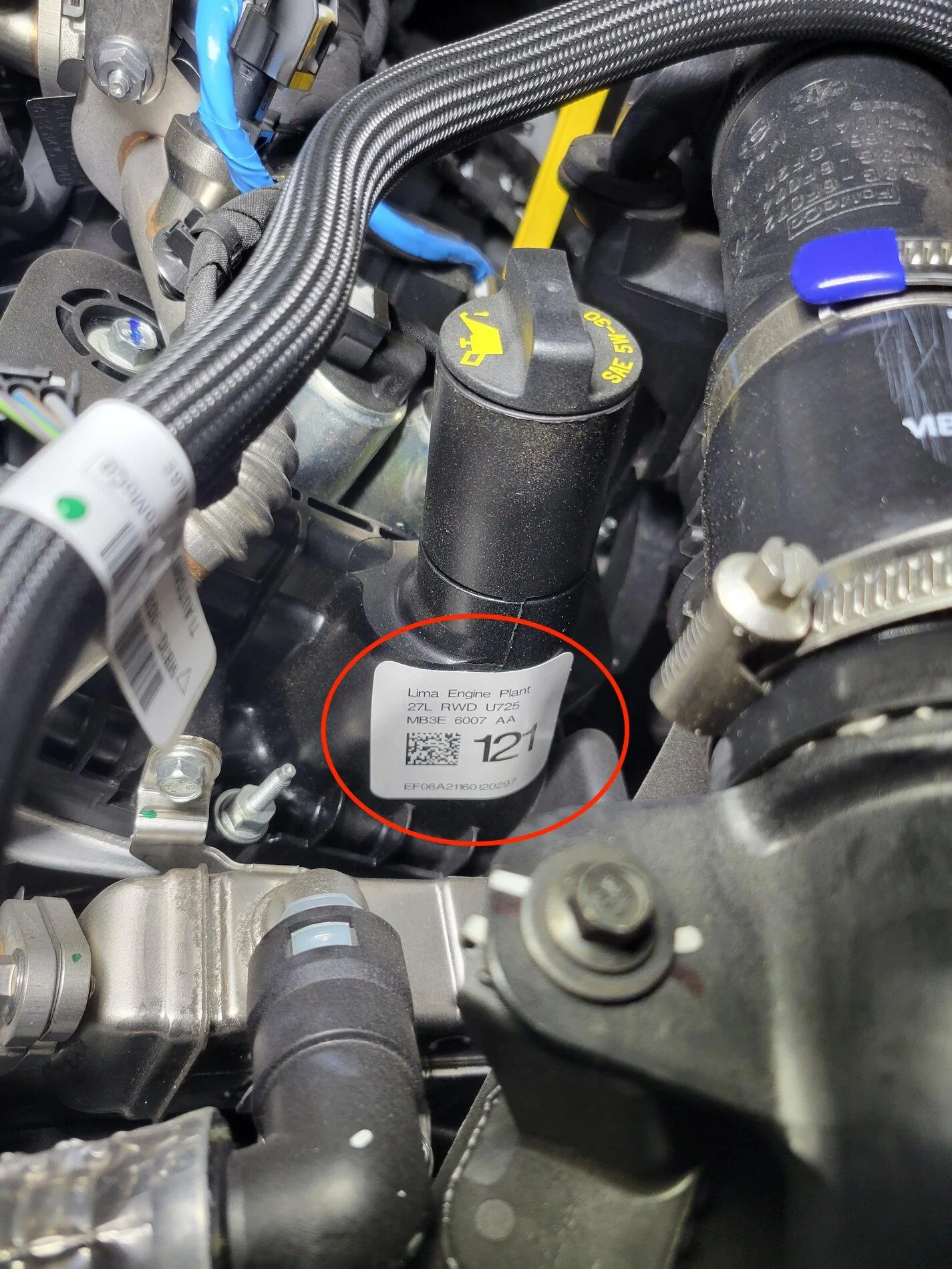

- so far the engine build-dates run 21160 - 21216 - see how to read Engine Ser#

- when time permits, the engine ser# would be very helpful to B6g build-date tracking efforts
example Engine Ser# Labels -
