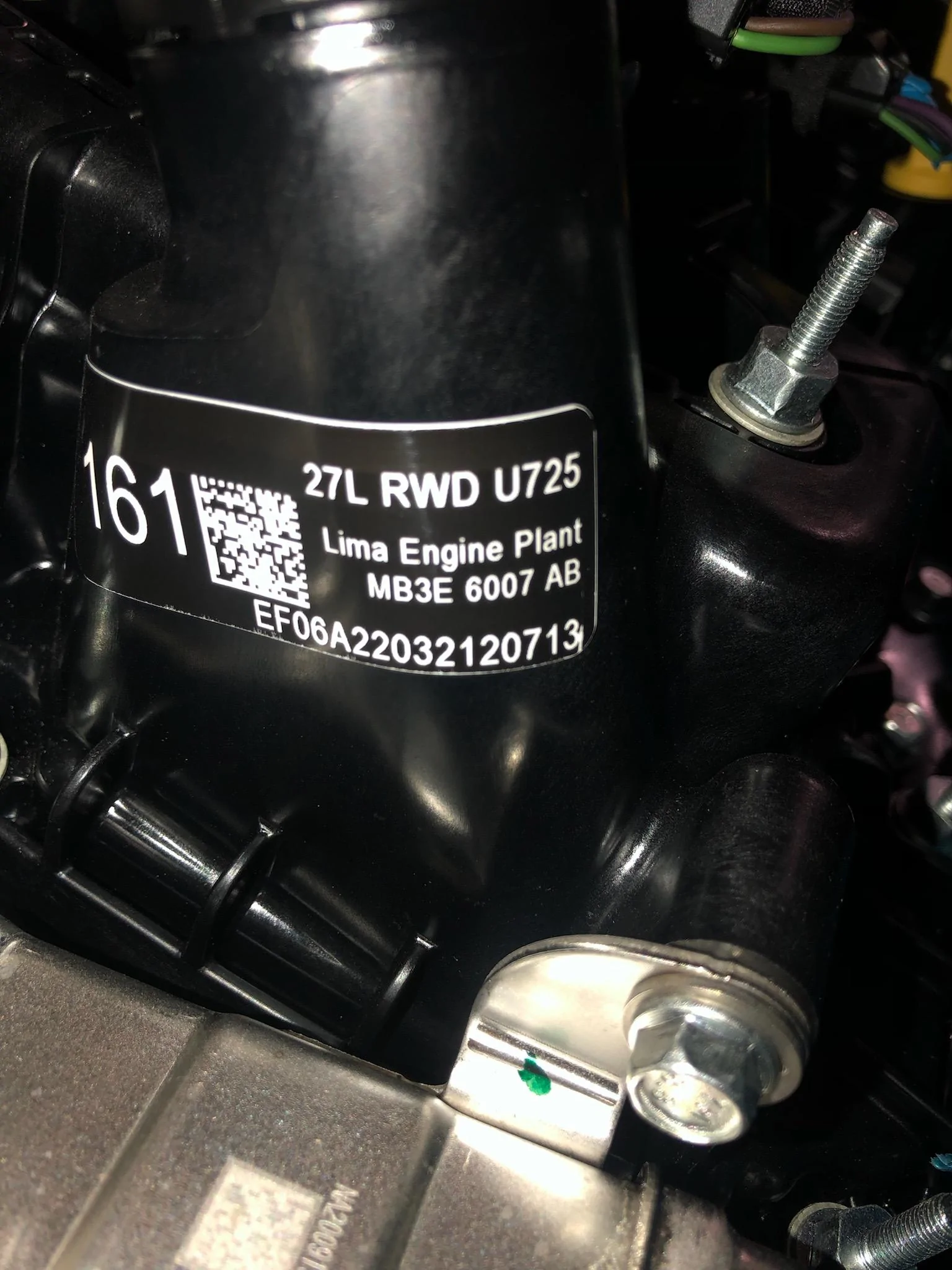

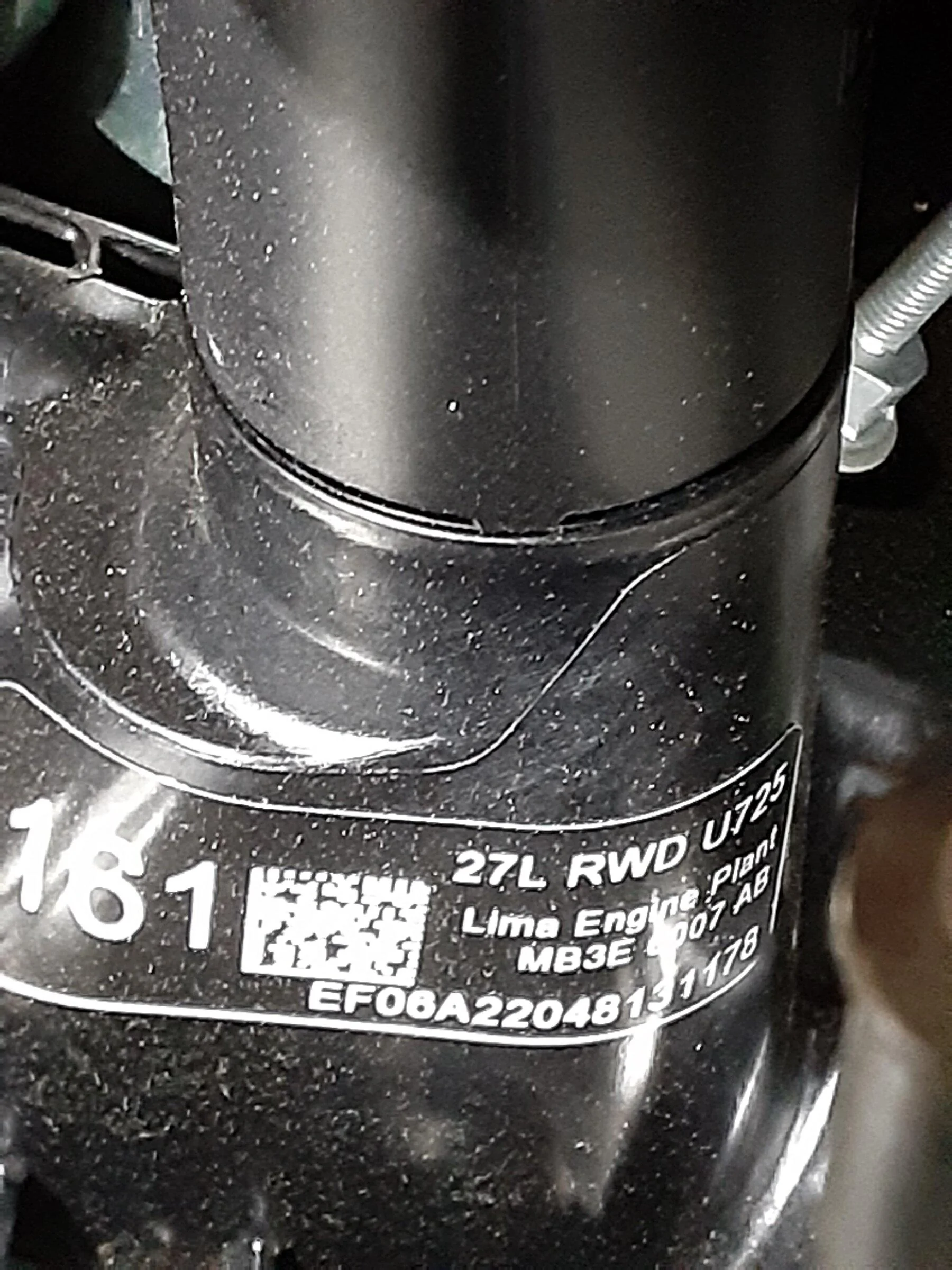

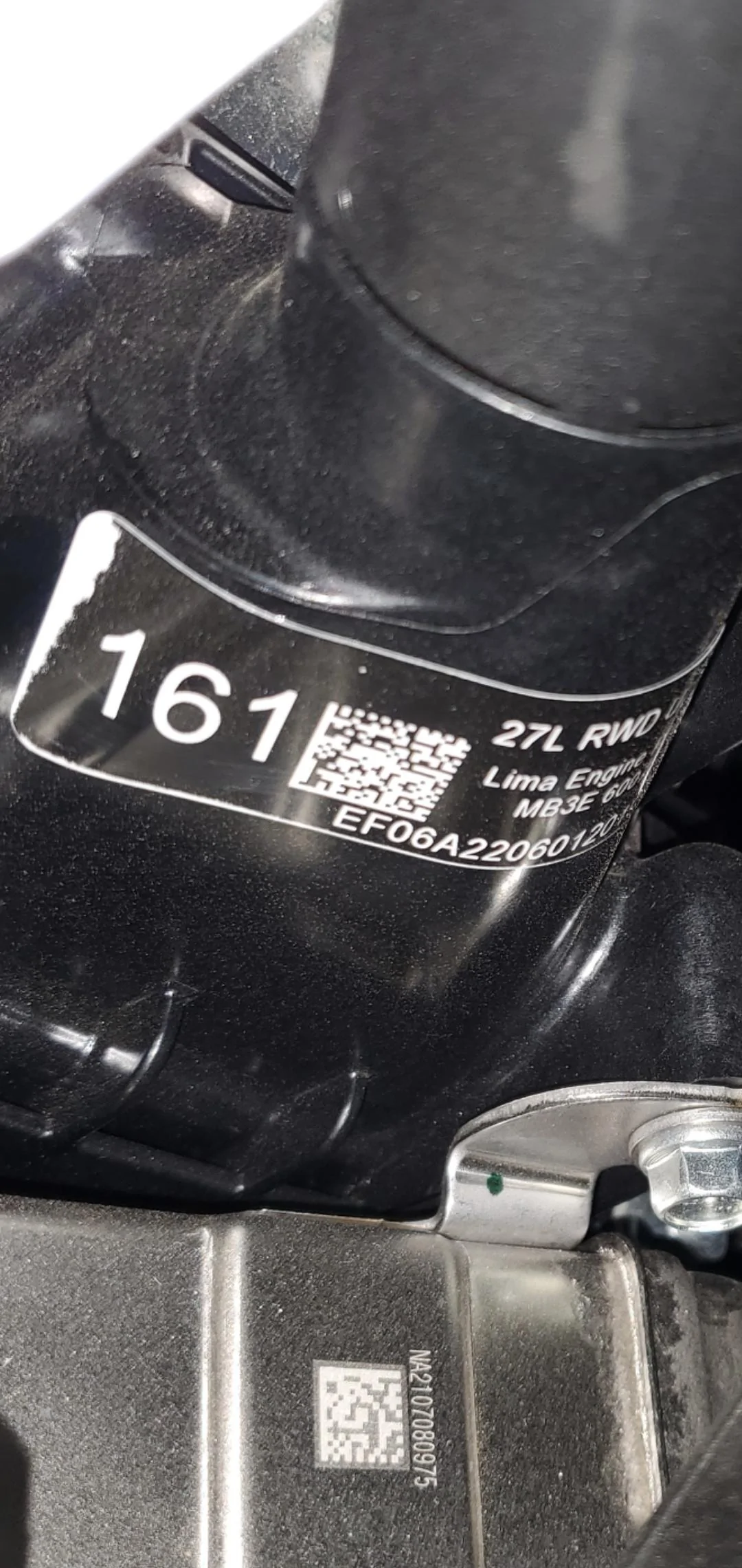

Lucchese has a way of making things feel better :) he just pointed out via PM:
“you got the solid new -AB engine and with AMB 2Dr - it's a total Unicorn - could be the only one, or extremely rare, since AMB was discontinued”
Anyhow, here’s the new engine for those that may be interested. Evidently built in Feb. 2022.
Ford Bronco 2.7L blown engine failure list . . 68 so far [Updated: December 13, 2022] Screenshot_20220419-084506_Gallery
What did you mean by AB engine and with AMB 2Dr?
