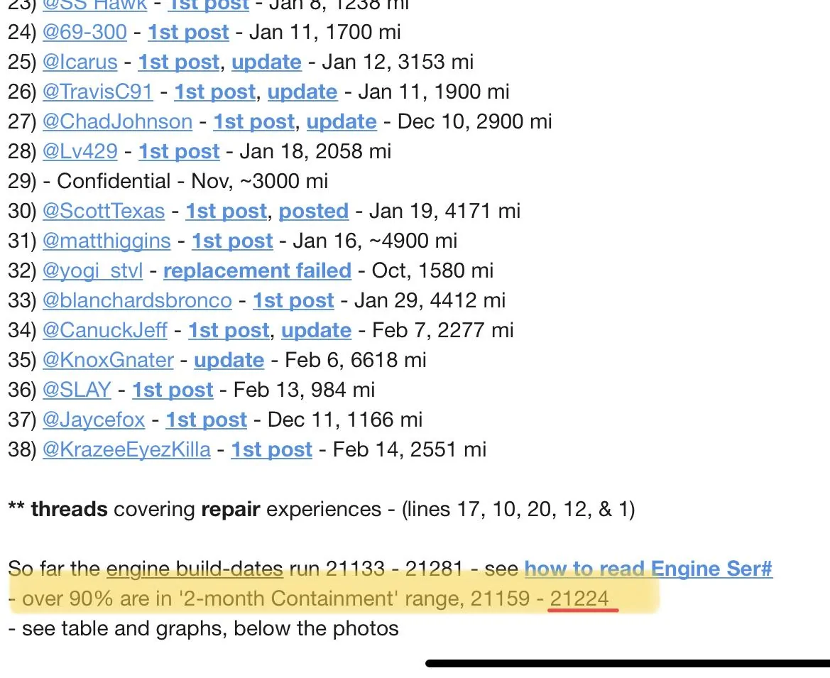

I see that the NHTSA site is up to 11 engine complaints now. Still a far cry from the 38 on here alone.

. . any engine failures after the resolution of the Nano valve supplier issue ?
The State of the Plant announcement said they redesigned & updated materials.
Recent Changes - 2.7L Bronco V6 (Nano gen2)
- over the past 6-months there were at least three changes
1) New Valves
- 'Nano valve supplier issue was resolved with more robust design and material changes at the supplier.'
- Timeframe: ~ Summer/Fall
2) Head Assemblies - New Part#'s
- Left
-- Engineering# ML3E-6M099-DB --> new rev -DF
-- Service part# ML3Z-6049-G --> new rev -K
- Right
-- Engineering# ML3E-6F093-DB --> new rev -DH
-- Service part# ML3Z-6049-D --> new rev -J
- Timeframe: prob along w change# 3) below
3) 2.7L V6 Engine - New Part#
- Engineering# MB3E-6007-AA --> new rev -AB
- new part# prob coincident w new head assemblies
- Timeframe: appears ~ Nov/Dec ebd's
Blown Engines
- in B6g tracking, the bunches of dropped-valve failures appear to end w ebd 21224 (Aug 12) - Since then we've only seen one blown engine (21281), which could be an isolated random failure
- so far we have not seen blown engines w new part# rev -AB
- engine rev -AB still fairly new, many still low mileage

My JD is 21224, lol. We'll see....

I haven’t read all this thread but I hear everyone saying they dropped a valve. How would a bad batch of valves cause a dropped valve? Could keeper/retainer notch be bad and not lock in the keepers? Could the valve break at the keeper/retainer notch? Is it really the (6518) in the diagram actual valve keeper/retainer that failed to keep the valve, thus dropping into cylinder? Or the rocker could kick off due to bad lash adjusters (6500) causing it to hit the spring, which could throw the retainer and drop the valve? This was an issue on some 5.4’s. Only so many parts can cause a dropped valve but it usually isn’t the valve itself that failed.
