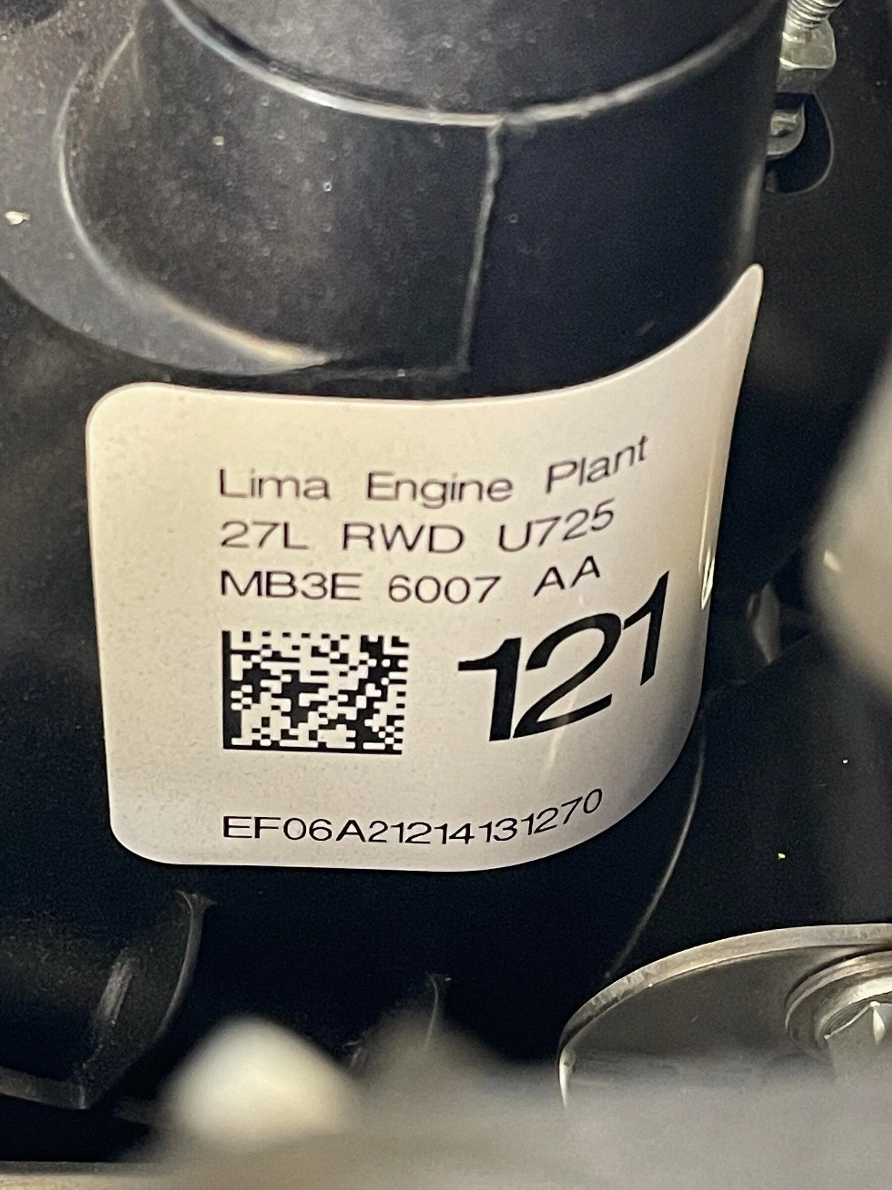

Looks like you can add my ‘21 Badlands to the list. I took delivery in late Nov. and with roughly 3,200 miles, my 2.7L died on me in the middle of driving. “Trailer Brake System Failure” keeps reappearing on the display. Dealership has it now and I should know tomorrow if I had a bad valve and now a bad engine. I will get a photo of the engine manufacturing info tomorrow when I go back to the dealership. Didn’t find this blog until I had already gotten home. Totally bummed. Hopefully get a quick swap out if required.
EDIT #1: here is my engine info -
Ford Bronco 2.7L blown engine failure list . . 68 so far [Updated: December 13, 2022] 1645637016311
Well shit!
That makes 3 failed engines on my day 21214131426! Yours was built 156 units before mine , one was 4 units before mine, and the last was 39 after mine.
Guess I'm screwed. So much for a summer of fun!

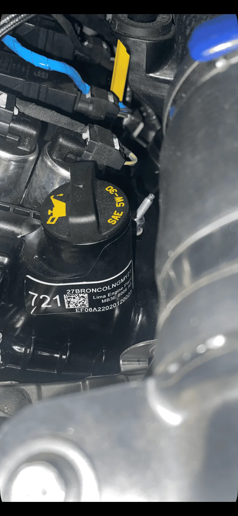

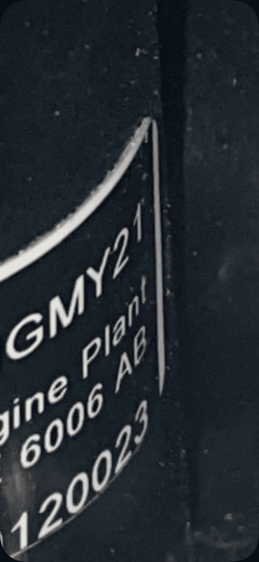

JollyFolly
Matthew
Jun 21, 2021
215
418
Charleston
Toyota 4 Runner
Update for ya’ll…got my Bronco back last week. Check out the photos of the new engine date. The Oil spout is much lower than the original and the sticker is black and to the side making it a little harder to get a picture for everyone. It is an AB and built in 22’.
