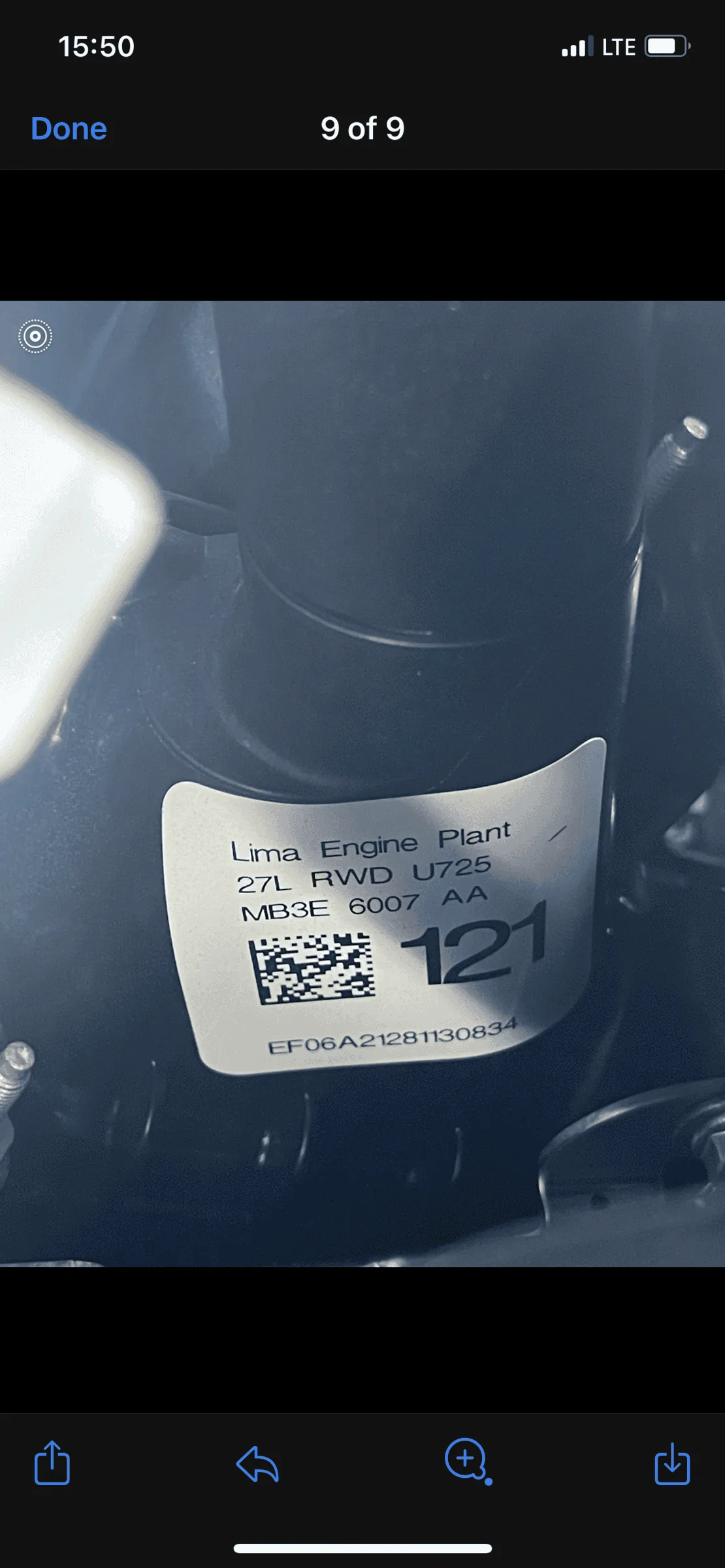

I have a 2021 Bronco OBX 2.7 that I took delivery 2.5 months ago and have 4K miles. I was driving only about 35-40 mph when all of a sudden I heard a click then white smoke poured out of my exhaust. It looked like I was driving a cloud for a few seconds. My dash said that I need to park it and start it up again. I was able to pull over into a parking lot, but it would start but would only sputter. I had to get Ford Roadside Assistance to tow my Bronco to the Dealer. They are supposed to look at it today

That’s a huge bummer, I’m sorry. Before they take your truck and diagnose it, please make sure to take a picture of the sticker in your engine bay described in the first post of this thread. If this failure ends up to be a dropped valve like the others that info will be very helpful.

That sounds like it could be the same thing. Keep us updated and get a pic of your engine serial tag if you can. @Lucchese looks like another one😪
