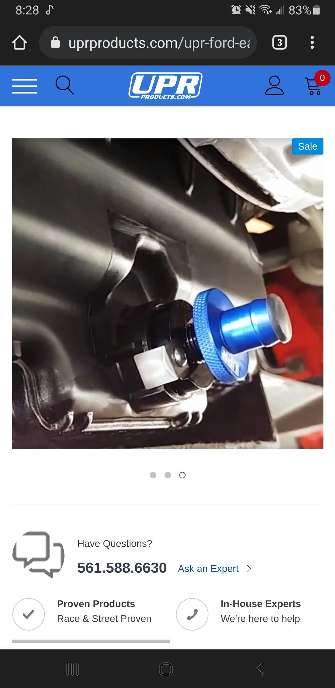

Are you using the same yellow plug and did you replace the rubber O ring seals around the oil plug with new ones?
I suggest going after market and getting a metal oil plug w/ the built in drain cap/lever. Also, I've noticed the plug twists into place securely but you have to twist it further to tighten the seal.
Address that issue before driving the Bronc again, a loose oil plug can throw off the oil pressure and cause internal damage if not replaced properly. Good luck!

No wiggling after I changed my oil.. but I also went aftermarket for the oil plug. It was a PIA to unscrew the old yellow and screw a new oil plug back in, I'd suggest going A.M. getting the oil plug with the drain cap.
*** Side note: gingerly twist past the initial locking of the plug, don't use a huge amount of force but do twist further, the fitment of the plug screwed into the oil pan feels like a 2 step engagement process, if that makes sense.

Which aftermarket plug did you go with?

Those aftermarket metal drain plugs look like a disaster waiting to happen if something hits it considering the plastic oil pan.

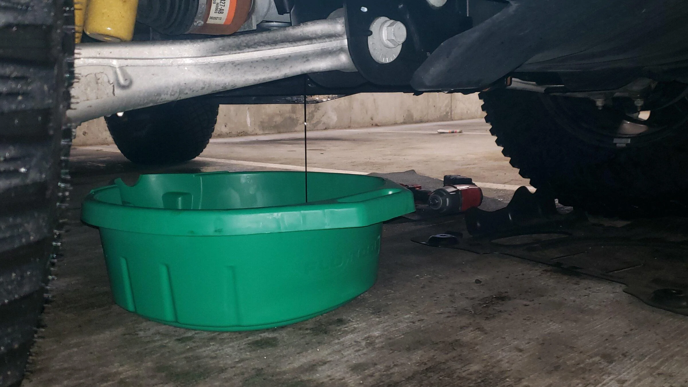

I found it's easier for me to drain the oil out with this plug. Unscrew the plug's cap and it will drain. I don't need to replace the plug and o-rings each time with the current setup.
Update:
The plug worked without any leaks, the skid plate had no oil on it (skid plate can be seen by driver tire).
Super simple and easy oil change.
Popped hood and removed oil filter, slid under front of truck, removed skid plate and unplugged drain valve and Very controlled and predictable stream of oil released to bucket (15 qt). Waited close to 1.5 hours because oil stopped draining for a few moments, then oil started draining again at a decent rate. Eventually stopped, sealed release valve with plug, refilled crankcase with new oil , new filter and new filter o rings, tightened, primed engine (accessory mode on, fully depress brake and gas pedal simultaneously, THEN, press start button) and it was good to go!
The video is over an *hour* after initial drain plug removal. Very clean oil change.
Engine's happy and sounds like it's enjoying the new oil, I'm happy.
