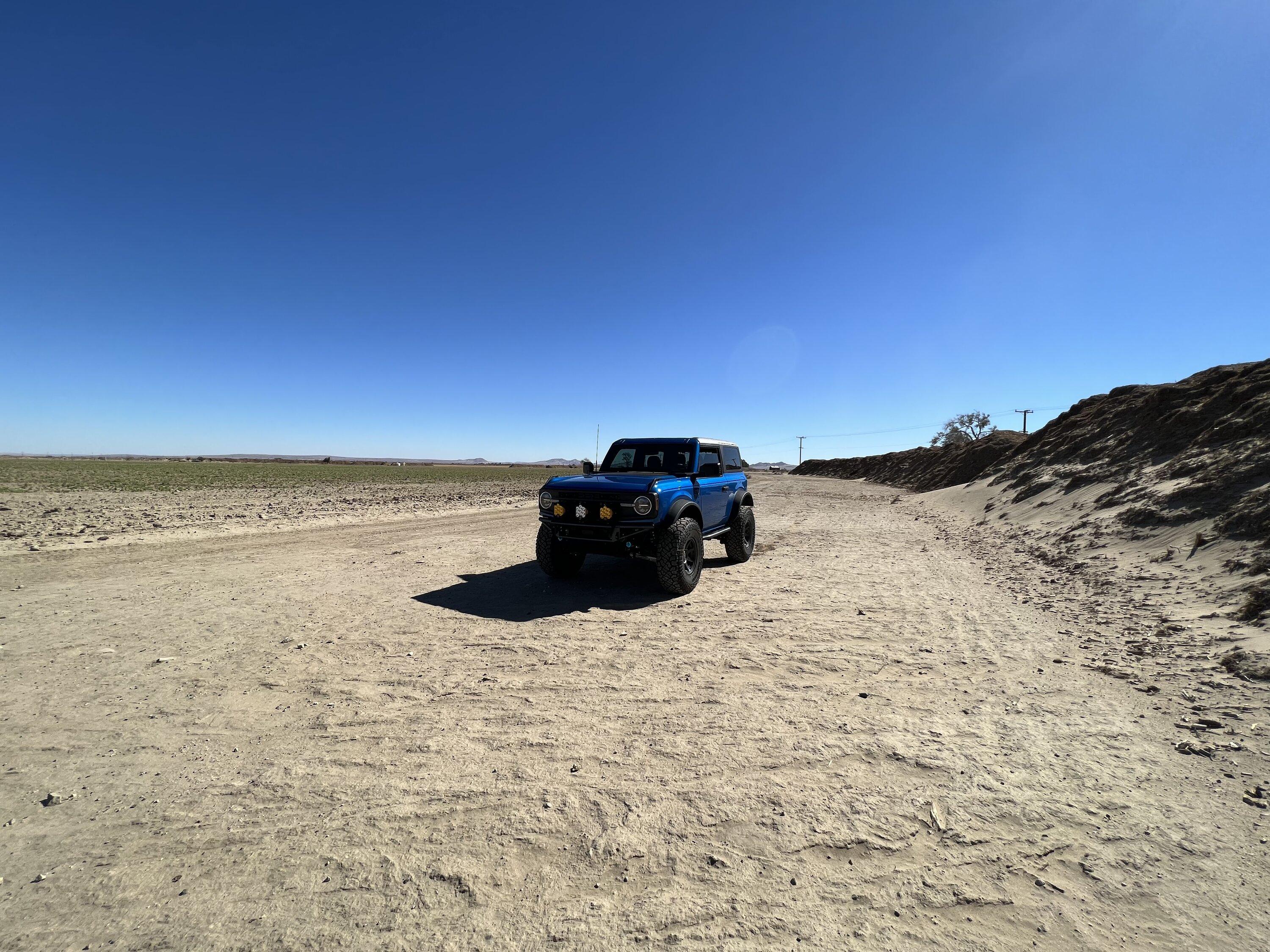

Man these kings are nice at high speeds through the desert.
trying out different terrains

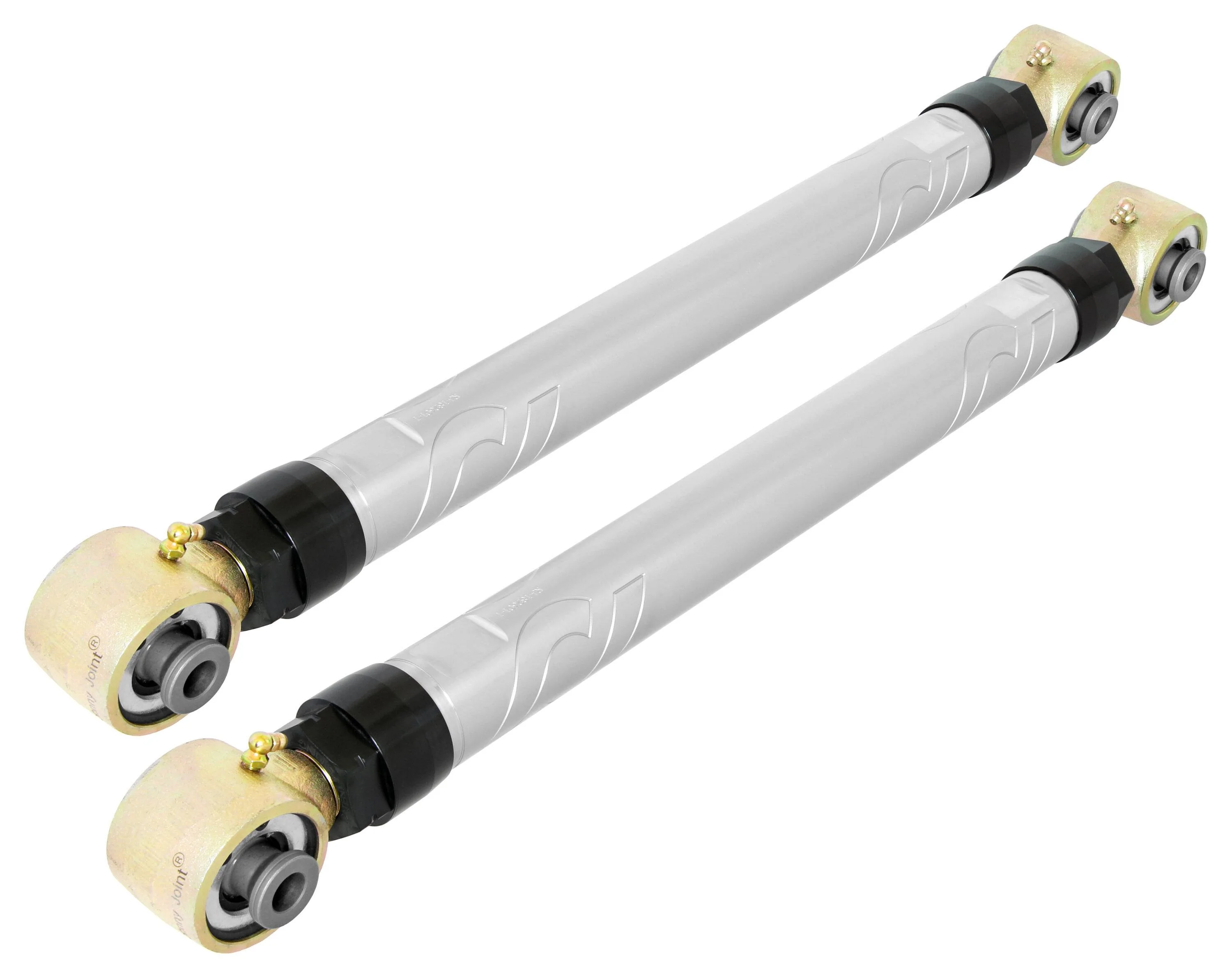

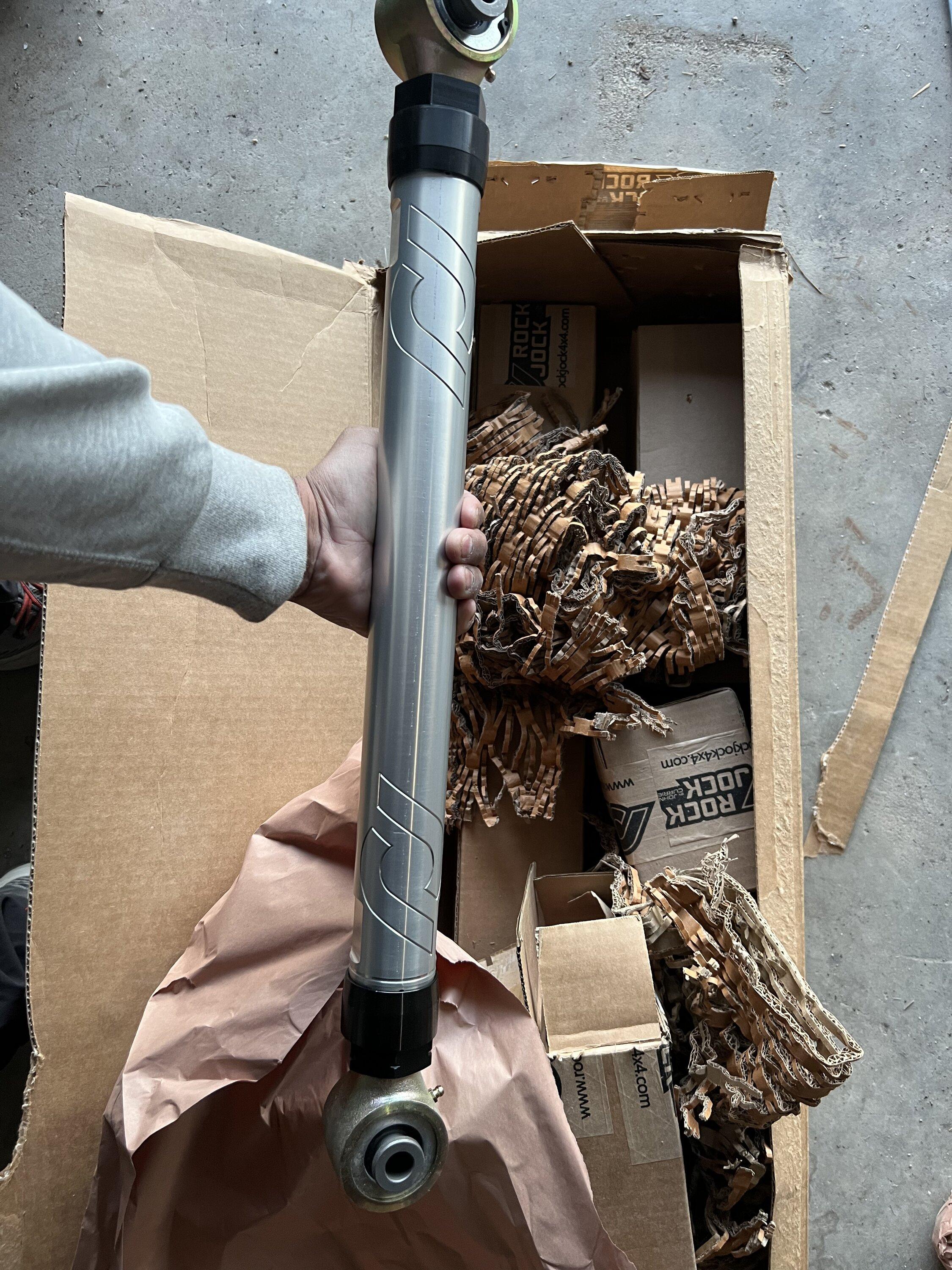

Ordered some lower control arms and a track bar from rock jock, i like that they are double adjustable.
The billet ones out there are nice, but are at a fixed length.

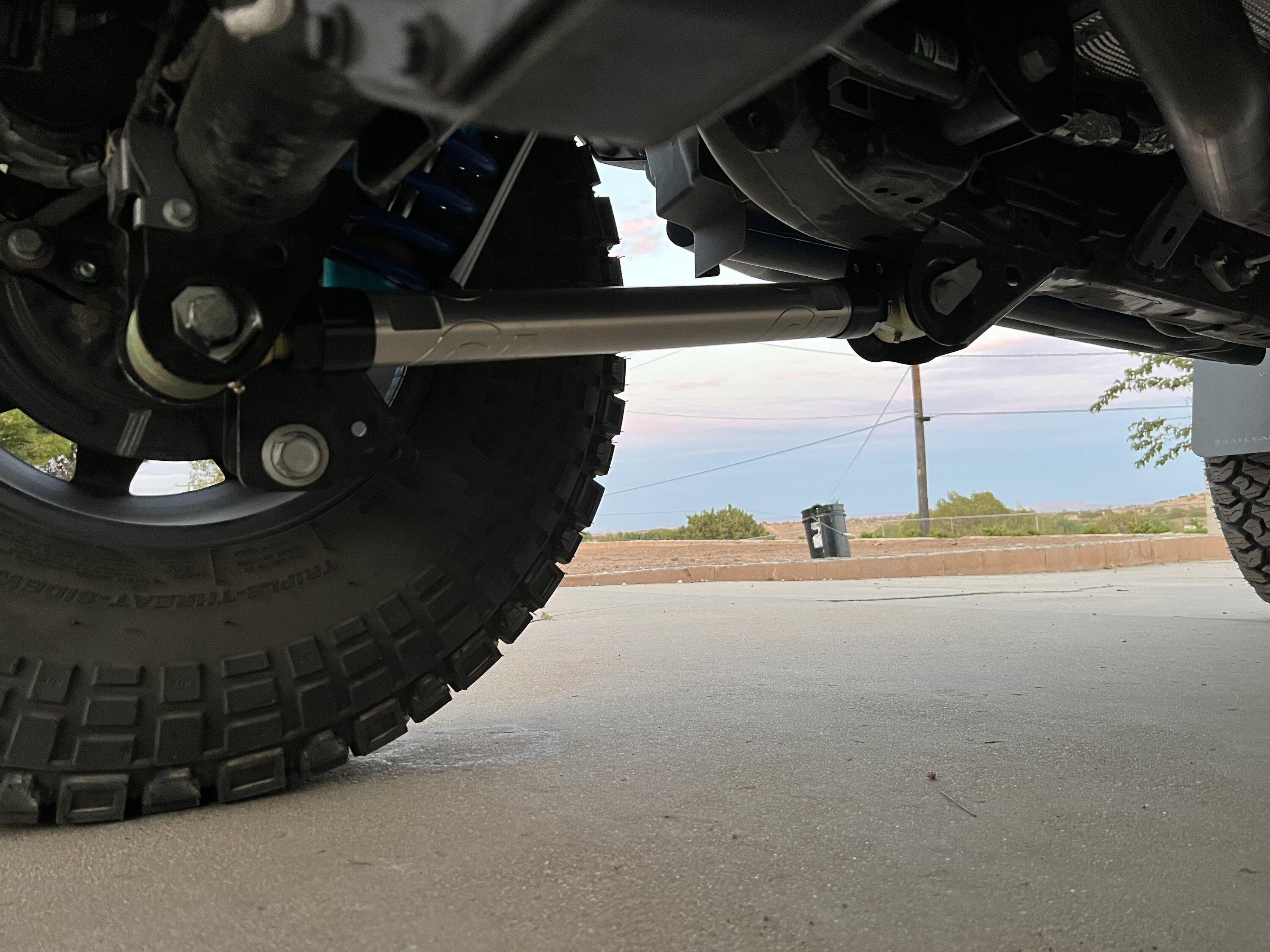

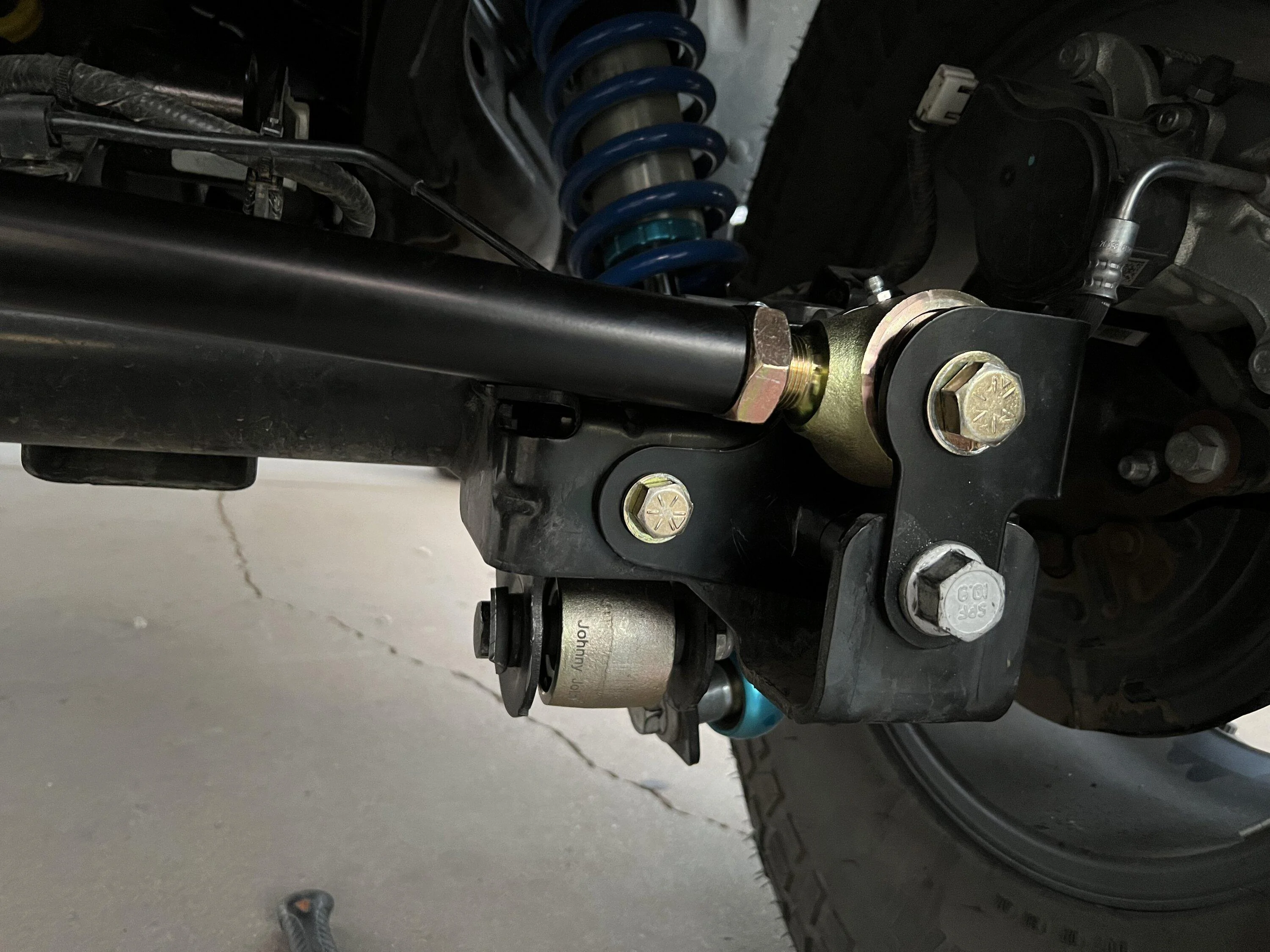

Had some time to install the lower control arms and the track bar.
I cut off the upper bolt on the passenger side. To avoid dropping the tank.
There isn’t any type of instructions on their website.
so make sure you install them
The johnny joints are axle or frame specific.
wider joint goes towards the frame

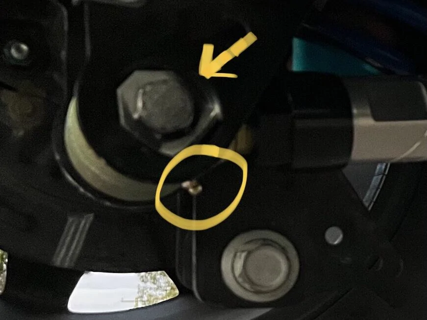

Build looks great! I’m stacking parts for almost the same suspension. Including the Rock Jock rear components.
I noticed your Zerk fitting is facing down. Was there a conflict pointing it up as shown in the product image.
I have no idea, there wasnt any instructions available.
i installed that way and was going to call them to see what they recommended.
If ran the facing up might hit, for sure will be harder to grease.
if ran facing down, can possibly shear off.

Thanks! Can you let us know what they recommend if you find something out.
ships already sailed on the Rock Jock, the part are in the pile. I’ll have to see how it works out as well. But I don’t like that fitting there, I’ll end up sheering it off. Could put on a ASFIR skid I guess.

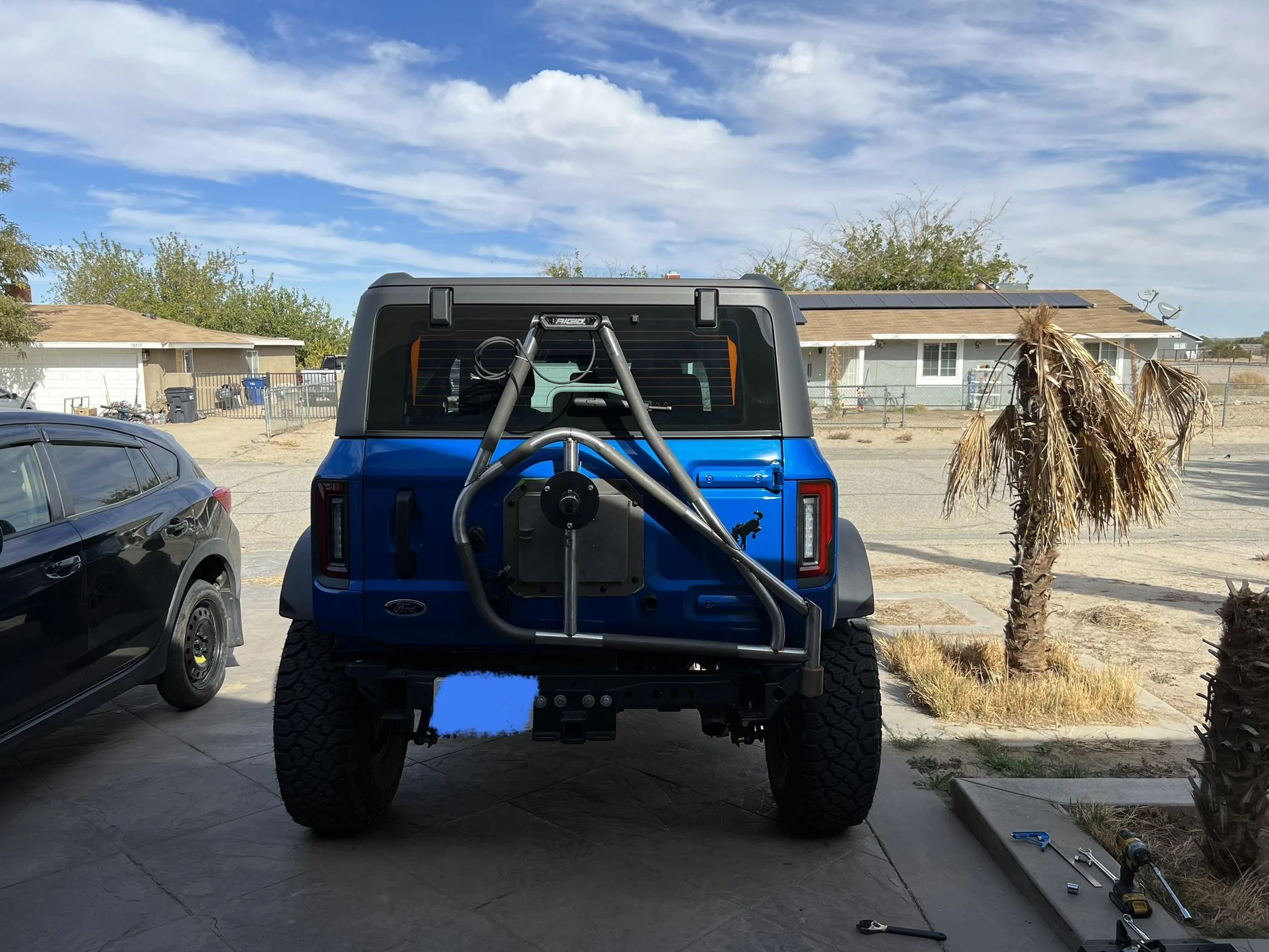

Heres a sneak peak of the tire carrier.
That my fab guy is putting together
Ford Bronco 2-door desert runner Bronco w/ custom tire carrier E203D7CE-C8F9-4847-8CD0-160308096B57
The fab work looks great. Massive load on a single pivot point with that leverage though!
