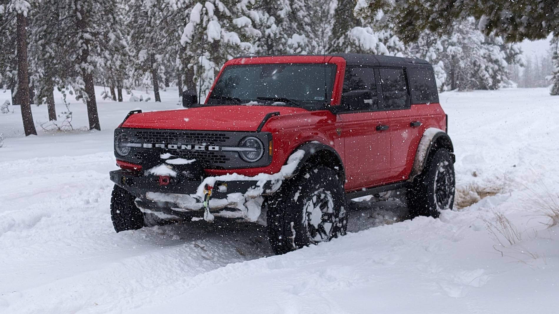

I got stuck in the snow in that 1st year and found out that the wiring harness feeding the sway bar disconnect wasn't plugged in all the way to the catch. In my process of getting unstuck, that came unplugged and caused a whole slew of problems. Actually had to go to the dealer to get everything reset as plugging it back in didn't fix it.

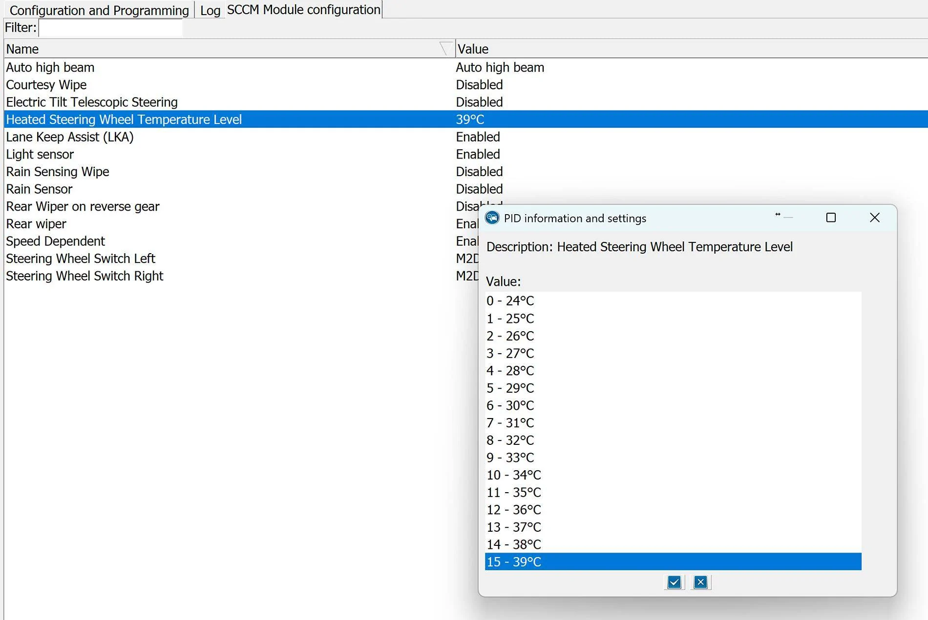

I have a loaner brand new escape while my Bronco is in for some warranty work. After dropping my son off at school the heated steering wheel turned on and feels likes it’s going to burn my hands off. 21 Bronco heated wheel like you said is barely warm.
yes i have asked a few times, and even asked if the steering wheel itself needed to be replaced and basically got a no-go on that. and my dealership is awesome, they've never done me wrong. but when your sterring wheel gets to like 90-95 degrees and your hands are that temp, well it doesn't feel hot at all.

Theres a change you can make in forscan to bring the steering wheel temp up to 102*
You go into the programming menu, click on the non as built body module ,then click the play button on bottom left, then scroll down to you see the steering wheel temp, then click on it and then edit, then you should see the drop down menu for Temps, select the temp then click write.
i will dig into that. maybe forscan has been updated with new values, cause previously i tried forscan and couldn't get it higher than 95.

nothing in body computer, but in SCCM i already have it set to 102.
Ford Bronco 2 year Bronco ownership review from a previous Jeep owner! 1731686289789-yw
still barely gets warm. but oh well lol! I've lived with it this long.
