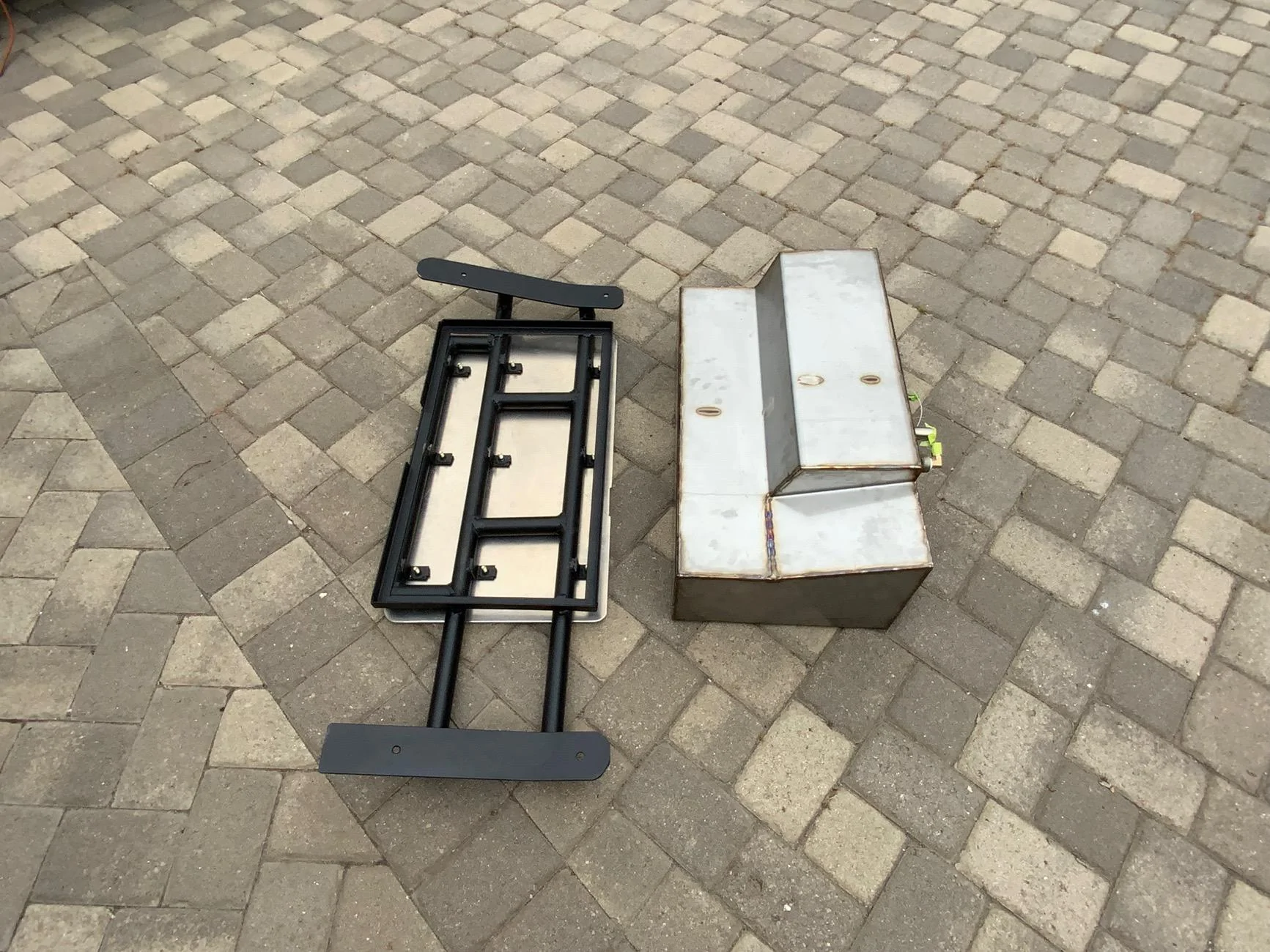

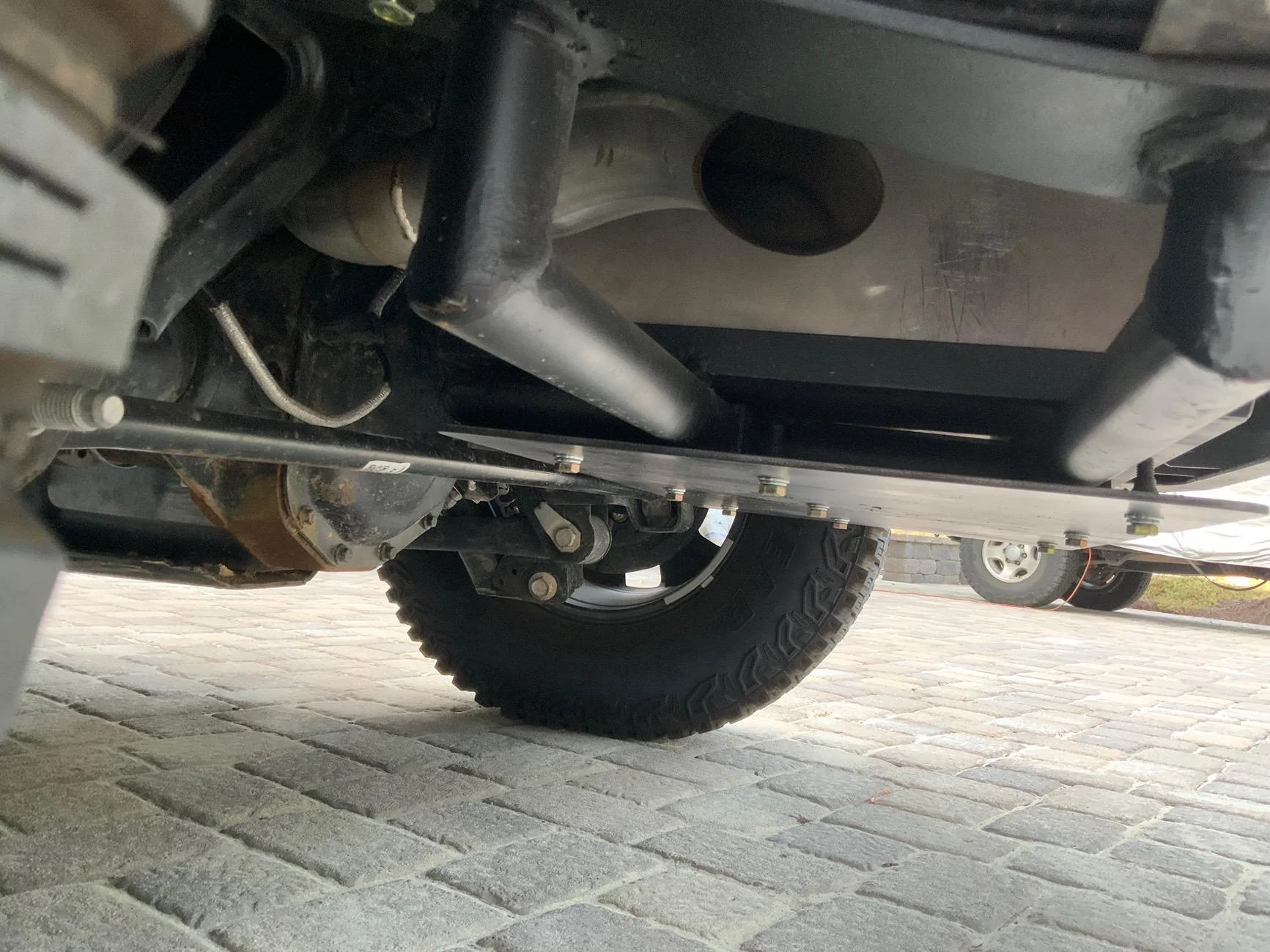

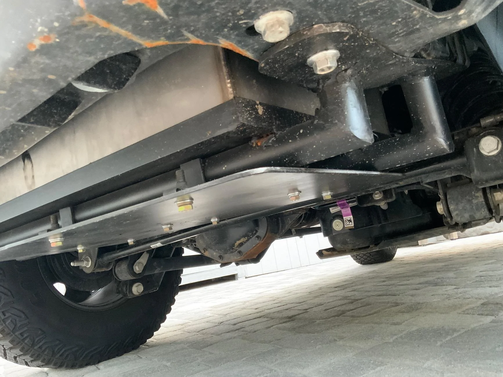

Sorry I don't have better photos.
20 gl 304 stainlesssteel tank, frame mounted steel tube cradle, 3/16 aluminum skid plate.
Electric fuel transfer pump into the main tank.
I have installed this system on several of previous off-road vehicles with great results.
The vents are tied together so pressures are equalized. No CEL or other issues.
The muffler relocation turned out slightly louder than stock but not objectionable.

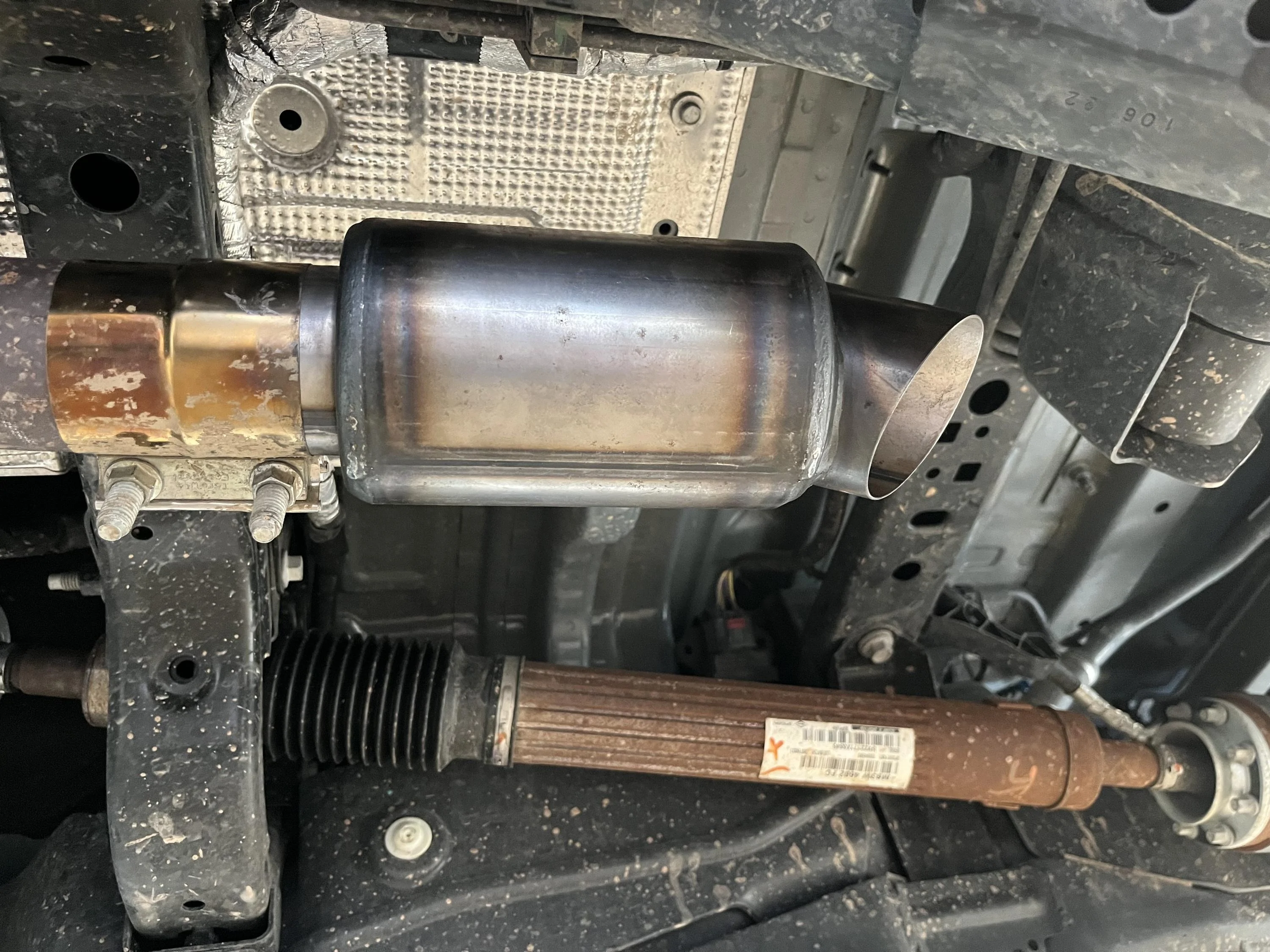

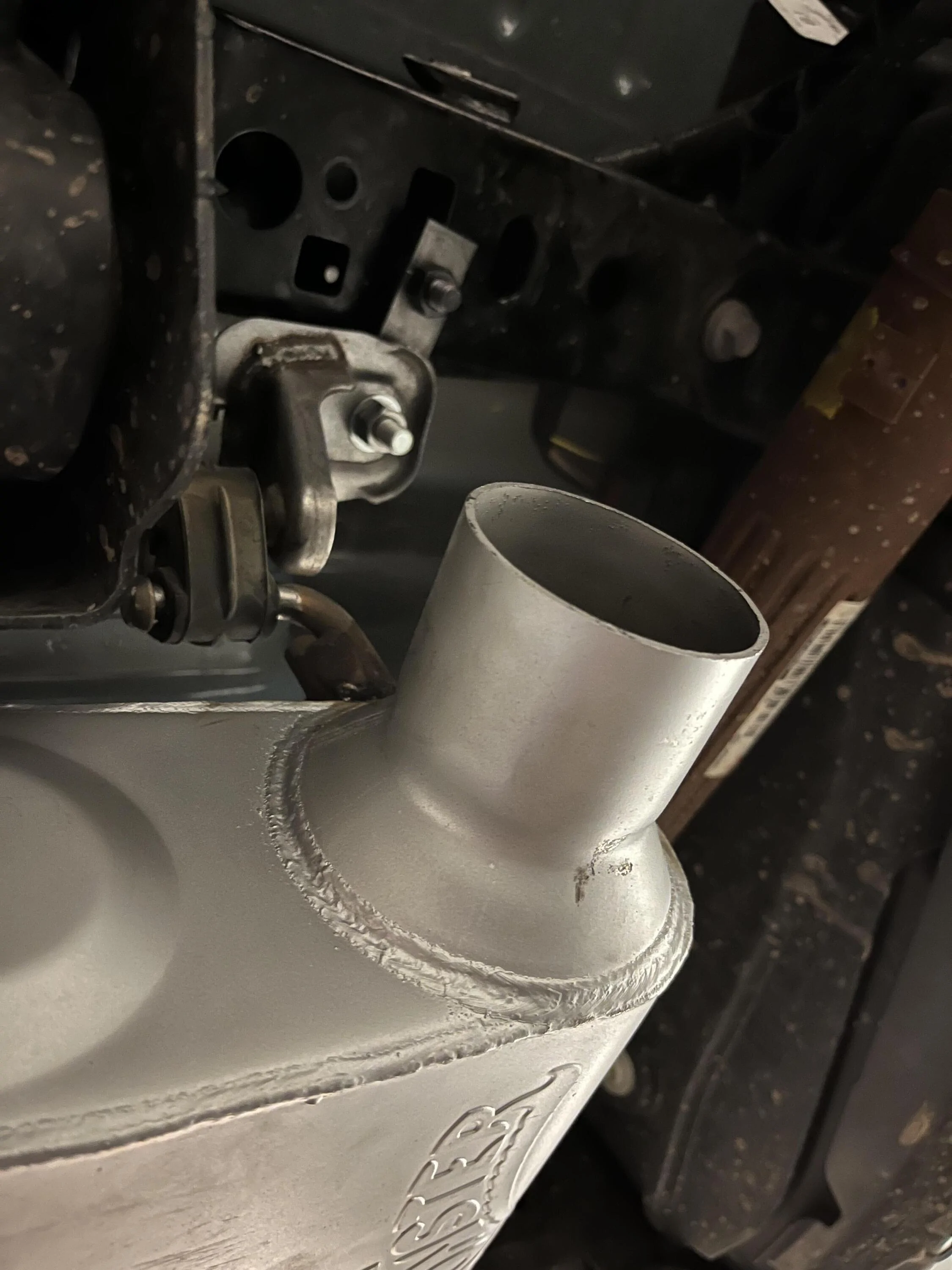

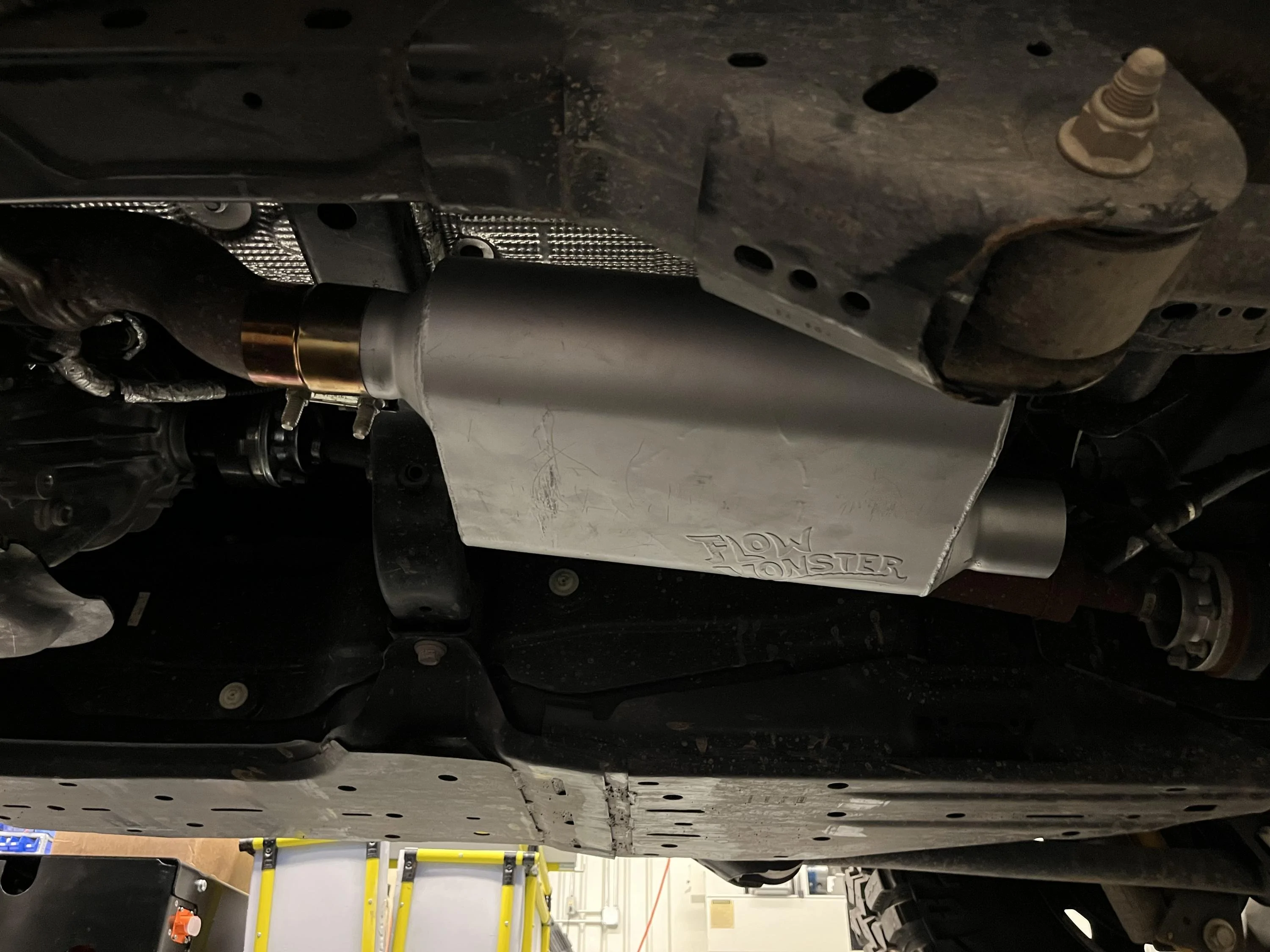

I've already got that factory muffler space wide open. Here is my current 2-chamber muffler that sounds considerably better than the typical "resonator" types.
Sounds good:
Ford Bronco 20 gallon auxiliary fuel tank installed! lKAm5mR
Ford Bronco 20 gallon auxiliary fuel tank installed! VKZ5wCm
Sounded horrible so I replaced it:
Ford Bronco 20 gallon auxiliary fuel tank installed! eRYSGZf
