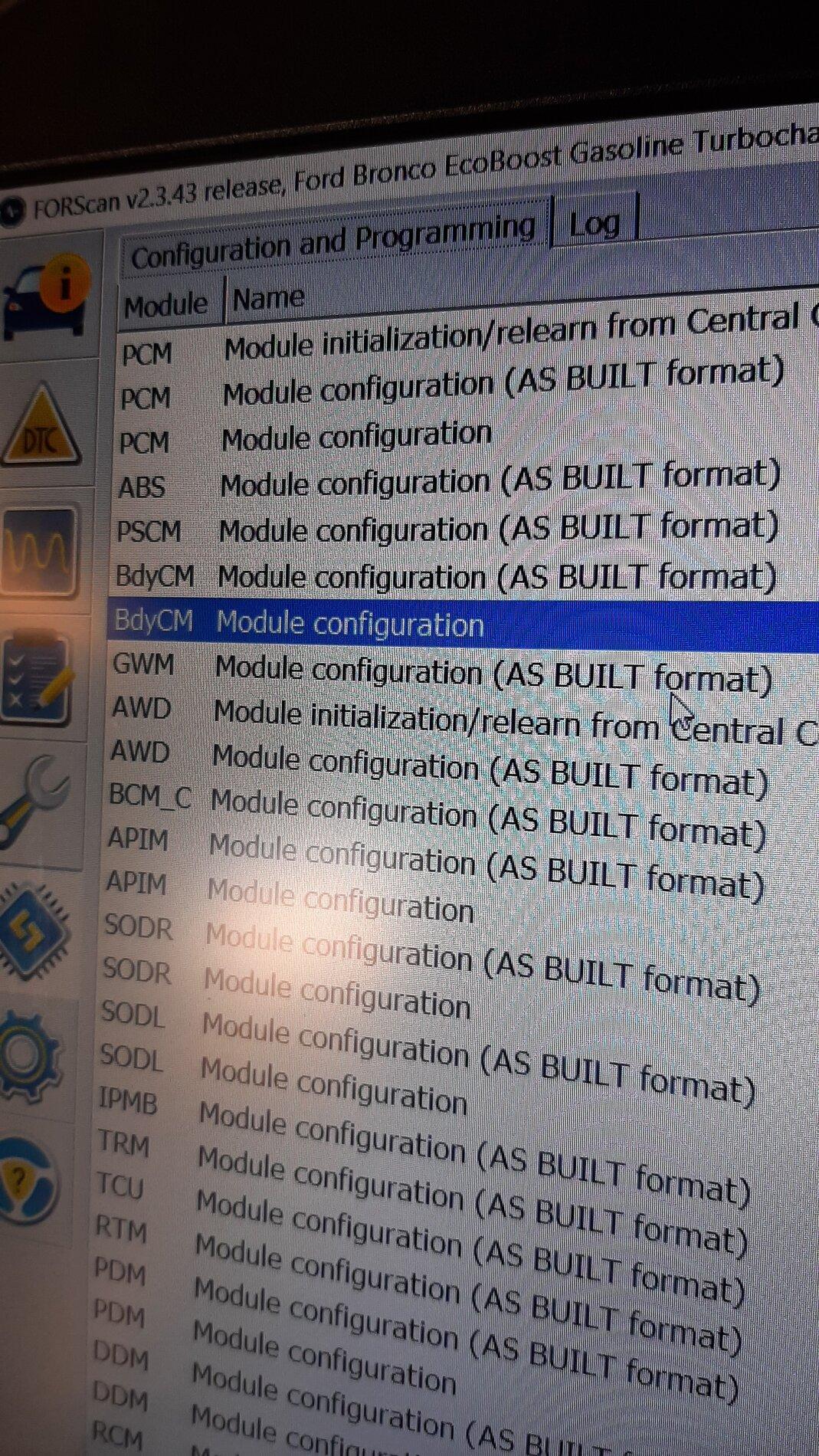

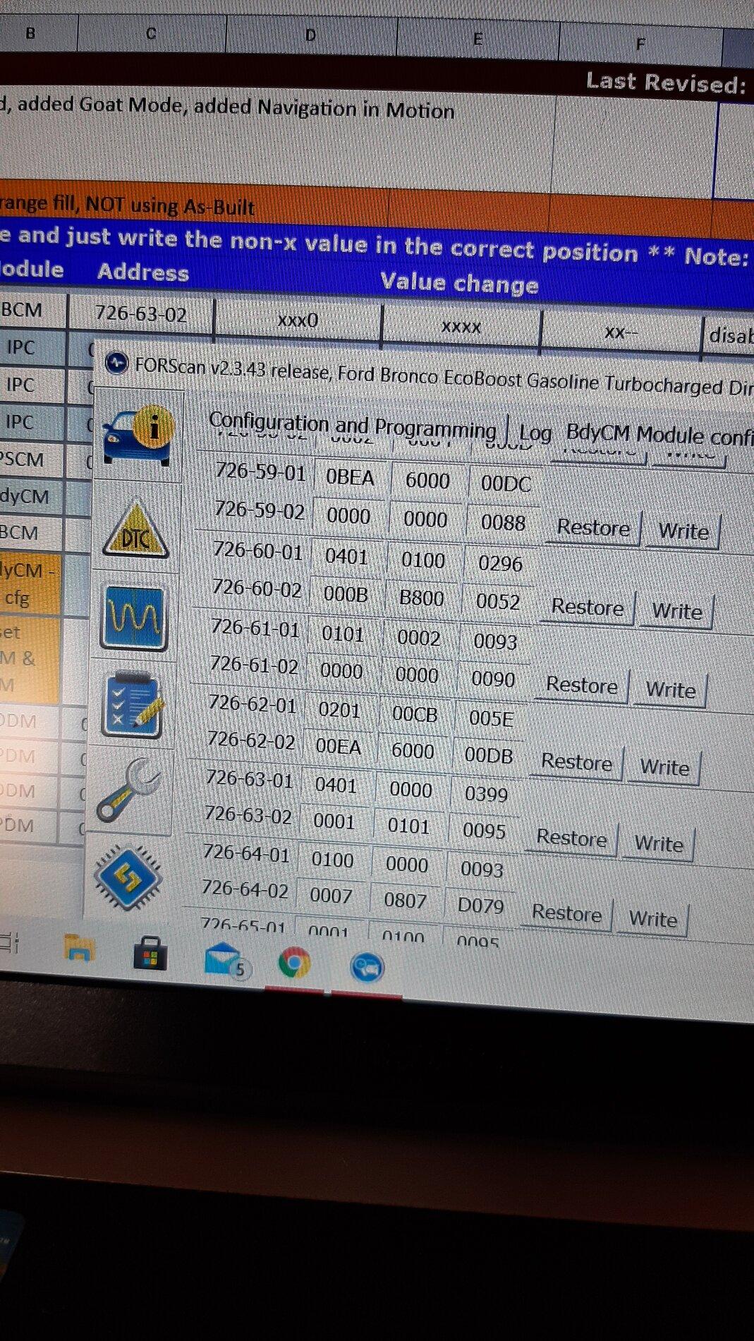

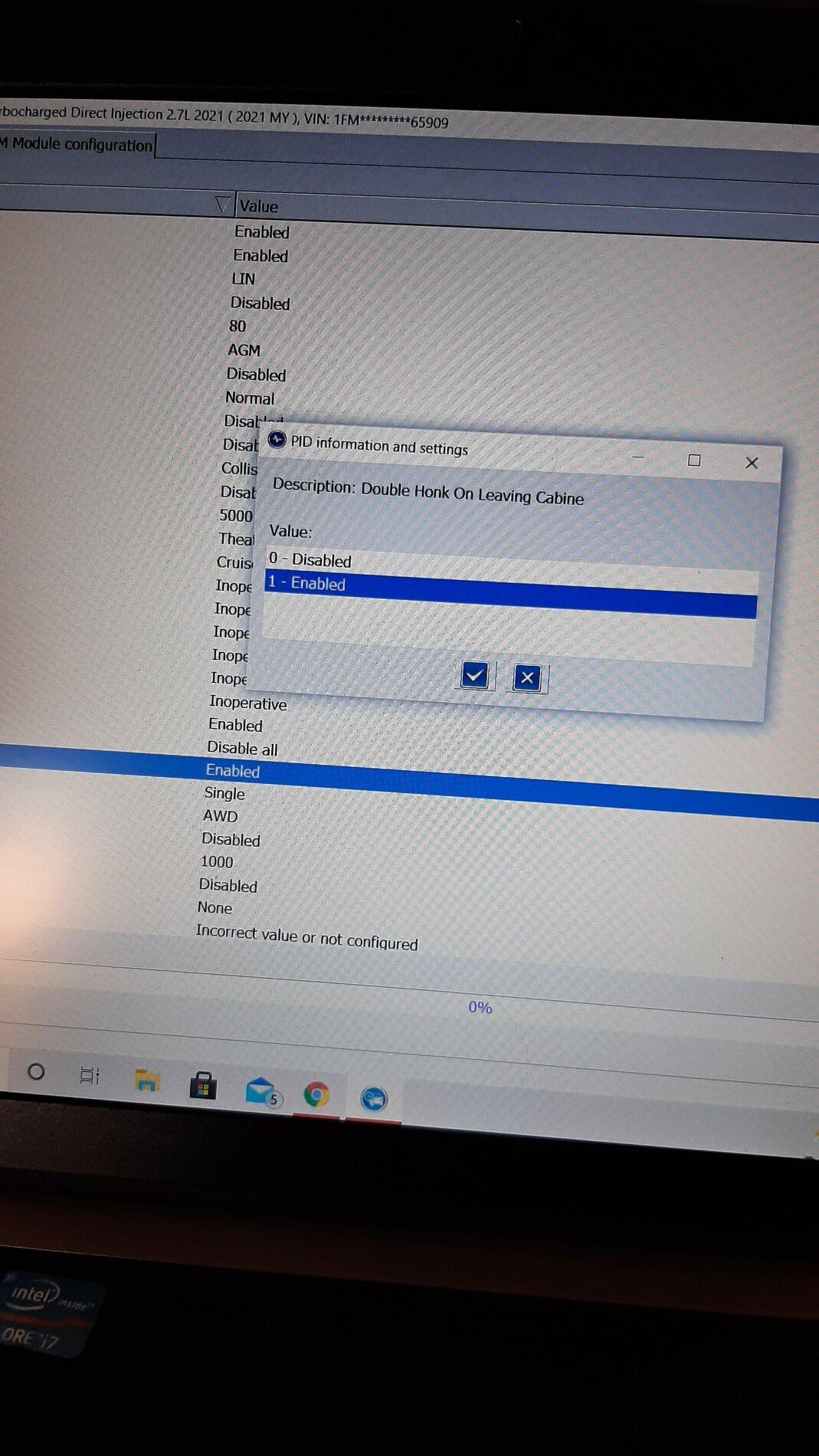

What is the difference on forscan to example disable double honk by
1.the digits to modify from forscan sheet
vs
2. Click on clicking of bdycm and click on the double feature to desabled?
vs
Ford Bronco 2021+ Bronco ForScan Thread 20211112_145901
i dont think there is a difference for most mods, but the forscan expert suggests using the advanced method to change things He says: "I recommend that you use the advanced way exclusively for a few reasons. First, there are many mods listed in my spreadsheets that cannot be performed via the plain English screens in FORScan because they require changes to multiple modules. Second, there are some mods listed in the plain English screens in FORScan that simply don’t work or will only work for a certain truck trim level." link to FORscan tutorial: https://docs.google.com/document/u/0/d/1-8dKaS_Spu4Zw4hV_CrKC4tLoP9G8yejqegF1wxIqxY/mobilebasic
