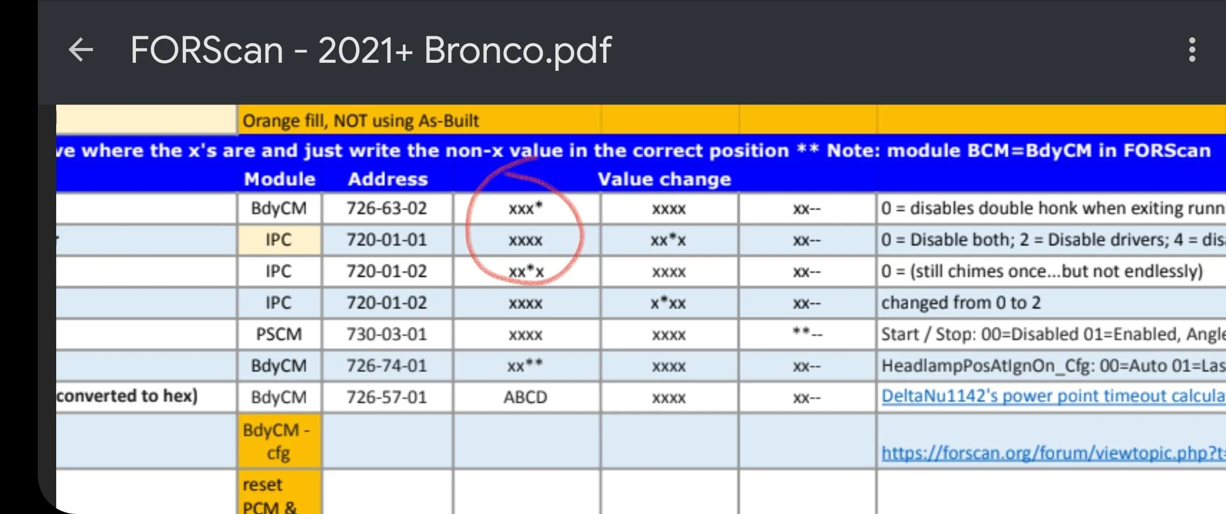

So when I see a *, that just means replace that character position regardless of what number my vehicle is displaying?
Ford Bronco 2021+ Bronco ForScan Thread Screenshot_20211206-063444_Sheets
Yes, backup everything before you make a change.
