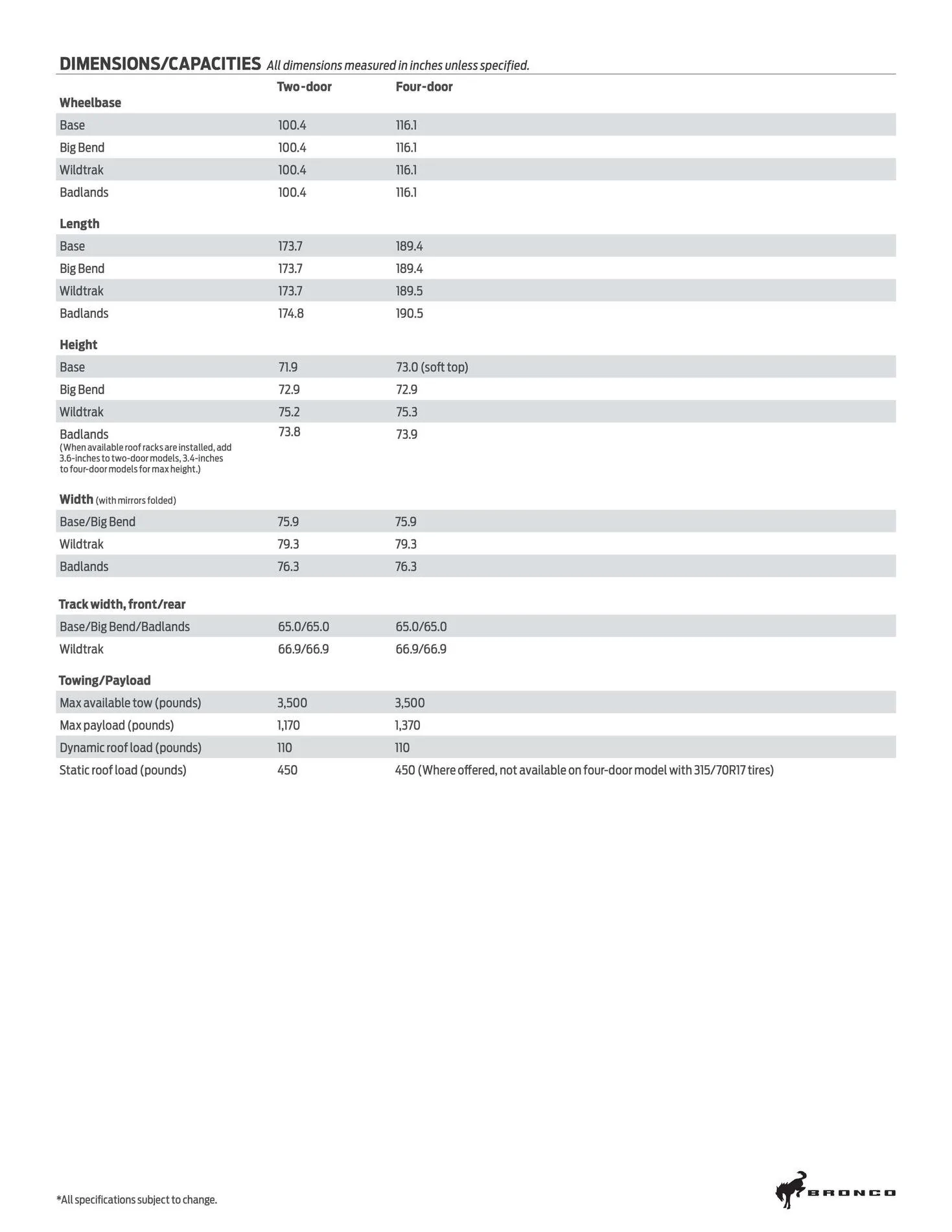

The specs for every model on Ford's website show the height to be 73.0" for the soft top. How can that be when some models have 35" tires and the base has 30" tires?
I'm trying to figure what to do to make sure that I can get it into the garage - with an open door opening of 79.5".
Looks like I can clear the soft top with a little room to spare, but Ford doesn't give the height for the hardtop. I assume hardtop is a little taller. I'd also like to get a roof rack. That may not be possible.
And the radio antenna. No way is that thing going to clear my garage door opening. I had to cut about 3" off the antennas of my last 2 F-150's. The Bronco looks like it would need far more than 3" cut off.
I assume that the radio antenna height will be a problem fro everyone with a 7' tall garage door. Is there a better solution than cutting off part of the antenna?
I may need to look into getting a few more inches of garage door clearance.

Should answer all your questions near enough except antenna. Mine are all flexible and has never been an issue going in and out of a garage.

Perfect - Thanks!

Use the Wildtrack as a Sasquatch Model (It basically is pre-sasquatched) 4 Door 75.3" Plus if you add the rack 3.4" = 78.7" A standard garage door is 7' (84"). That gives you 5.3" before you are scraping concrete.

Recommend actually measuring your door before assuming that. I have a 7' garage door, but actual opening is just over 80" after you account for the concrete 'lip' and the bottom edge of the door when you have it open.

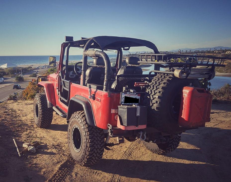

In a standard 2 car garage, I drive in my FJ40 with 35's + a suspension lift & a custom light bar with KC lights that all stick up above roofline.
I'd be shocked if the stock rig wasn't verfied to fit in a common garage (sans roof rack, lights, gear).
Ford Bronco 2021 Bronco height? overlook-01
On a side note, I'd instantly remove the antenna & cap it or go to a stubby. I loathe terrestrial radio & will never listen.
