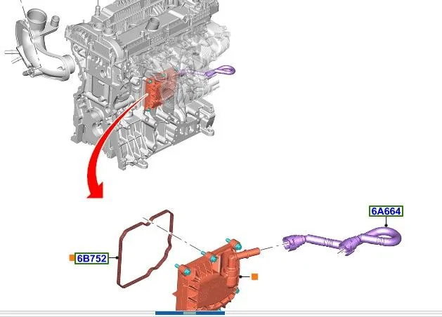

Admittedly, I don't know what California's "official" definition of an oil separator is. Both a catch can and an oil separator effectively do the same thing... they separate oil from the air.
Colloquially, an oil separator is low (basically zero) maintenance and drains directly back into the crankcase. Due to this fact, it is common to have oil separators installed by the factory, especially on high-end performance vehicles (Mustang, for example). A catch can, on the other hand, drains into the can itself. And because you have to remember to empty the catch can, vehicles are almost never equipped with one from the factory.
But in terms of CARB emission standards... by the book it needs a CARB EO number since it modifies the factory PCV system. Whether you will actually ever run into an issue during an emission test by having an oil catch can is a completely different question. Ultimately depends on how anal the inspector is.

I've also seen situations where catch cans will fail, but an oil separator on a similar car mysteriously will not fail. I assume the difference is that most oil separators bolt directly to the engine and any junk collected by the oil separator drains back into the crankcase and thus it is considered part of the engine? Maybe? With a catch can, that junk is collected externally to the engine rather than within the engine. That may be enough to trigger some inspectors. It's hard to know honestly... depends which inspector you get.

It’s worth mentioning that the oil separator hose that needs to be removed to install the fittings on your hoses is a big ol’ pain in the d!ck to access.
You need to remove the driver wheel and it helps to remove some of the pins in the wheel guard. Still it’s not at all visible and not easily accessible. You have to remove the fittings by feel and they have a very specific locking mechanism. I tried for a solid hour and gave up (it was also 20°F). But, just learned how those locking fittings work. So, I’ll give it another attempt soon.
You're ahead of the game! We have a full install guide in the works as well that will help give some guidance on these fittings!
