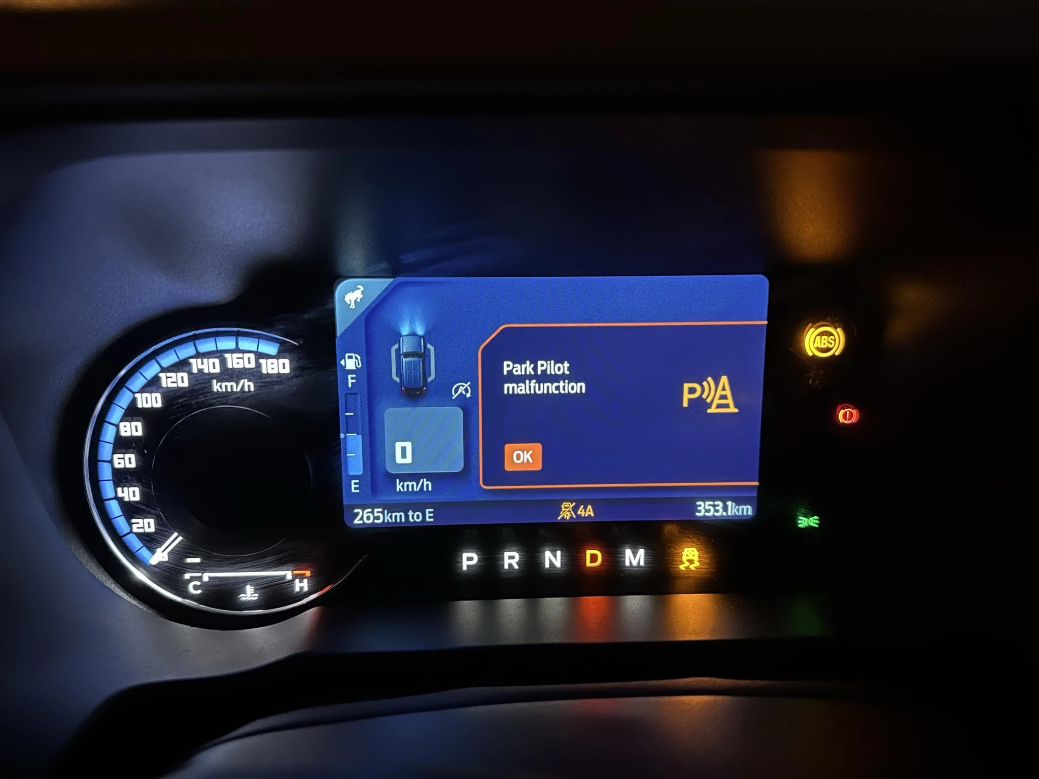

Ford Bronco
My Wildtrak arrived two days ago. About 120 miles later, I got multiple faults (ABS, Pre-Collision Assist Not Available, Drive mode not available, Trail control fault see manual, ESC service required, Park pilot malfunction), so I could no longer change GOAT modes or use ACC/LKA.
I have a service appointment in 9 days, but has this ever happened to anyone else?

nope, nothing like that. hope nothing serious.

Does sound familiar. Probably worth checking the connectors for each wheel speed sensor while you wait. Also, @flip can probably look at your codes if you send him your VIN.

Fixed one today with a similar issue. Corrosion on the left rear wheel speed sensor connector.
Hopefully it's something easy for you also and your dealership can get it fixed quickly.

Update: problem fixed after returning from dealership. They simply reset ABS after finding no mechanical or wiring issues.

So glad I’m not the only one. Had her 7 days and it’s constant now, everytime I go around a curve it up/down a hill.

Mine done this today , said rear rh speed sensor fault. I pulled the rear sensor and found a few small metal shavings stuck to magnet , I cleaned the sensor and reinstalled, drove about 1/2 mile and codes cleared . Simple task with a 1/4 drive ratchet and 8mm socket, took less than 5 min .
