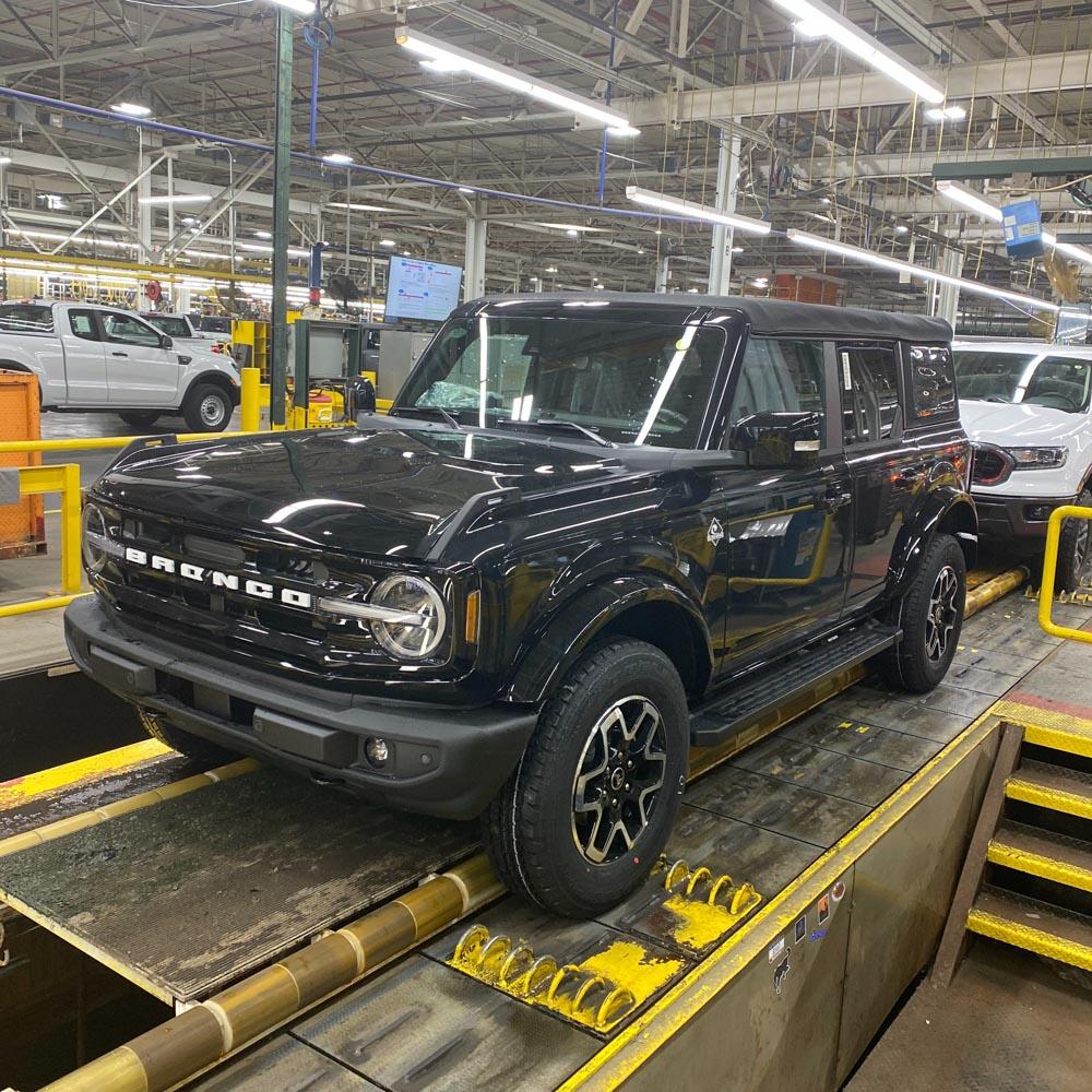

Here is where we started...factory line photo!

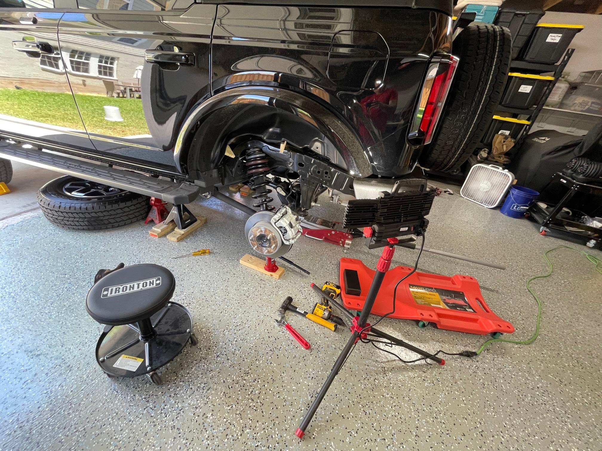

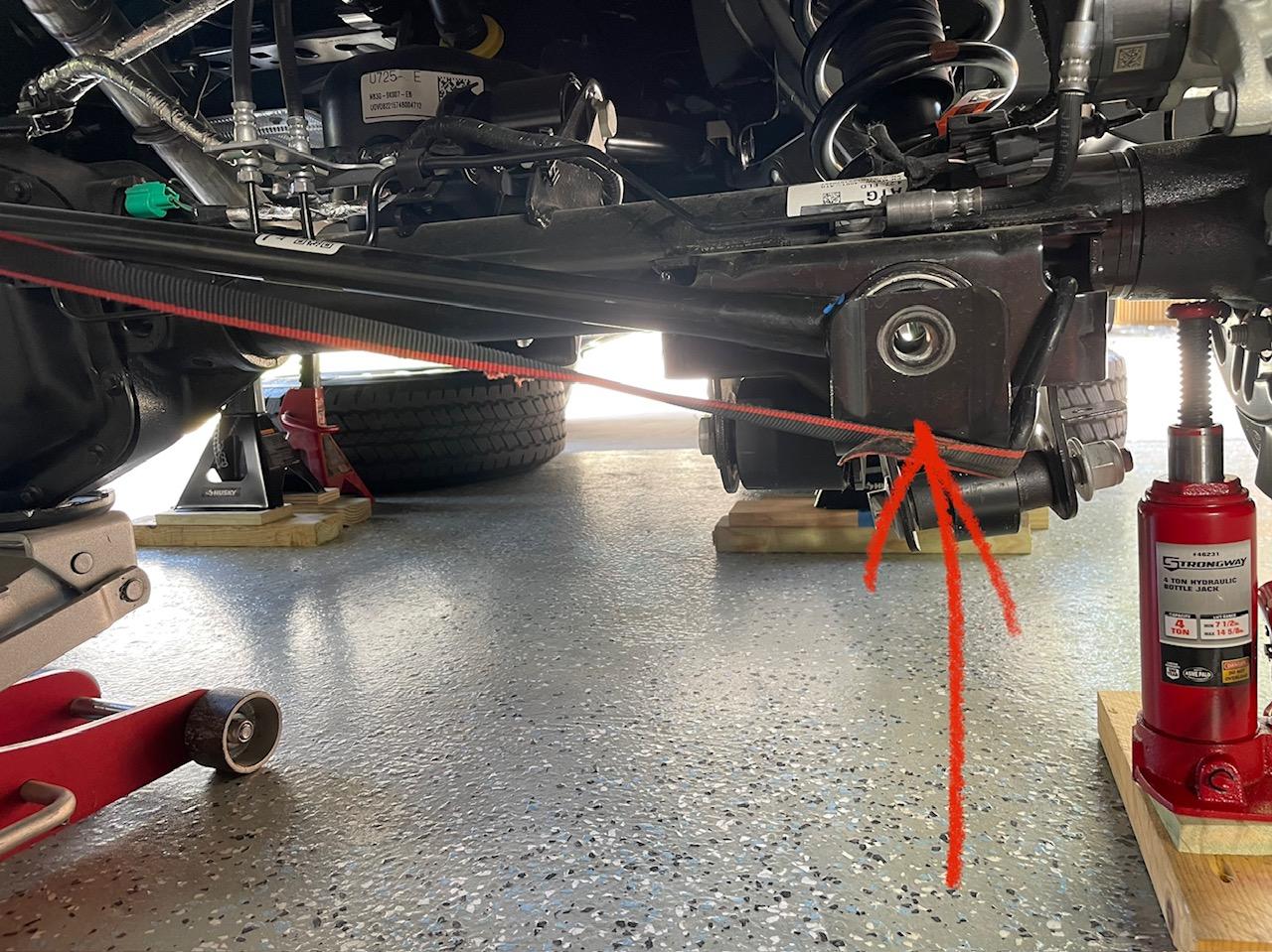

Rough Country 2" spacer lift:
Within days of receiving, I rolled it into my humble garage and installed the 2" Rough Country spacer lift. Took me pretty much a full day's work doing solo (split across 2 days). Only had a few small challenges, but overall went smooth. I opted to go the route of removing the front LCA vs the instructions of removing axle nut. I researched the pros and cons of both options and this is where I landed. I used this video for my main guidance.
I would say I only had 2 real challenges.:
-#1 - It was challenging getting the rear struts back in there after attaching the spacer....space is tight and no one really mentions that you rotate the strut to reinstall.
-#2 - It was challenging getting the rear sway bar back into alignment. I ended up using a combination of a floor jack under the diff, bottle jack under the passenger axle + ratchet strap to kinda winch it over for the bolt alignment. Super janky, but it worked.
Ford Bronco 2022 Outer Banks (Non-Sas) Build - Wife's Daily Driver - Blacked-Out IMG_7440
Ford Bronco 2022 Outer Banks (Non-Sas) Build - Wife's Daily Driver - Blacked-Out IMG_7442
Here are some measurements. I was pretty happy with the outcome of the kit...got me exactly where I wanted it

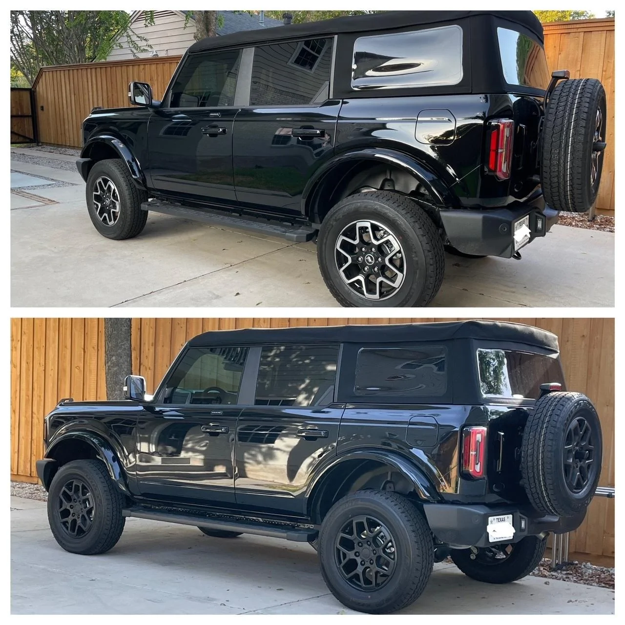

Bit of a story here. The rims we wanted were on serious backorder everywhere. @Discount Tire has always treated my right, so I ordered a package deal from them and started the waiting game.
In the meantime, I wanted to preview what it would look like blacked out. I bought a Hyperdip $130 Wheel Kit + 1 extra can for the spare(higher-end line of Plastidip). Cleaned wheels and got to spraying. It made an absolute mess. If you are going to do this anywhere besides over dirt/gravel, lay down plastic. Lots of plastic. I did it with the wheels attached, but not sure I would do it that way again...had to tape+plastic lots off. Best to do it upright so the cans spray properly, but made a mess regardless. Cans sprayed splotchy, finish was hard to perfect, etc. But it got the job done as a temporary solution. Here is a before and after pic (lift already installed).
Ford Bronco 2022 Outer Banks (Non-Sas) Build - Wife's Daily Driver - Blacked-Out IMG_7635e

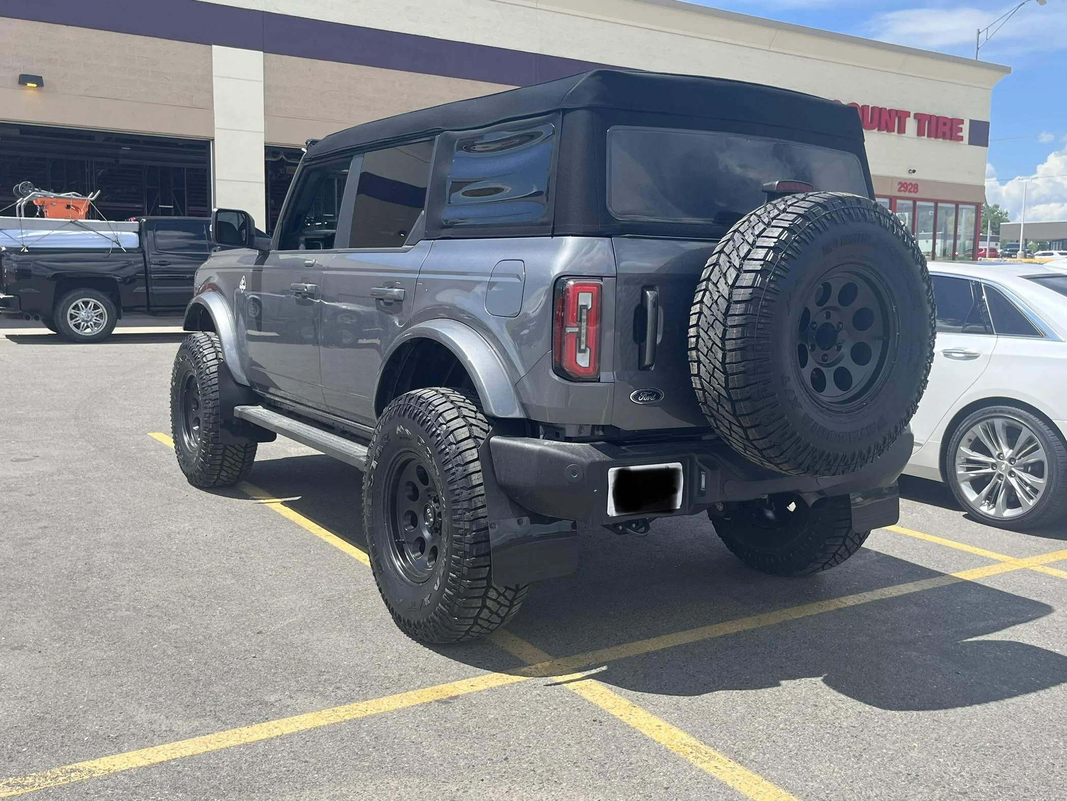

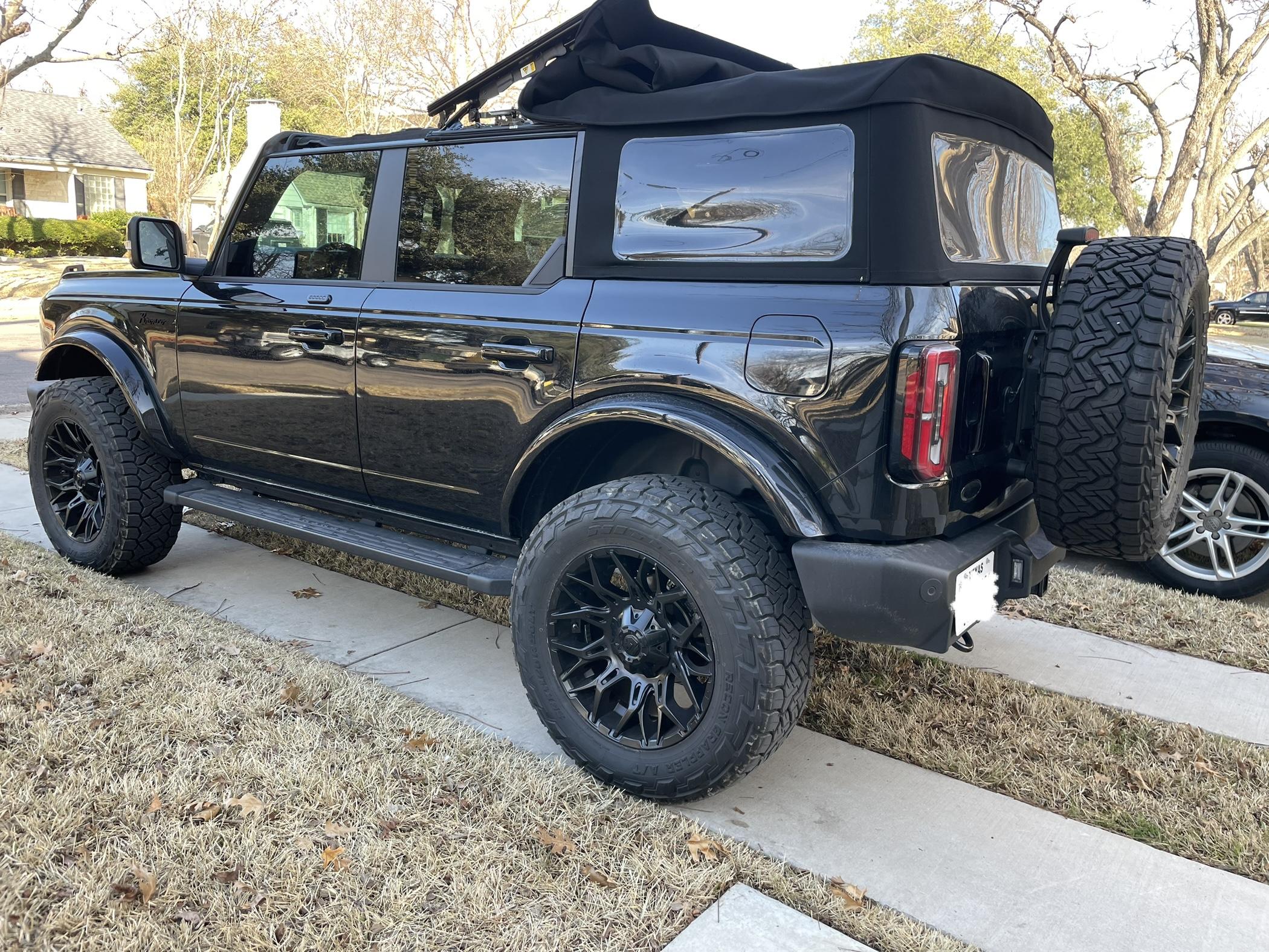

After a few months of lead time, the wheels finally came in. It was now time to mount up and install. Here are the details:
Wheels = Fuel Twitch 20x9 +01 offset (D77220909850)
Tires = Nitto 35 x 11.50R20 Recon Grappler (218-090)
- I went with the 11.50 width over the "standard" 12.50 for a few reasons. Mainly it was a weight play. These were about 10lbs lighter...less weight on vehicle components (steering, drivetrain, tailgate, etc). Didn't need the heavier ply and extra inch....like the way these poke, but not too much. Still tall, but not too fat. Came out right where I wanted in my personal opinion.
- Skipped the Spare Tire tailgate reinforcement. No sag, currently no issues. I did, however, use a 2 black racquetballs for as spacer wedges for the bottom stabilizers....it works great and takes some pressure off when slamming the gate, hitting some bumps, etc.
- Here are some more pics the day we got them installed:

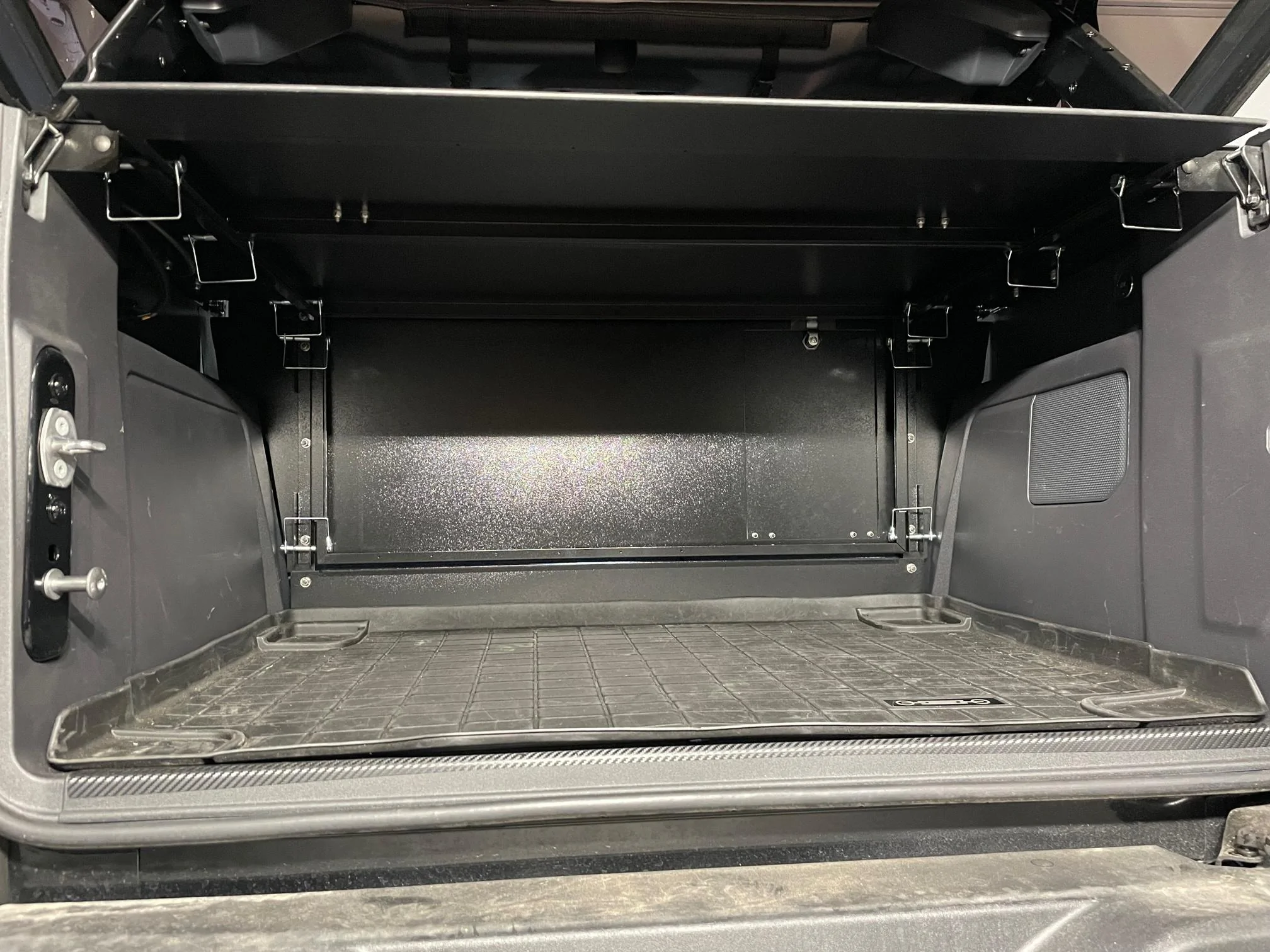

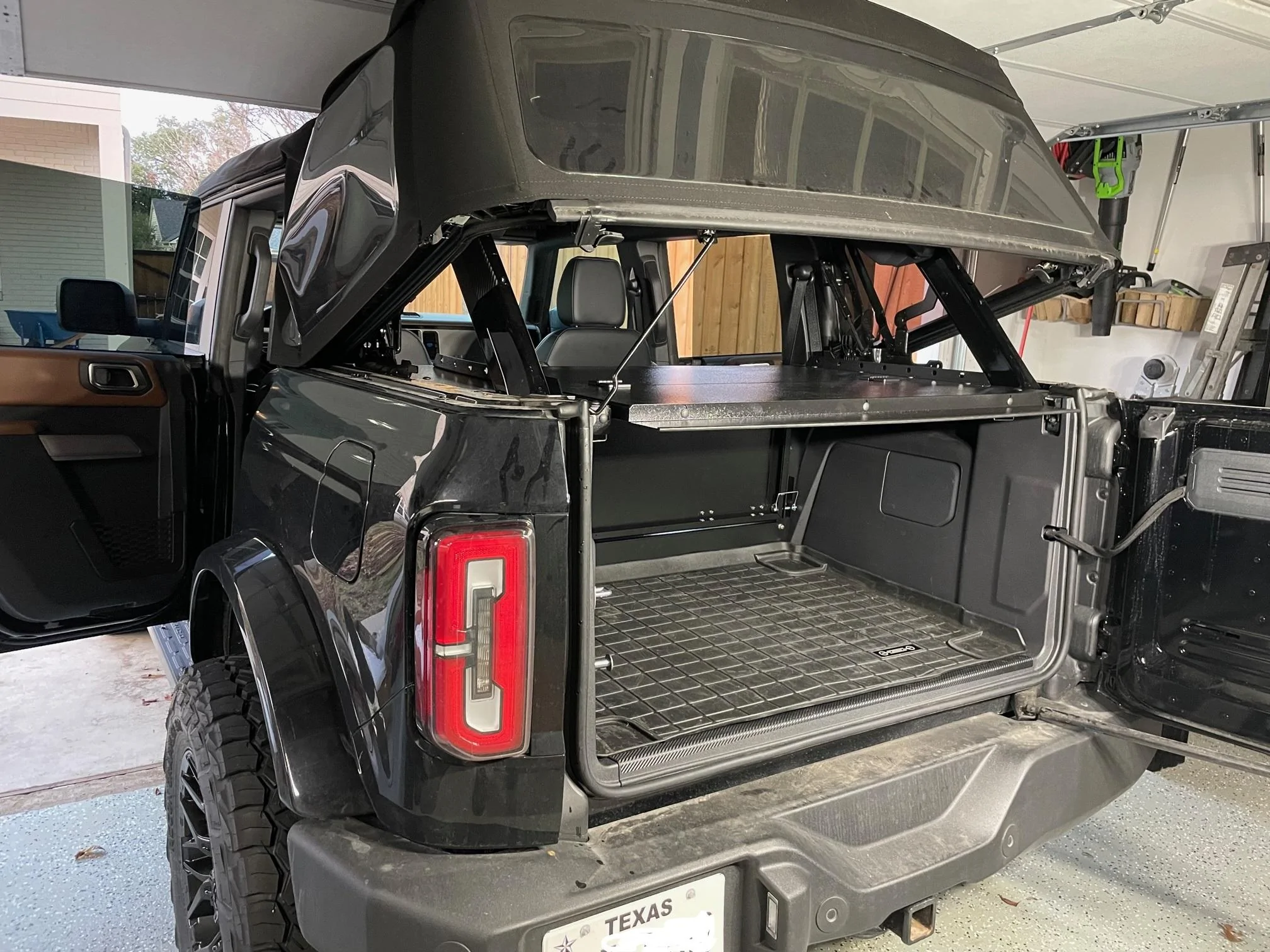

Diabolical Slipstream Cargo Enclosure
This was a tough decision for me. In the end, I saw value in the design and flexibility of the Slipstream system over the OEM (Tuffy) options. I was leaning towards the Tuffy raised lid version, but once I realized the process to remove the front wall, I moved onto the Slipstream.
Slipstream is a good product...sturdy and durable materials, made in USA, helpful and engaging owner, excellent design/engineering, impressive packaging, etc. However, it has some drawbacks. The installation is a 4+ hour, serial process of following along and piecing together multiple installation videos (soft-top option). Lots of alignment to get things right.

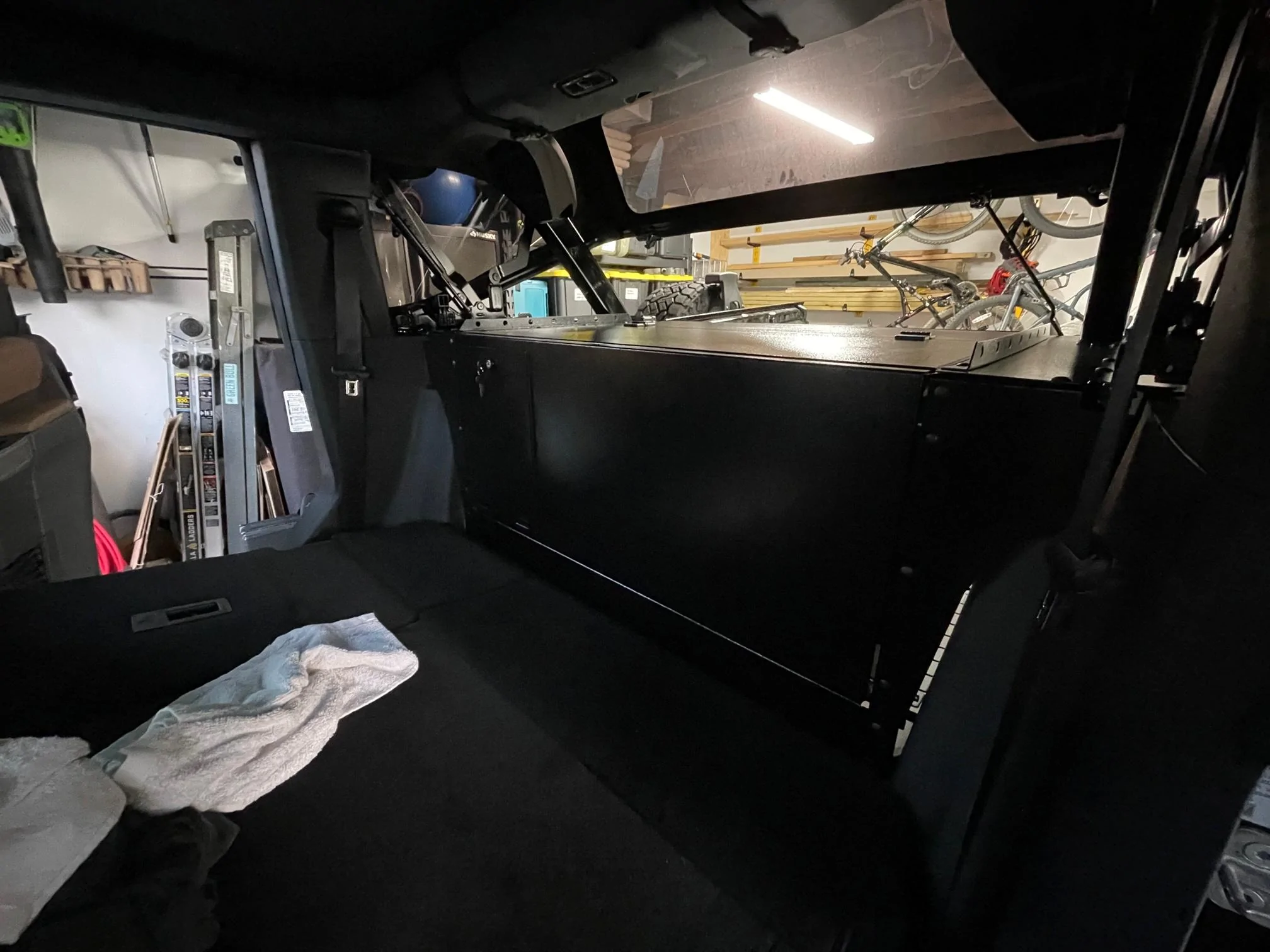

My number 1 complaint was overcoming the rattling challenge. I watched the "Slipstream Maintenance" video, I scoured the forums, I searched for any and all options. This thing rattles once installed...there should be no debate around that. The metal on metal, the enclosure lid, and most notably the quick-release pins. After days of incremental improvement and test runs I got enough additional foam padding spread out, bolts tightened, and Plastidip'd the pins to finally get it to an acceptable level. It is finally quiet, but the pins are now extremely challenging to pull out due to my rubberized coating hack, but it's a trade-off to keep the rattling down. Perhaps others don't have this problem or found a better way to solve it? I am still torn on if I should have just gone with the Tuffy brand, but time will tell to see how often I fold down the front wall and/or remove the lid with the Slipstream efficiencies and superior design/engineering.
Regarding the foam padding on the top....Wife didn't like the Diabolical skull logo and I didn't like the price. I later purchased some Marine foam decking off Amazon (https://www.amazon.com/gp/product/B09GVC1RVN/ref=ppx_yo_dt_b_search_asin_title?ie=UTF8&psc=1), cut it, and installed. Worked great for my needs.

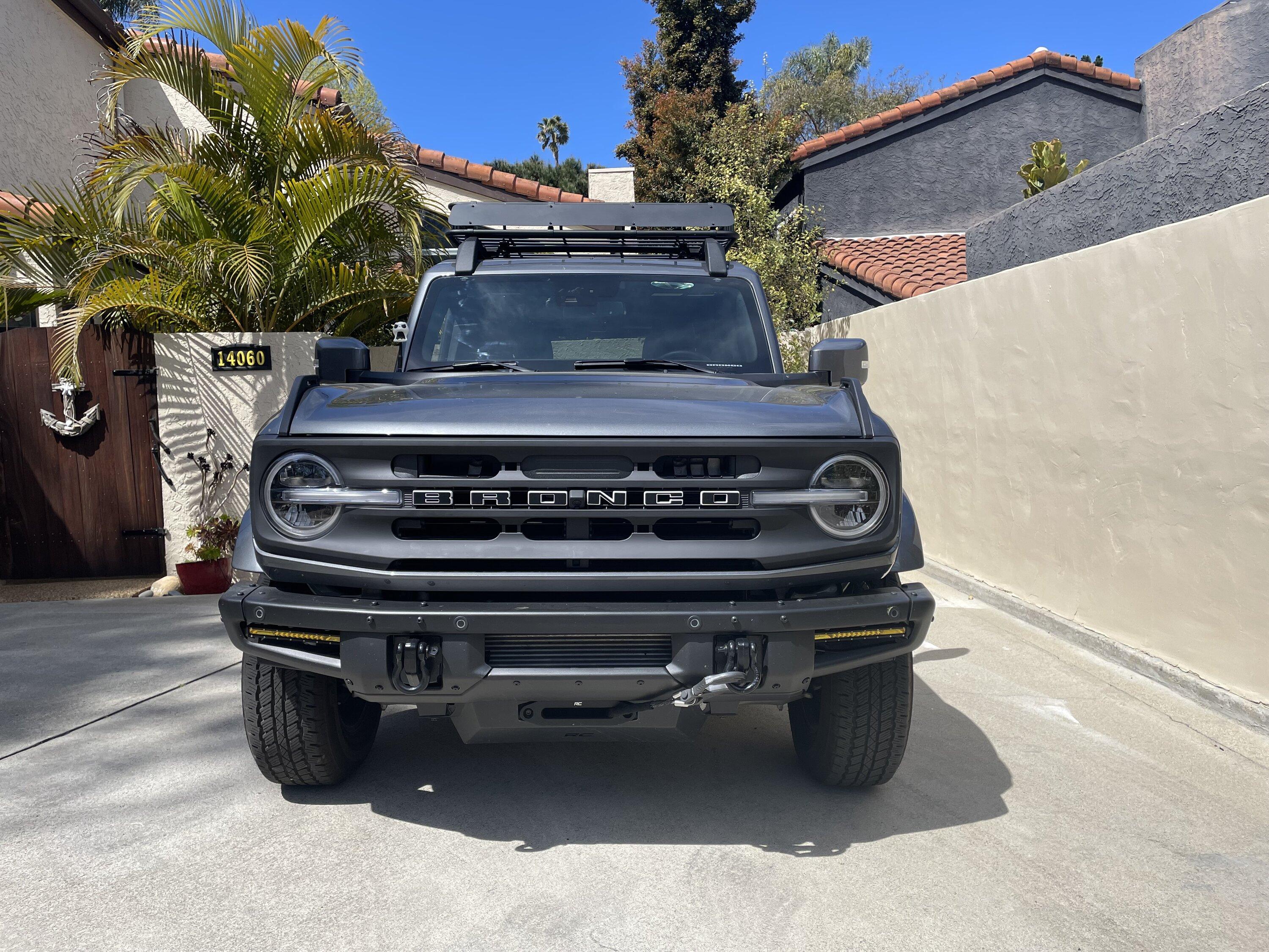

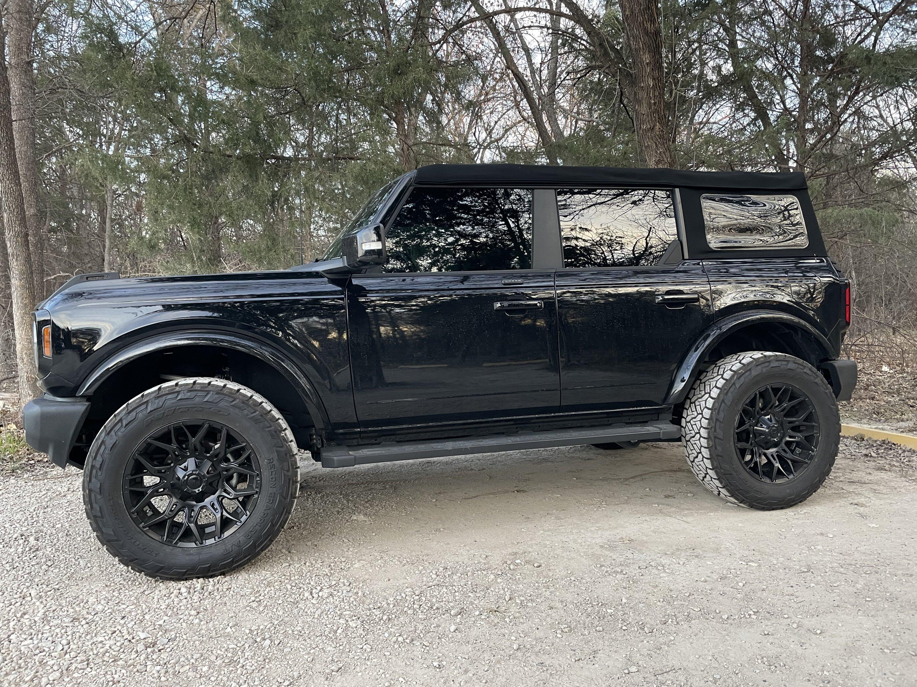

You should add the grill inserts, fairly inexpensive and look pretty decent. like this:
Ford Bronco 2022 Outer Banks (Non-Sas) Build - Wife's Daily Driver - Blacked-Out IMG_2291

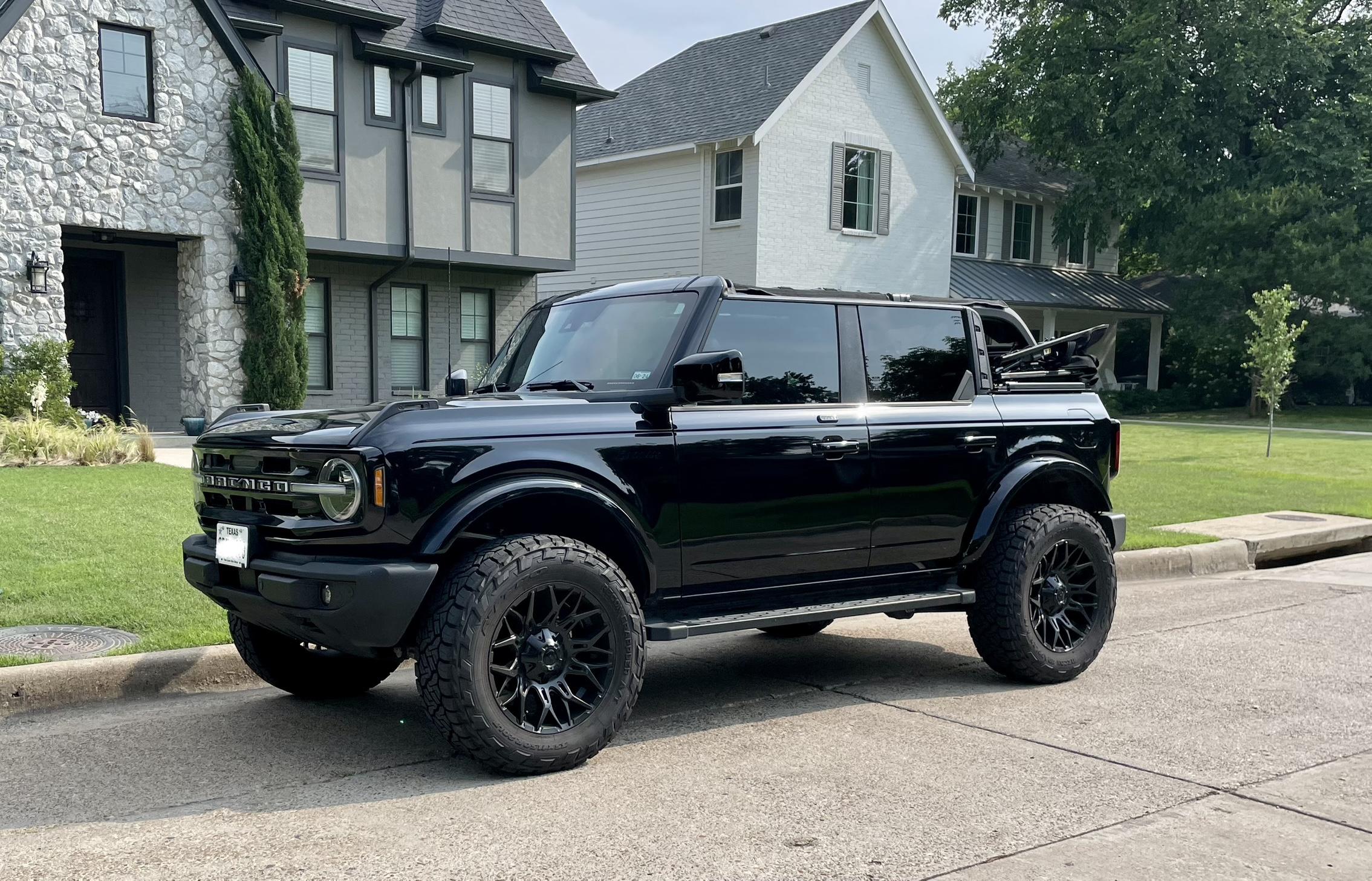

Thanks, those do look good. Here is a pic from the front after I put on the Tufskinz. I'll research the inserts...thank you!

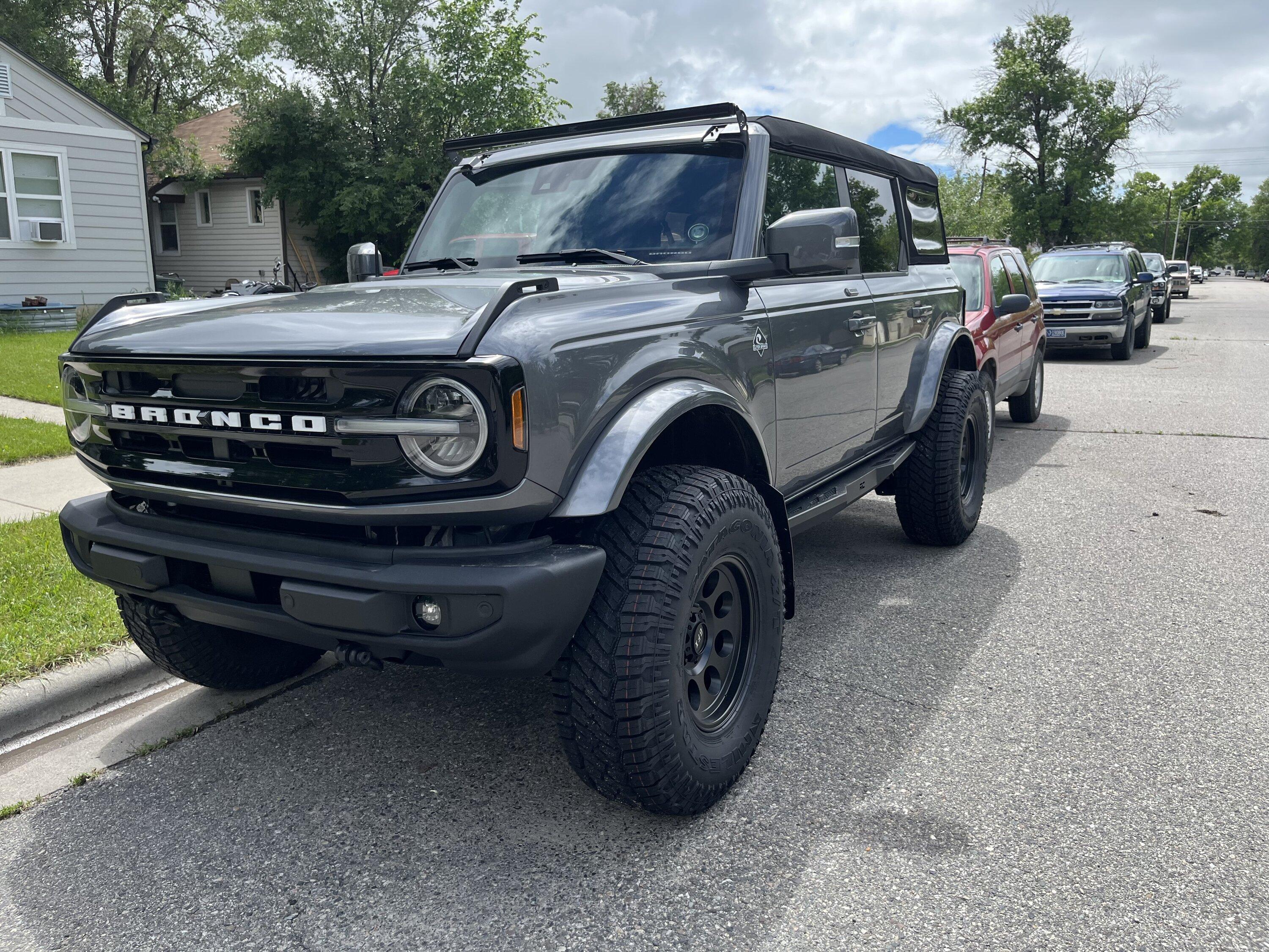

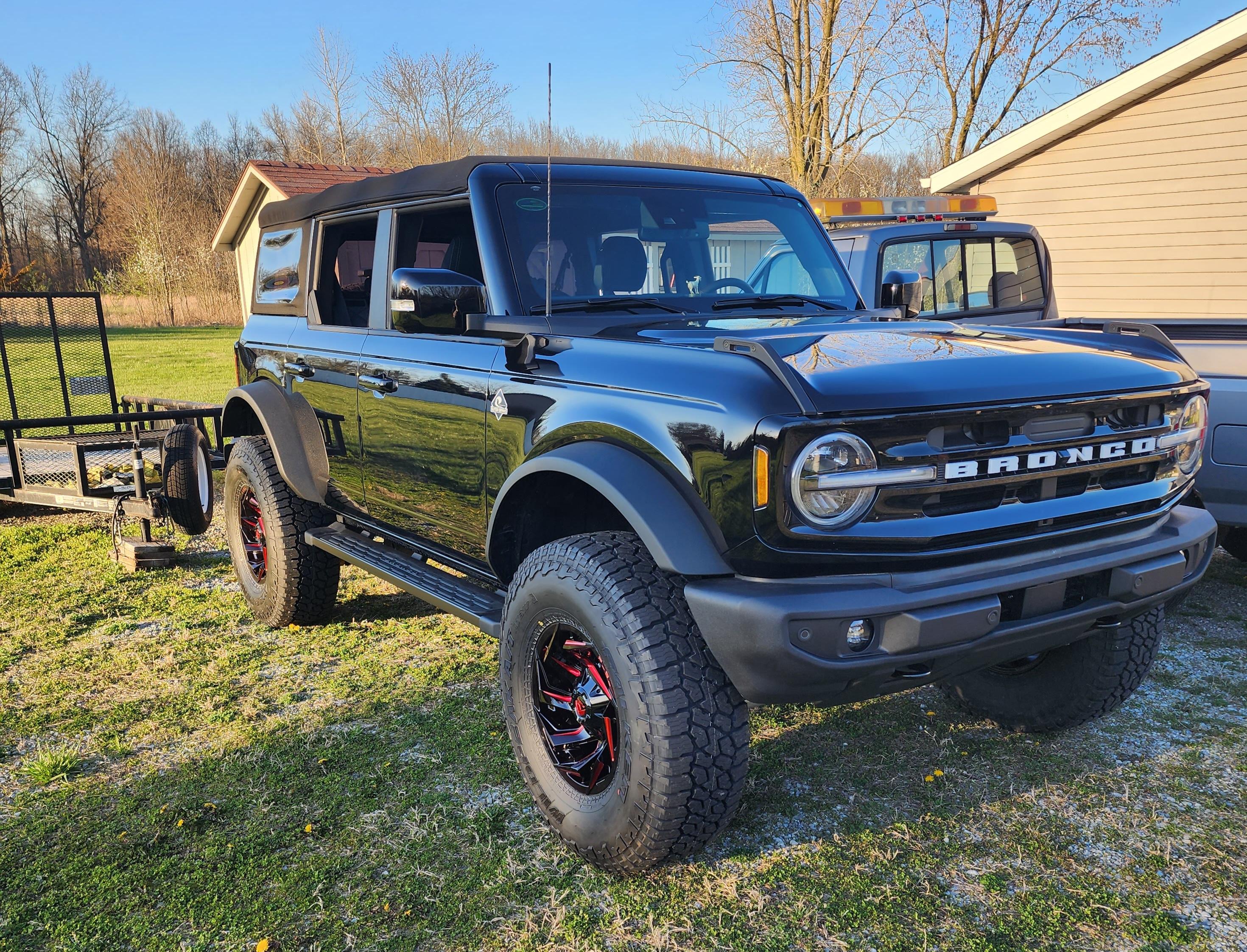

I like your choice of tires and rims, thanks for the pics. Have you considered replacing the running boards. I replaced mine with OEM Rock Rails and IAG Steps.

Wheels and Tires
Ford Bronco 2022 Outer Banks (Non-Sas) Build - Wife's Daily Driver - Blacked-Out IMG_1699

Wheels and Tires

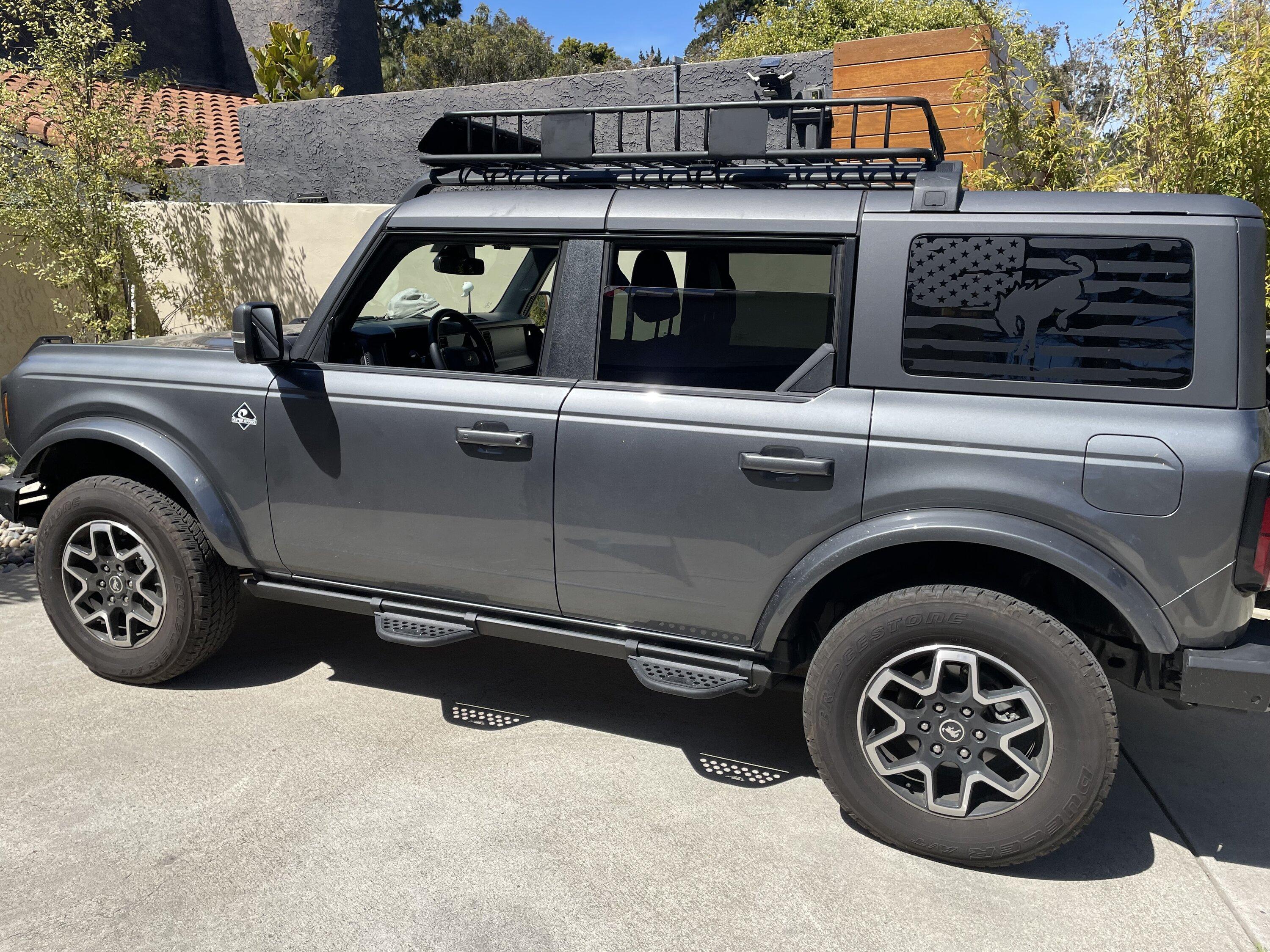

Looks awesome! Here is my 22 OB SAS, so far!
Ford Bronco 2022 Outer Banks (Non-Sas) Build - Wife's Daily Driver - Blacked-Out 20230412_191636

I love yours. I almost went with black but I they wouldn’t come down in price the same as they would this one since it was on the lot longer. They even went up on my trade in since I told them I was settling with this color, even though I still liked it. Mine is a 2023, and the wife got a matching 2022. Only difference other than year is hers is the Lux and mine is High. I’m not done yet, but I’ve been taking photos. I might need to do the same! Great idea and enjoy the completed ride!
Ford Bronco 2022 Outer Banks (Non-Sas) Build - Wife's Daily Driver - Blacked-Out IMG_0980
Looking good! Love those sliders. Question for you - What front splash guards are those on the front fender and do your recommend? Nothing worse than having a fresh wash and hitting a tiny puddle. The curse of offset wheels....
MikeM173
May 15, 2023
Montana
2023 Bronco
The wife has Mabett on hers and they have worked well. After ordering and installing I found the Ford ones cheaper. I’m not sure if they are better quality or mount nicer or not, but the Mabett ones she likes and they have worked.
I have Rallyarmor. I intend on doing some rock crawling with mine and wanted a something that would still hold up. After getting these installed I’m sure I’ll end up ripping these off eventually. The hard plastic sits a little too low, so I’m sure it’ll get caught still. If I was going for just looks, they look great in my opinion. Especially with the wider stance from the different offset. They helped catch that, and it’s at least saving my paint in the mean time.
Posted a better picture of them so you could see if you liked them as well.
