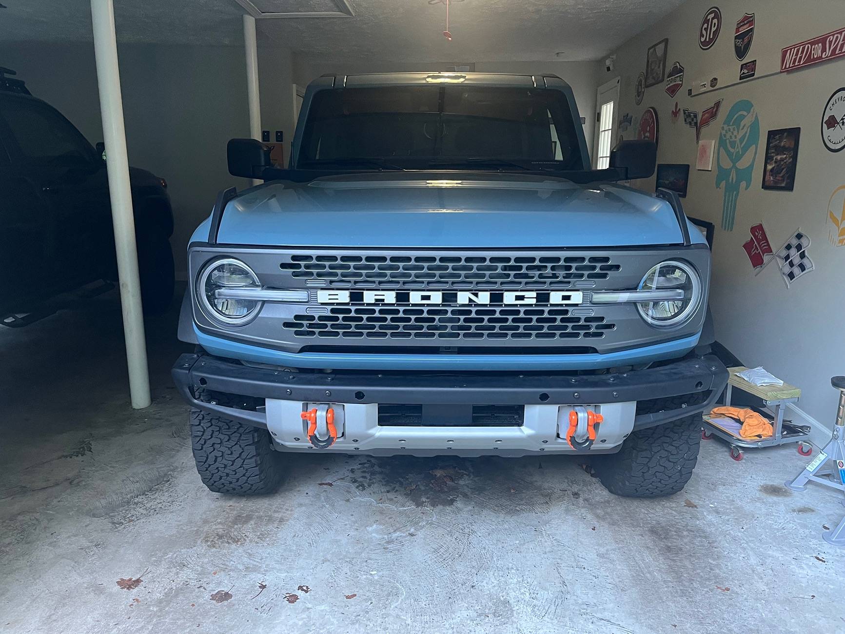

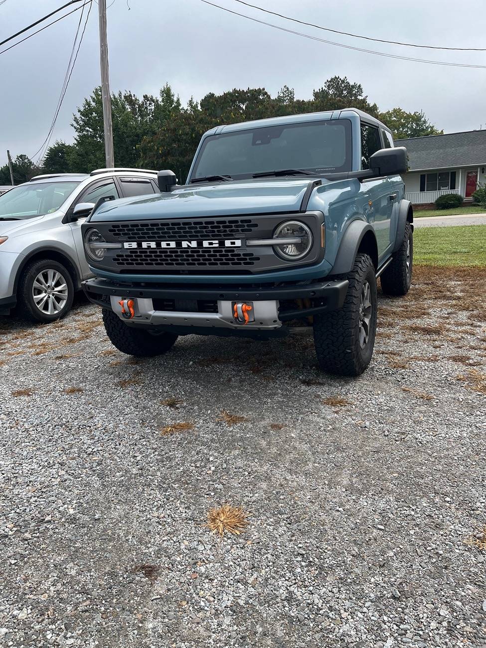

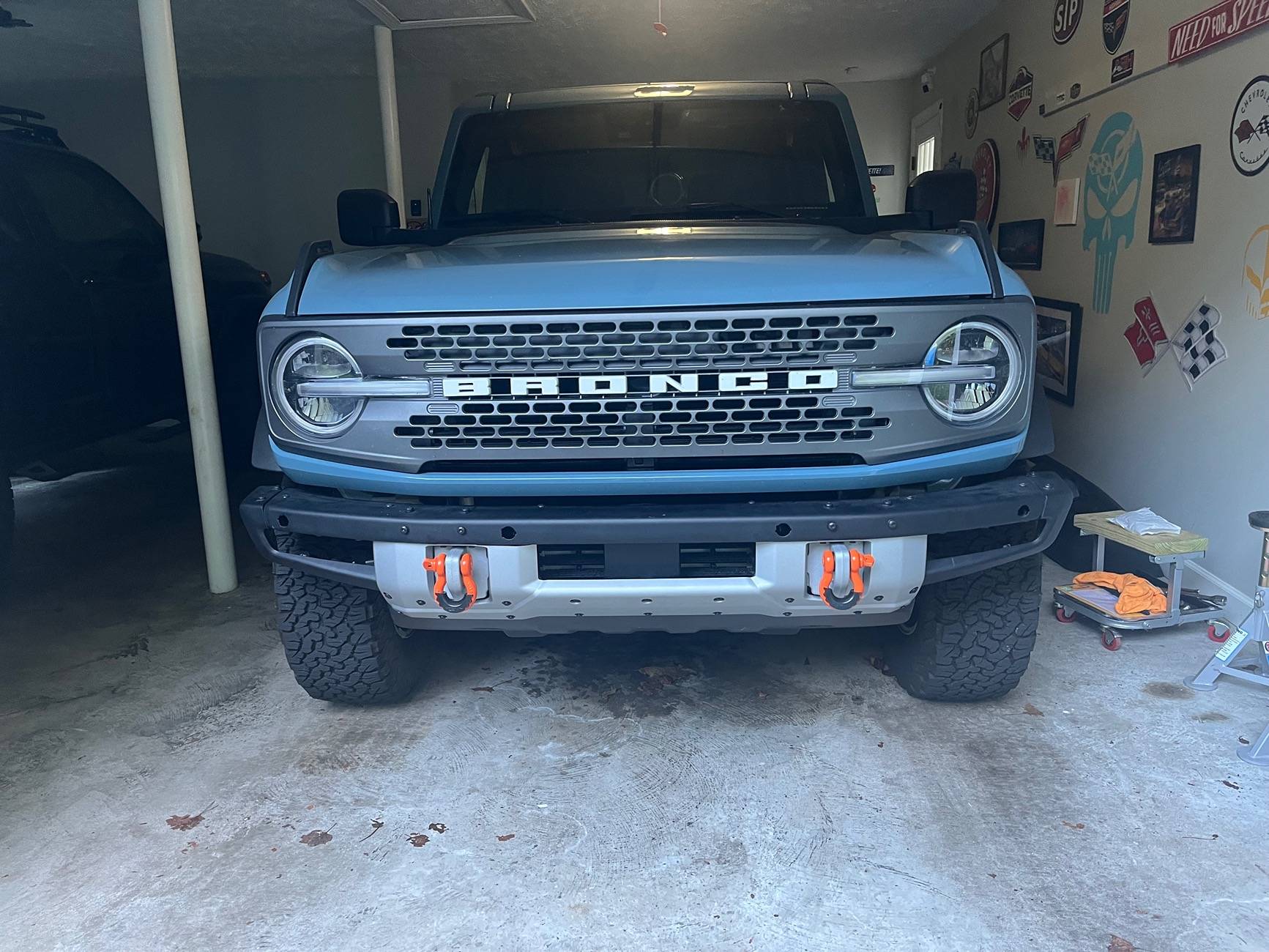

Several weeks ago I posted a WTB ad for a modular bumper. I was a little sad because it seemed that EVERYONE is trying to get a modular bumper. 😢

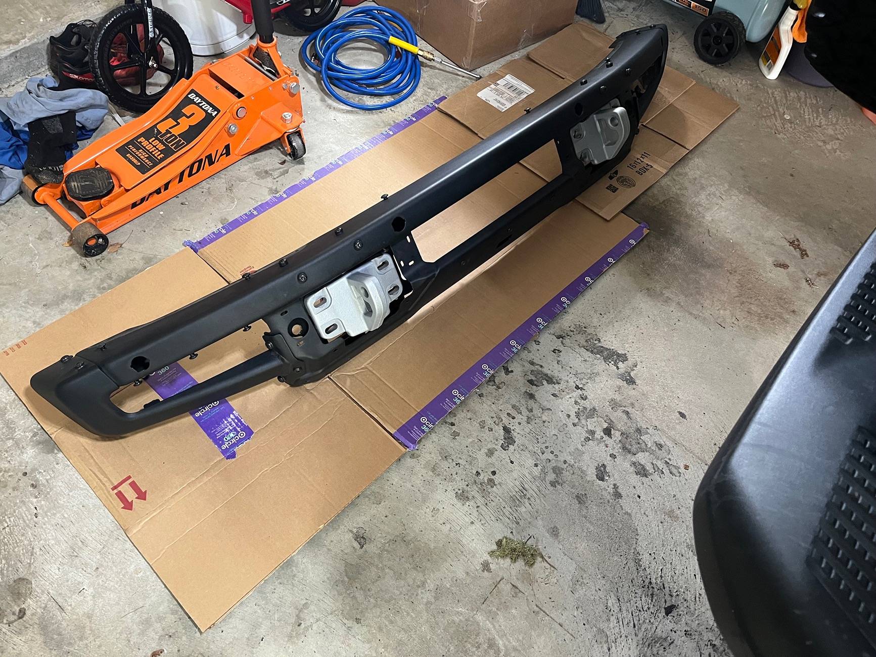

After several hits, (one of which was a PM from a scammer that has since been banned) I had a forum member give me a lukewarm offer — possibility — of a takeoff modular bumper from a Bronco Raptor. It was contingent on whether or not he liked the new aftermarket winch bumper he had just acquired. A couple weeks went by and he almost hesitantly decided to sell me his OEM bumper. I made the 6-hr round trip drive and picked it up this past weekend in my F150. For those that are considering this swap, I was very surprised just how heavy this dang bumper is. I’m really glad I took my truck and several packing blankets to get it. It was surprisingly heavy to me…….much heavier than I expected.
The install was super-straightforward and VERY easy considering my Badlands had dummy sensors and foglights. There was no wiring, so it was just a matter of 6 bolts, removal of the plastic bolt covers, and then not damaging the new bumper during installation.
I am SUPER-STOKED about the finished product. Now all I need is lights and dummy sensor covers. (If anyone has a suggestion on those, please feel free)

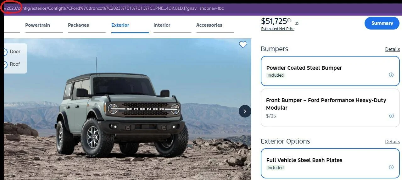

Makes no difference. I have a non-sas BL that I ordered with the steel bumper.
I think that is the key. It ‘can’ be ordered with a steel bumper, but it doesn’t automatically come standard. My buddy at work has a Badlands and his has a front camera, modular bumper, and sensors. (His is also non-Sasquatch)

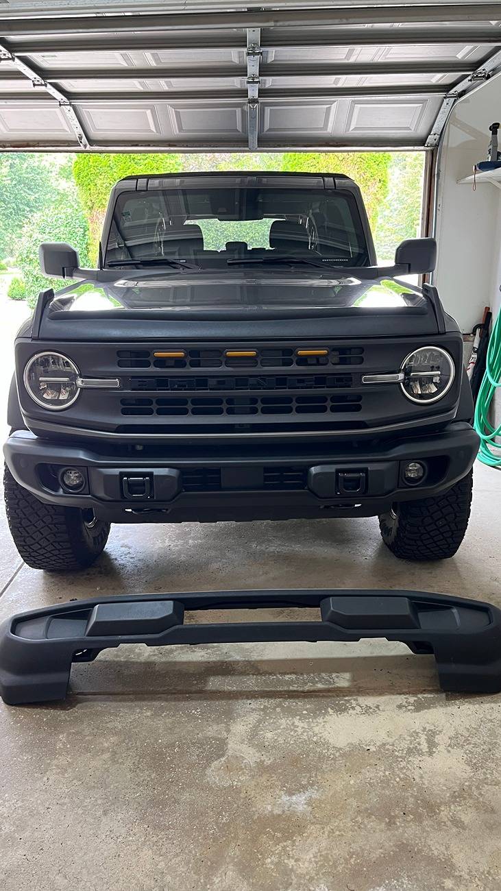

I swapped from the plastic bumper to a capable bumper last month and used the following sensor hole plugs from Amazon - perfect fit.
Amazon.com: Masendelk 10pcs Plastic Hole Plugs, Snap in Locking Hole Tube Circular Locking Fastener Cover, Insert End Caps for Furniture Fencing Post Pipe - 28mm, Black : Industrial & Scientific
Here is what they look like on the capable bumper...

Also, although I know that the standard bumper mounting bolts (6), work with the other 2 bumpers, Flip pointed out the parts number for the Mod and Capable are the same and the standard bumper has its own.
