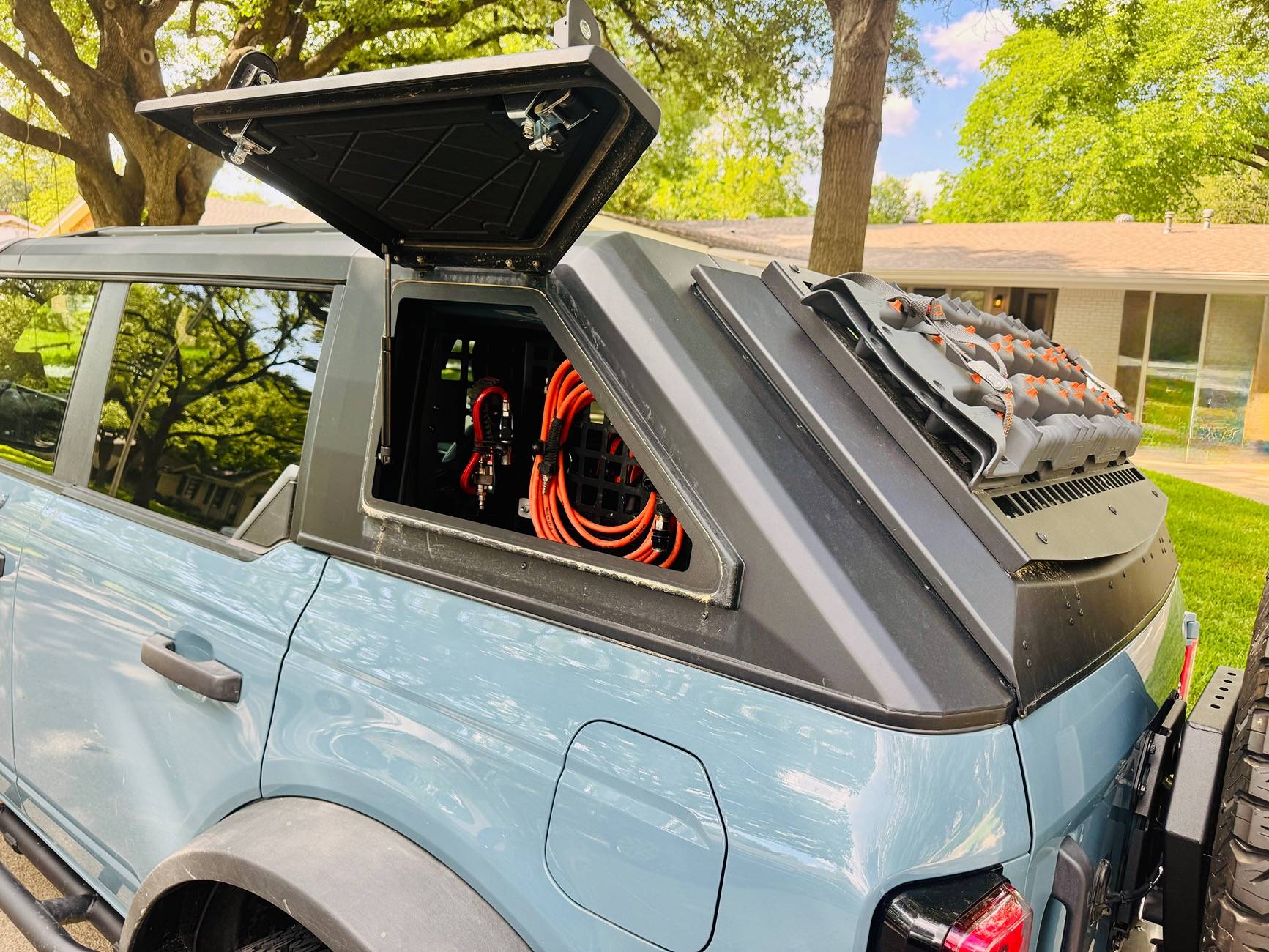

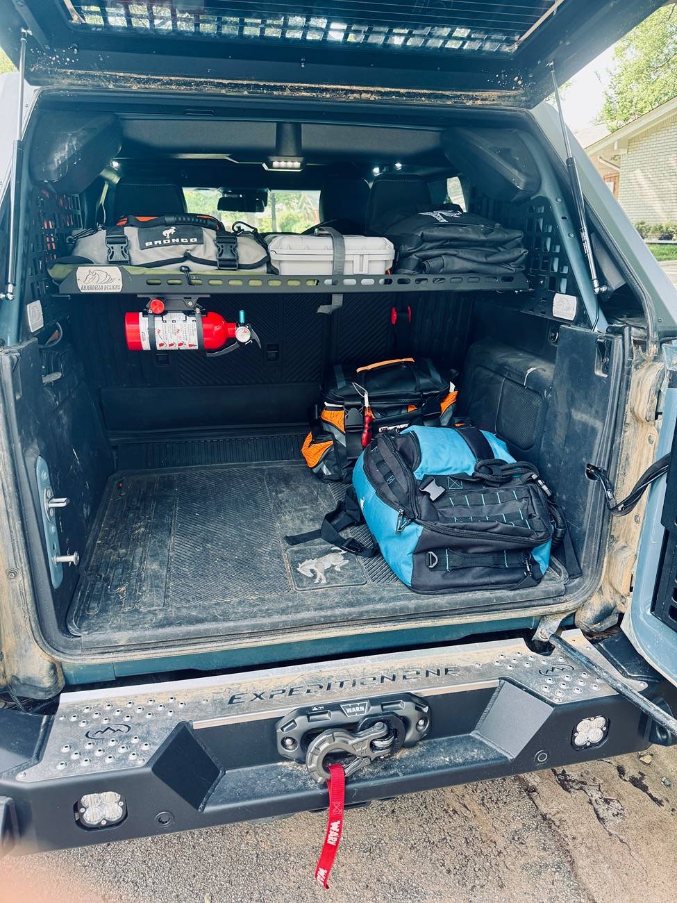

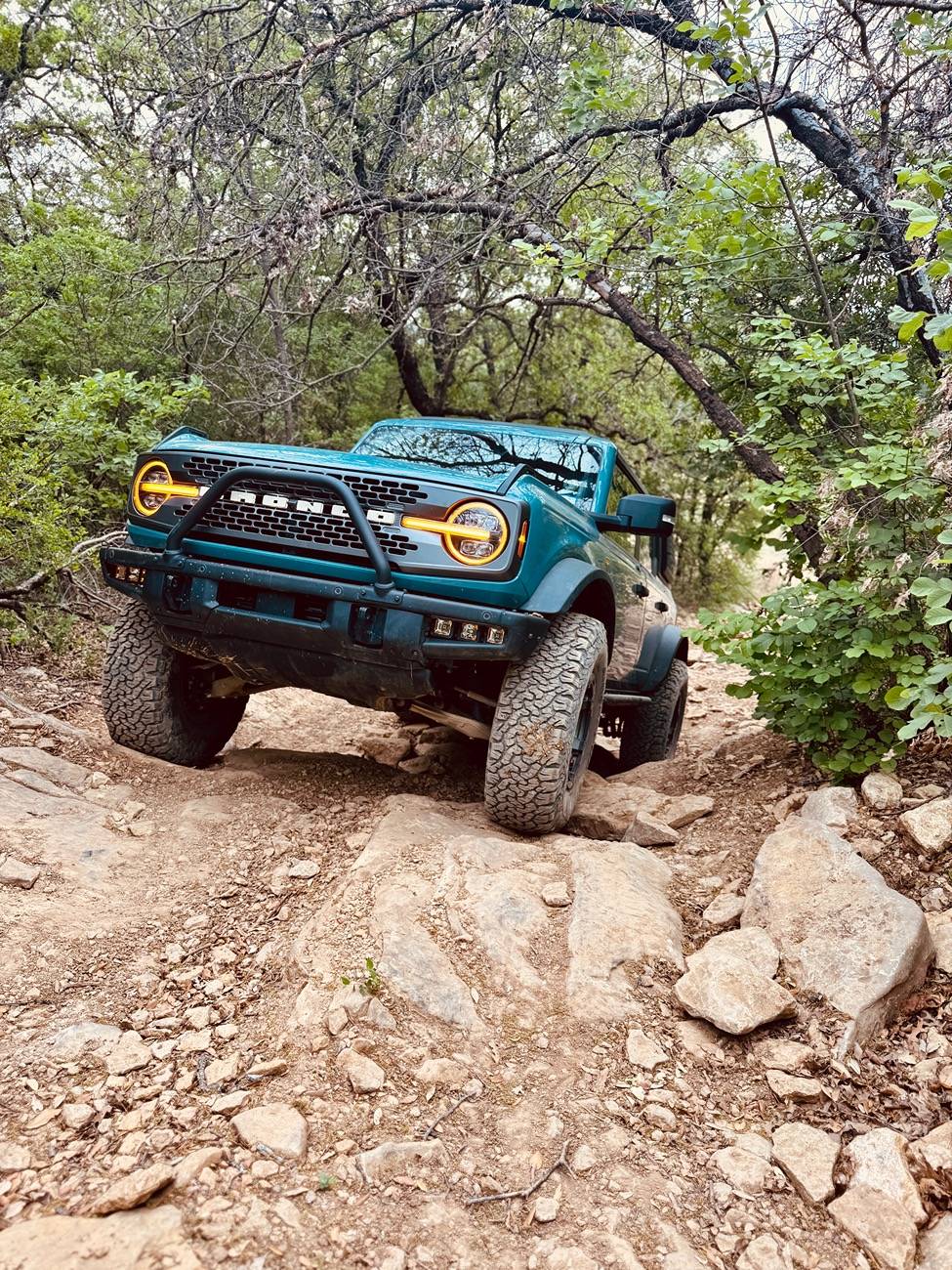

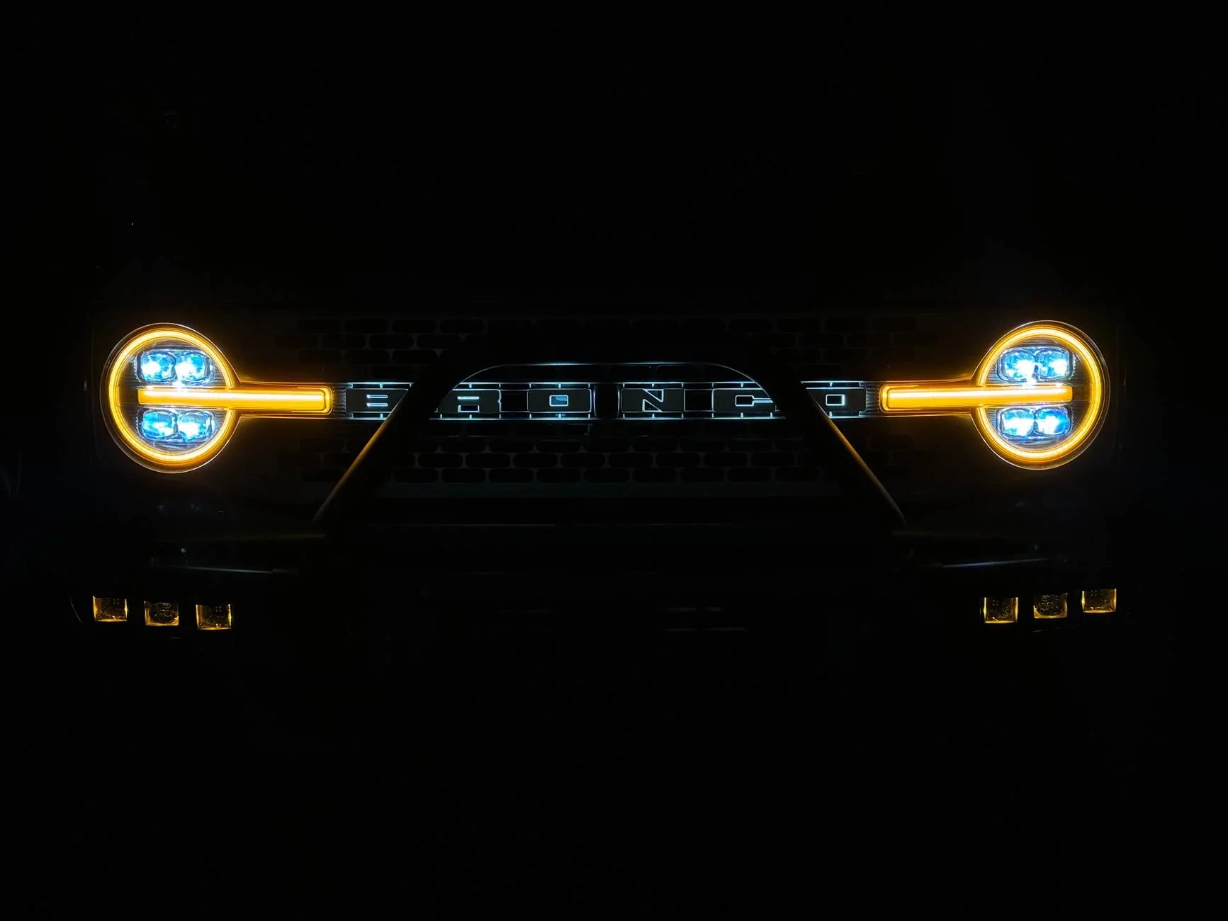

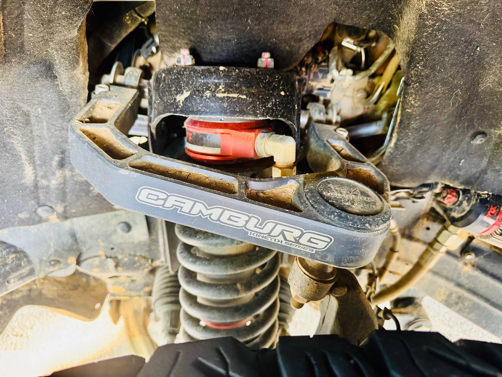

Here is my complete build list. I think (I swear) I may actually be done with this. Feel free to ask my about anything. What I liked, what I didn’t, how install was (didn’t do suspension or bumper but did do everything else in my driveway basically). Full list below with photos
Performance & Mechanical

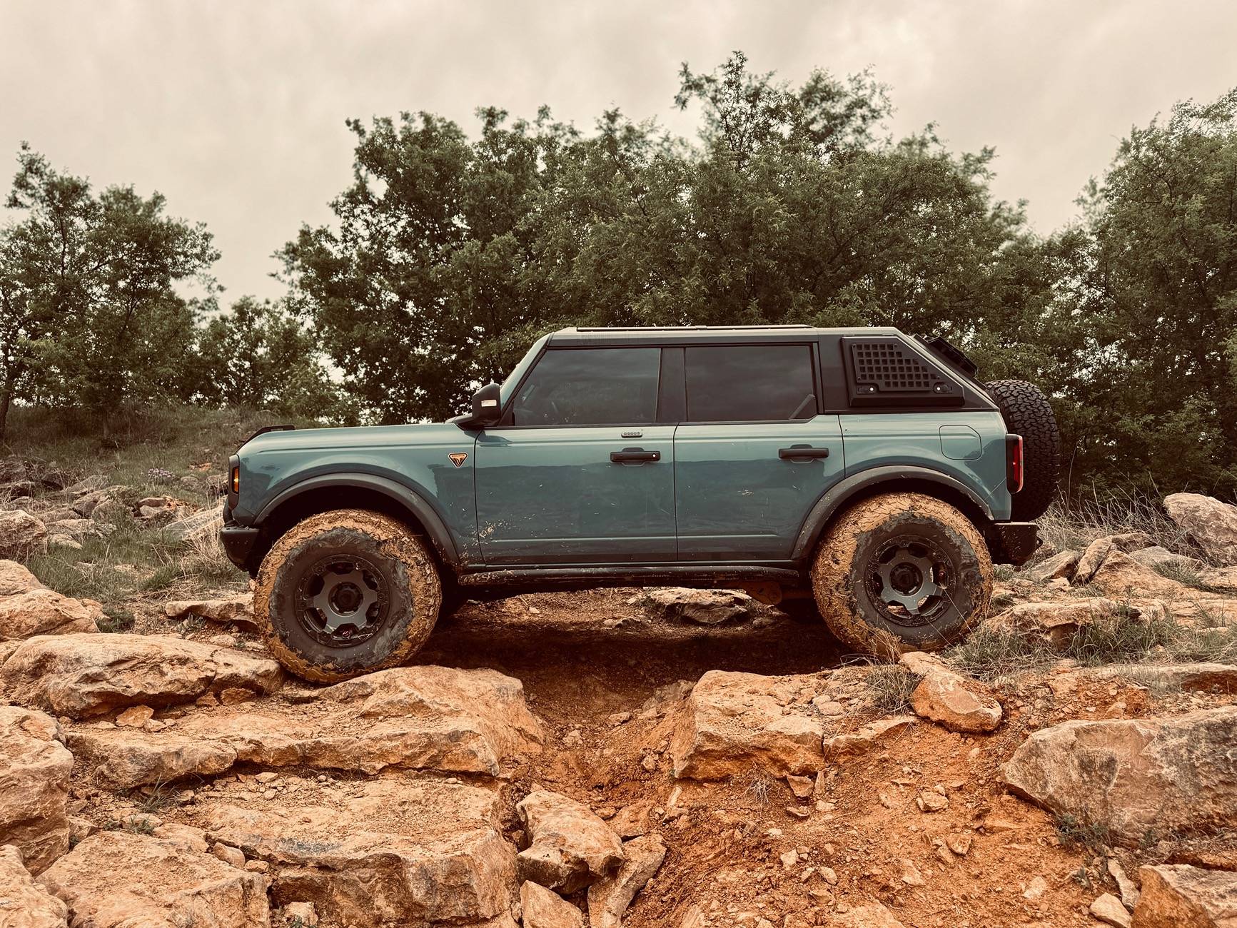

  • Fox Factory Racing 3.0 Suspension
  • Camburg KINETIK V2 Upper Control Arms
  • Ford Performance severe-duty steering rack and tie rods
  • Ford ProCal performance tune
  • Corsa performance exhaust

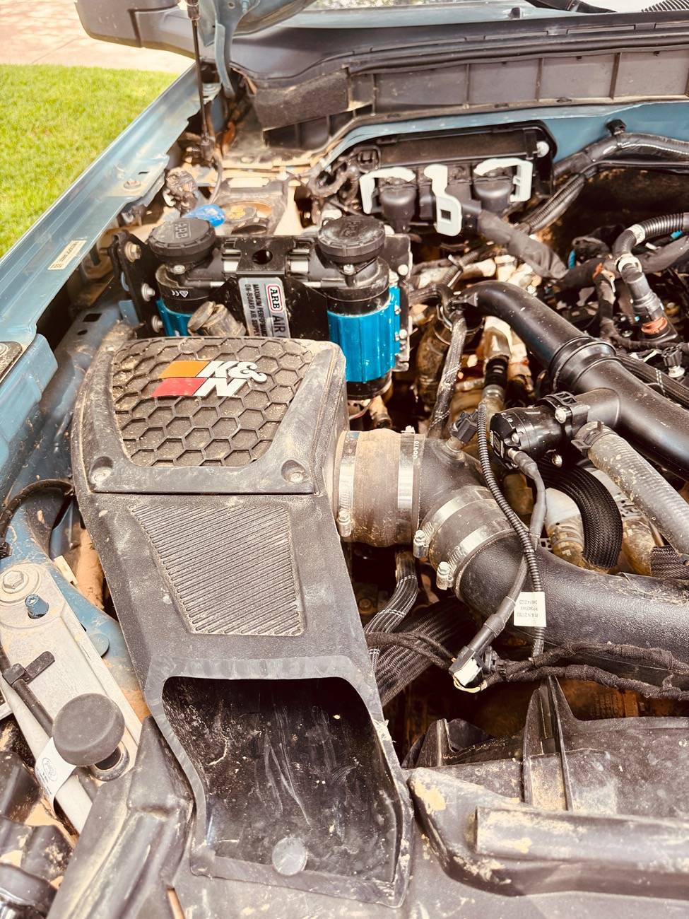

  • K&N cold air intake
  • TurboSmart blowoff valve
Wheels & Tires

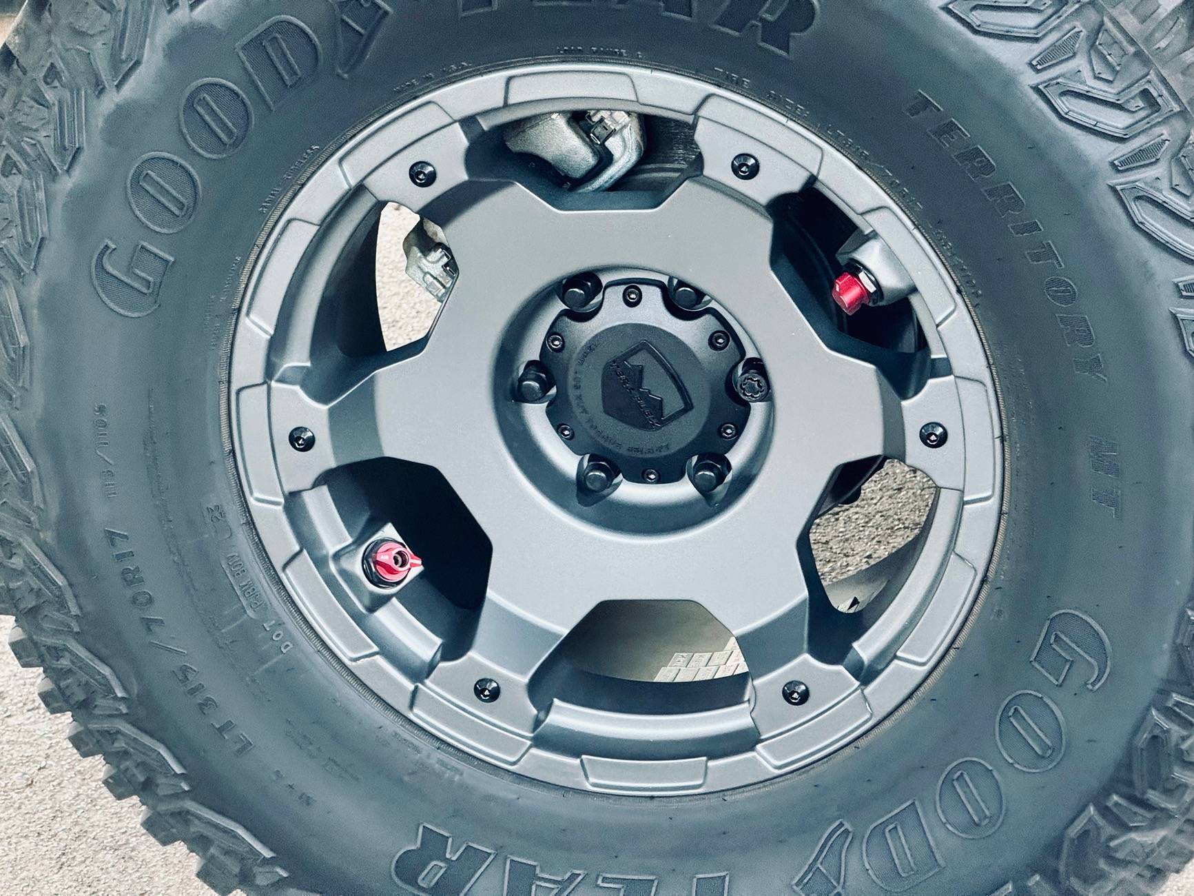

  • 37” BFGoodrich KO2 tires
  • Teraflex Nomad wheels with quick deflator valves
Body & Exterior

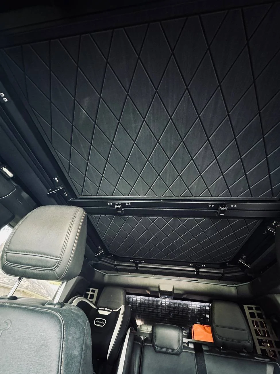

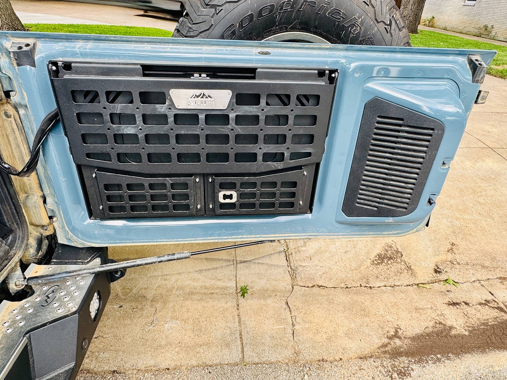

  • Armadillo Designs Slantback hardtop with MOLLE gull-wing panels, rear window MOLLE panel, and internal MOLLE shelf

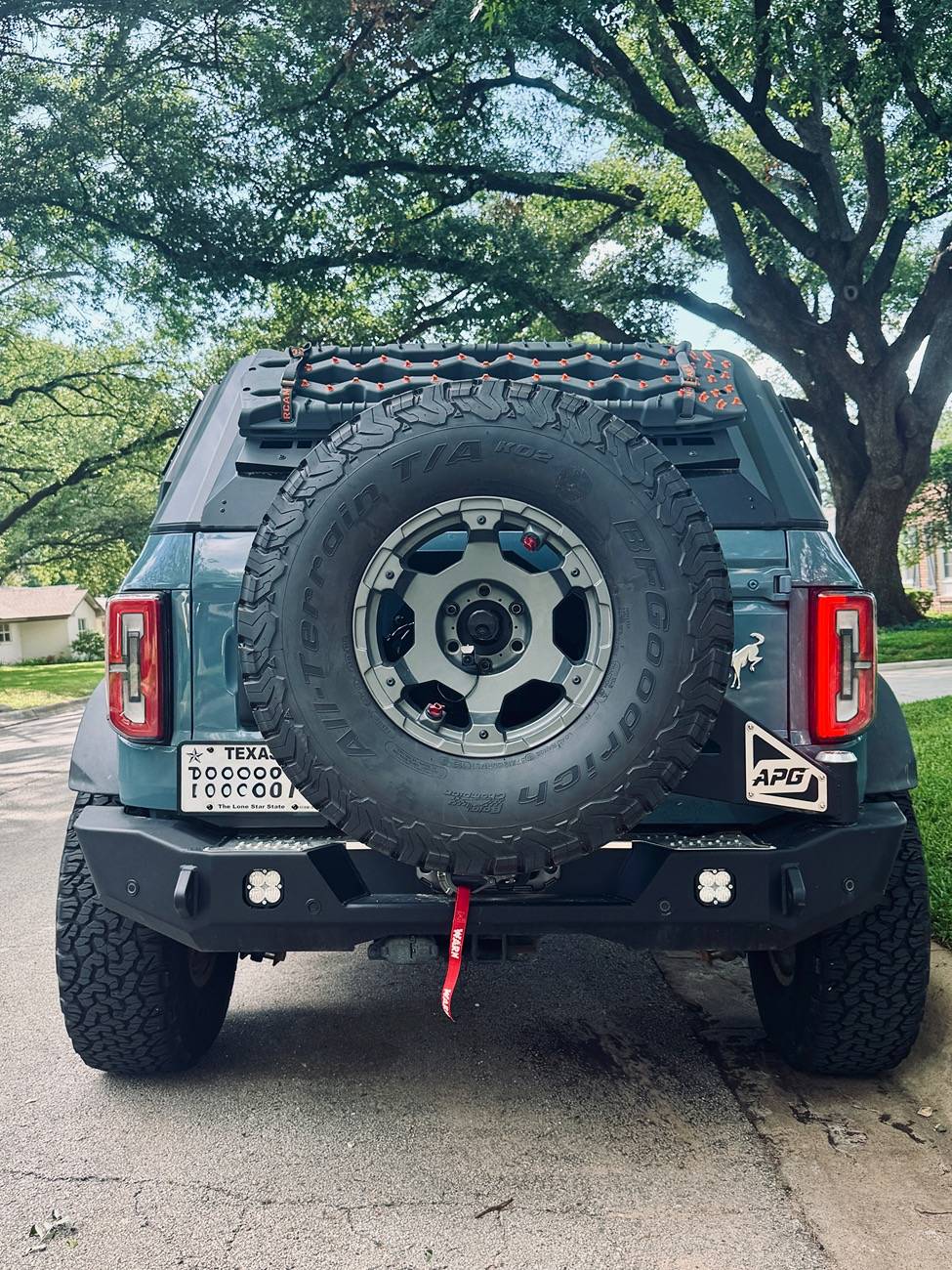

  • APG/Exp1 rear bumper and tire carrier
  • GOATfab pinch weld covers
  • GOATfab rock slider steps
  • RCI crossmember skid plates
  • JKS Max Tire Clearance Kit
  • Turn Offroad license plate relocation bracket
Lighting
  • 6x Rigid amber backlit bumper pod lights (4x Scene, 2x Radiance)
  • 2x rear-facing Baja Designs Squadron Sport
  • Alpharex headlights
  • Oracle Bronco letter lights
  • Hood light kit

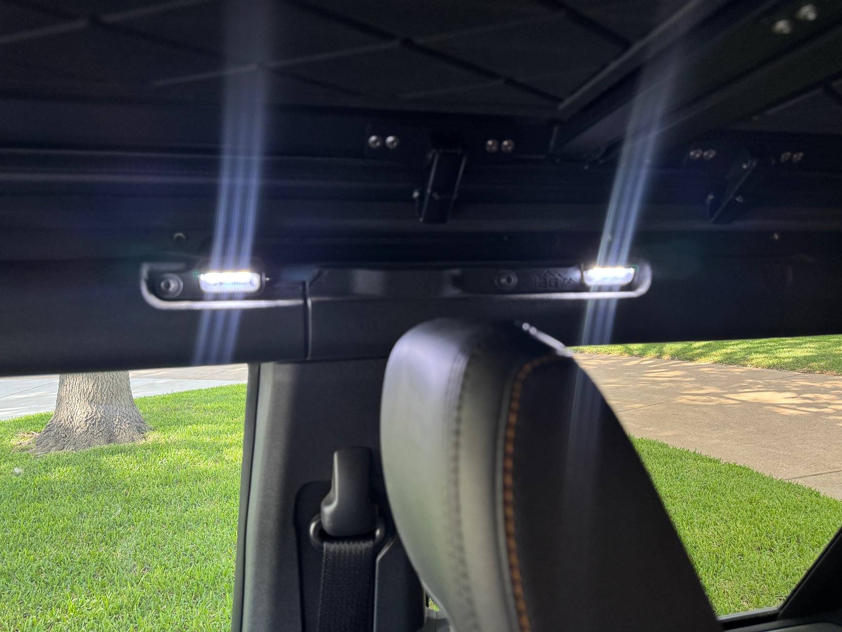

  • IAG interior lighting kit
Recovery & Overlanding
  • Warn M-8000S winch (with Epic hook and fairlead)
  • APG hidden rear winch mount
  • ARB Dual Compressor with SDHQ vertical under-hood mount
  • ARB TRED Pro recovery boards
  • ARB Premium Recovery Kit
  • BroAddict tailgate table with MOLLE panels
Interior, Tech & Convenience
  • Midland MXT275 GMRS radio system

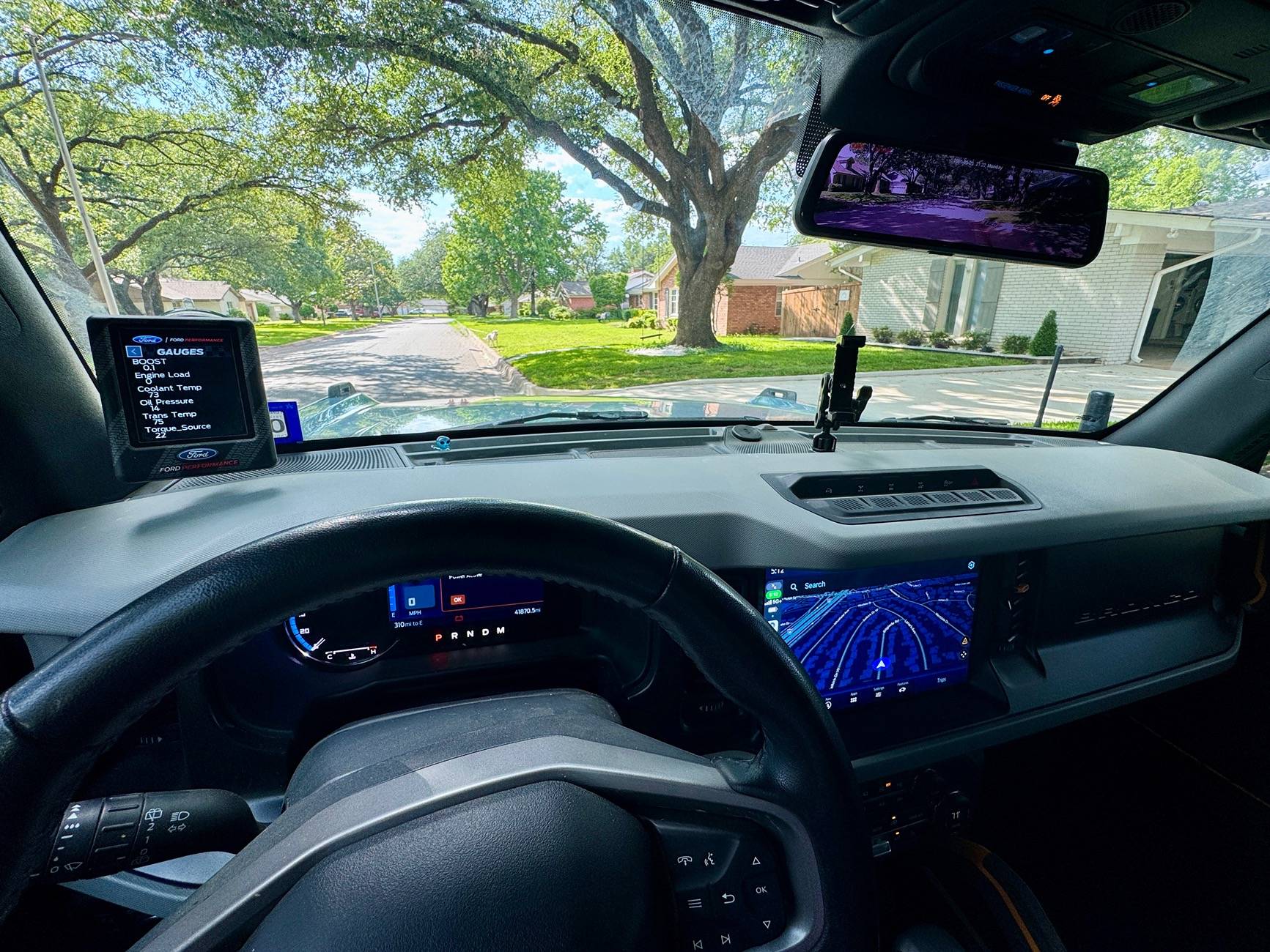

  • BrandMotion Digital rearview mirror & dashcam
  • Auto start-stop eliminator
  • Hood struts
  • Kicker Comp RT subwoofer (8”) with Musway FOUR.100 amplifier
  • Buck Your Bronco gimbal
  • Suma wide-angle mirrors
  • StickerFab interior warning cover

VERY Nice build! Those rims are very nice. Rear winch setup is also nice. I guess we can be Badlands Slant Back Bros :) One day, I'll do a build thread.

Love the rear winch setup.

Absolutely insane build! Any problems with the tires rubbing on the fenders or any adjustments made there? You think they would fit with stock suspension? Trying to possibly do 37s on mine as well.
BroncoFrog
BroncoFrog
Drew
Apr 20, 2023
95
193
DFW
Bronco Badlands 2023
Yes, I had to cut the rearward crash bar "mount" (the crashbar is already gone on sasquatch). I bought the Max tire clearance kit to cleanly move the fender out of the way in the rear of the front wheel well cleanly (not 'necessary' but clean). I did not need to use the front portion of the tire clearance kit, so I paid a lot to use minimal. I thought I would also need it in the front but did not. Zero rub up there.
