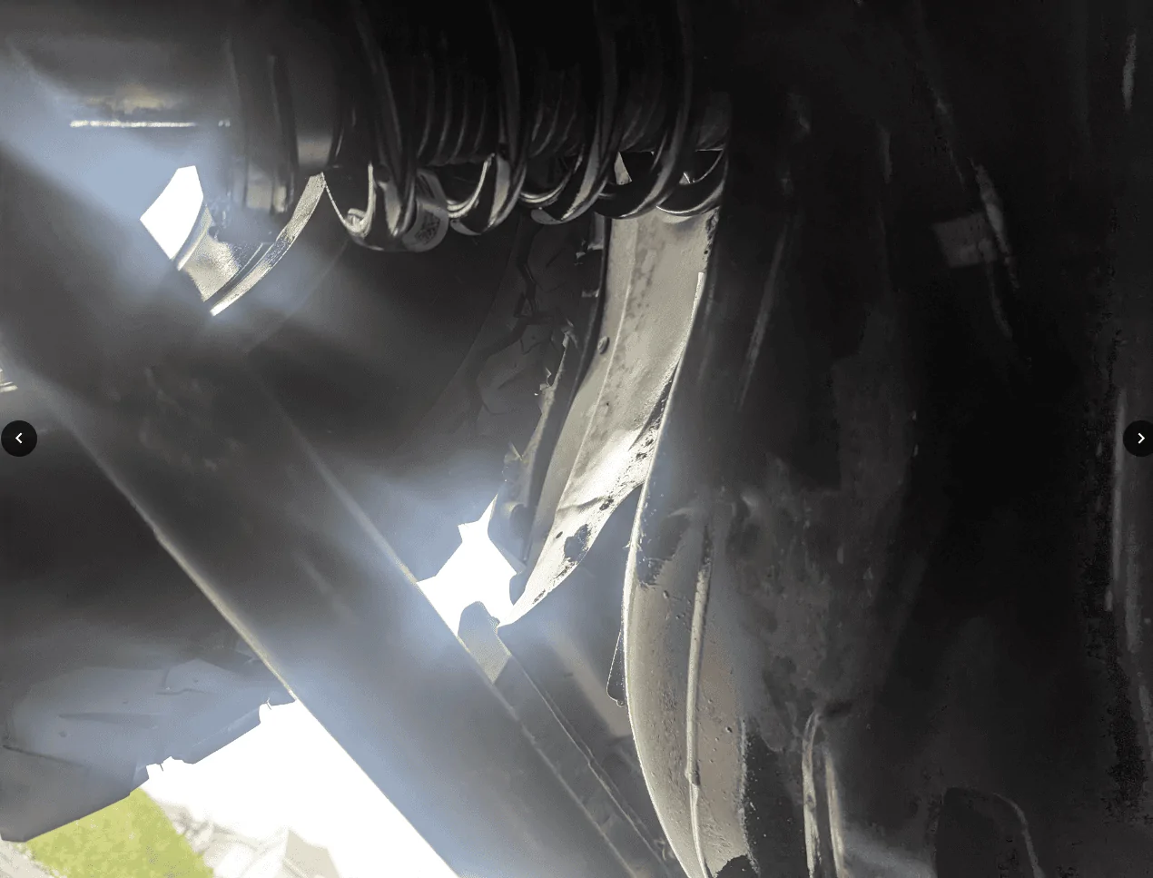

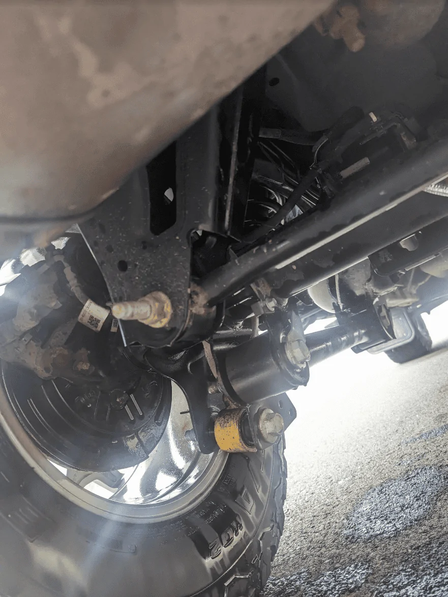

Well I can no longer say my 2021 Badlands has never had a problem.
On the way home from work my driver's side rear shock decided it didn't want to be a shock anymore and all the fluid came out. I was luckily only about a km from home and was able to limp it home.
Unfortunately the soonest a dealer can get it in to look at it is the 21st of May, the other dealer in town isn't booking until June 3rd(!)
Guess I'm riding the Ducati to work unless it's nice and then I'll take my Mustang (it's never seen rain, lol)
Ford Bronco '21 Badlands rear shock failure 1715198367006-25
Ford Bronco '21 Badlands rear shock failure 1715198390449-kh

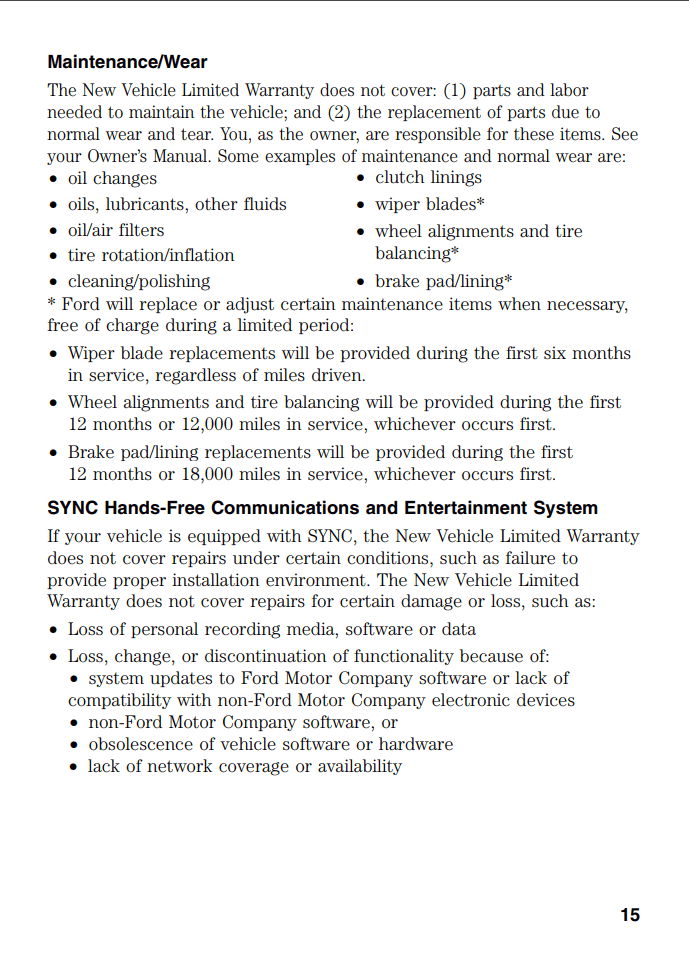

Shocks aren't covered by warranty (I thought)? Couldn't you just replace them?
If the shocks aren't covered by warranty when I've never had this thing on a dirt road, they won't have to worry about the warranty because my insurance will cover the fire.
I may be wrong, but I thought it was considered a wear item like tires and wasn't covered. Seem to remember several people posting they lost their reservoir and they were Out of Luck Chuck.
They may get covered anyway, I guess. I dunno. Worth asking so you don't wait only to find out later.

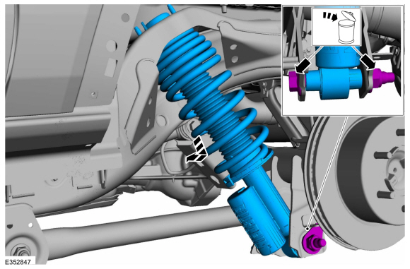

If it has a trash can it's one time use.
They will need
1- W720199-S440
3- W520213-S440
1- W719177-S439
1- W719178-S440
1- shock (has to be looked up by VIN, too many choices)
Shock Absorber and Spring Assembly
Special Tool(s) / General Equipment
Vehicle/Axle Stands
Removal
NOTICE: Suspension fasteners are critical parts that affect the performance of vital components and systems. Failure of these fasteners may result in major service expense. Use the same or equivalent parts if replacement is necessary. Do not use a replacement part of lesser quality or substitute design. Tighten fasteners as specified.
NOTE:
Removal steps in this procedure may contain installation details.
NOTE: LH side shown, RH side similar.
  1. Remove the wheel and tire.
    Refer to: Wheel and Tire (204-04A Wheels and Tires, Removal and Installation).

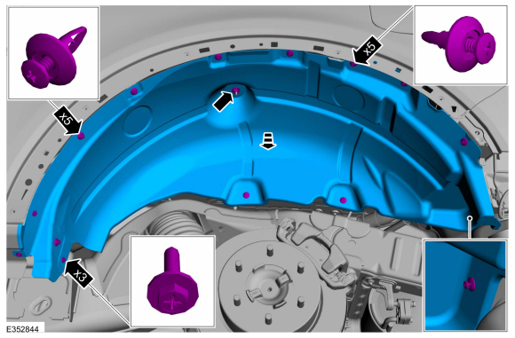

  1. Remove the rear quarter panel moulding.
    Refer to: Rear Quarter Panel Moulding (501-08 Exterior Trim and Ornamentation, Removal and Installation).
  1. Detach the retainers and remove the splash shield.
    Torque: 18 lb.in (2 Nm)
Ford Bronco {thread} {filename}

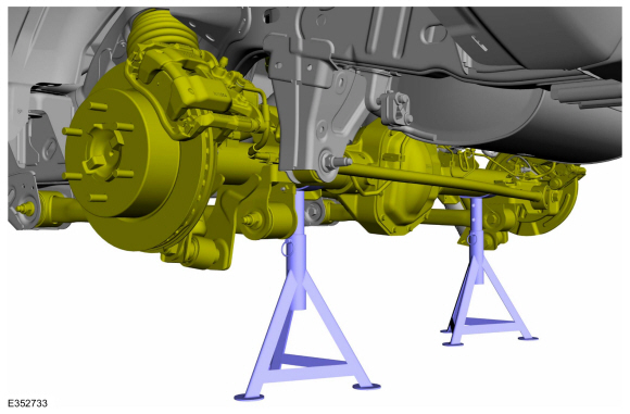

  1. NOTICE: Do not position the jack on the front control arm or rear control arm on any vehicle. Damage to control arms may occur.
    NOTICE: Make sure that the jack insulator pads are correctly positioned to prevent direct contact with other components.
    With the vehicle on hoist, place axle stands under the rear axle such that the axle stand insulator pads are in contact with the axle.
    Use the General Equipment: Vehicle/Axle Stands

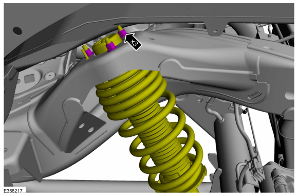

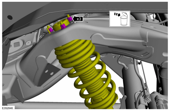

  1. Remove and discard the rear shock absorber upper nuts.

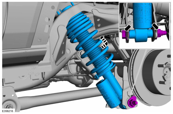

  1. Remove and discard the rear shock absorber lower nut and bolt and remove the shock absorber.

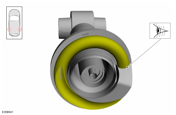

Hitachi - shock absorber and spring assembly.
  1. NOTE: Make sure that the component is installed to the position noted before removal.
    On both sides.
    Make sure that the spring lower end tip in the shock absorber and spring assembly is facing the RH side of the vehicle.

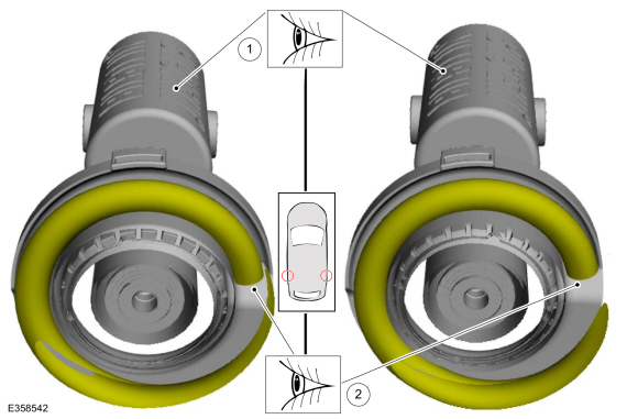

Bilstein - shock absorber and spring assembly.
    1. Shock absorber reservoir should face forward direction for the vehicle.
    1. Make sure coil spring lower end tip in the shock assembly must face RH side of the vehicle.

  1. NOTE: Make sure a new nut and bolt is installed.
    Install the new rear shock absorber and shock absorber lower bolt and nut.
    Torque: 350 lb.ft (475 Nm)
  1. Install the new rear shock absorber upper nuts.
    Torque: 41 lb.ft (55 Nm)
