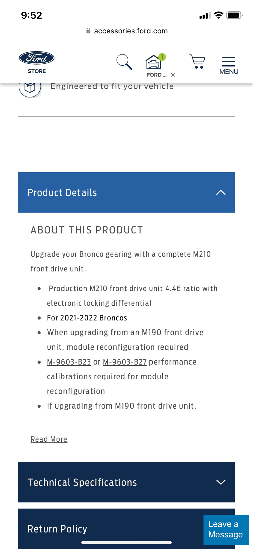

Has anyone with a Black Diamond upgraded their 190 front end to a 210? I know it can be done as Ford has most of it mapped out with their parts listing and required programming. The only thing I don’t know would be the hero switches aspect of it.

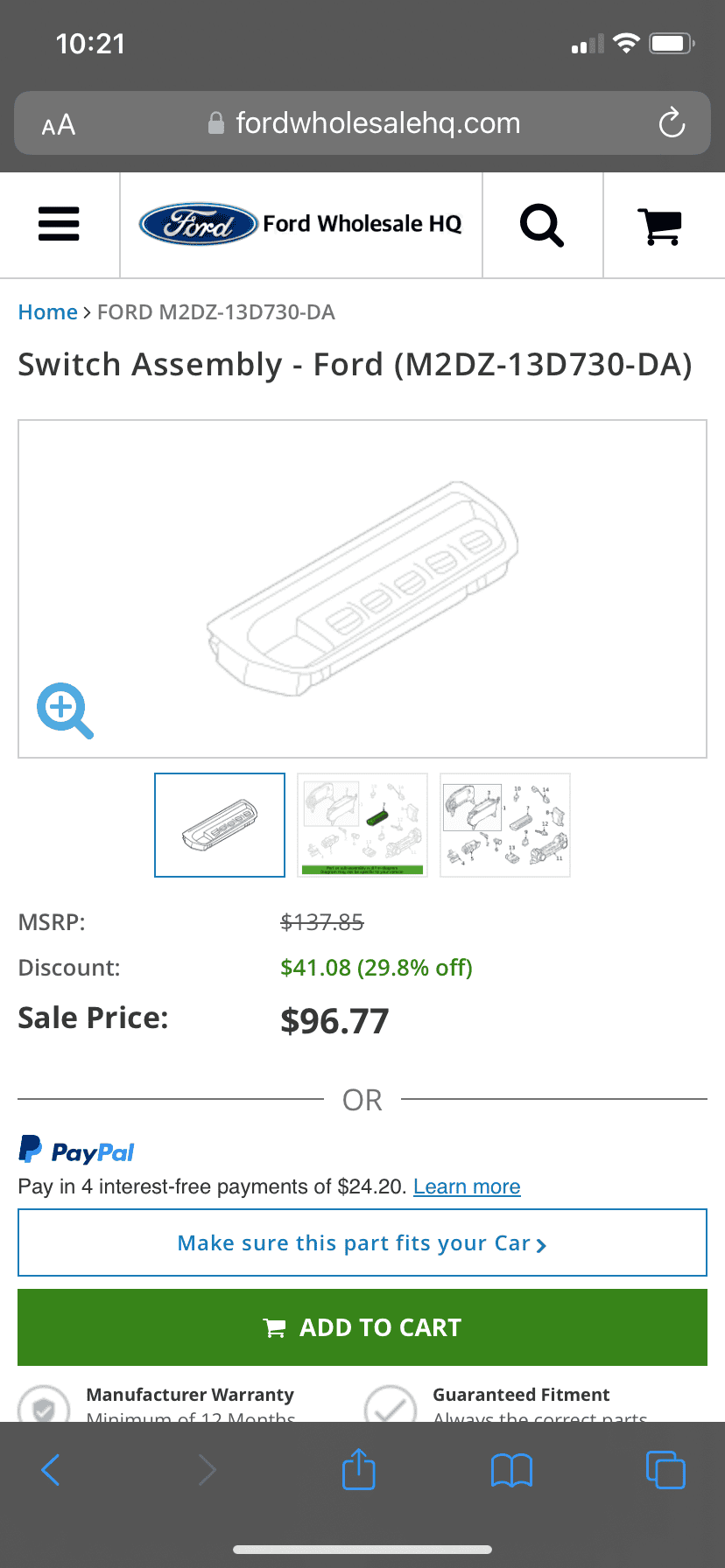

What about the Hero Switch Panel? That would be the part and part number I think is the outlier. I’m assuming that the wiring harness is under the dash. So I “think” that connecting the new Hero switch panel to the wiring harness and the new required calibration required per the part’s description, which is tied to the vin of your Bronco, everything should line up.
I agree but I don't think it's been done yet, I'm not that concerned as I can wire it up to the upfitter switches if it doesn't work out. I think you need a pigtail mentioned in this thread as well.
I don't have that answer but it would make sense that you would need to replace it with one with the front locker option unless there's some sort of other input or sequence to activate either through the goat switch or ??

I found the Hero Switch Panel and added it to the pictures on the original post

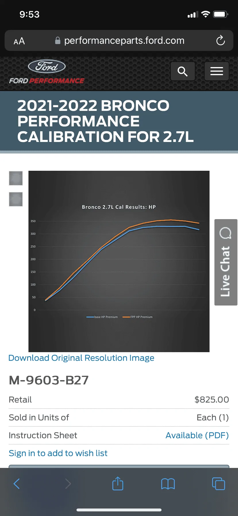

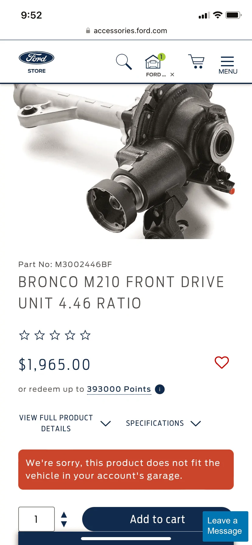

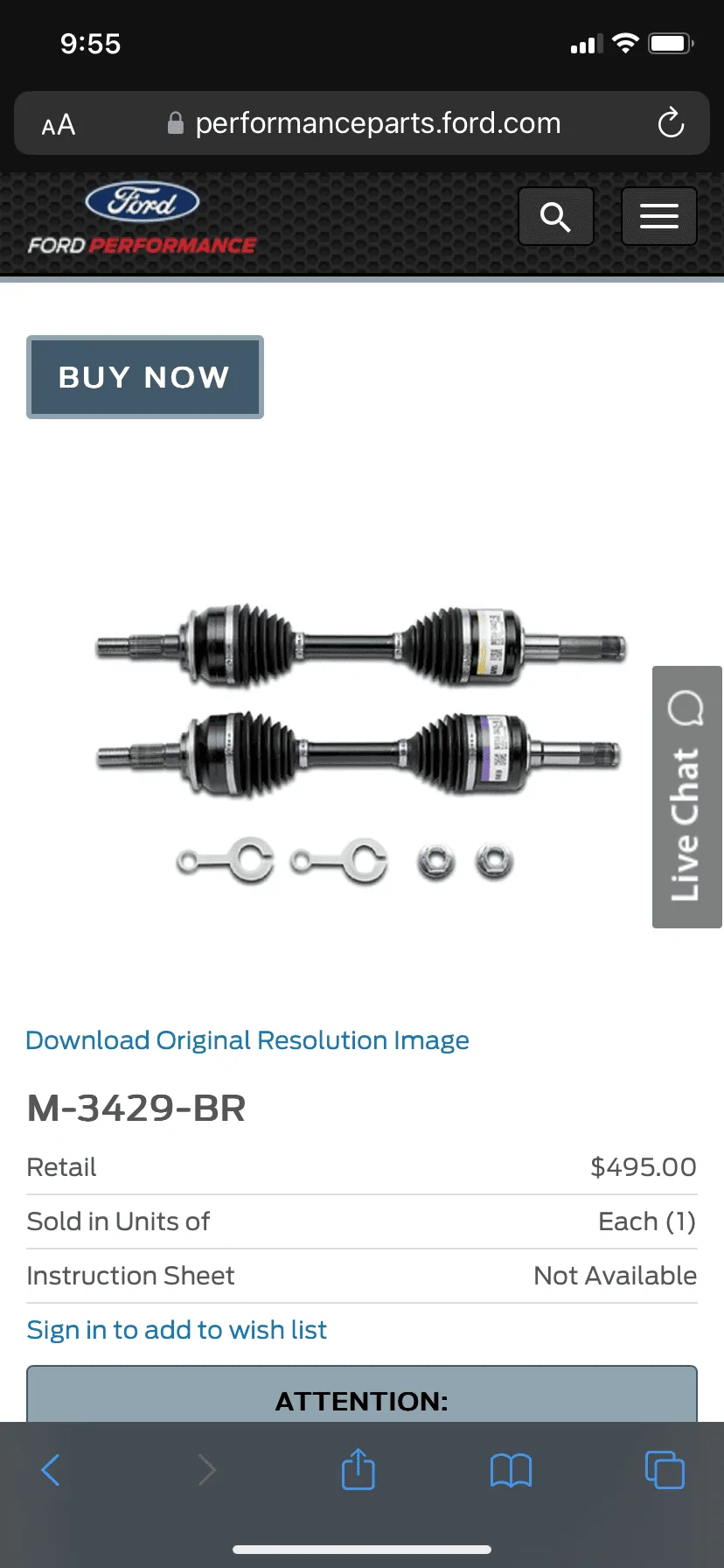

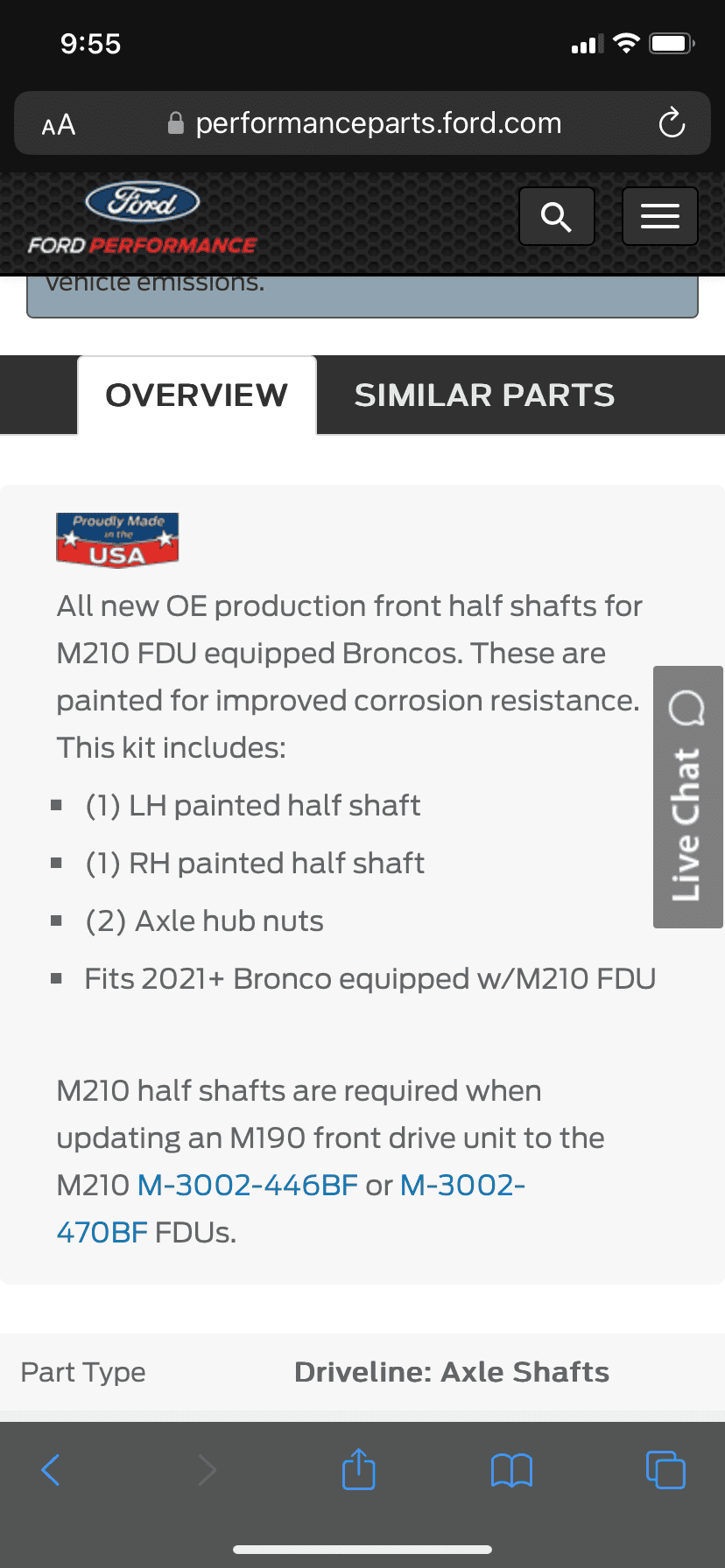

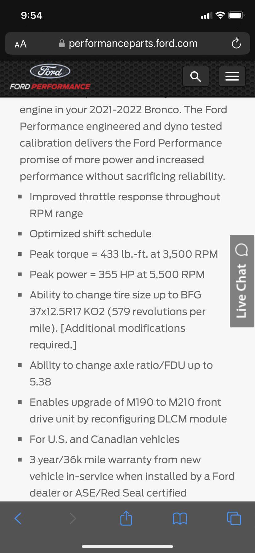

Front Drive Unit: $1965
Half Shafts: $495
Req. Calibration: $895
Hero Switches: $97
Total: $3452
Keeping in mind that some people @flip give discounts, etc…looks like all the parts come with 36,000 miles warranty, so this may be a way to go for non-SAS Bronco owners.
@CMillBronco also posted above a link to @LethalPerformance their conversation kits that have all the parts already packaged together at a good price, but don’t see a hero panel switch in their description. Which leads me to believe that we may have to use an AUX switch. But I hope that isn’t the case.
