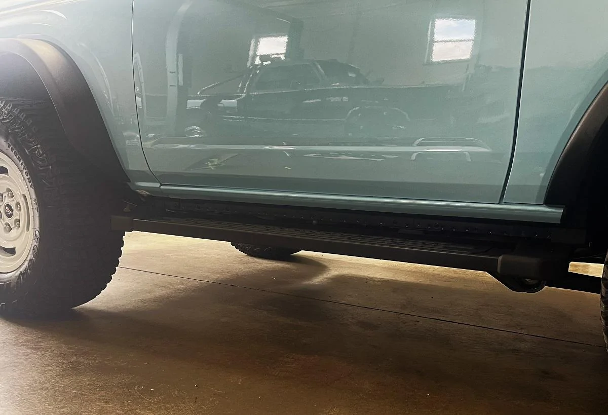

I just picked a 2024 2 door Heritage Edition in Robins Egg Blue, Plans include Red tow attach points, body color painted door handles, Fender flairs and the outer edge of the Grille where it meets the blue. I was happy to find that the Heritage hardtop came with a "Gunners" hatch. Wasn't a fan of the black Roof Rack against the White top so it was the first thing to go. Stay tuned for updates and pictures as soon as I can get them done.

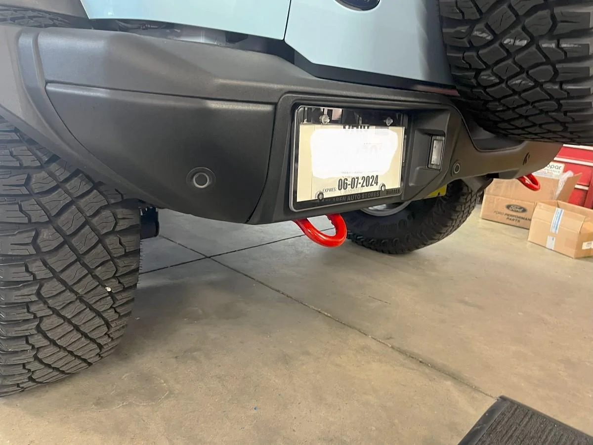

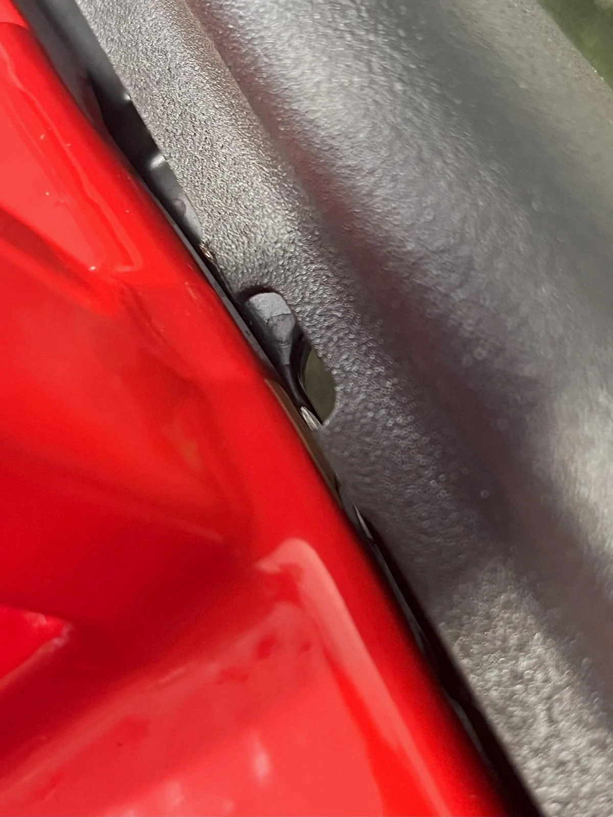

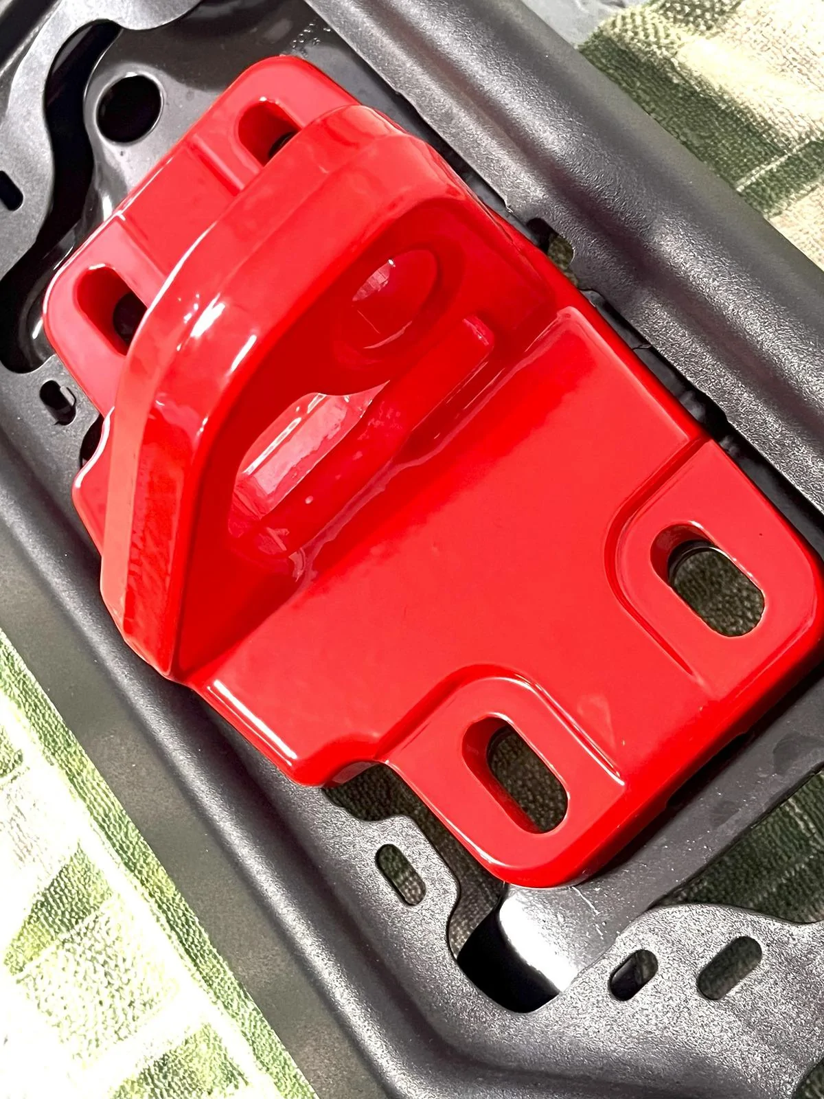

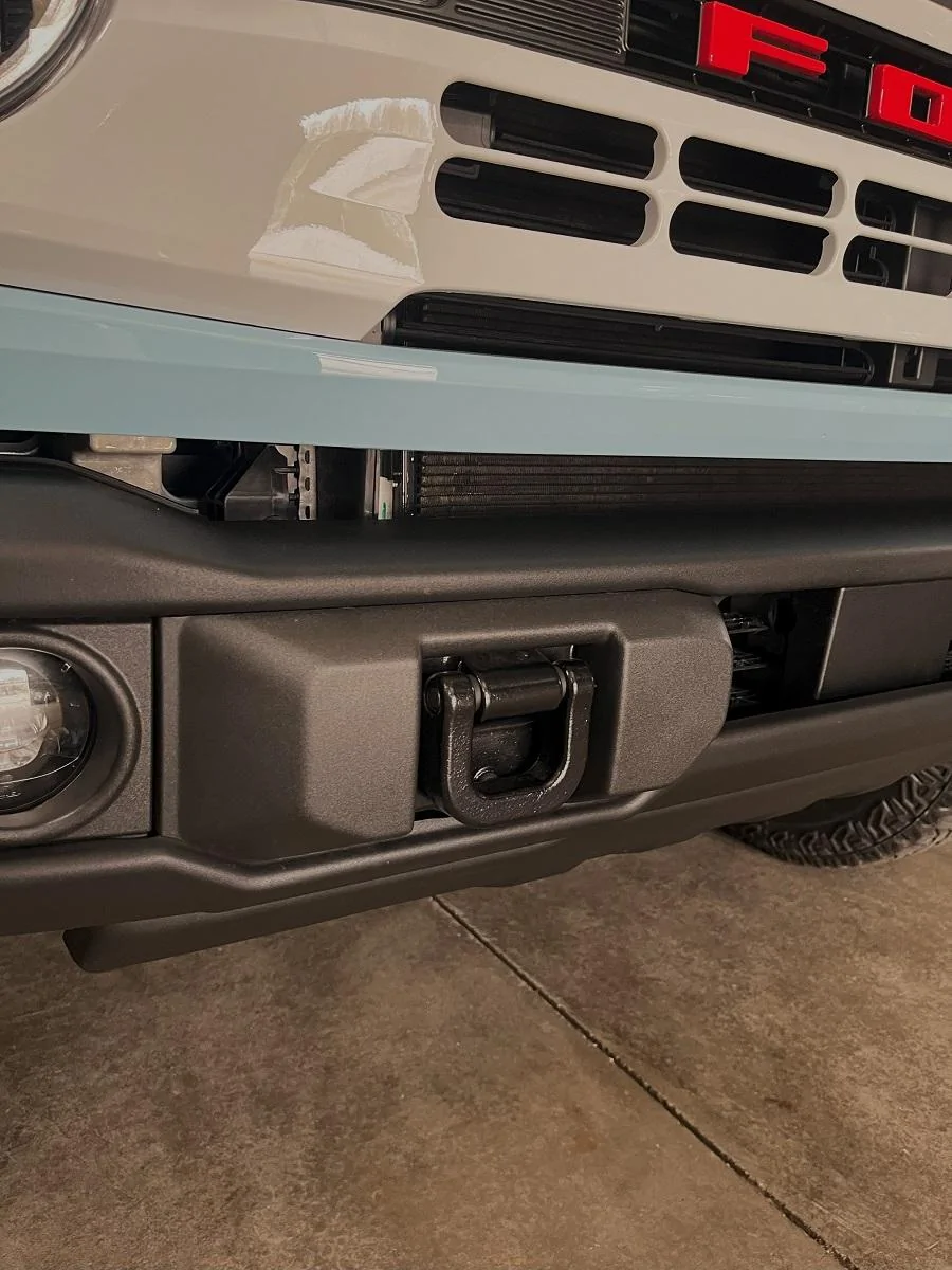

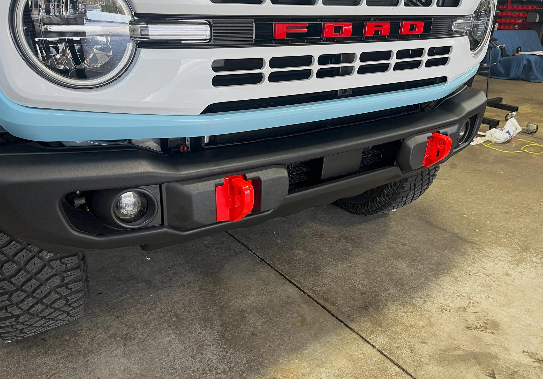

First addition today was a set of Ford Motorsport Red front and rear tow hooks (Ford Performance part #s M-18954-BR & M-18954-BTHR). Ford description says They say fit all bronco's which is true for the Capable bumper that my Heritage edition has, however you will need to cut off the top middle tab slot from the metal bumper and notch out the plastic cover to clear the extended part of the bracket both are easy modifications (if you have the proper tools). I think the red hooks looks awesome with the color combo. enjoy the before and after

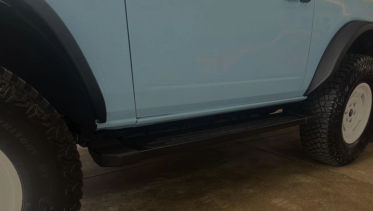

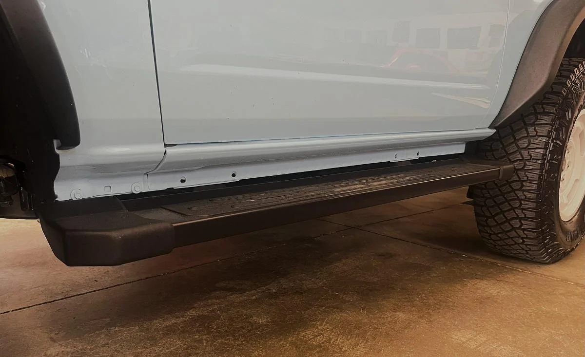

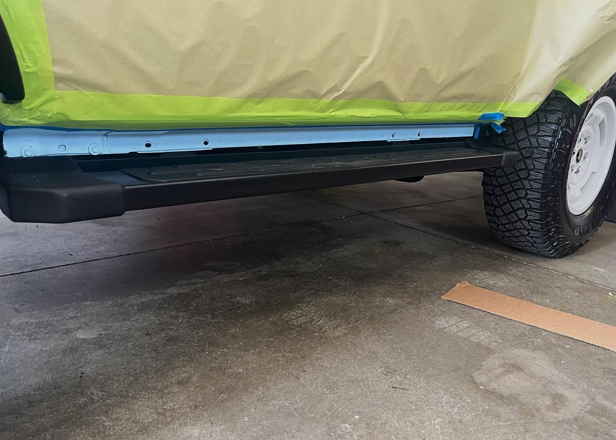

Ever since I got my Heritage Edition less than a week ago one thing that bothered me was the pinch weld along the bottom of the rocker because when I looked at how cool this vehicle is, my eyes kept being drawn to the bolts and holes along the bottom of the vehicle, I'm sure it stands out more being a lighter color and because of the steps that came on it. So, I decided to paint the pinch weld Black using some SEM Trim Black.
