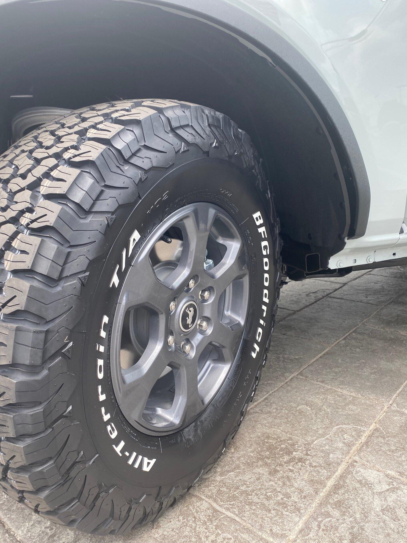

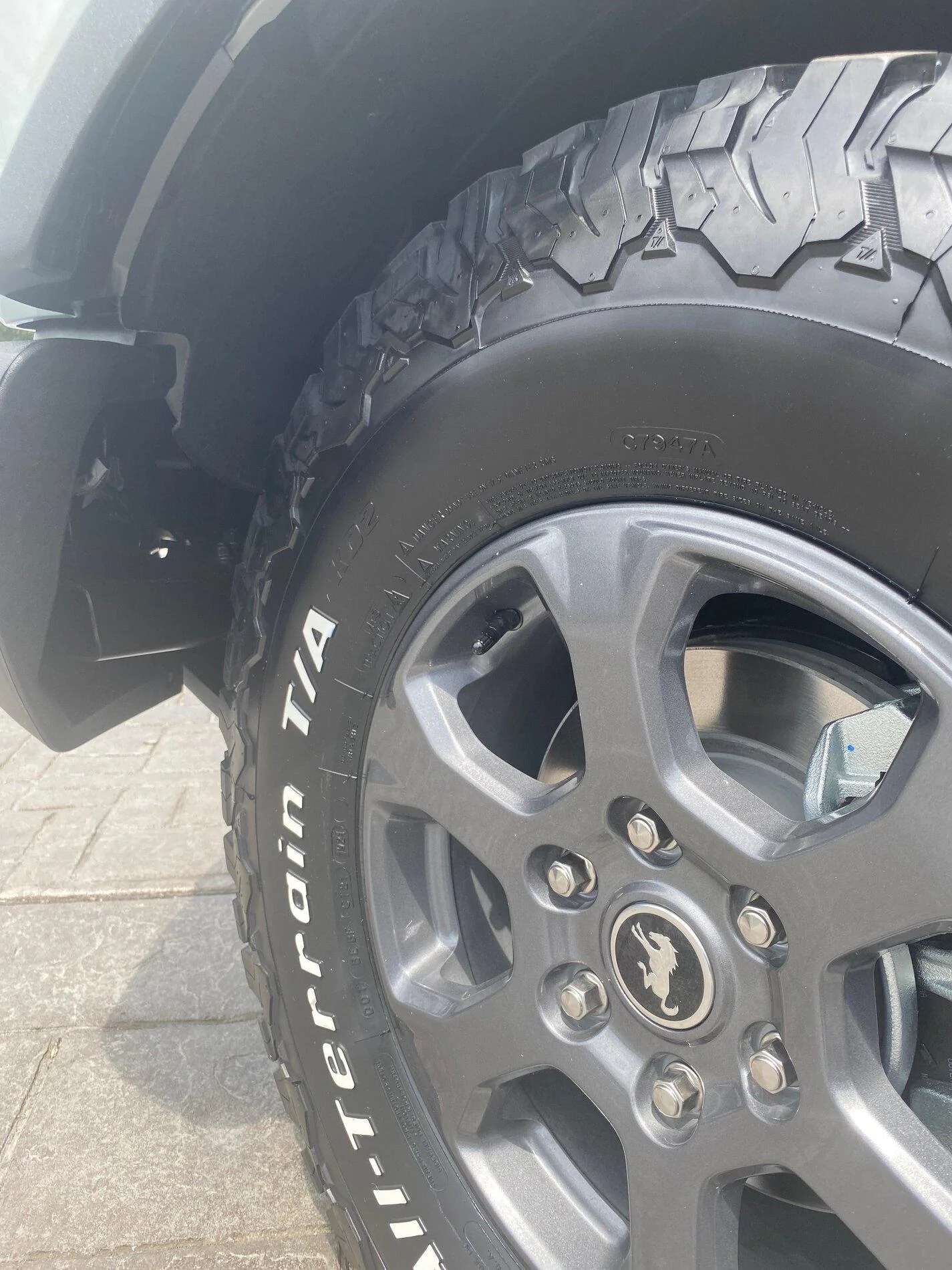

Ford Bronco 33's tires fit Big Bend! As tested on my 2021 Bronco 20240320_194154
Ford Bronco 33's tires fit Big Bend! As tested on my 2021 Bronco 20240320_181304
Ford Bronco 33's tires fit Big Bend! As tested on my 2021 Bronco 20240320_192118

Had 315x70r17 Cooper Discoverer ATP XLT's put on the stock BB wheels. I did add a 1.25" front level kit. The crash bars have also been removed. This is a 2.3 auto with 3.73 gears. Power and torque are still good, very little difference in take off. I absolutely love these tires!
